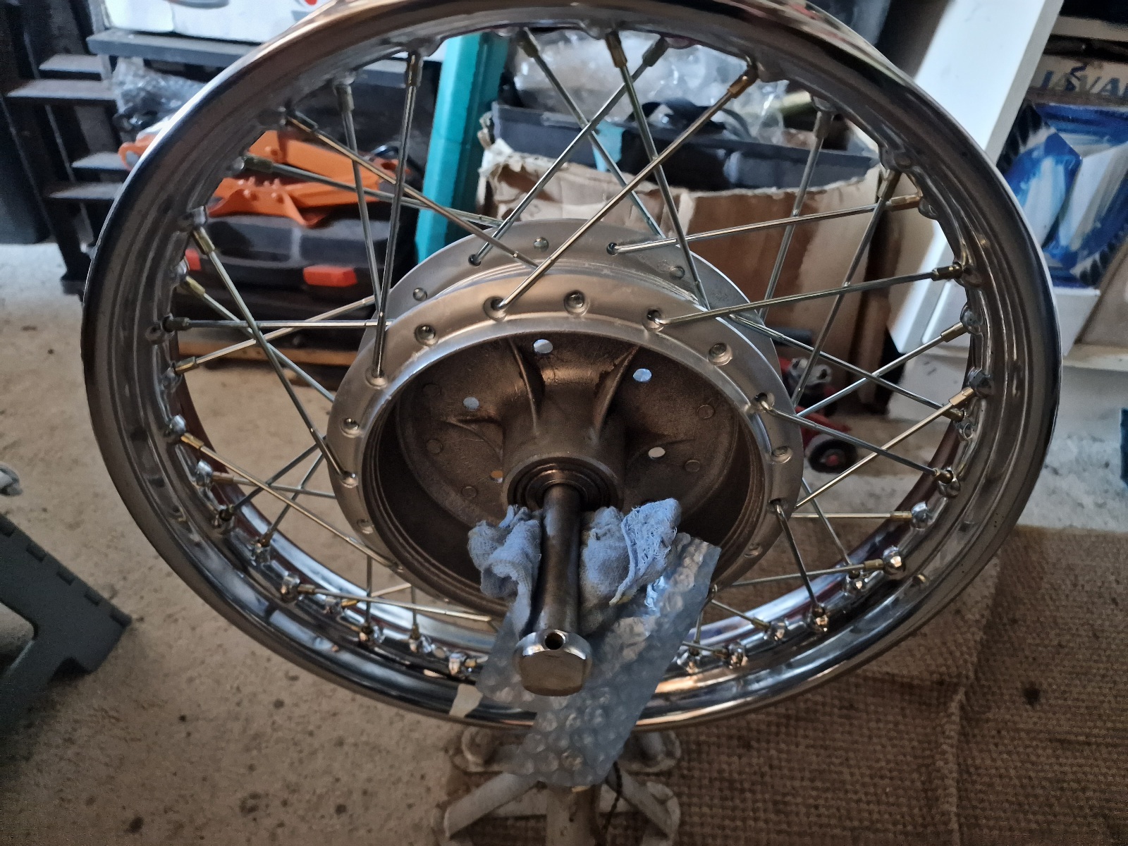

Next inserted the 10 outer as instructed, just entered enough on rim to start nipples a few turns, then flip over10 on other side, then 10 outers, flip again and last 10. When all in place correctly, tighten them so that just a bit of thread showing. Then measure between hub and rim to ensure same distance. It now looks like Phillippes photo.
Made up a jig using 2 axle stands and pivot using rear axle. Rotated and checked , its slightly out so needs truing.
Think that may be the tricky part? Any suggestions i know you loosen 1 side and tighten other, but how many at a time? 2, 3 or just 1?

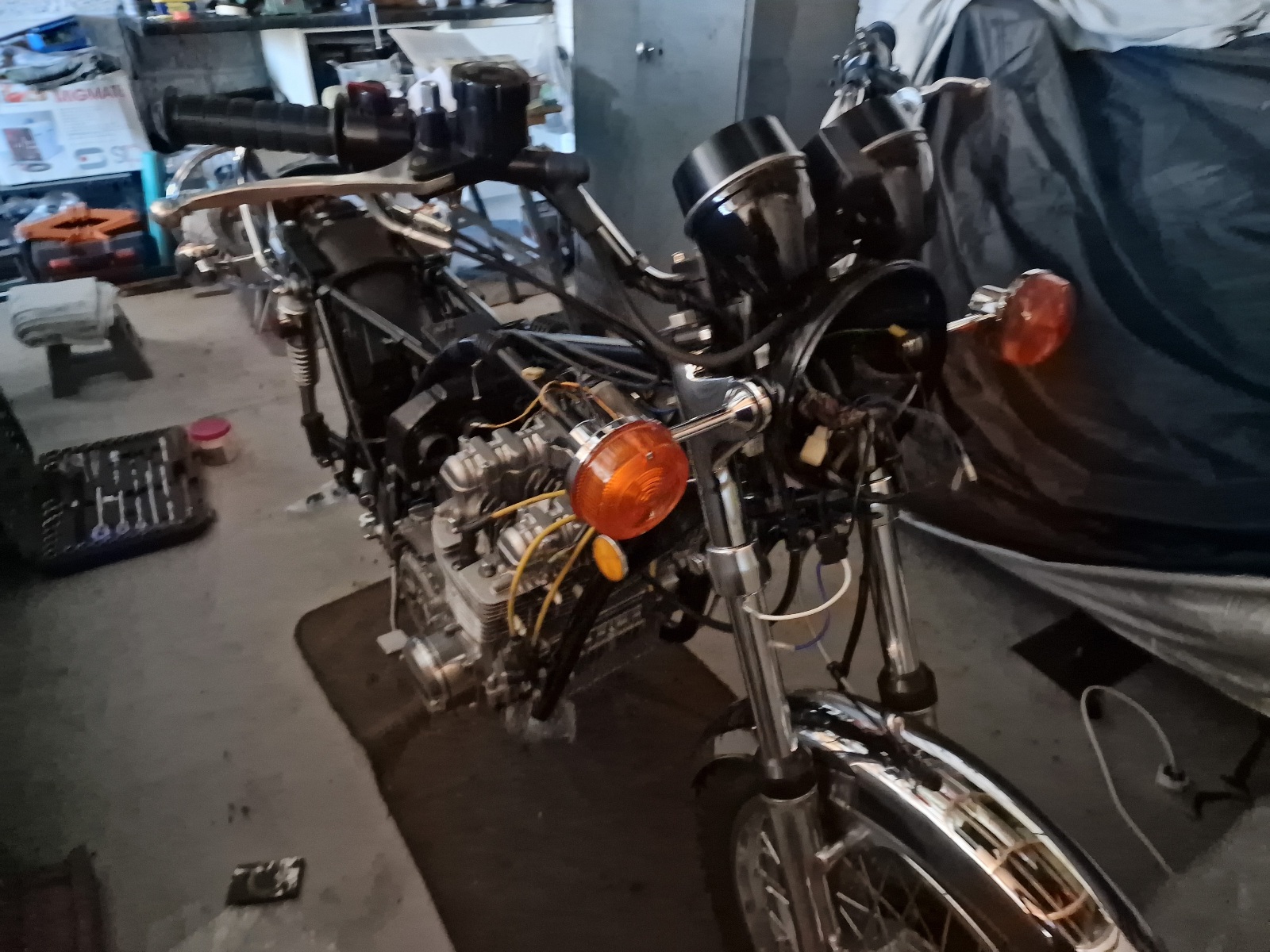

Heres a photo so far and another of bike so far.
