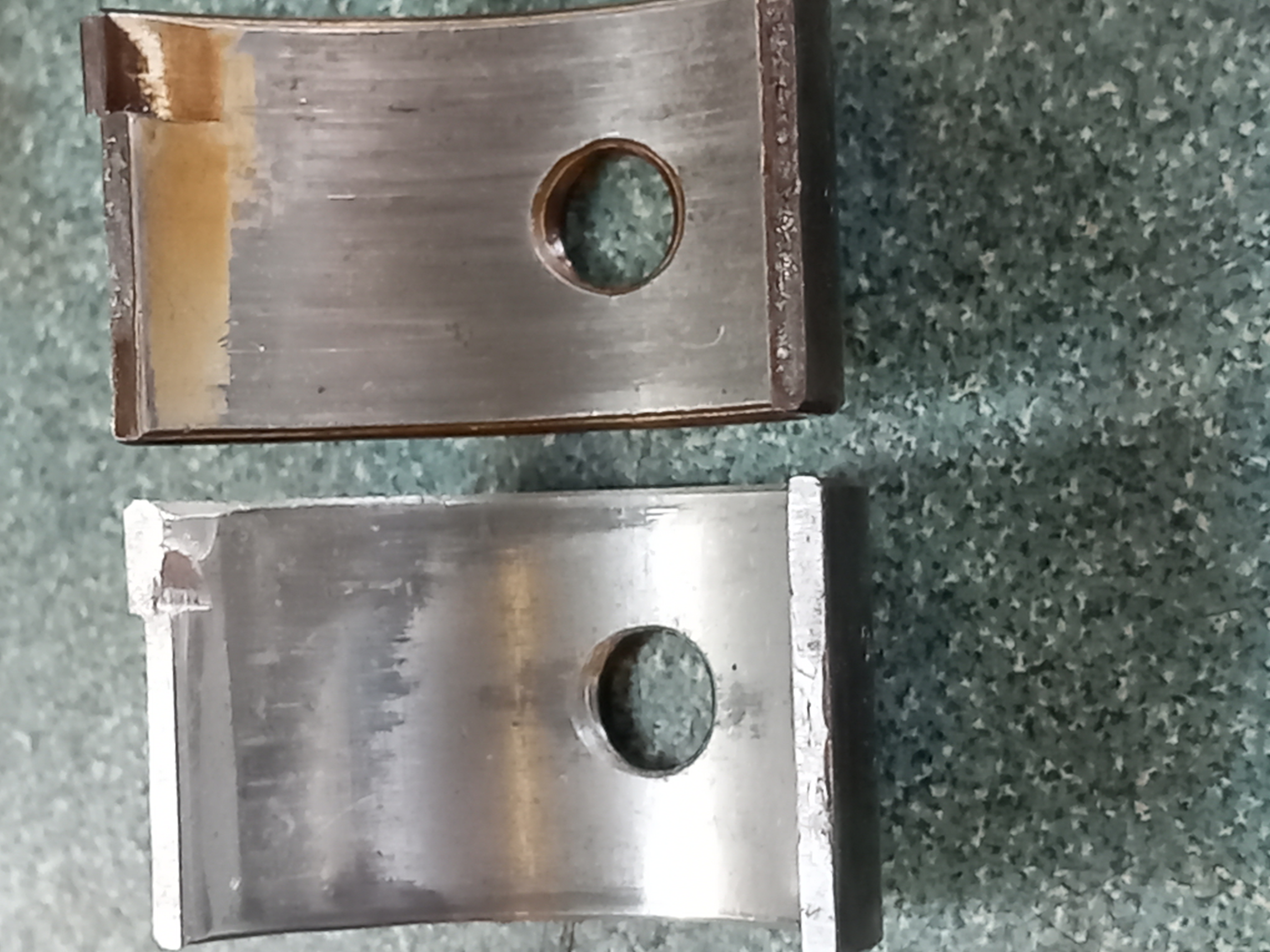

Has anyone got the size/ thickness of the camshaft shells ?

z1bman wrote:Has anyone got the size/ thickness of the camshaft shells ?
Are you looking for over all dimensions of a "shim on top" ?
Re: Camshaft shells
1.44 / 1.45 / 1.43mm at three locations on 3 seperate REPRO shells i have here.
I dont have any non-worn genuine ones.
Re: Camshaft shells
Al wrote:1.44 / 1.45 / 1.43mm at three locations on 3 seperate REPRO shells i have here.
Thanks al thats great its for a z250 but the cam has ruined the cam journals & i need to get some made up just needed a rough idea of the thickness to get the cylinder head & cam cover line bored
