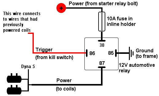

Have you checked the voltage to the coils? Low voltage will soot up plugs pretty quickly. As all four are the same all four carbs would need to have the same issue. If it were electical both coils and all four plugs would present the same symptoms.
If your only getting 10 - 11volts at the coil that would be enough yo soot the plugs.
Maybe time to fit a wired George relay mod to power the coils direct from the battery.

I did the 'George' relay mod some time ago, which initially seemed to help, but rich and sooty plugs remain.
