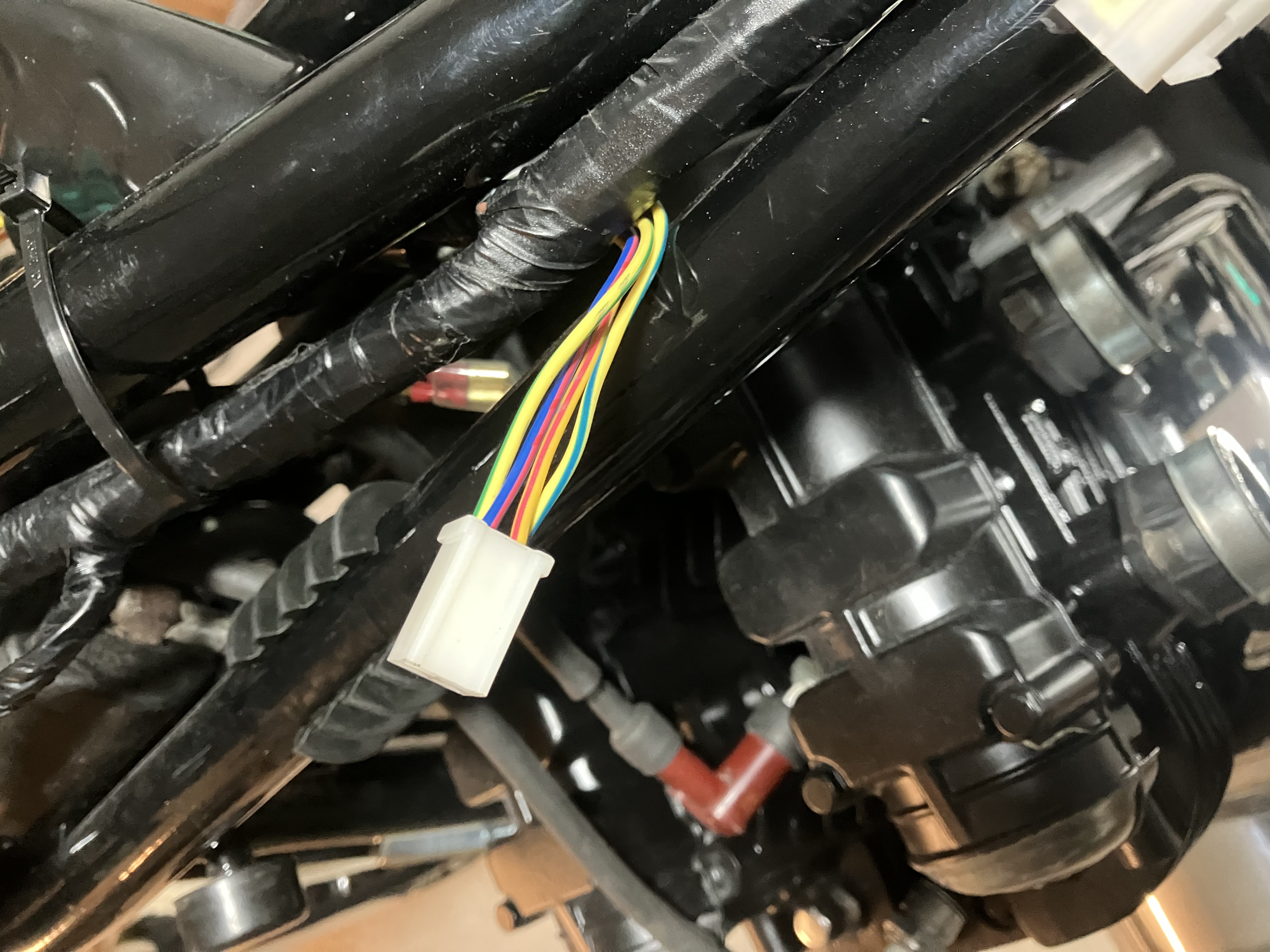

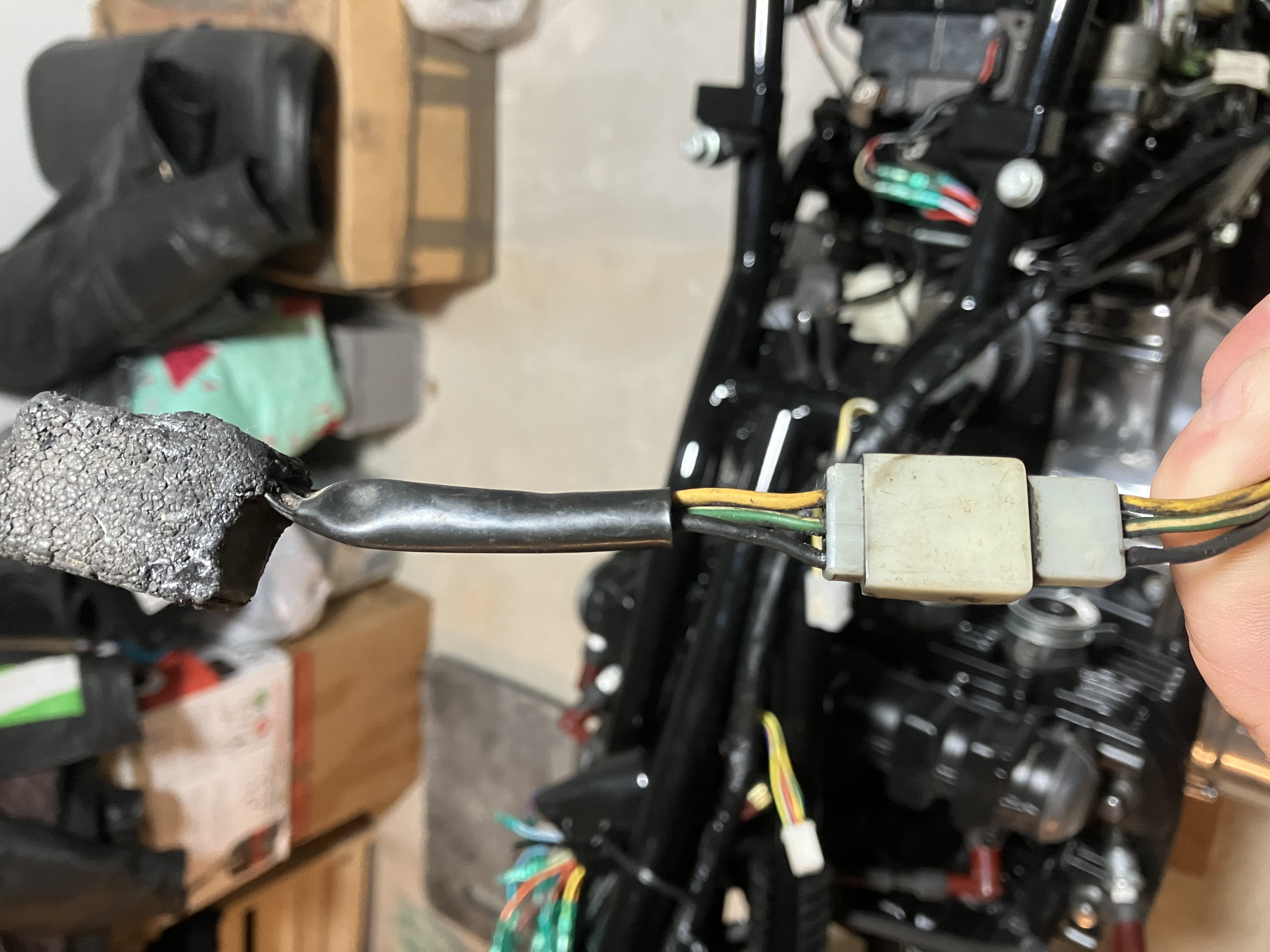

Hi guys. Have just fitted a new loom to my Z1R and have just about everything working accept for the front and rear lights. The new loom has not got anywhere to plug in,I’m guessing is a resistor of some sort pictured above? I’m not sure what it does or is called or if it needs to go back on? The other picture of the connector I’m also unsure what should plug/connect into? Any help would be greatly appreciated as I have spent many hours scratching my head… Cheers

the first picture: no idea (perhaps the connection of the reserve lighting relay of the US version, it switches the head beam on when the driving light wire is broken...)
the second picture is the stop lamp failure relay. It lets the red light flash in the dash board (rev counter or idiot lights) when the stop bulb wire is broken.

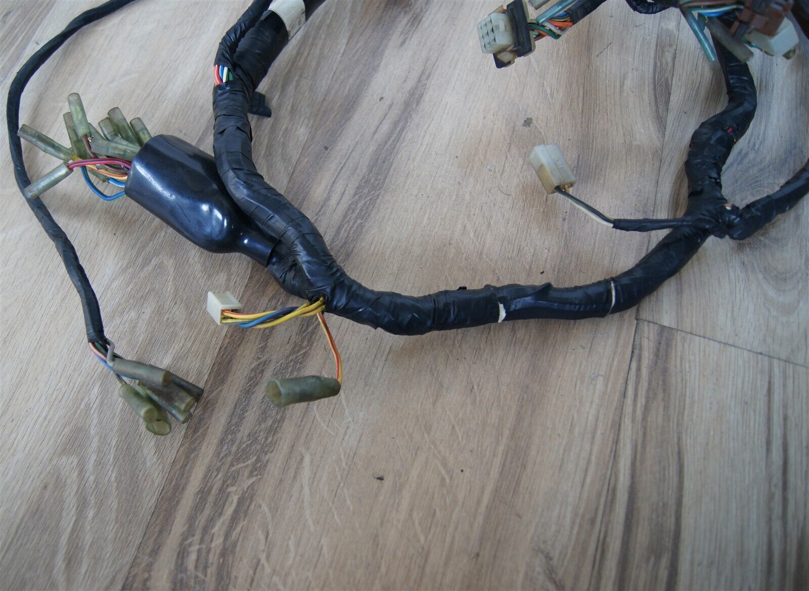

the new usa loom has to b altered to fit euro/uk bikes u will need your old blocks of the old loom and refit both wire diagram us and uk will help !!!!!

Philippe is right, the second pic is of the connection for the stop light failure switch. Has it got a switchy looking box hanging off one end? From memory it should be under the tank near the LH frame tube. I've had a look at the manual for the US versions and the spare 4-pin connector you have is for a resistor connected to the reserve lighting system - safe to ignore!
TTFN, Grog
Edit: just looked at the pic again - the foam covered bit at the top of the first pic is the failure switch - tuck it somewhere out of the way under the tank. I assume the end where your fingers are is connected to something already?
Edit edit; duh, assuming that's the bike in the background then unless you have the world's longest wires then it's not connected to anything! Somewhere on the main loom you should have three connections to go - black connects to black/yellow earth. Yellow connects to the blue/red which feeds the brake light switches. Green/white will connect to the same green/white that feeds the idiot light in the tacho. All this from the wiring diagram - not near the bike at the moment so can't give you a physical location for the connections, sorry.

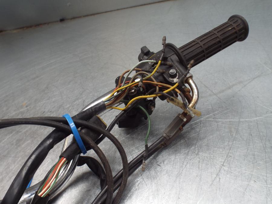

The switch gear left hand USA has 9 wires down the handle bars U.K. / euro has 7 German has 4 there are 3 part No to the switches now u have fitted a new loom USA ? So u need to check with a wire diagram ok

this is a gen usa loom u can see the block on your bike has different colours to original

this the gen usa switch wires 9 wires
