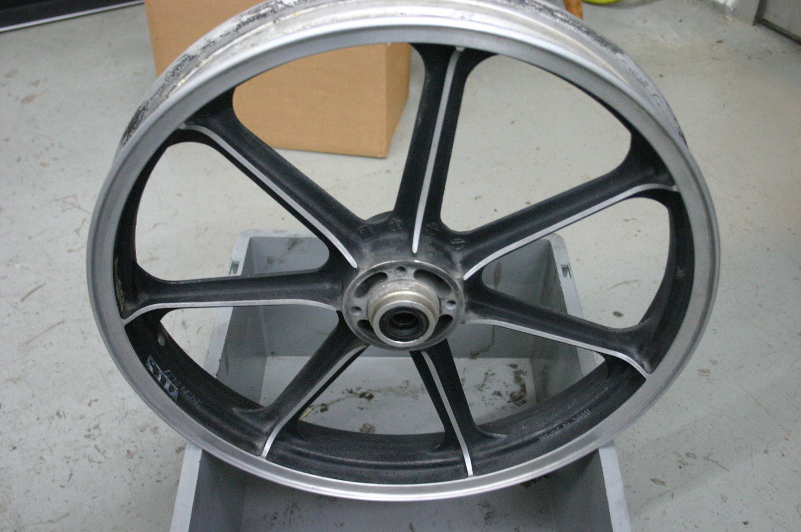

I have a pair of mag wheels removed from my 1977 Z1000 A1please see attached image

Hello James, the wheels which Kevin H has shown in the pictures are the ones you need.
