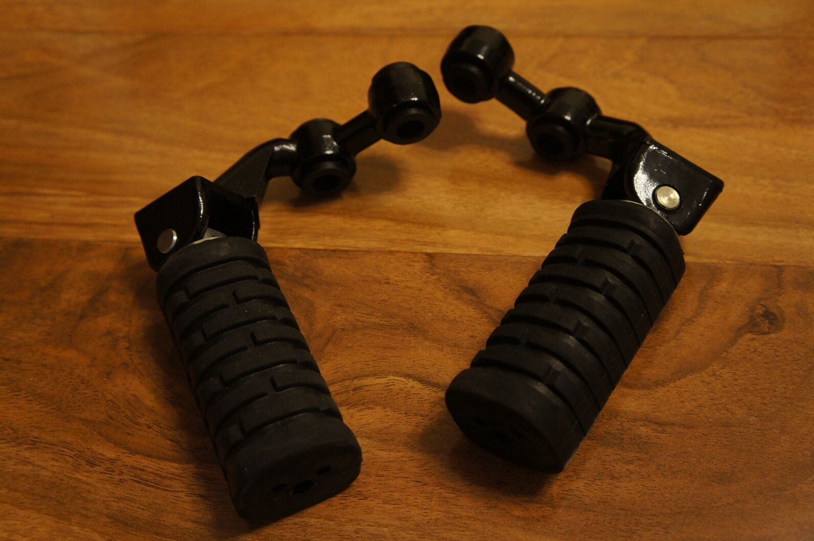

Hi,
Quick question, do the rider footrests for Z1000 A D etc fit all models including the ST.
Can't seem to find a simple answer on the net.
Cheers, Bert

The front footrest brackets (34003-036) are the same on the Z1a to Z1b, the Z900, Z1000 A1 to A4 and the Z1r D1 and D3 and all Ltd models to 1980 as far as i am aware.

The Z1000 shaft are different.
