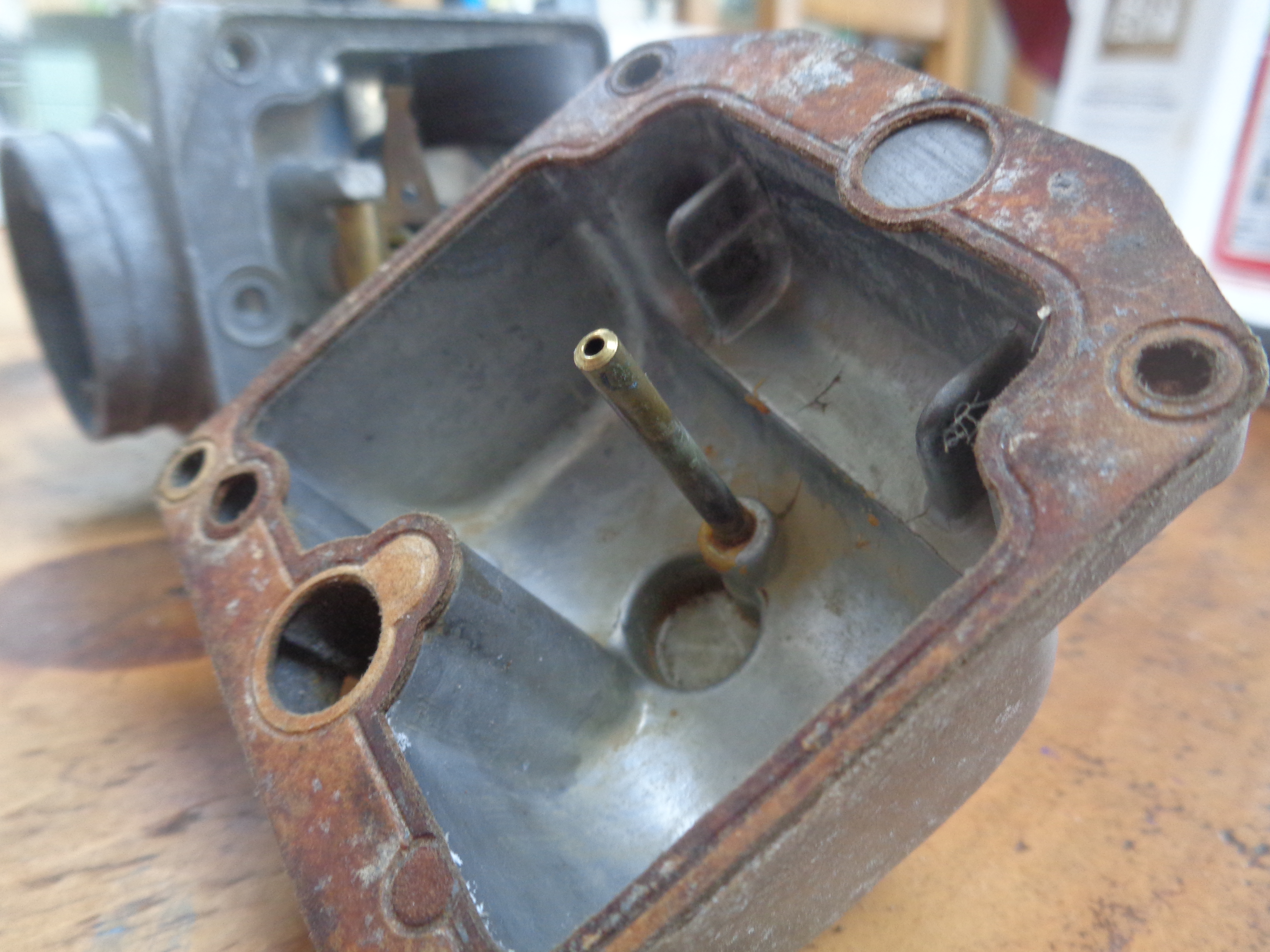

What i cant understand is even if i turn tap off fuel keeps pouring out of L/H carb overflow far more then in the pipe, how is this possible?
Its a new tank def no corrosion or sediment, brand new tap, new rubber hose and carbs all cleaned and checked, floats set statically on the bench, all close manually, other 3 carbs work fine. Could it be a faulty float? But why does fuel keep coming out even with tap off.

Another thought. With the bowl off fill it with fuel and see if level drops. If it does then the overflow tube has a crack.
Which means when the level drops from dumping fuel from the crack, it refills and then repeats again etc etc.

If the overflow tube is cracked split it can be replaced but it's easier to sleeve it on the outside with some bass tube then solder it in place. If you've got an radio control model shop near you they are a treasure trove for little odds and sods like brass tube, piano wire to make springs, small tins of enamel coloured paints for switches etc.

Cracked overflow tube
Float catching on Gasket or body
Re: Z900 A4 fuel leak any ideas please?
The cracked overflow pipe sounds bizarre but I experienced this issue some years ago on my Z1R. Not sure what causes it - maybe vibration / stress. In the end I acquired a new float bowl through Dave Marsden. (Although I also bought most of the carburettor that went with it.)
If it is a cracked pipe I reasoned that you would have to be careful that any adhesive for repair would not be soluble in petrol as I didn't want any of that going into the intricate carburettor workings. Hence I went for the 'complete replacement' option. That was back around 1990 and there may be better alternative options now.

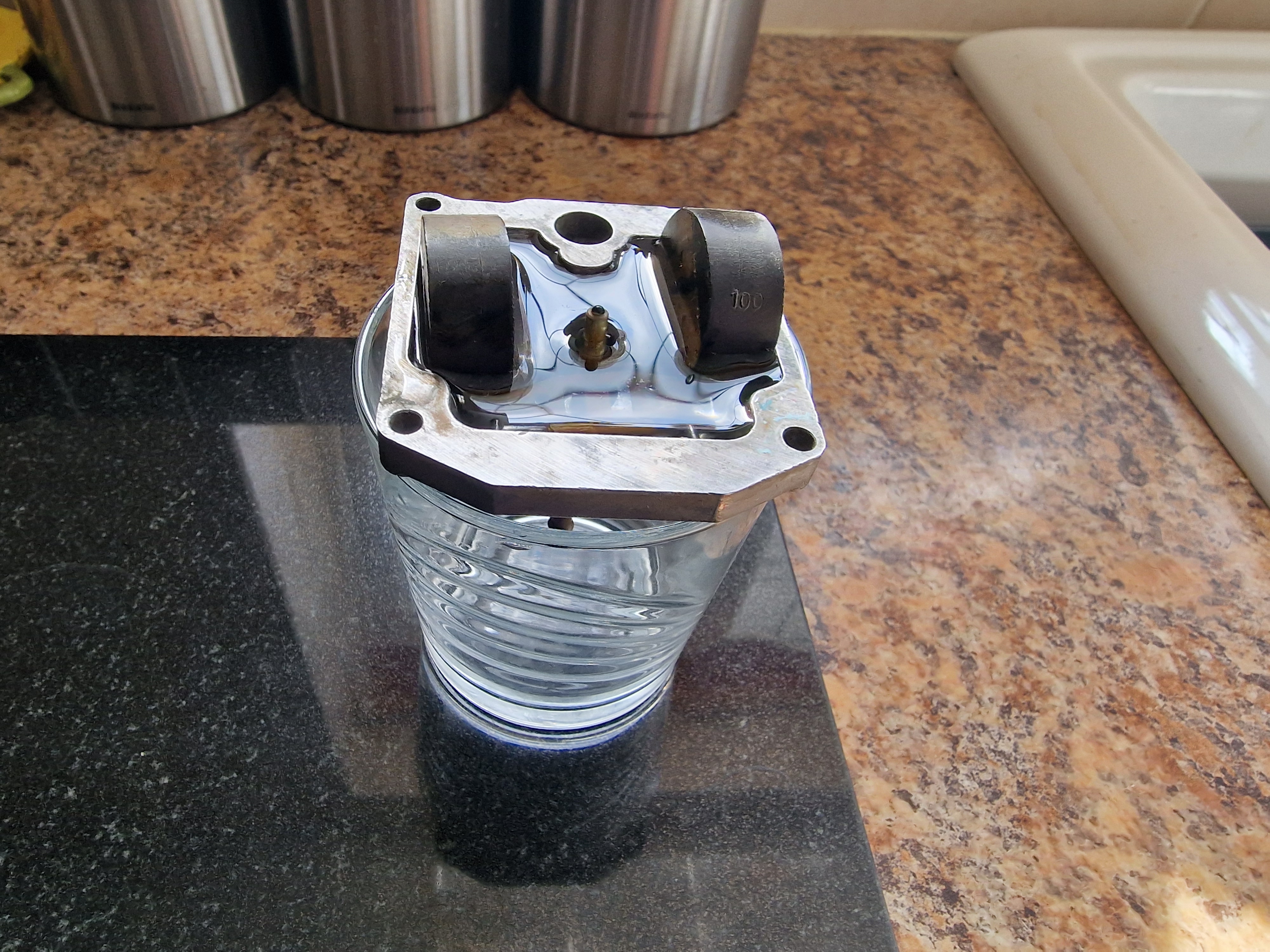

Next created a test for leaking overflow, glass with bowl on top the bowl filled with water and float on top, float does float which is good and no leaks so far into glass see photo not ideal but it works to test.
I read Zpowers suggestions to put a 2nd washer under float valve rather then bending tab so now done. Will leave test till after lunch see if any drips in glass, as fuel was pouring out of overflow got to assume if no drips tube intact with no split. As for float sticking think this may be most likely will check all surfaces as did fit new gasket set. Its also hardest to test as once bowl in place you cannot see if float catches! Have noted that the ones ive fitted not the best so may have to get new set although bowl to carb body not leaking at all. As for fuel flowing have left tank on blocks overnight with drip tray 7nder outlets, bone dry this morning so looks like new tap doesnt leak, perhaps the flow was what was left in pipe but seemed a lot, assumed once level dropped below drain height overflow would stop, but it didnt, maybe should have left it longer?

Using fuel instead of water will tell you more Graham. If there is a crack in the overflow it'll be full of fuel. Fuel and water don't mix so the fuel would effectively be a barrier to any leaking water.
As the overflow tube sits higher than the bowl surface you could try putting your finger over the outflow end and blowing down the inflow end. You'll feel if theres a leak as your cheeks will deflate
Oooh! Oooh! Liking Warren's idea to blow down the tube to check for leaks - but why stop there? Leave the bowl full of water/fuel as shown. Stick a bit of pipe over the inflow end to give your nose clearance from the fluid. Finger over outflow and blow. Bubbles in liquid? Deflated cheeks? Cracked pipe. I claim (partial) credit for the new-fangled 'fart-in-bath' diagnostic method!

Hi Guys, well yes tried the blow method down tubes already couldnt hear any leaks, the glass was to check if any cracks on overflow pipe, not ideal but it does its job. Best i could come up with on spare of moment and needs must!
