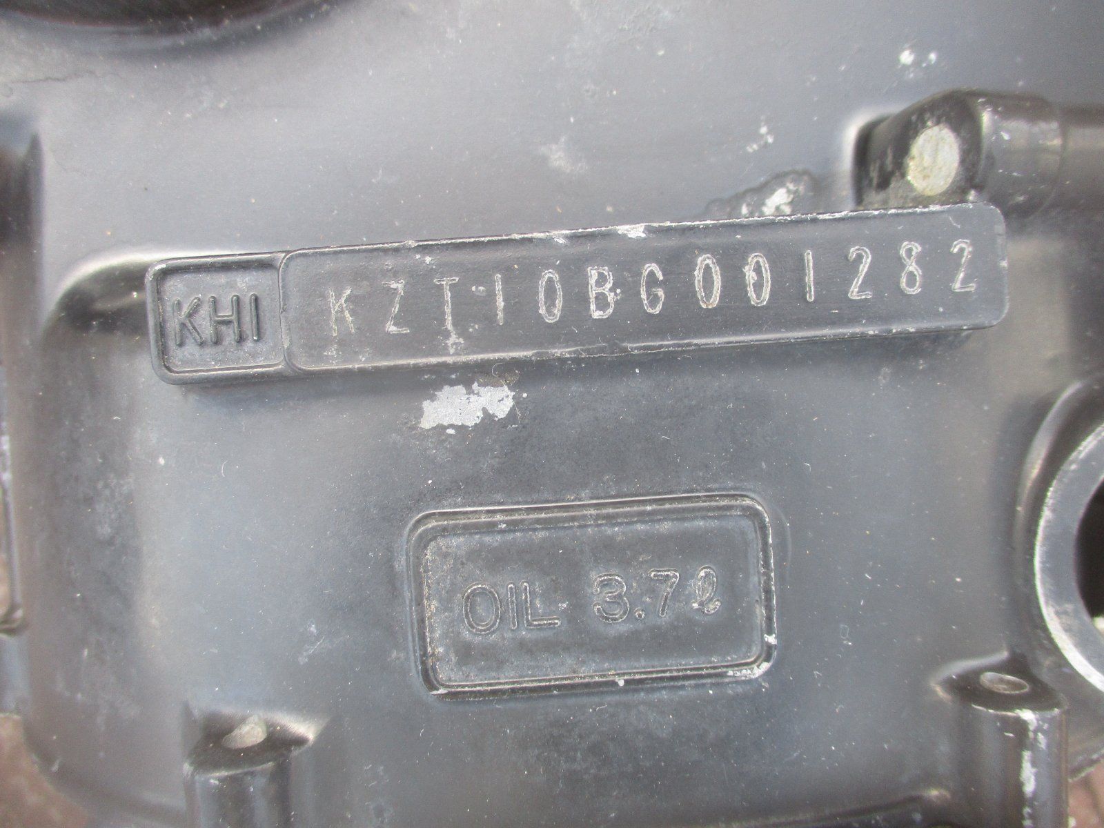

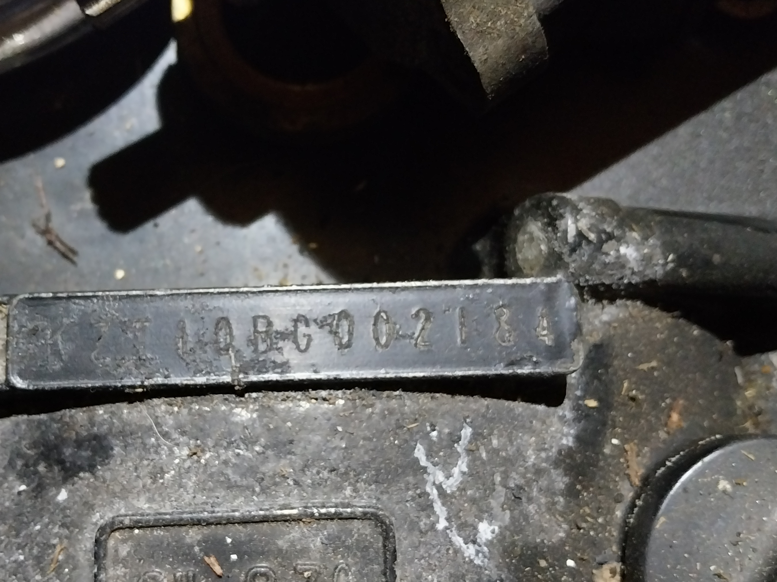

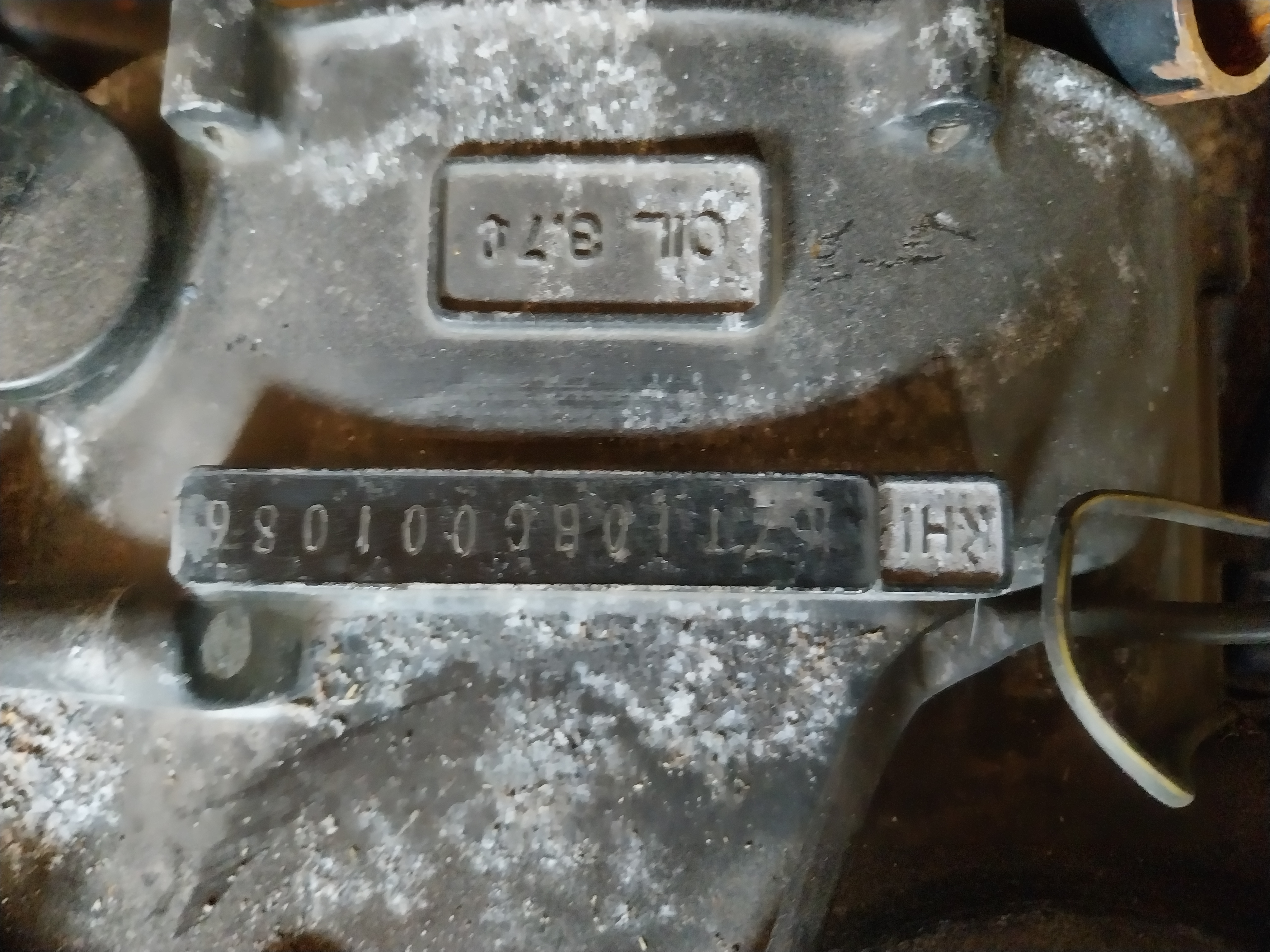

To anyone out there who might be the GPZ1100 guru, im trying to pin down what i have frame and engine wise in a job lot i bought pre covid and all i have is info from the states and all 3 of my frames are German. All im finding is the American KAZXBA1vDA000001 and on but all my frames and ownerships are KZT10A-00. Also 2 of the engines have the numbers KZT01BG. All im looking for is any info on the European numbers if any one out there is in the know, tanks in advance!

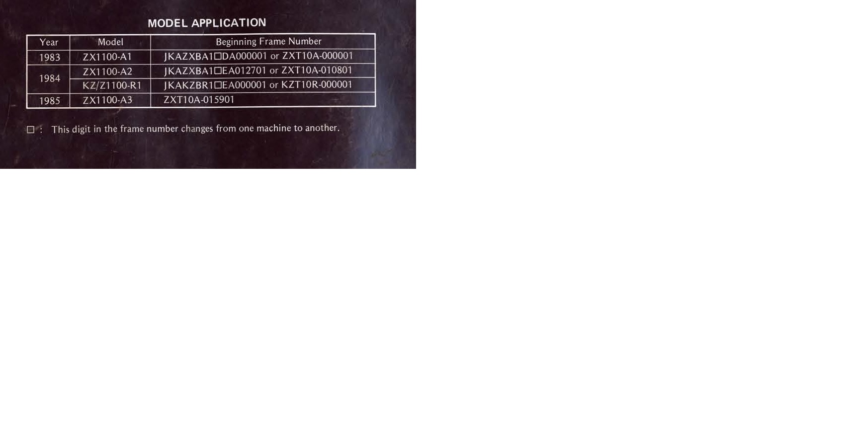

#2 PostAuthor: moizeau » Sat Mar 30, 2024 4:37 pm
I have this on the back of the supplement manual if it's any good?

#3 PostAuthor: Z1streetfighter71 » Sat Mar 30, 2024 6:10 pm
moizeau wrote:gpz.jpg
Thanks for that mate, i actually have that book. The thing is that while the frames are all ZXT01 the engines are split between KZT01BG and KZT01BE, there is little or nothing out there that is a bit more specific, plus i have two of the frames in the 85 region and would like to know what engine cases to hunt for for the 85 specifically.

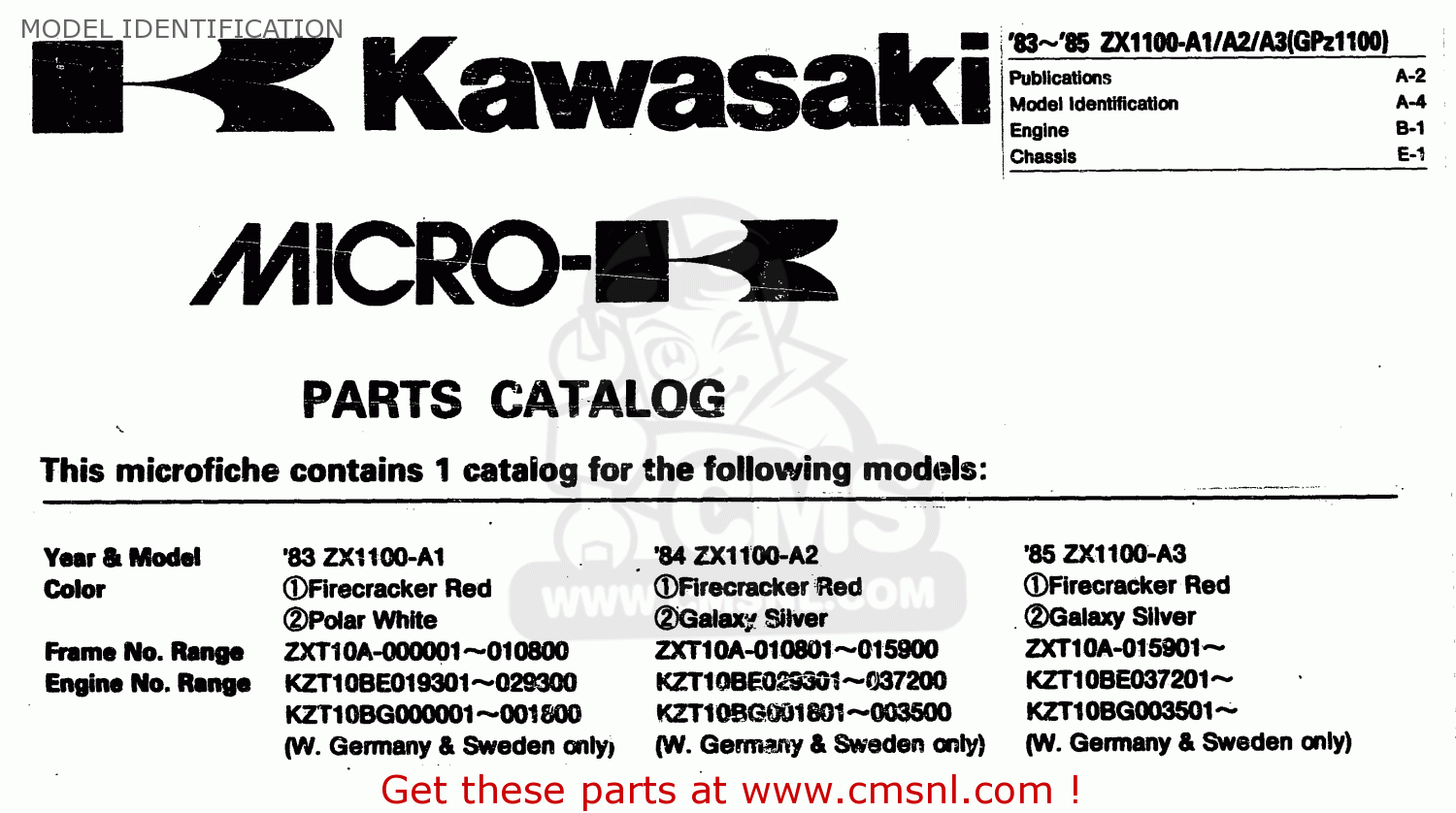

#4 PostAuthor: Mathh » Sat Mar 30, 2024 8:09 pm
Maybe this helps?
kawasaki-zx1100a3-1985-europe-uk-fr-gr-it-nr-st-model-identification_bigkae0576title_309b.gif
Last line is West Germany & Sweden, the line above is Uk, FR, Gr, It, Nr, St.

#5 PostAuthor: Z1streetfighter71 » Sat Mar 30, 2024 8:49 pm
Mathh wrote:Maybe this helps?
Yes sir! this is a great help. Ill give this a good look.

#6 PostAuthor: Z1streetfighter71 » Sat Mar 30, 2024 9:01 pm
That puts one of them in the late 1983 and the other in early-ish 1984. Thanks for that again, would not have know those engines were in such low numbers.

#7 PostAuthor: Gus » Sat Mar 30, 2024 9:41 pm
I see on the first picture you have the separate prefix KHI. I have that on one of my engines which I hadn't seen before

#8 PostAuthor: Z1streetfighter71 » Sat Mar 30, 2024 9:53 pm
Gus wrote:I see on the first picture you have the separate prefix KHI. I have that on one of my engines which I hadn't seen before
Gus
Both the German engines have it and this one too i was looking at. Must be unique to that casting.
