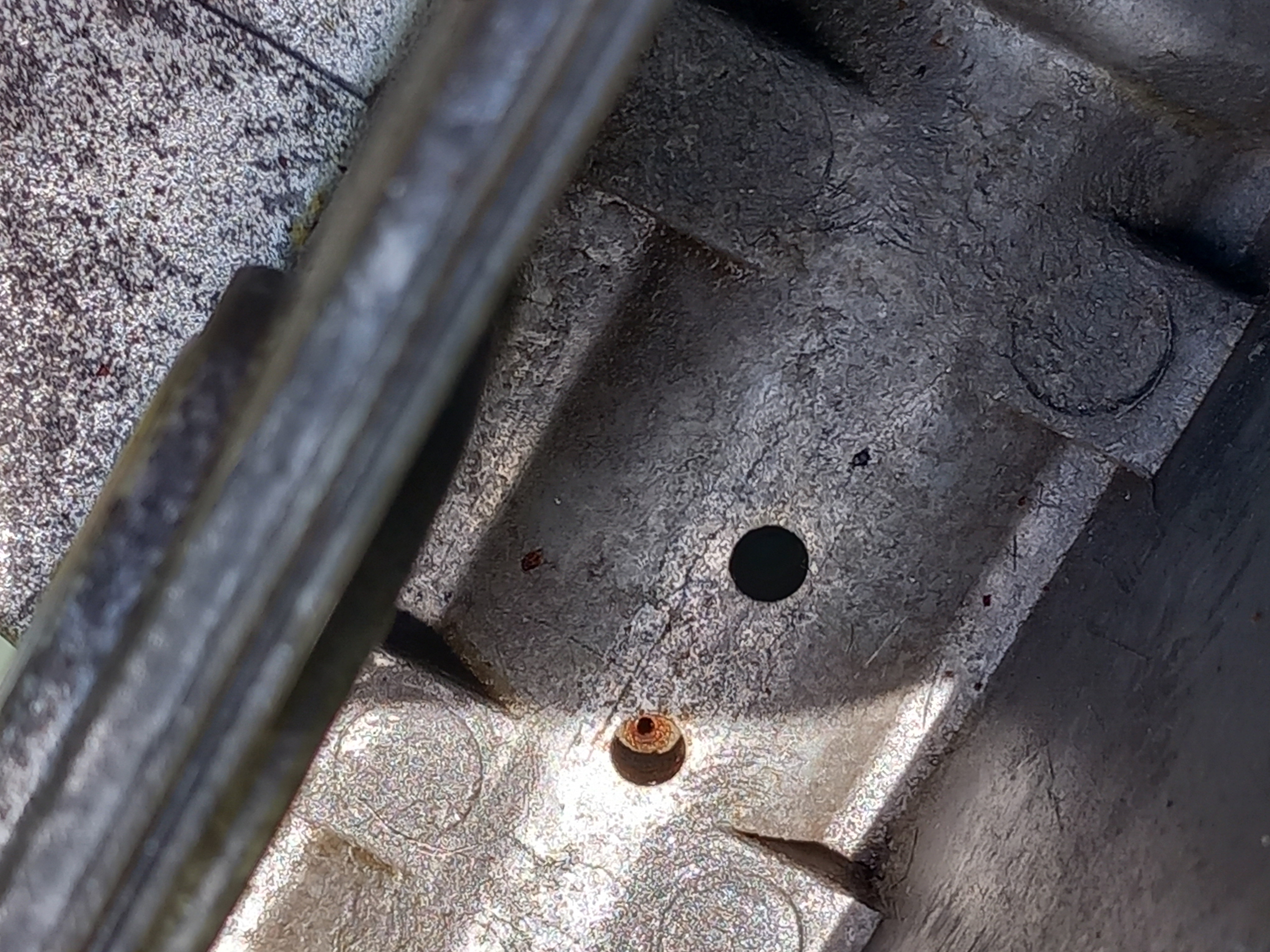

Tried again today, no fun. When the lever is pumped a small stream of bubbles come out the hole nearest the lever, RHS one on this photo.

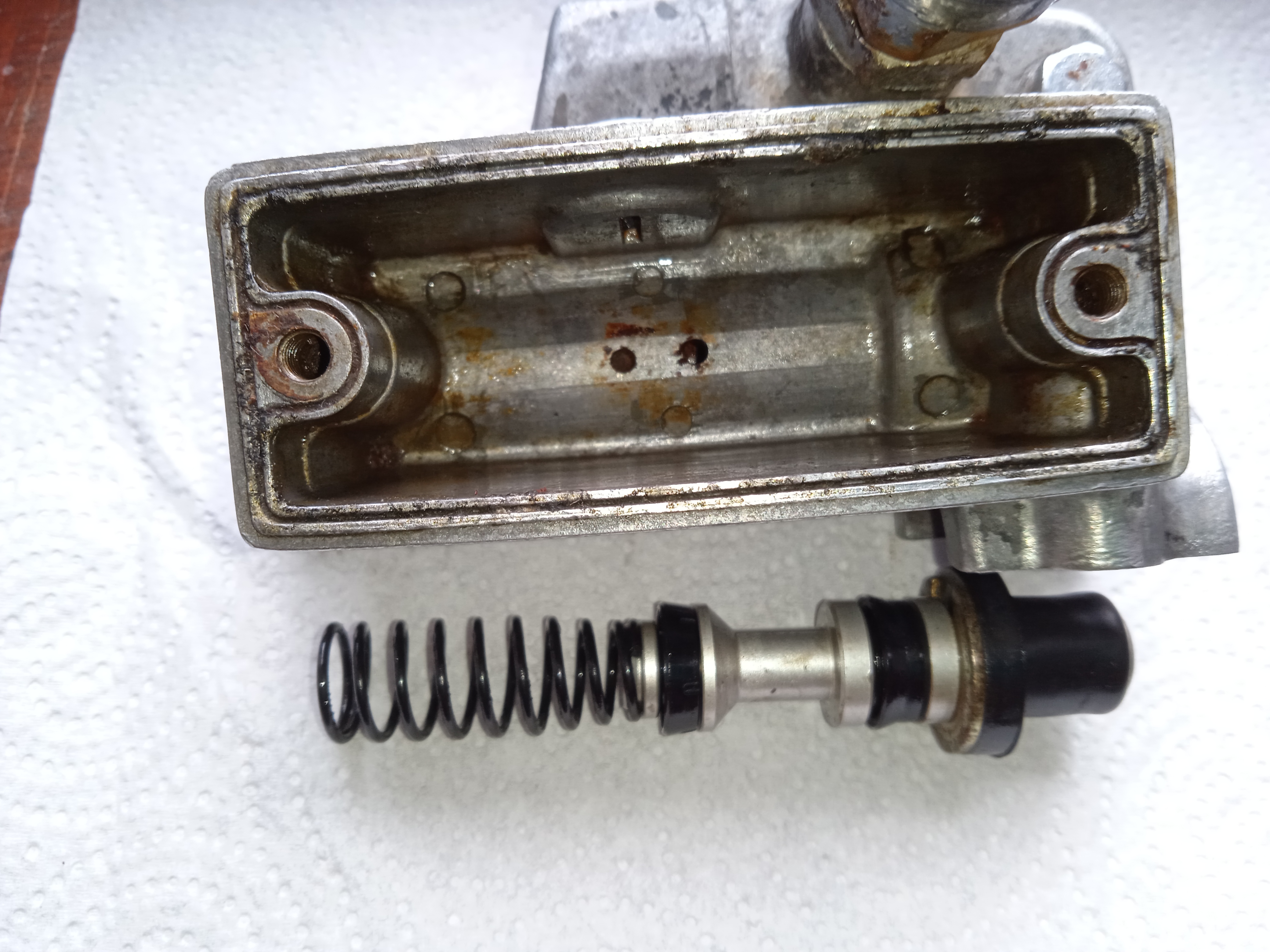

Tried a reverse bleed from bleed nipple back up to the master cylinder. Long bit of clear tube full of brake fluid with my gob on the end. I could get some in then no more. Tried a pop bottle as a squeezy, not much better. Stripped the lot down to check the hoses and splitter for blockages, fine.Blew through each caliper, fine. Then tried the master cylinder, can't blow in reverse (lever not pulled in). Stripped it. The piston and seals still look like new, no leaks, air or fluid. The hole on the rhs is clear the lhs one seems solid. I remember someone, possibly Philippe, mentioning a microscopic return hole? Would that be the 'blocked/solid one on the left? Also as seen in the photo the piston is placed pretty much where it would be when together. The front seal sitting between the 2 'holes'. So that would suggest all brake pressure is applied from the rear seal near the lever.
After cleaning the MC up, did a tongue test. Press the piston forces air out, release the piston and tries to suck your tongue inside. This is with no cover or seal on the MC.
So, should the lhs 'hole' have a hole, if so, how small is it?

Thanks Warren, done all the juggling of the splitter. Is that return hole the lhs one on my photo? Got an idea that my me the problem. The piston forces the fluid down but then sucks it back. It is impossible to get a reverse bleed, The MC won't accept anything in the wrong direction
Re: Front brake problem
I have one here the same as yours but from the J. It has a microscopic hole in the LHS as viewed in youre picture. The hole looks rusty in the bottom suggesting it has a steel ferrule in it but is probably the exposed top of the steel sleeve,.. but definately a hole. Perhaps 1/4mm in diameter or so!!

Pull a bristle from a wire brush and have a probe to ensure the holes in the mc are clear. You obviously need to be able to relief back into the mc or the brakes would stick on.

If you zoom right close on your picture there is a different coloured area central on the LH hole. Looks like it's rusted up. Get probing!
Yep, I thought that but my eyes are shite. Without the hole on the lhs there would be no way to reverse bleed, It was defying logic. Off to find a needle
Excellent, thanks chaps, pin got in then a cheap jet file has cleaned it up

I'm glad you solved your brake problem. The diameter of the small LHS hole is 0.35 mm. I use a small drilbit from my modeling tools.
If you want to be sure that your brakes don't tighten up, you have to use the correct brake lever! Most of the pattern new ones have the correct part number but the part that pushes on the master cylinder is a bit too long. That prevents the master cylinder to return fully. If you have that problem you should file a bit of aluminium off the lever. Not too much, a bit at a time. Good luck with it.
