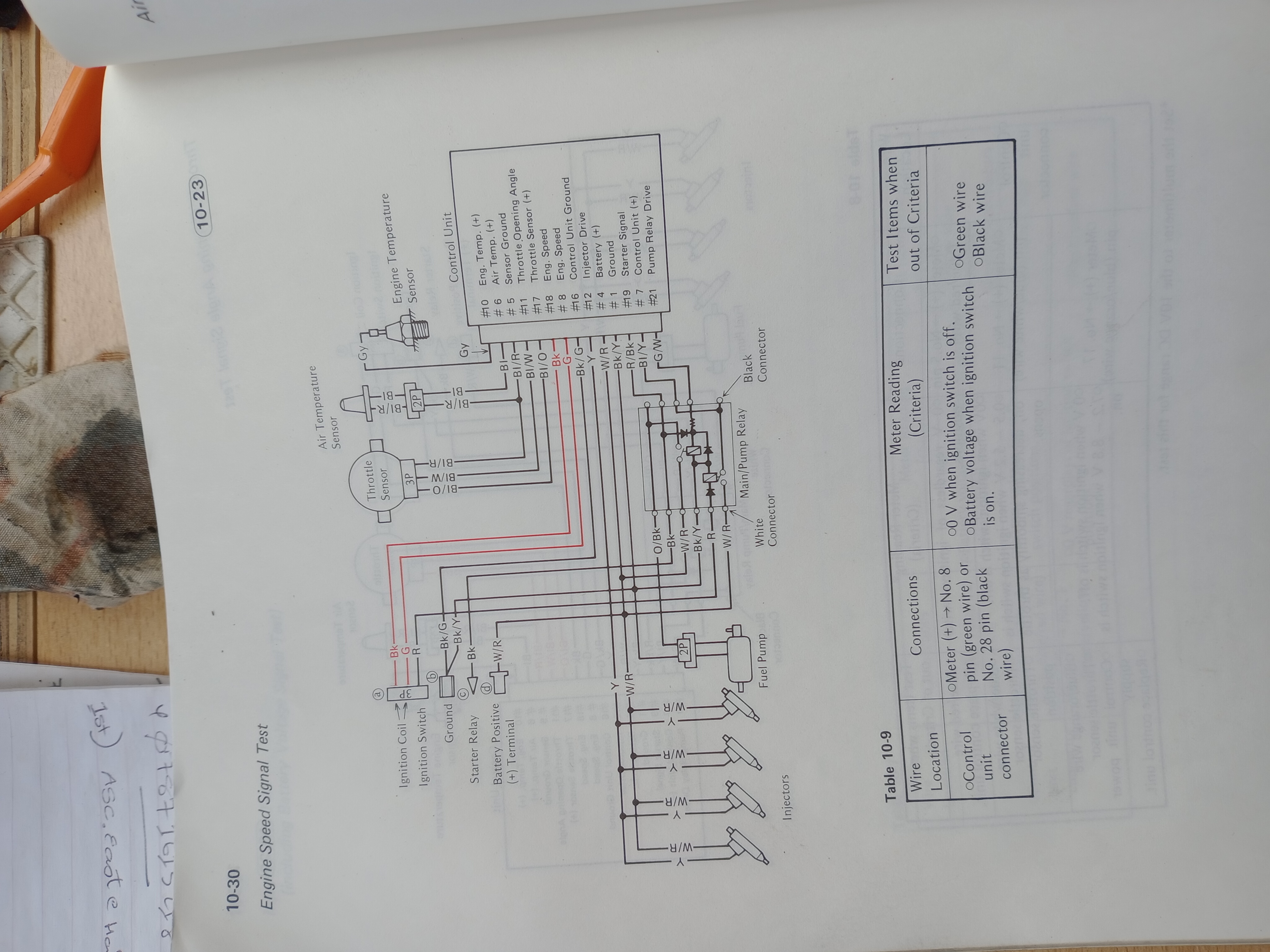

I looked at the green light on the DFi box and the DFi trouble code was number 23, which is... perform "engine speed signal test" (base manual p10-30), and inspect ignition system damage.
I did the Engine speed signal test first thing and it was 0v when ignition was off and 12.78v with ignition on. I decided to do it again later and it was 0v with the ignition off however it was only 0.9v with the ignition on.
Any clues what this means and what to do next to try to rectify it?

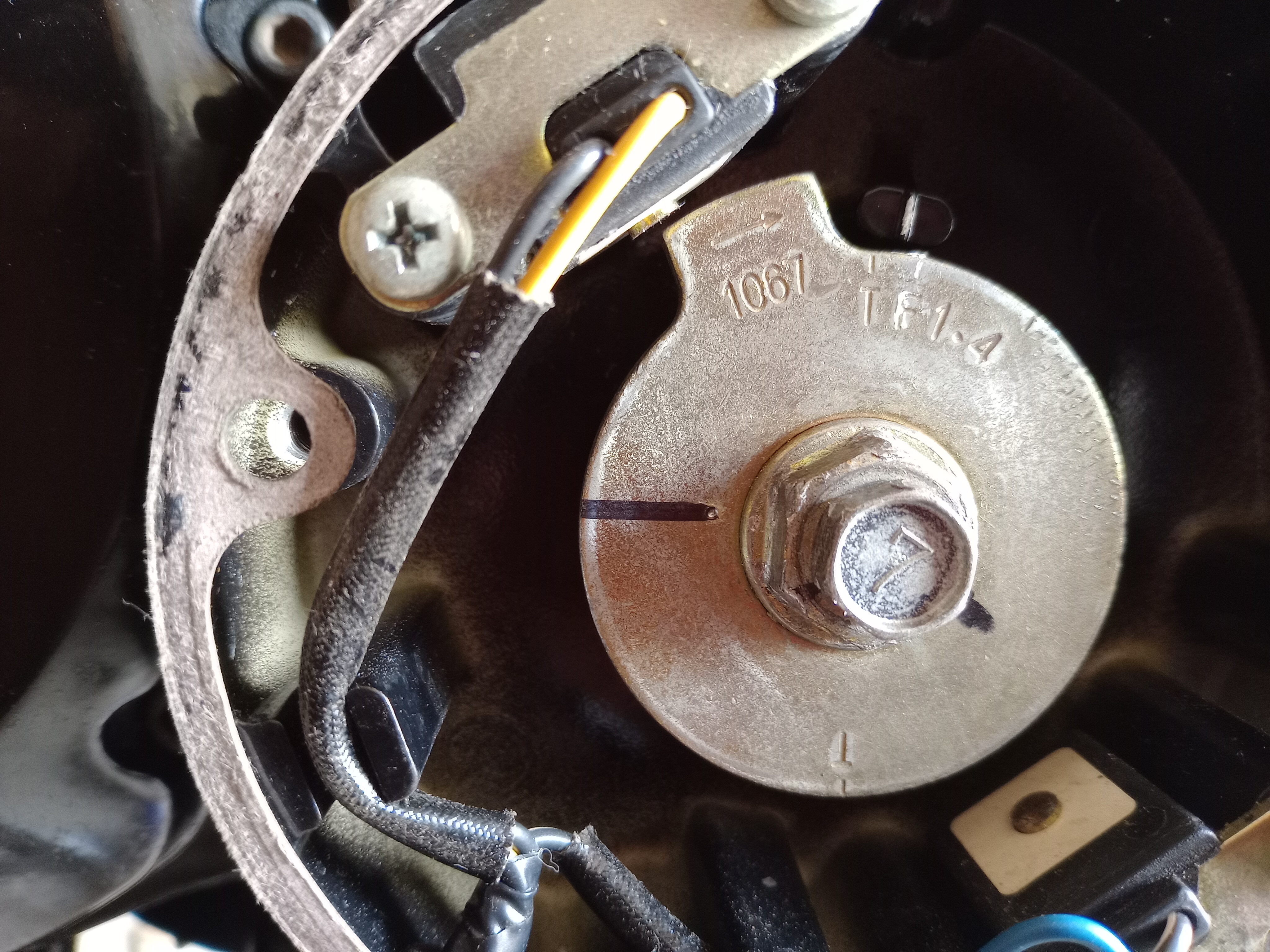

i wondered whether I had been a fool and accidentally altered the timing (you have to remove the camchain tensioner cap to do the starter). I put on my strobe light and the timing was out, my strobe has a dwell angle thingy and I reckon it might be 4°out.
So I wanted to try to adjust the timing, which is normally easy but i'm well in the learning stage with the GPz 1100.

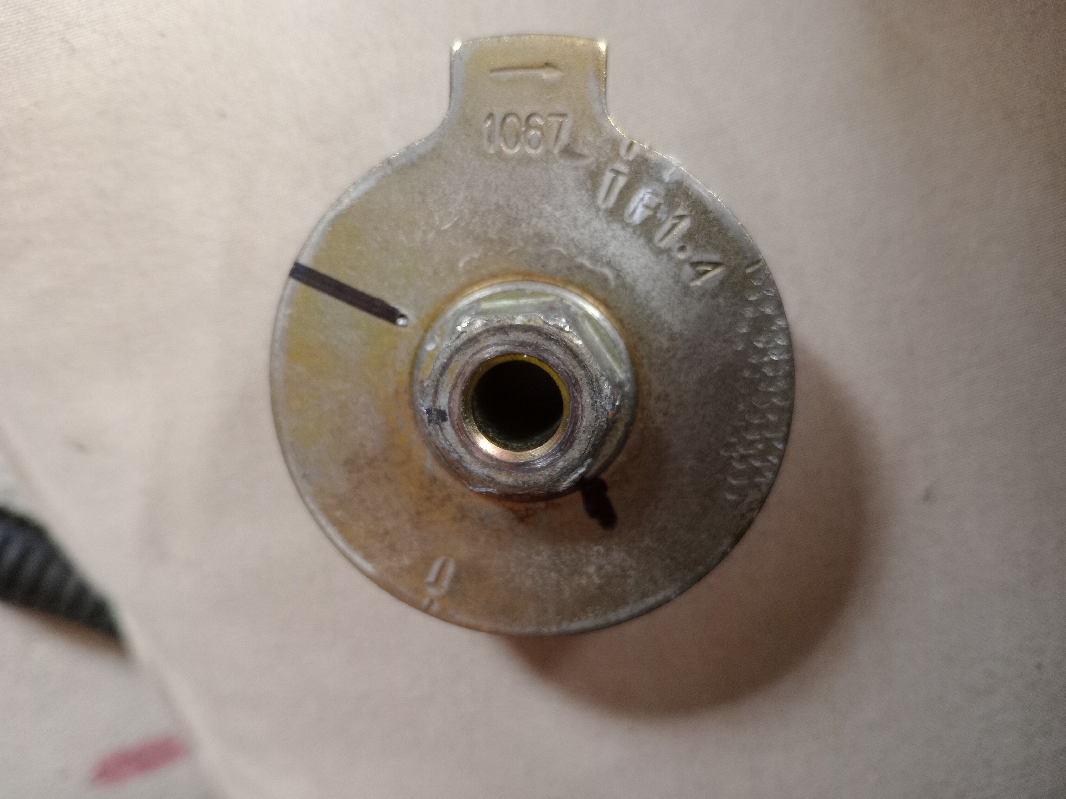

I can remove the 12mm bolt and the advancer pulls away from the pin behind, this leaves the 17mm rotation nut on the advancer itself.
I would assume that I have to remove the 17mm rotation nut so I can move/rotate the timing plate? If it is a yes, how do I do it?
