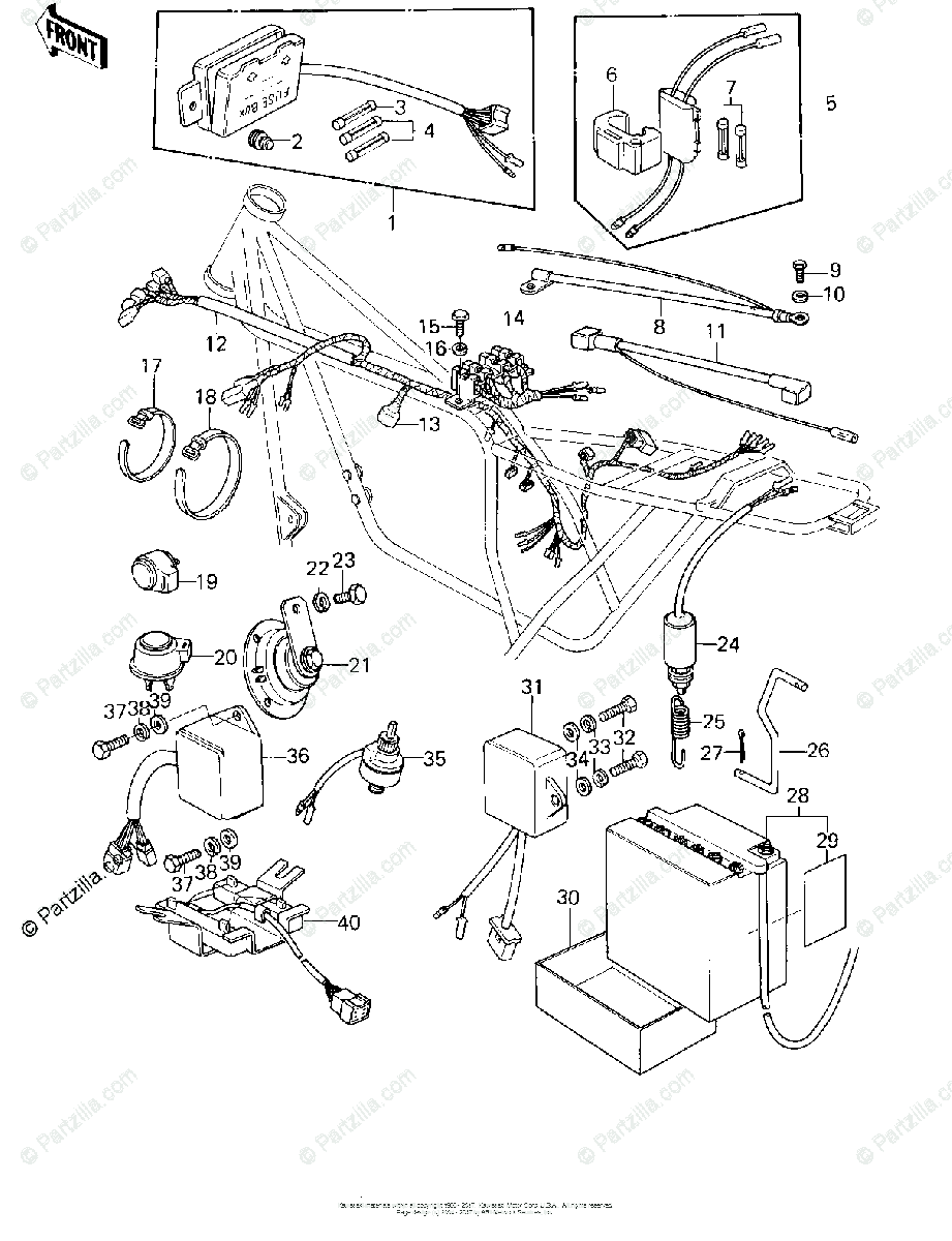

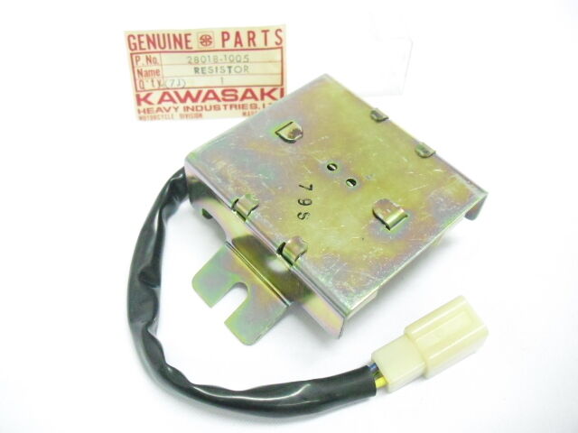

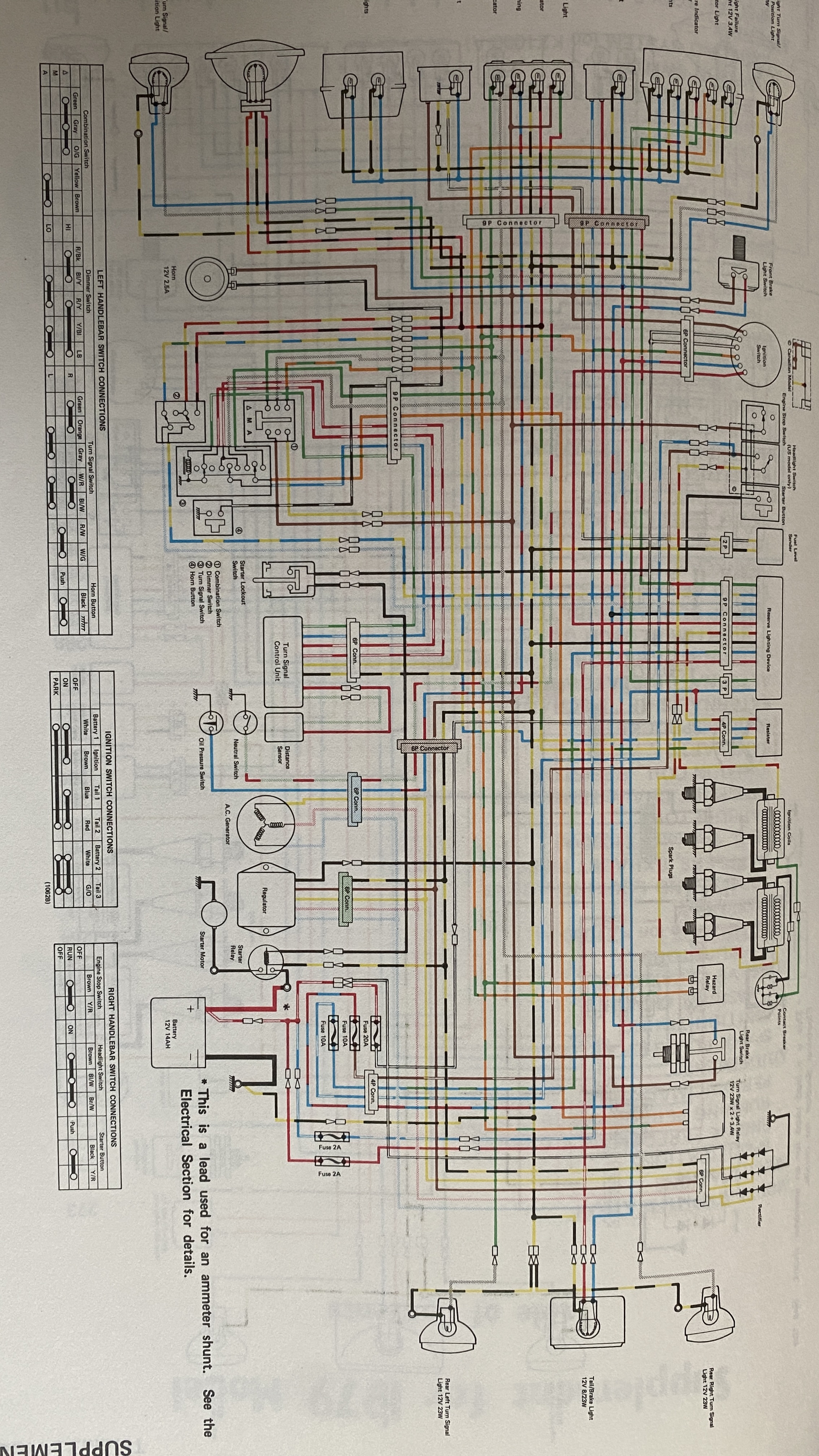

So Im trying to return my Z1rs wiring back to stock, the P.O had grafted in a bunch of new bits and chopped the loom/harness up a bit, so a new loom is in but i want it fairly factory stock, while the old loom is being fixed up ready to go back in i want to return the bike back to the original rectifier/ regulator anything else that was lost on the way. Problem is im woring with dodgy internet loom diagrams. Have a few you tube vids of Z1r restoration but main bit that puzzles me is this resistor. NO.40. and eher it is located, below the battery box? Also if anyone has a good scan of a D1 wiring diagram it would real appreciated.

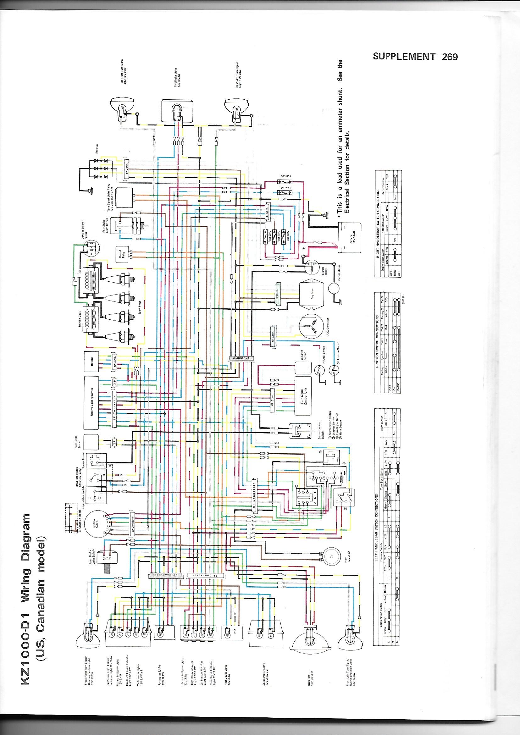

Im pretty sure you sussed its either a stateside or canadian model and thats all part of the reserve lighting circuit does this help

KeithZ1R wrote:Im pretty sure you sussed its either a stateside or canadian model and thats all part of the reserve lighting circuit does this help

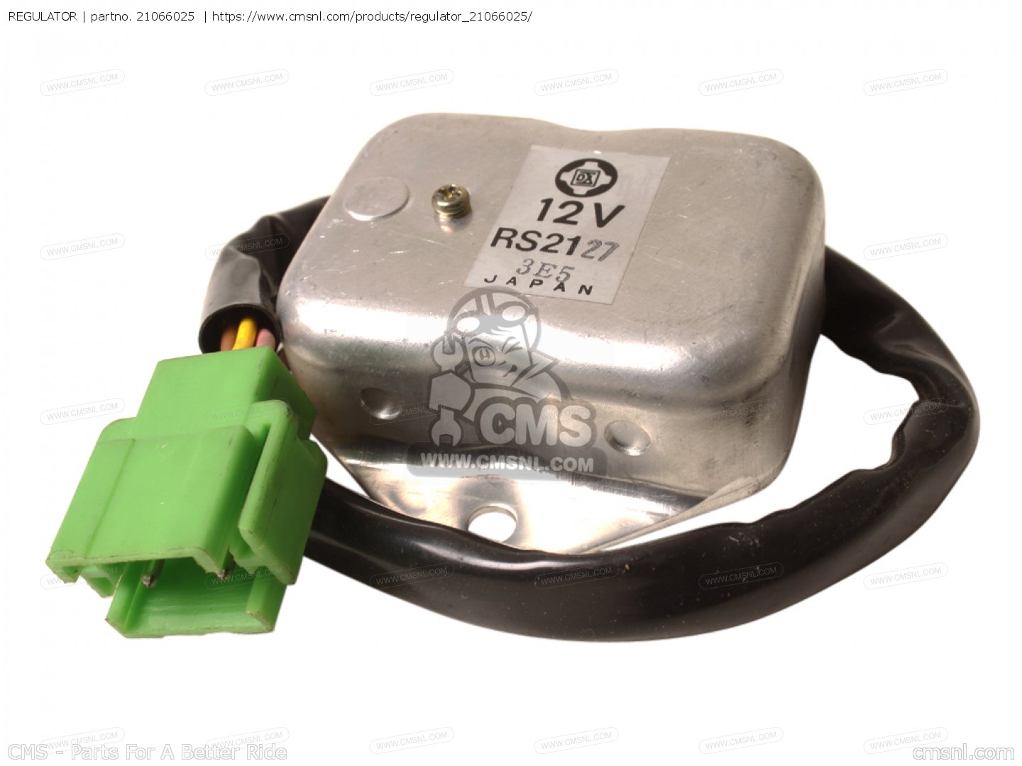

Thanks for that Keith, its way more readable than the one i have, i read into it and its not that inportant right now and by the frame numbers its a Euro bike. Another question that i have you Is the lead wires on the REGULATOR
21066-025 longer on the Z1r? the one i have doesnt seem to reach.

Yea must be something im doing wrong or it might be a Z1 one, either way i can dig out a z1000 one from one of the many boxs stored away.

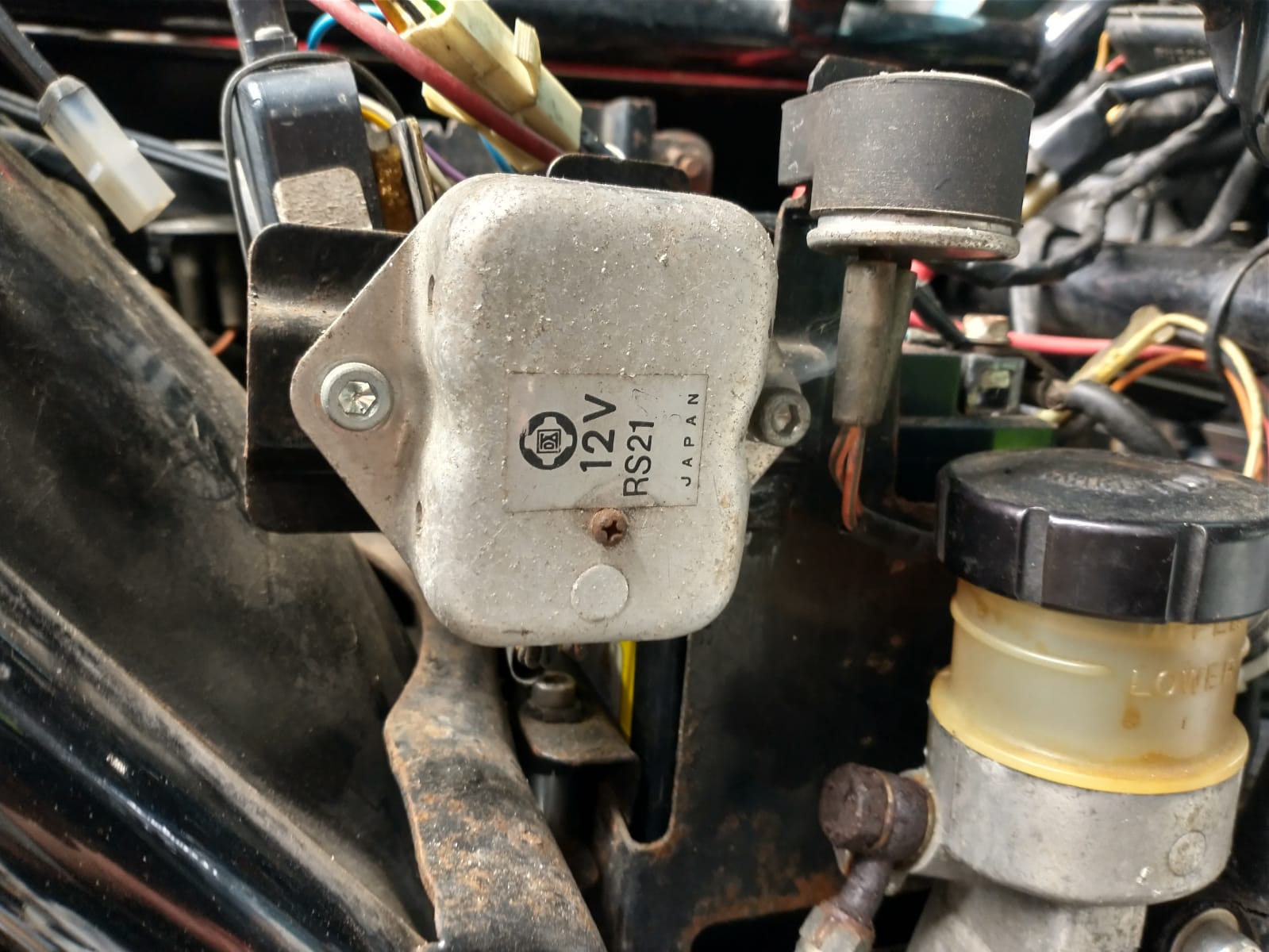

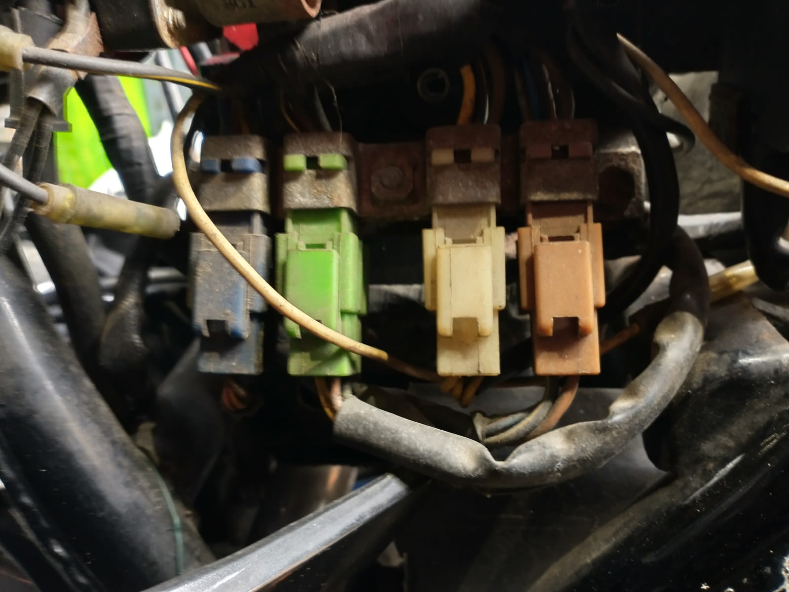

Hello mate: just been out and run a bit of string round the wiring on mine to get a decent idea of length. It told me two things:
1. The length of the wire from exiting the green plug to entering the regulator is 375mm give or take a few mm.
2. I now know how long a piece of string is.
I've attached a couple of pics, don't know if they'll help. The wiring on mine runs from the green plug, round the back of the battery and into the reg from below.

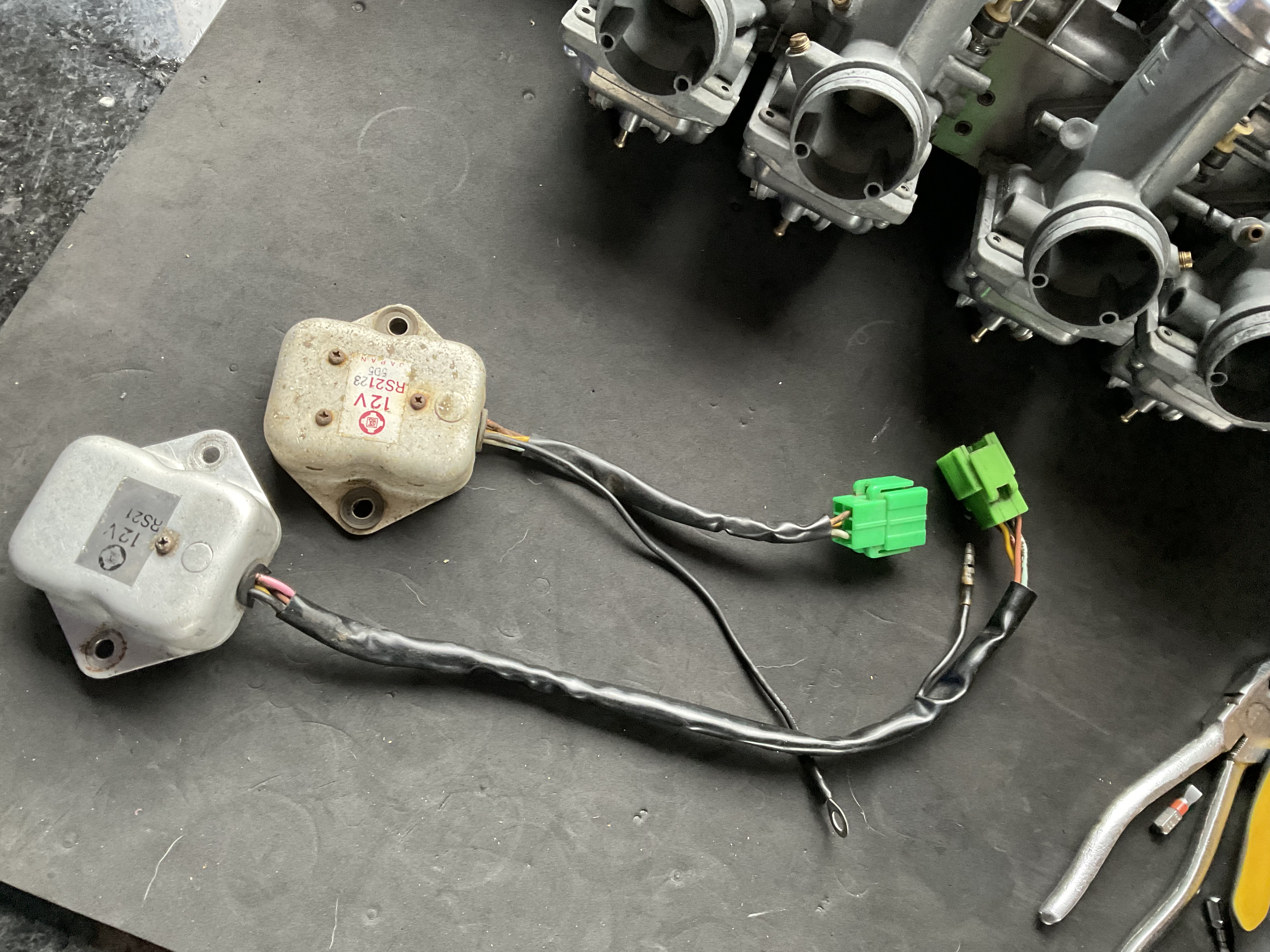

Complete day one rookie mistake on my behalf. Kinda was hoping no one would notice… looks like a Z1 one got mixed in with my Z1r box and I just picked the first one. Here is the two of them side-by-side. I am living with my shame.
