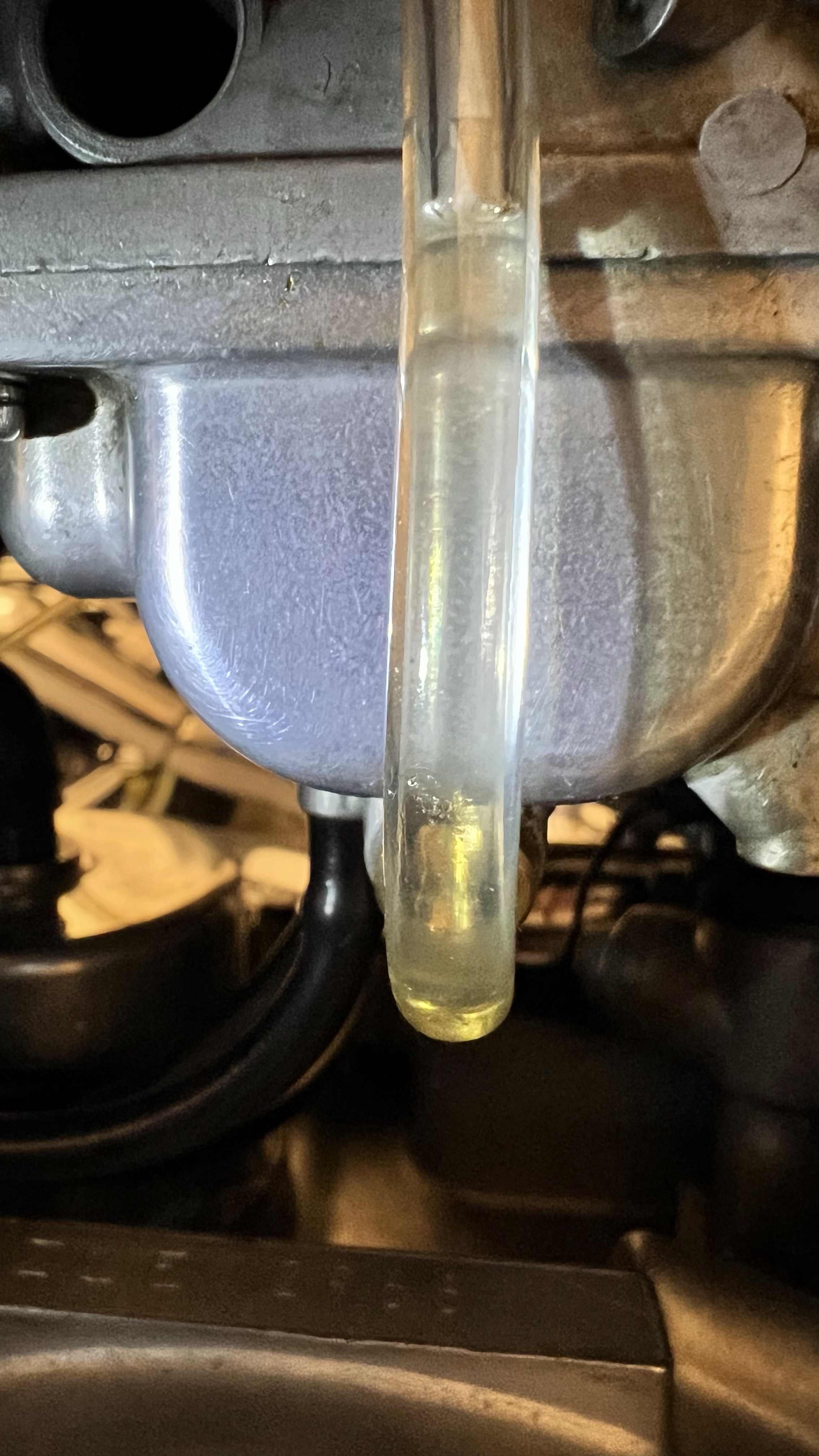

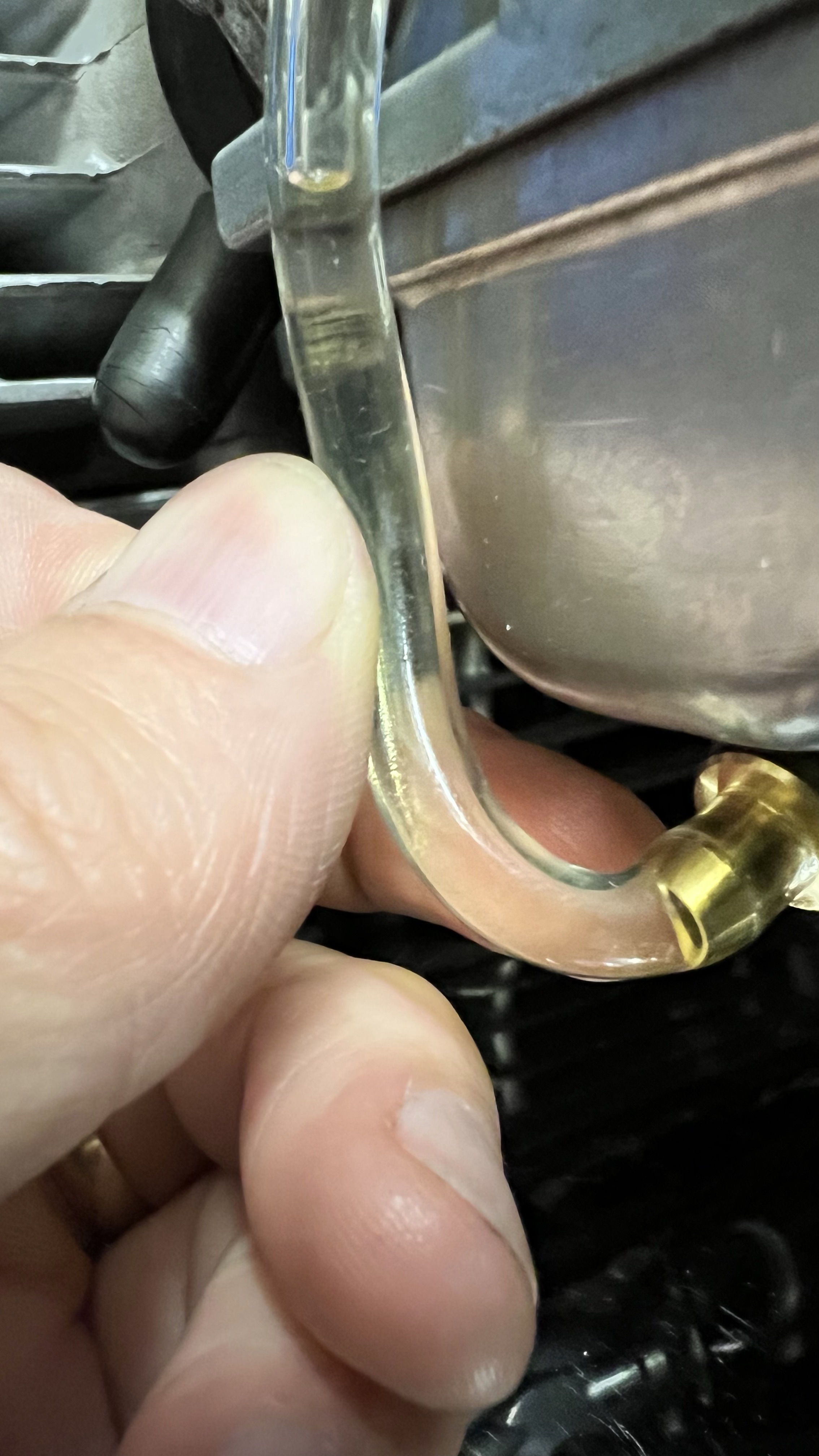

So, I think we are on the right track.
The Mrs is watching some shite on the tv, so I sneaked off out to the garage for a bit of a nosey.
Used the carb bowl fuel level measuring tool I just bought on the two outer cylinder carbs just to see what they were like. They are both well above where they should be. This despite setting the float height accurately and checking several times. I’ll get the carbs off the bike and make a jig to hold them level in the vice while I get them set up correctly. Feel a bit embarrassed by this school boy error, but just goes to show that float height in the manual doesn’t necessarily mean the correct fuel level. Lesson learned !
As a by product of taking a photo of the fuel levels (my eyes aren’t so good these days at close-up stuff) I noticed when I enlarged the image that the air off-take blank on number 1 carb to head rubber looks perished / cracked. I wonder if this may be causing an air leak and contributing to the issues ? Anyways, they are being replaced so that will be sorted shortly.
I will still check out / replace all of the other stuff on my ‘to do’ list, but feels like progress !

Re: KZ900 carb help
1975-S1C wrote: Feel a bit embarrassed by this school boy error, but just goes to show that float height in the manual doesn’t necessarily mean the correct fuel level. Lesson learned !
Yes, correct float height doesn't always equal correct fuel height.
A perished vac take off blank can leak air and cause issues, so best replaced.
Sounds like you are getting there.
