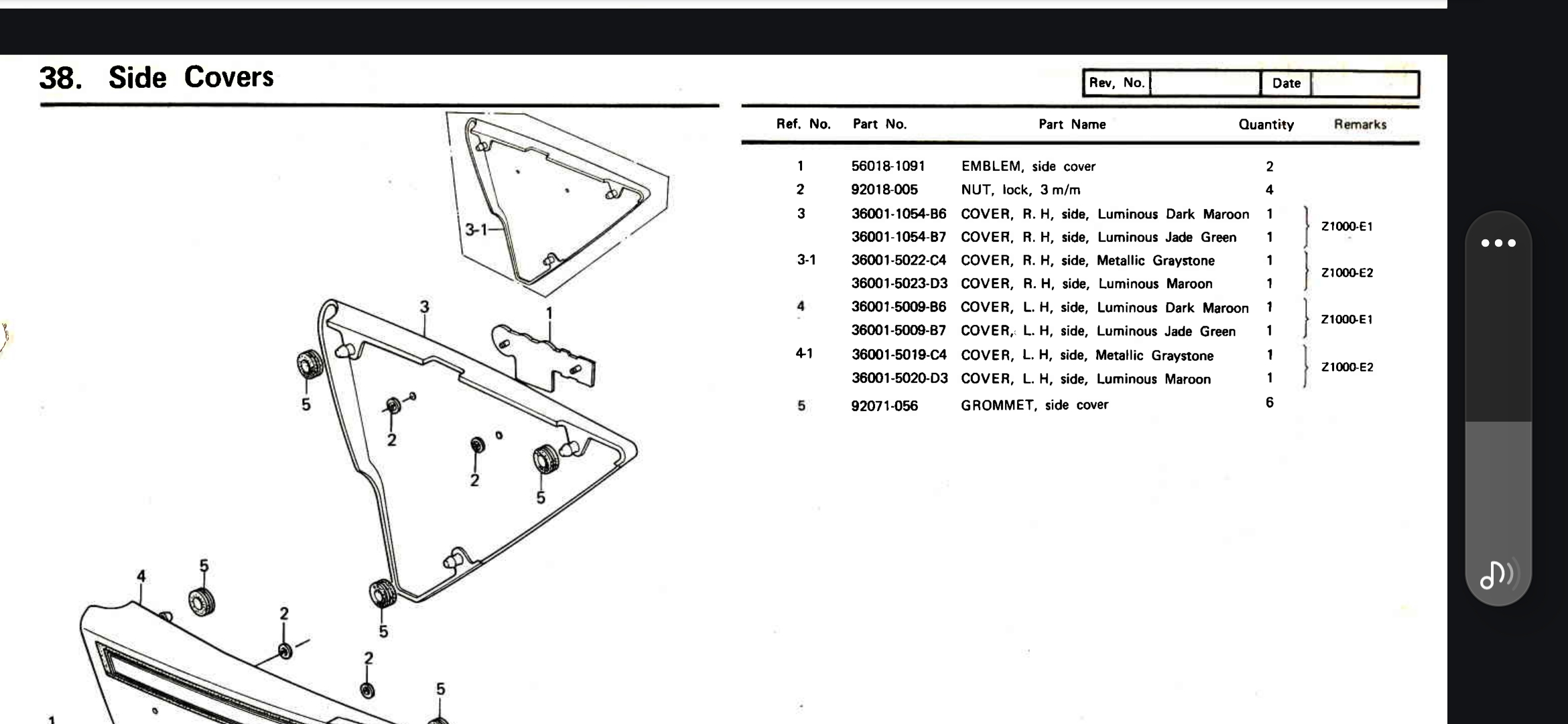

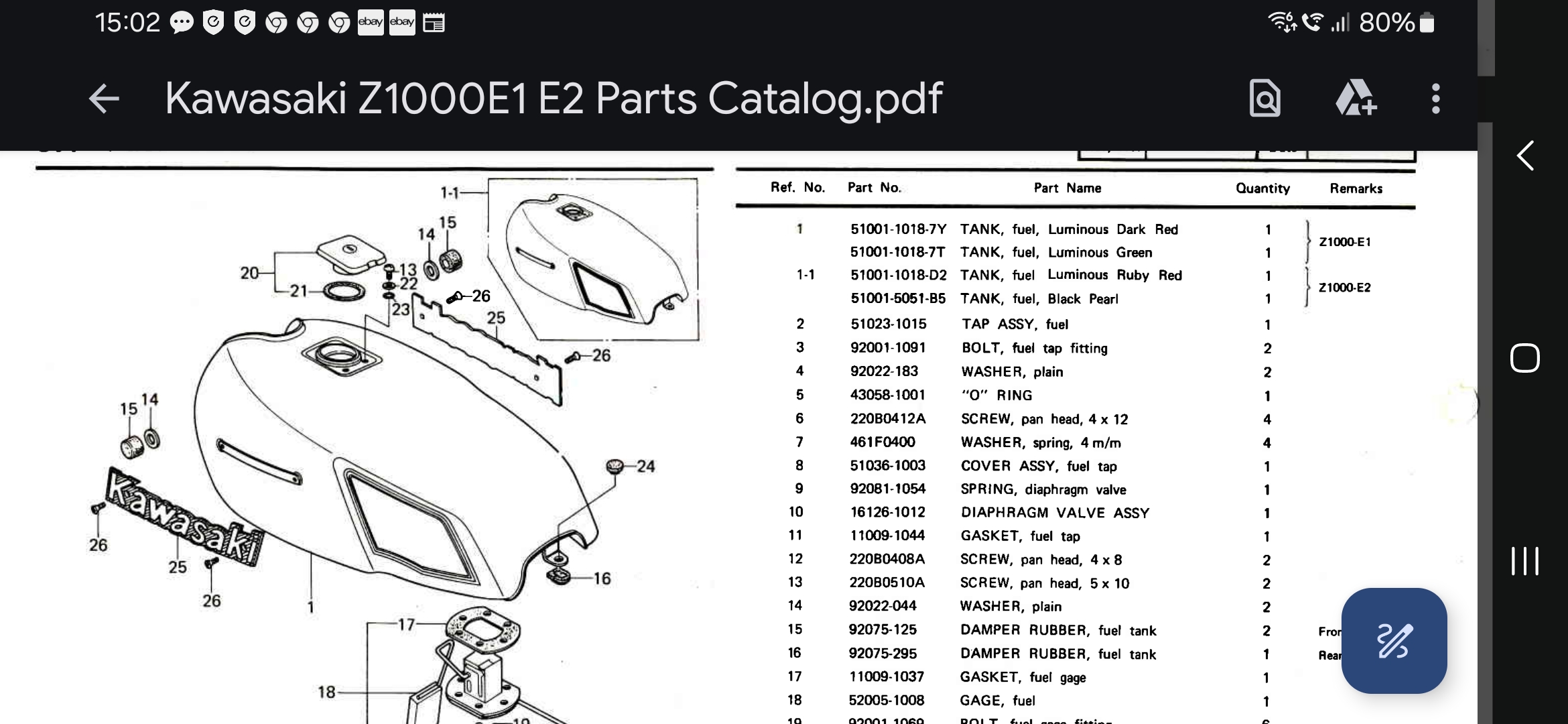

After searching for colours for ages I found the names of all the colours while looking for something else on the partsfiche, to save me typing them all out please see the attached images.
