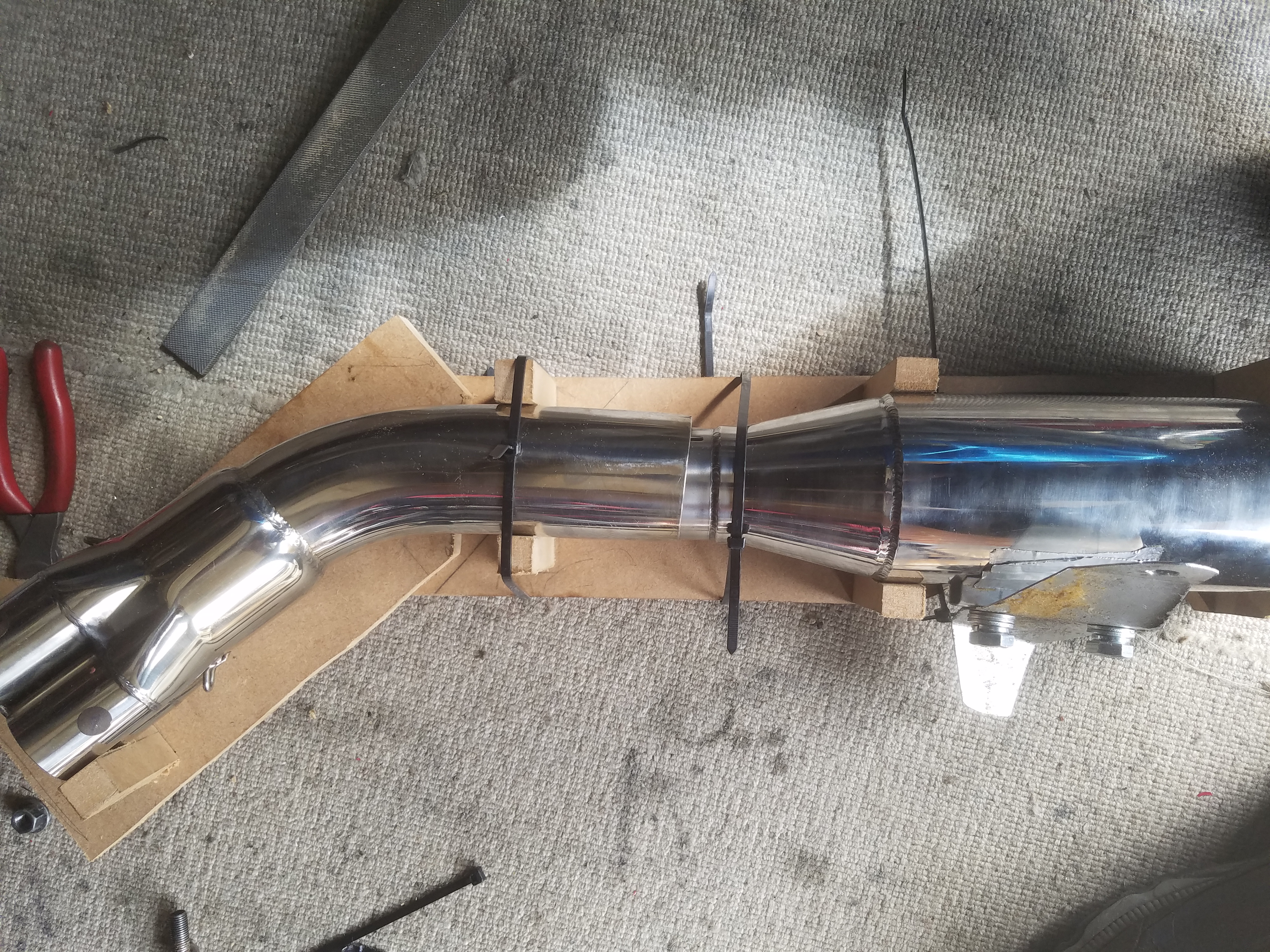

Used these down pipes in my Harris replica system. I think the are 60 mm. I reduced to 50 mm at the collector with a custom cone. I think I had a pressed reducer at one point but discarded it as it didn't look good.

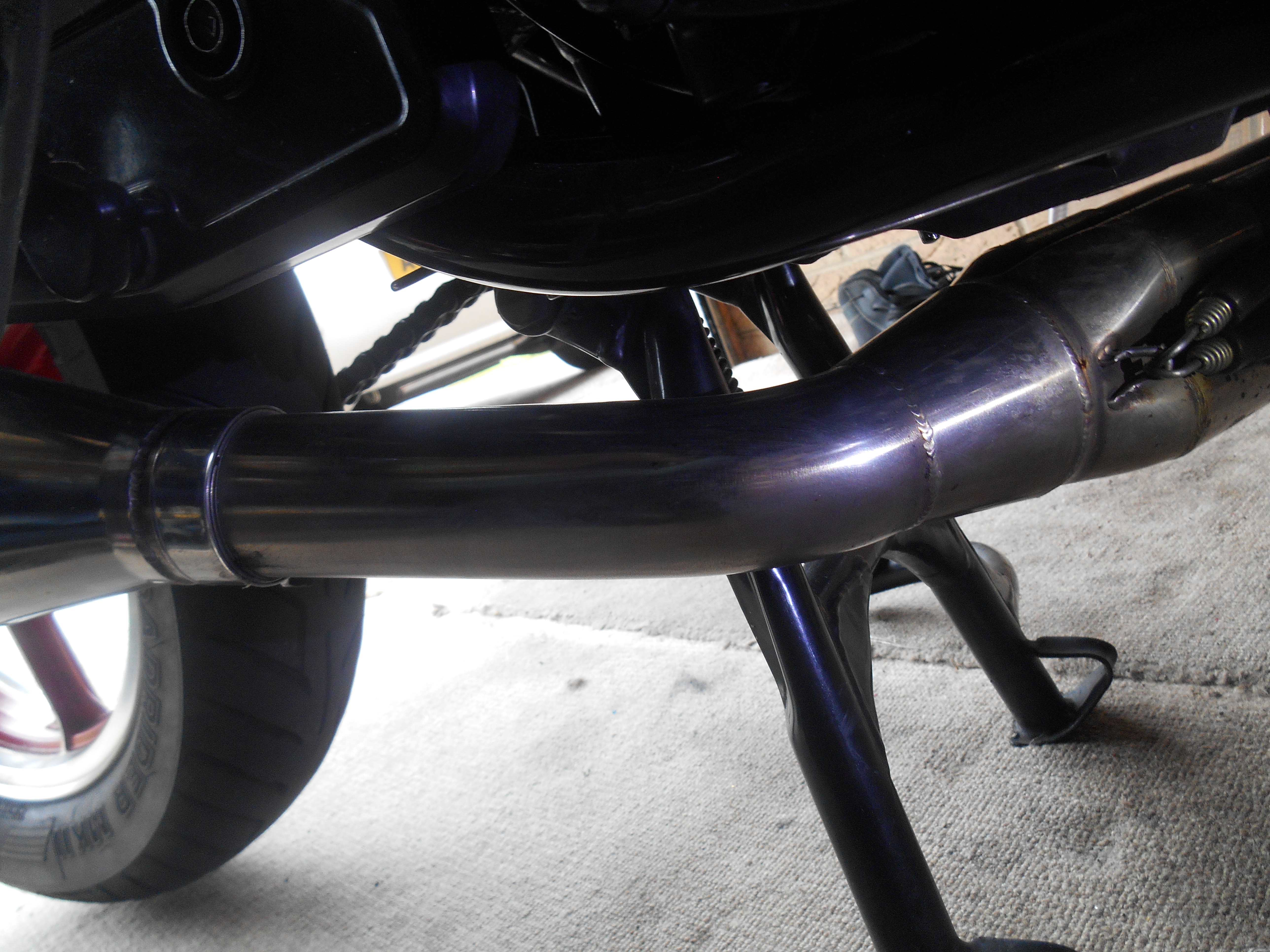

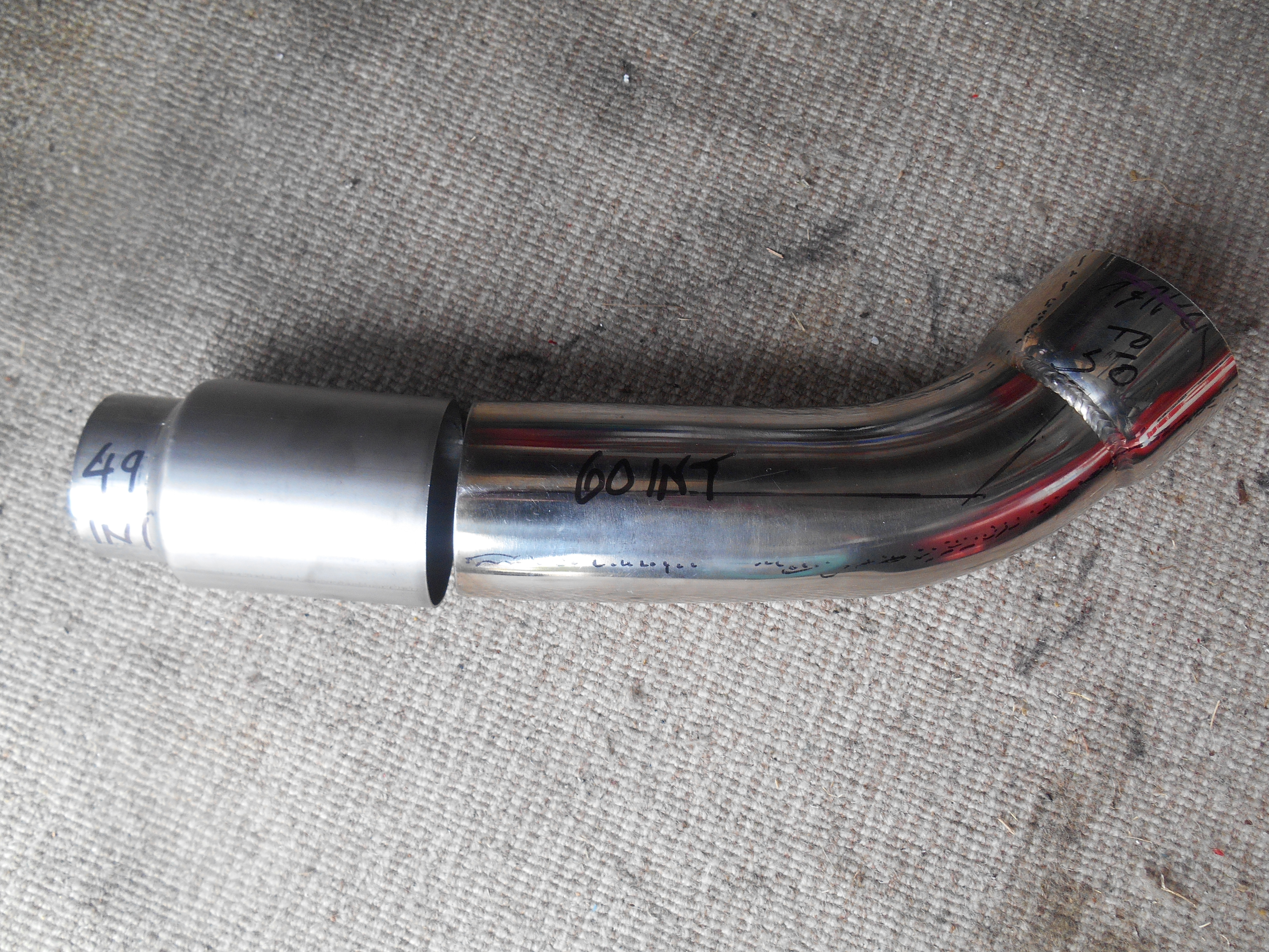

Checked the Delkevic remnant, 60 mm internal, the s/s reducer I have is 49 mm internal. Here's a clearer pic of my fitment solution. Neat and very tucked in. Needs a polish still.
