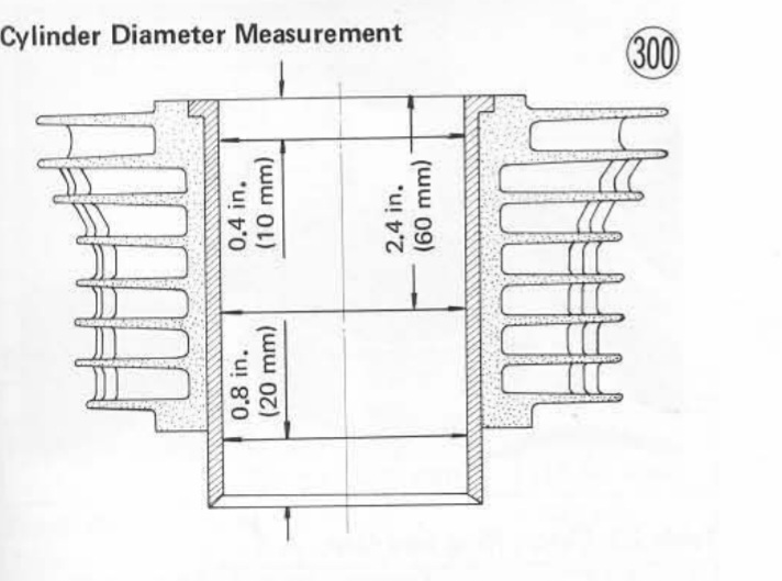

Service limit is O. 1mm over bore size. So if its 0.5 over then service limit is 66.6mm.
A borescope isn't likely to tell you much you need accurate measurements not a visual inspection.
Measurements should be taken both L to R and F to B at three height positions.
Screenshot_20240910_083105_PDF Reader - Hi Read.jpg (73.23 KiB) Viewed 3634 times

Warren3200gt, Thanks for the info. I did mean a bore gauge, not borescope. Either a typo or I had a blond moment :oops
Ive edited my post.
Cheers, Ken

I got the cylinder bores measured and they are well In tolerance. there was a stain on one bore, looks like it had been stood for a while and probably got moisture in through an open exhaust valve. Bores re honed very lightly and they are looking mint, no staines marks or scratches.
