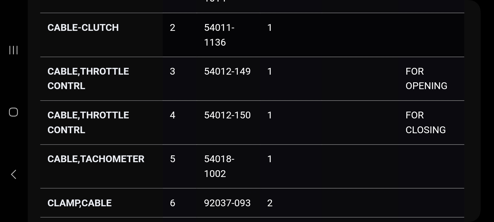

Does anyone know where I can get these that are actually are the correct length or a part number that fits before I go mad :lol:

cheers warren have got a new open cable fits perfect the problem is the close cable people are using this part number but the inner cable is far too long have ordered a cable nipple so i can shorten it but will keep trying and sending them back till i get the right one.
