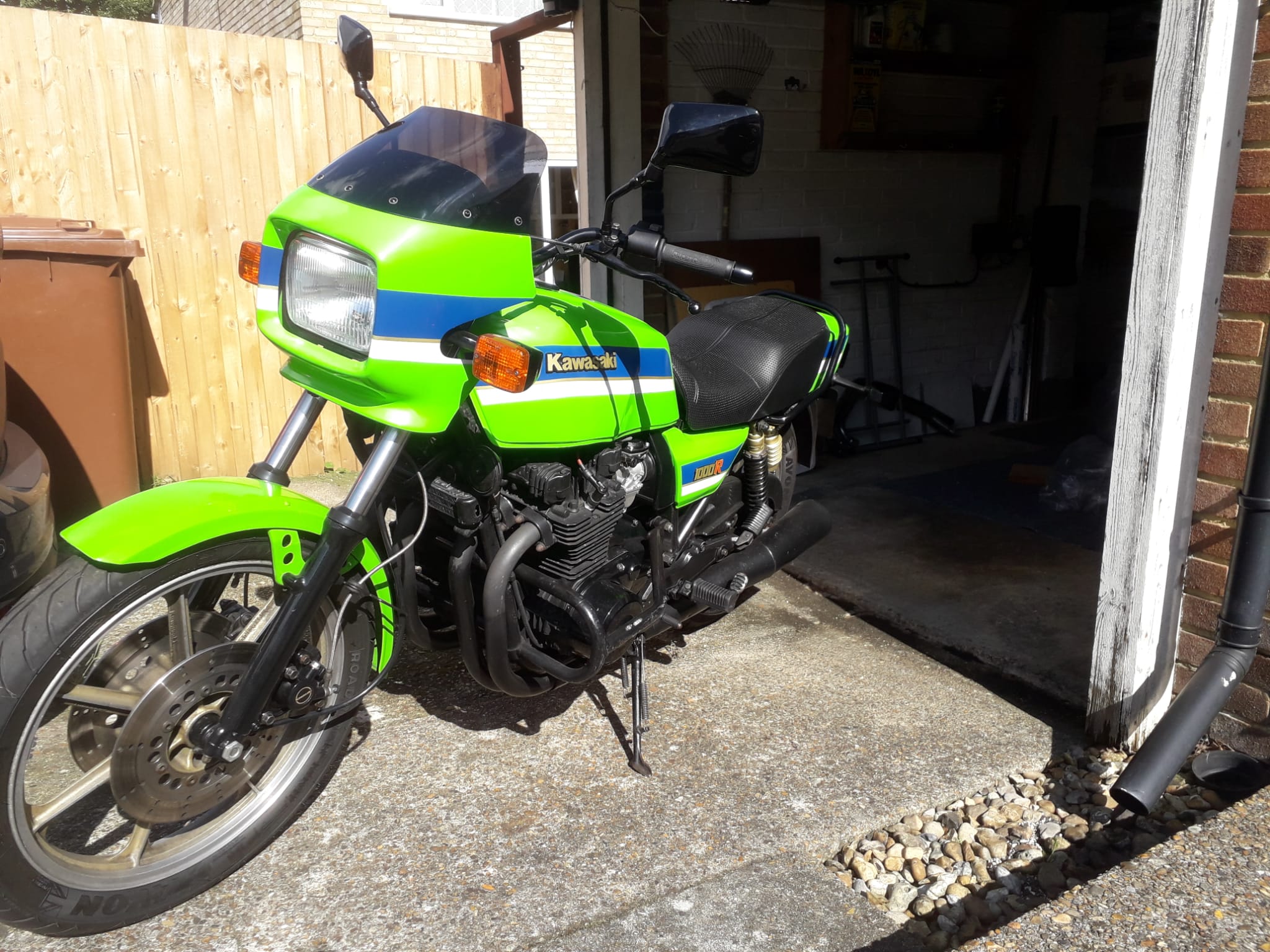

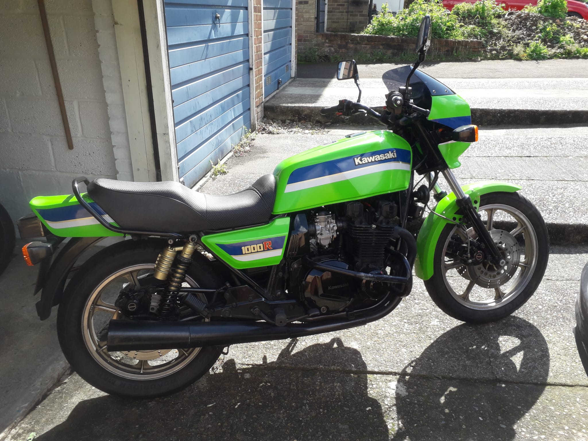

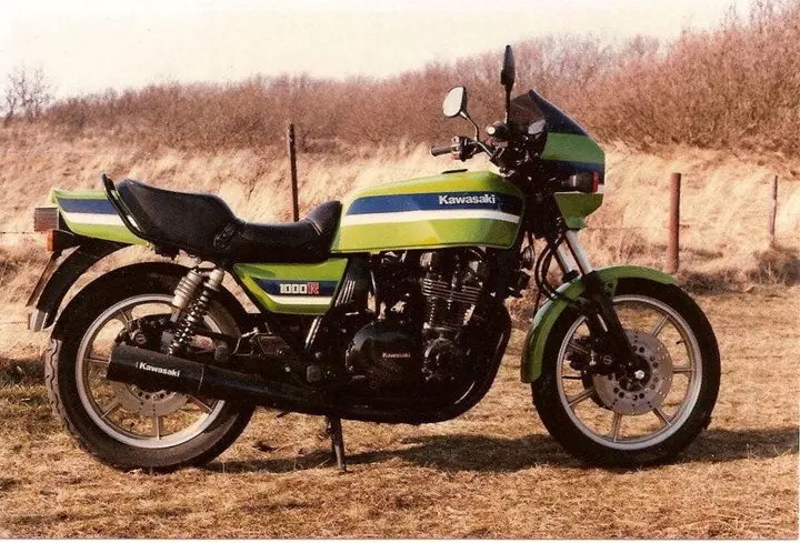

One I did for a mate two years ago. Plus pictures from adverts etc.
He's got a spare set of decals if you need them as I painted them details rather than decals. He wanted the shield on his.
The two shots outside the garages is his bike after I'd finished it.

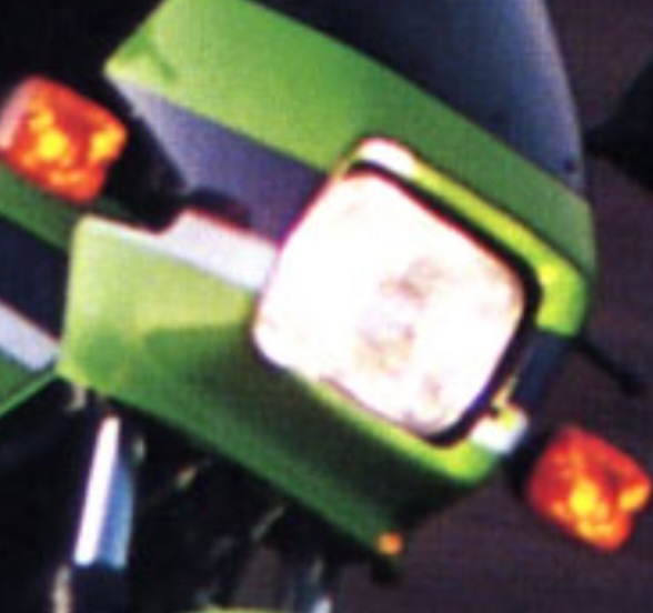

Never thought about that nose fairing wrap around at the front before… my decals don’t I never noticed before but it looks ok. Looking at pictures of various ELRs most do some don’t it’s impossible to tell what the actual original S1 racebike scheme was because they usually have a number board on

Only trust the original khi adverts Chris. They are the only ones that you can guarantee that they are the same as they left the factory.
God's knows how many times non kawasaki original pictures have been repainted.
The decal set supplied by my mate didn't wrap around to the headlight. Just one of the reasons I opted to paint rather than decal his paint job.
