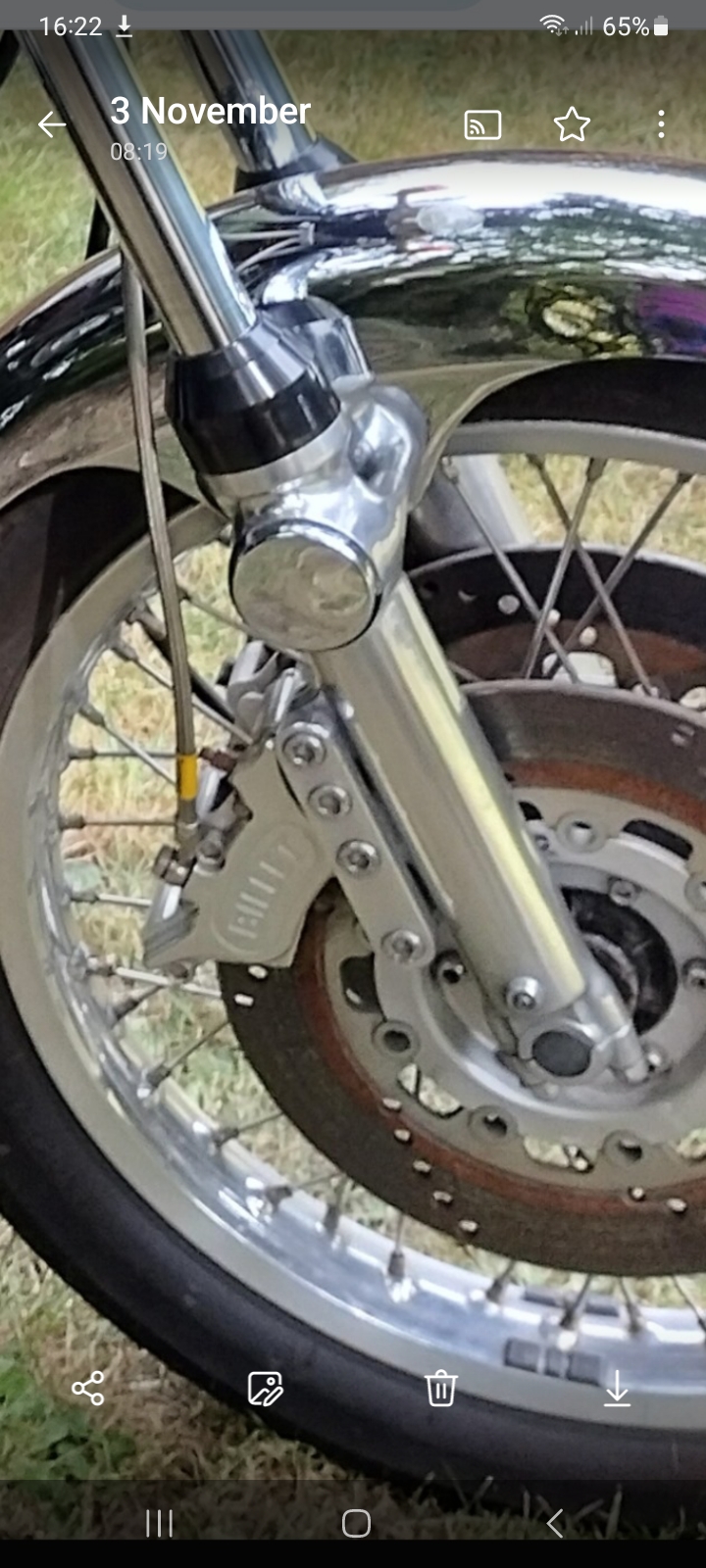

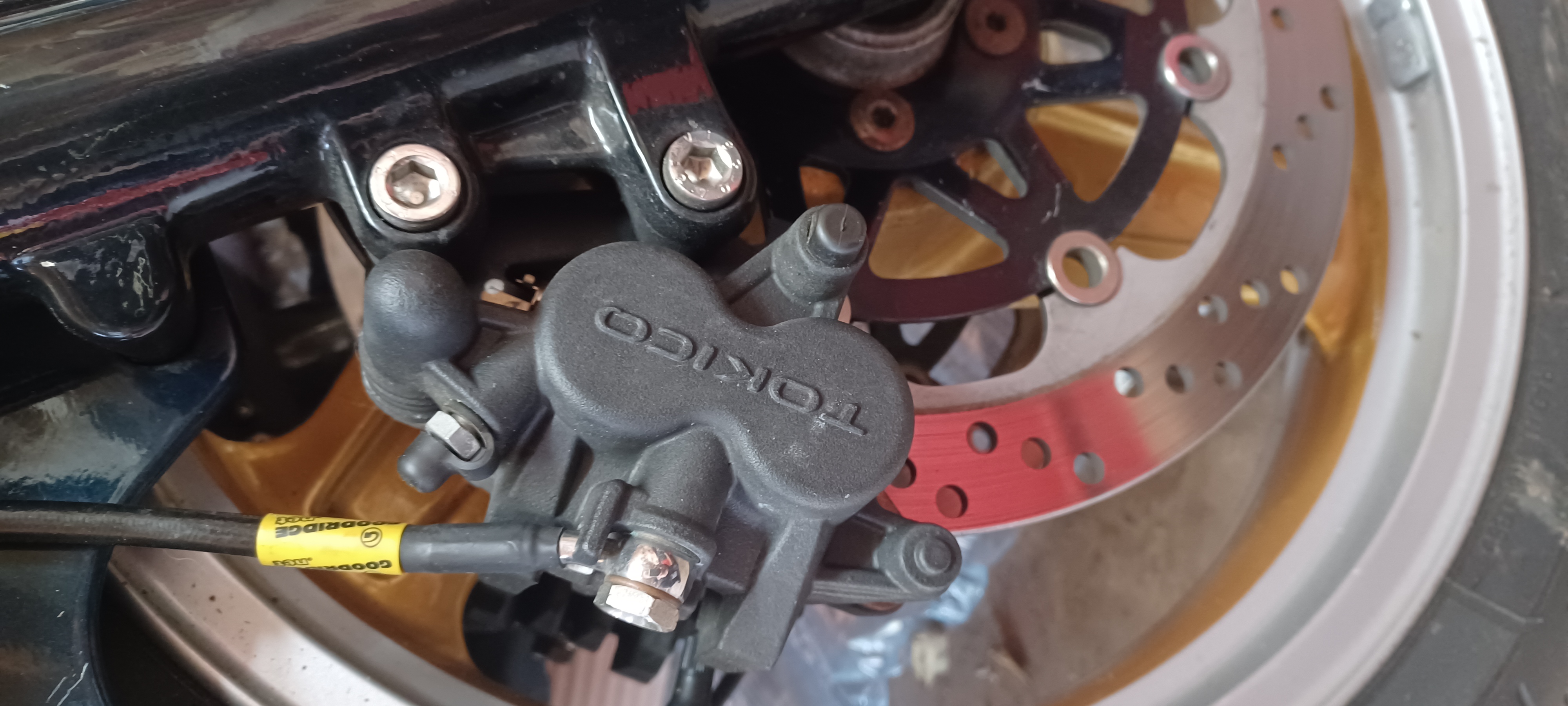

#6 PostAuthor: Speedie » Mon Nov 25, 2024 4:39 pm
Hi, this is the caliper off my 93 Zephyr 750, looks similar to the one
In the attachment. As previously mentioned they were used in many 80s/90s bikes.
I bit the bullet and bought new from Cradley a few years ago. Glad I did, no messing with worn old calipers and they bled up straight away.
The second photo is one I screenshot where someone had used EBC discs on their Z. I haven't looked any further into this as yet, but is something I'm considering. Photo also shows the Harrison calipers which are also an option (expensive when I last looked a couple of years ago)
