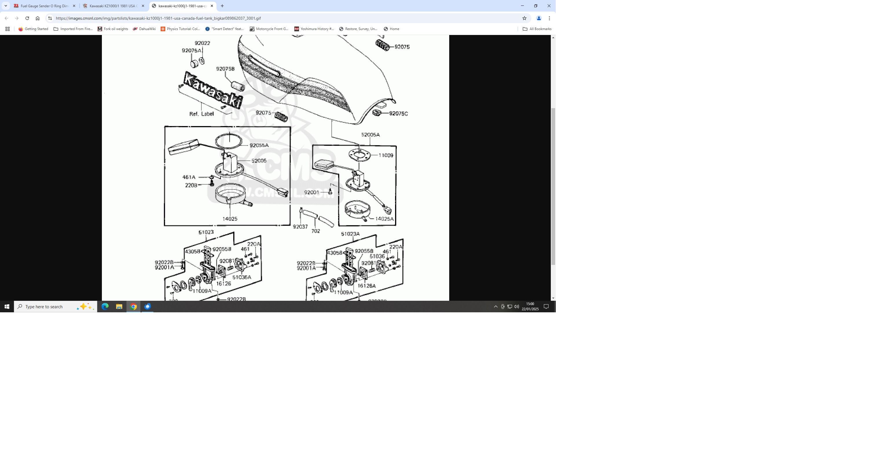

What bike are talking about? UK J's and R's both use rubber gasket not an o ring to seal the sender unit / tank joint.
Zpower stock the part number you originally posted.
Screenshot_20250122_132938_Samsung Internet.jpg (27.32 KiB) Viewed 2389 times

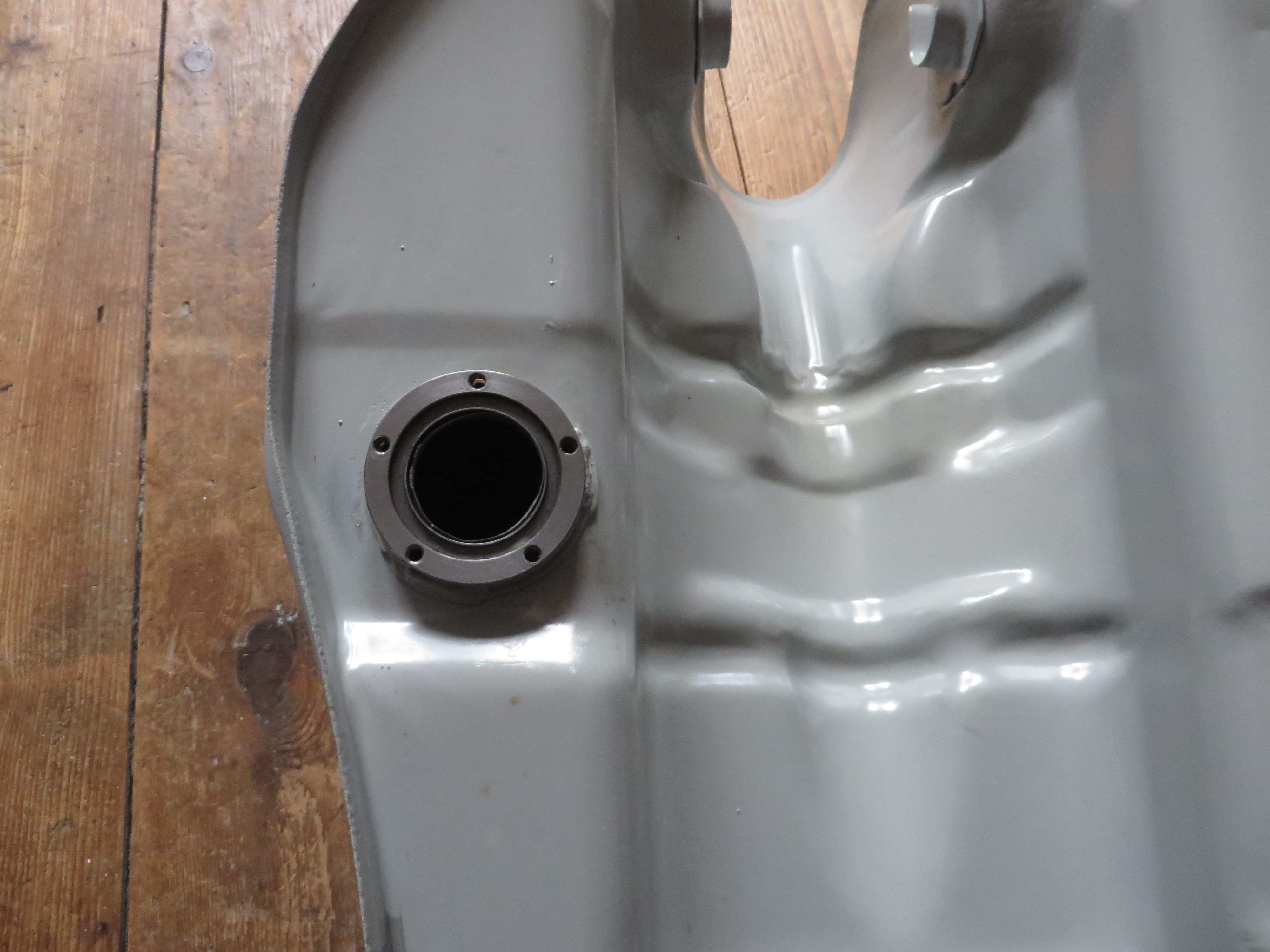

Some models have a round O ring and share these with some Z1300's i believe.
I havnt got the sizes sorry, the only one i have is on the bike with petrol in it just now.

We are talking the KZ1000 LTD and CSR 1981 to 1982.
O Ring as seen below.
o ring.png (333.06 KiB) Viewed 2369 times
