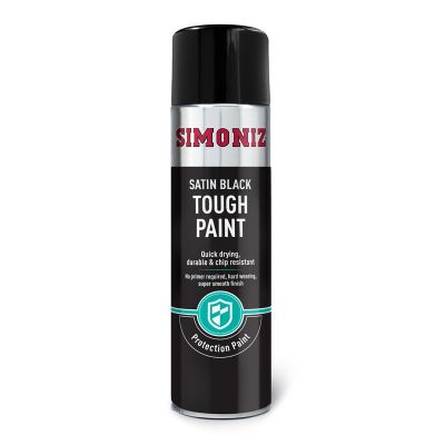

Sound lads, satin 2k it is, I use that Simoniz on bits a pieces, tough paint straight out of a can for sure. These are all original parts so I want to stay close to factory finish as I can but sure the real process is probably lost in time.
