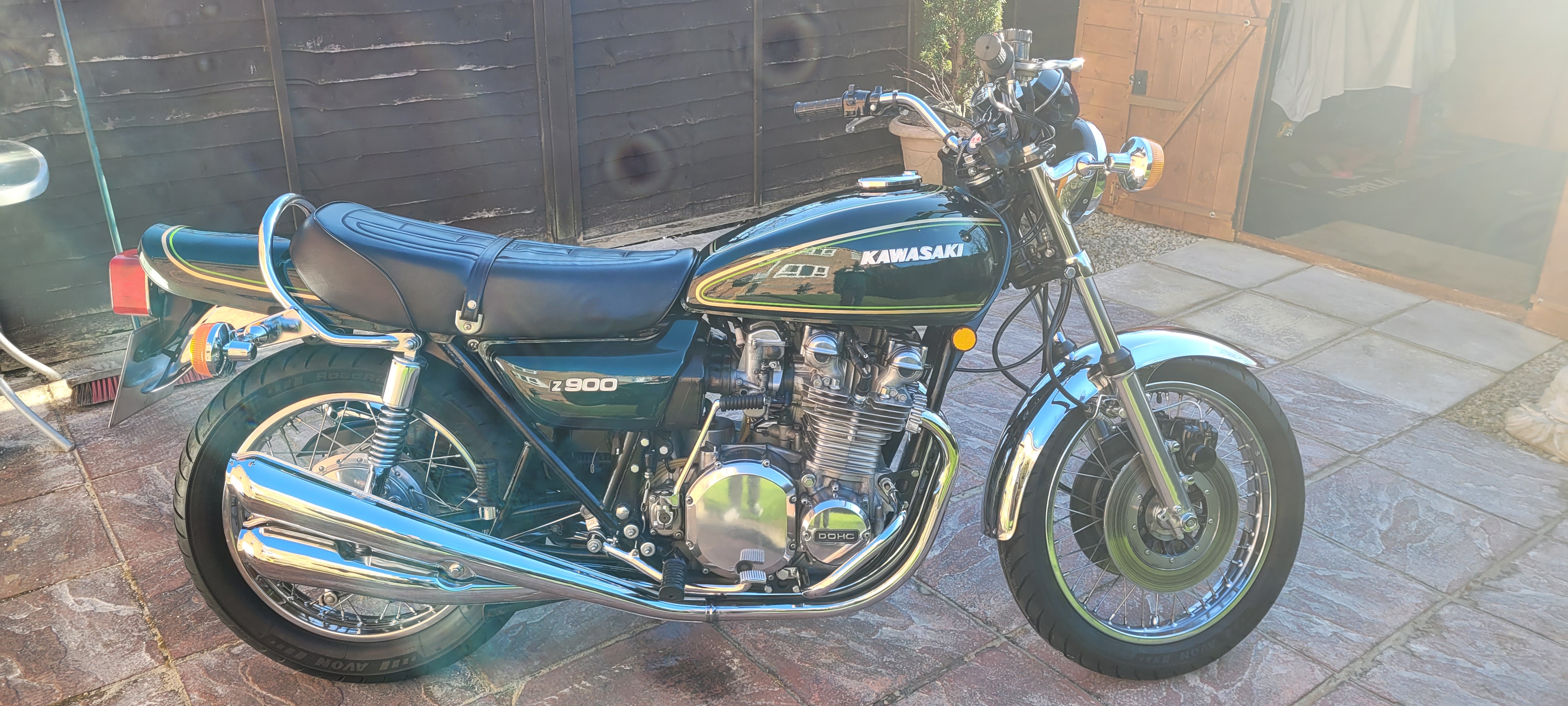

Hi people hope you can help got a slight pop from number 4 cylinder every now and then? got new plugs filter and oil and oil filter.
no smoke at all ticks over lovely any thoughts peeps ?
