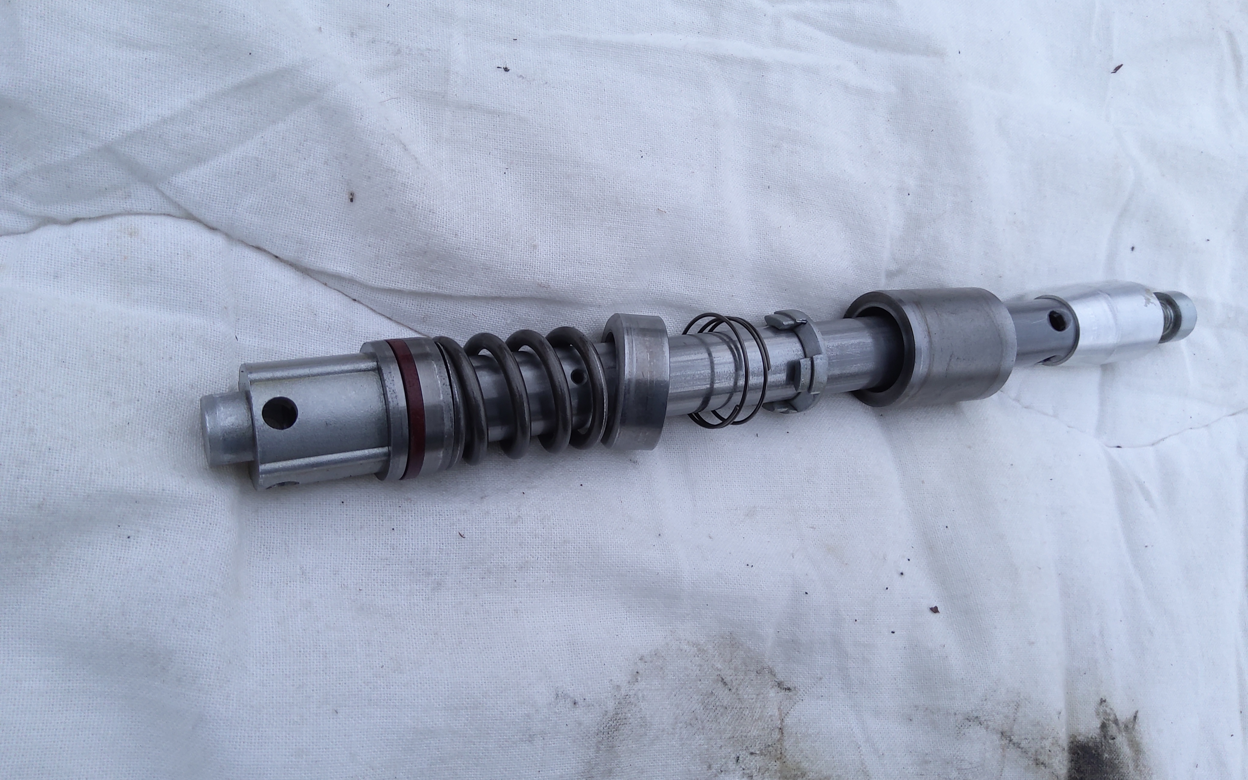

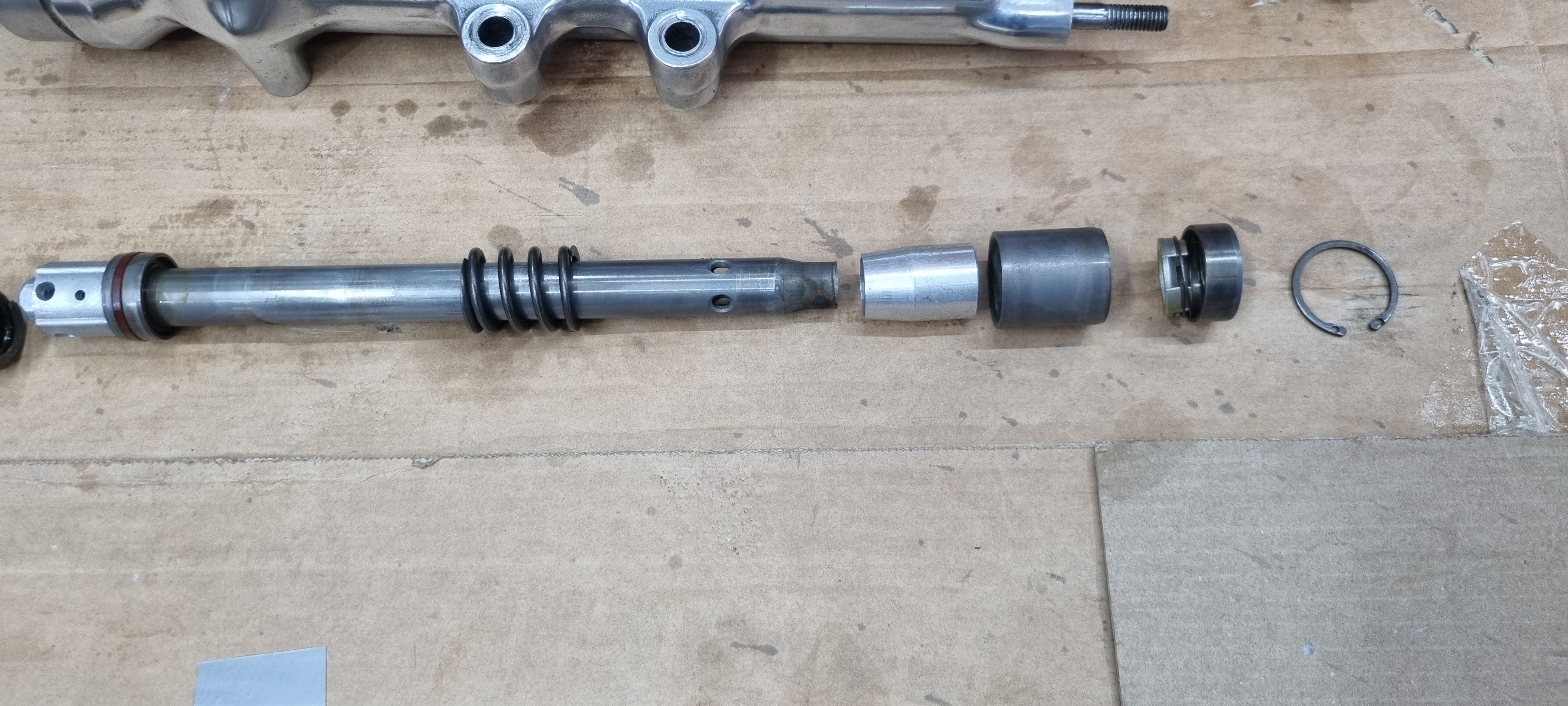

Can any of you kind folk confirm that I have the correct sequence of bits on this Jan 1975 build Z1-B fork damper (I believe it's a 44022-028).
Also, what's the current thinking on the best oil to use in the forks. Manual just says 170ml of SAE10. I know this has been discussed before but the last reference I can find on the forum is from 10 years ago.

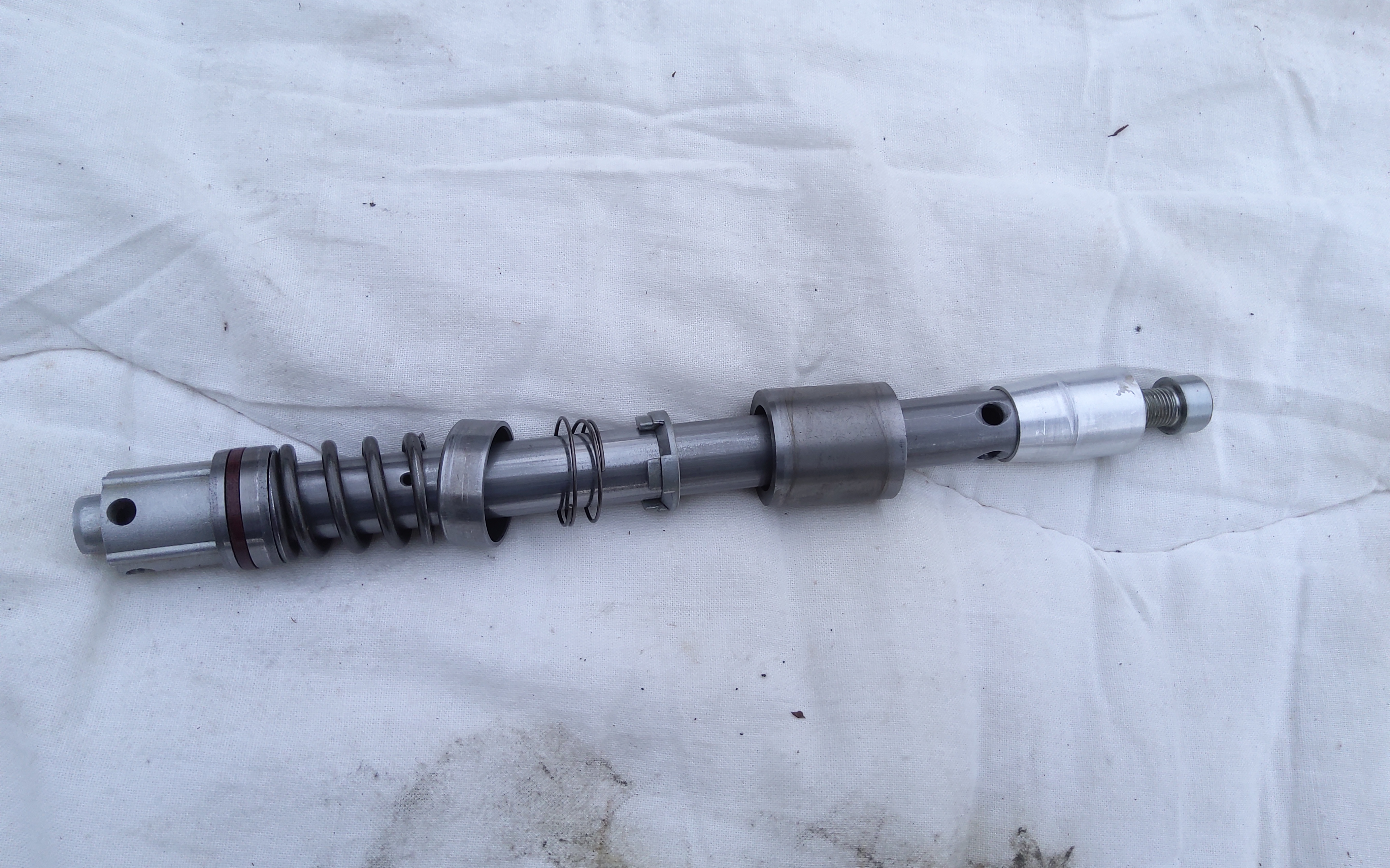

Here are mine also from Early 75 Z1B

#3 PostAuthor: Paul Spencer » Mon Mar 10, 2025 7:43 pm
Having recently re-built my Z1B forks, I think you've got it right.
