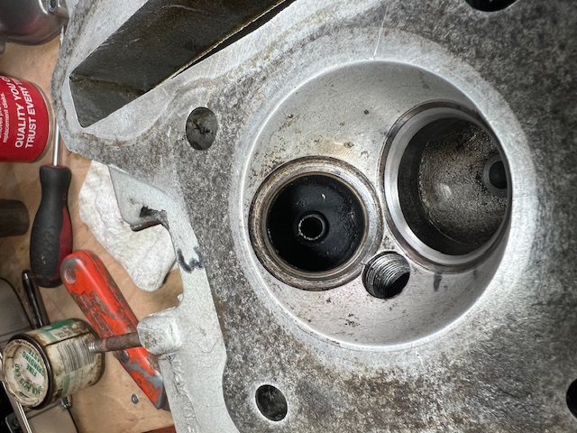

There is a crack in my Z1a Cylinder Head between the Exhaust Valve and Plug Hole. Is this repairable?

Best post a pic mate but in all the discussions iv ever heard on this topic unless you can see daylight through it its "play on". I recently changed a head gasket on my bandit 1200 and it had 4 cracks in the same place, ran fine before hand and runs grand now. Fella no KZR had a company in Germany laser weld the cracks on his, cost a bit and apparently there was no real difference in the compression tests but... thats only my chime, few others might offer advice.
Re: Cracked Head
Posted: Mon Mar 24, 2025 2:45 pm
Author: zed1015
Cracks in that area are very very common and are simply surface fissures caused by heat expansion.
99.99 % of cases need no attention.
Almost every one of my heads have these and never caused a problem even on my turbo and supercharged motors.

same here ,it shouldn't give you any probs and it is a common thing .

Although the crack is definitely there, I can't see that it is going to cause a leak. It is between the Spark Plug Thread and the Exhaust Valve Seat. Repairing it sounds like a bit of a 'mare. I do however have another head without any cracks BUT that will need all new valve guides and seats.
Perhaps if I "Pressure Test" the cracked one, somehow.
In the mean time I will try to get photos in.

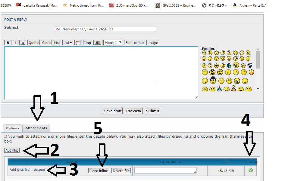

How to pics
Click reply
1. Click "Attachments"
2. "Add files" from wherever
3, Pics appear here.
4. Good to go
5. "Place inline" puts it in the message
Add pics from pc.png (44.57 KiB) Viewed 3895 times
Hopefully this works

I remember seeing a comment on the website ( a long long time ago - decades ) that it didn't matter unless the crack extended all the way up the spark plug threads , from combustion chamber to outside world

you see the same thing on GS and GSX Suzuki's, fairly common issue but nothing to worry about.

I think you can now see the photo!?
If so, thanks to Gus
Cracked Head
IMG_5190 (3).jpg (179.58 KiB) Viewed 3808 times

Normal.
Use it..
