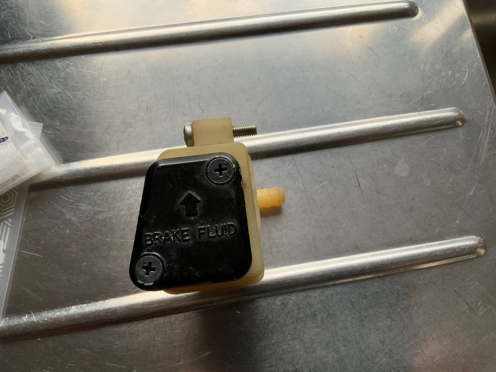

anyone know where to get the seals for this thanks in advance

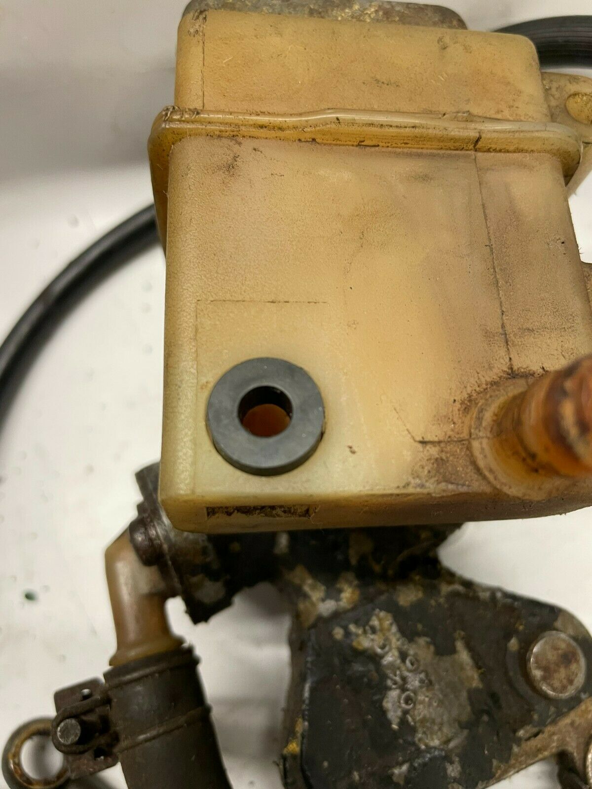

there not seals there mounting dampers ? and the only one selling was ross @ Kawasaki support down under ive just checked he's off grid for some reason nowt selling on ebay ? and they were 3D printed not quite right did not have the outer lip

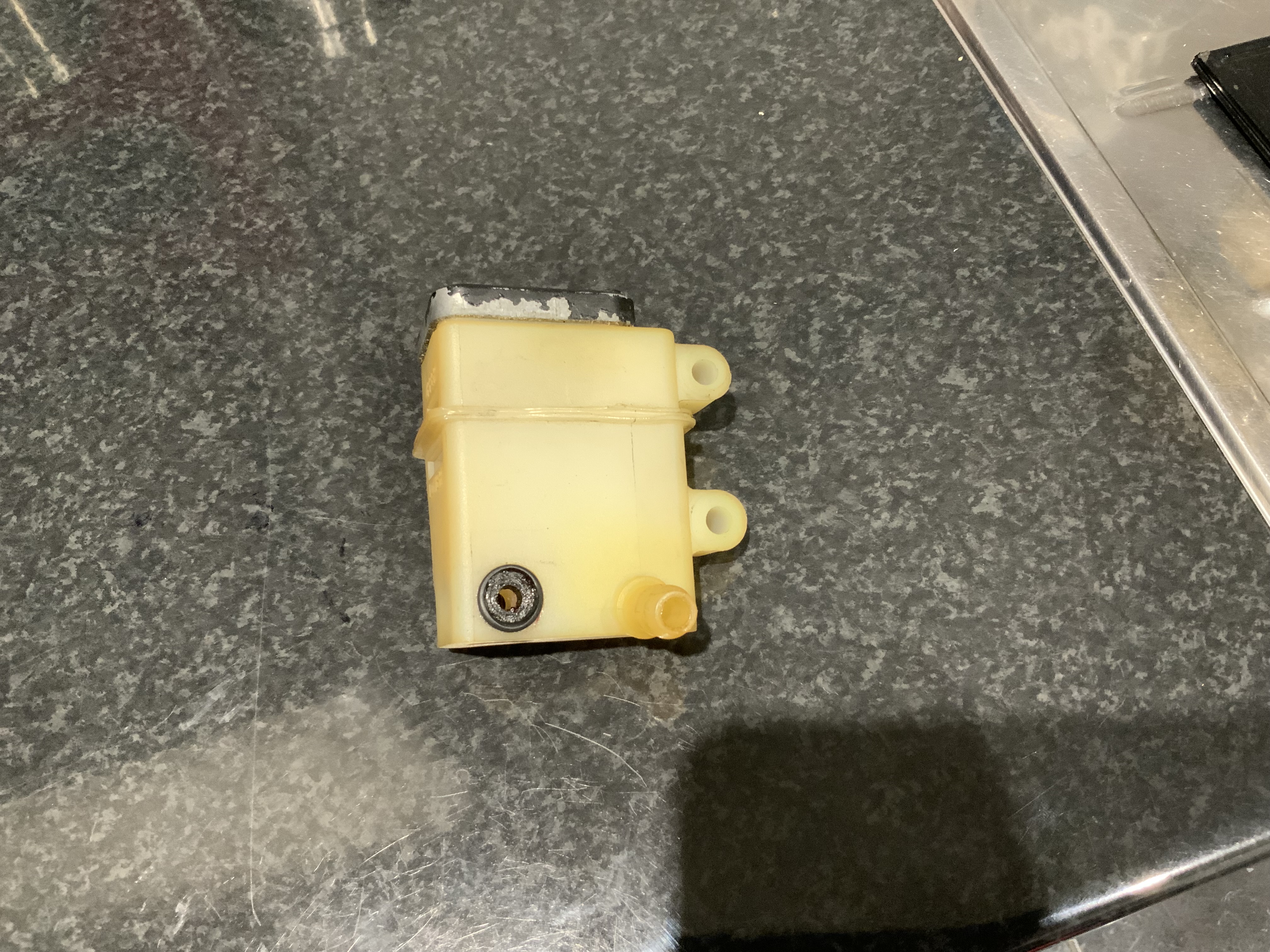

So not seals but spacers. So after thinking about it I could use anything

So 6mm fuel pipe does the job :up

Result. …. Onto the next problem
