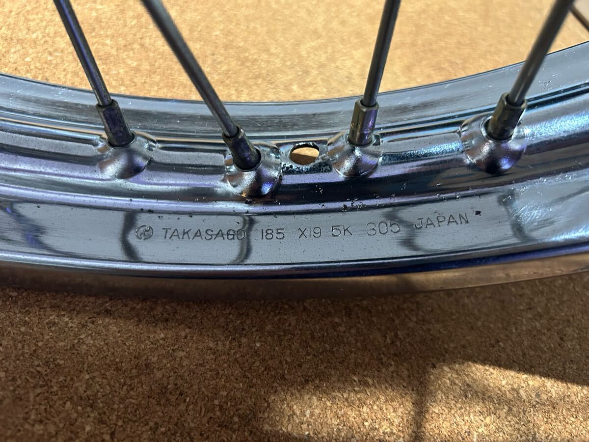

Hi guys, I have a takasago 2.15×18 5A 303 wheel rim I wanted to ask is the the right rim for a z900a4, also will the spokes zpower sell be suitable for this rim ,thanks again.

#2 PostAuthor: Z1streetfighter71 » Sun Jun 08, 2025 4:15 pm
303 is a Z1 rim 5A would be a 75/January. 306 rim is a z900 A4 with a 6 in front of a letter.

#4 PostAuthor: Z1streetfighter71 » Sun Jun 08, 2025 4:49 pm
Its possible but there may be others that can confirm. There were 305 and 306 rims being produced in 75 for early the Z900, below is a front rim for what i expect is a very early bike.

#5 PostAuthor: davo63 » Sun Jun 08, 2025 5:15 pm
That's the date code on my front 5k 305. I'm about to have the rims re-chromed, which is not cheap and wanted to make sure they are original fitment for that boke.

#6 PostAuthor: davo63 » Sun Jun 08, 2025 5:21 pm
Sorry got that wrong it's 5H 305.

#7 PostAuthor: Z1streetfighter71 » Sun Jun 08, 2025 5:43 pm
305 is a 19" front for z900 and z1000 and 306 is a 18" rear for the same bikes, so an early Z900 "rear" would be lets say 5H 306

#8 PostAuthor: davo63 » Sun Jun 08, 2025 6:00 pm
Great , by my reckoning the bike came originally with these rims
