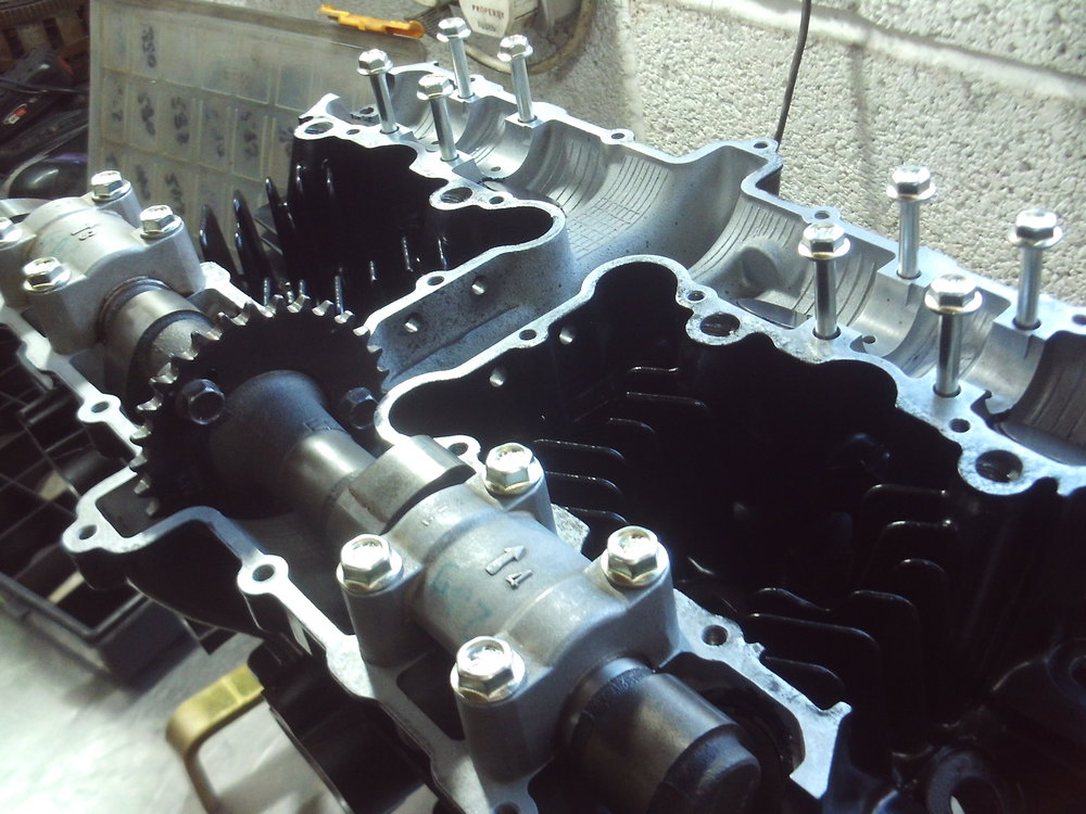

You can actually drill the holes deeper if needed and fit 20mm helicoils.
The genuine Kawasaki bolts are around £4 each but you can buy exactly the same spec bolts at 28p each from the link below.
You can pick the length you need ( 50mm if you fit the 20mm helicoils )
https://www.ebay.co.uk/itm/114307030889 ... 4558257426

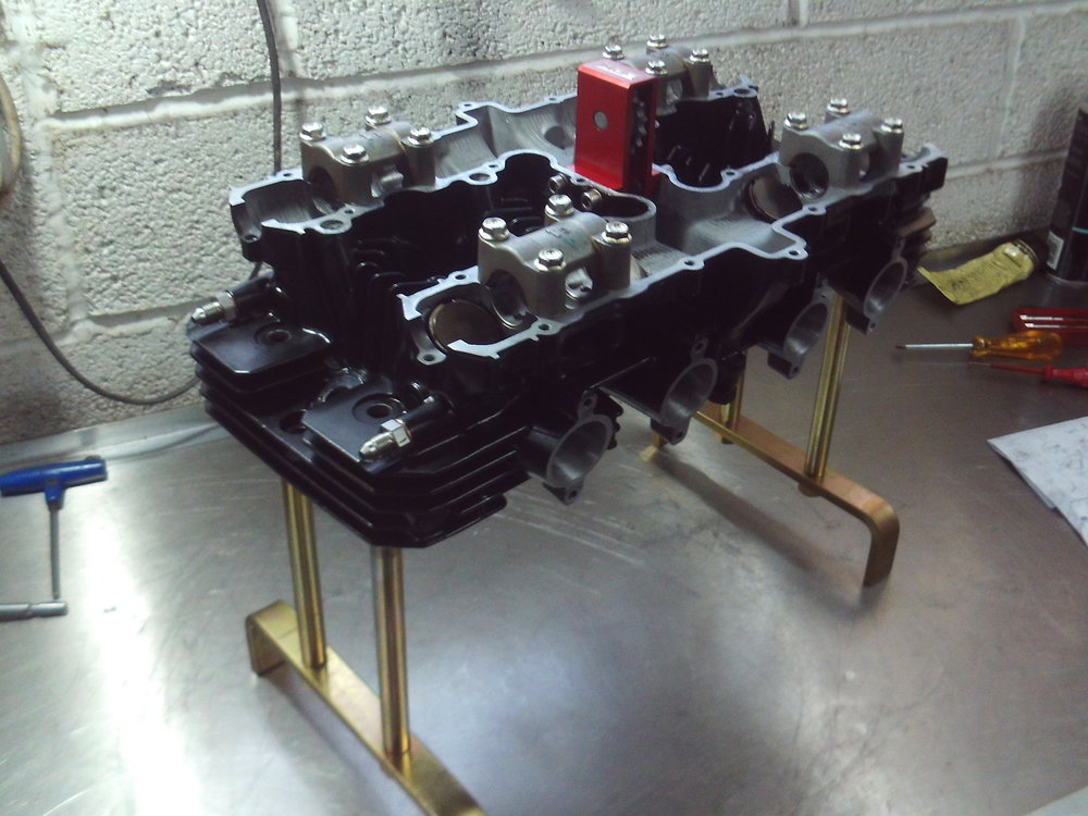

Here's a pic of the latest head i've done.
With the bolts being longer there is a lot more thread engaged in the head before they start pulling the caps down so no need to clamp the cams as some people do.
They are never going to strip again after this..

Before you re assemble and fit the head you should measure the installed height of the valve stems.
They need to as close to 37mm as possible ( from valve tip to bare head - spring seat removed ), if they are near 38mm you will be running out of shim sizes and may need to tip the valves or take other measures to retain decent valve clearances down the line..
