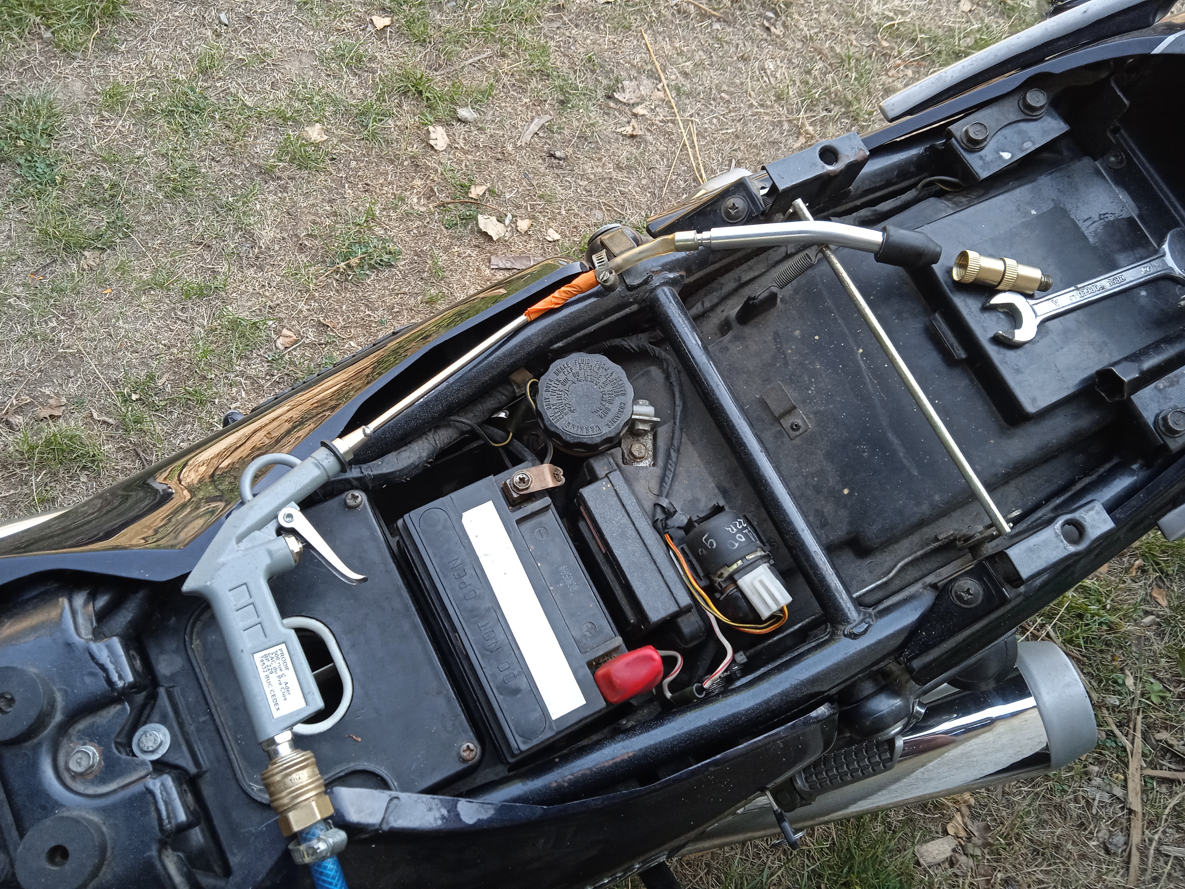

Rigged something up, not very scientific and couldn't be used to do a leakdown test but a way of getting air into the cylinder.
It was leaking but was hard to hear from where then I realised that the vac pipe for the tank tap is cyl 2. Couldn't hear anything but sticking it in my mouth and operating the air gun told my it's leaking from the inlet valve at least. Cam cover off it is then.
Glad I checked with the infrared gun or I'd have just ridden it. It was also a good excuse to buy a compression tester.

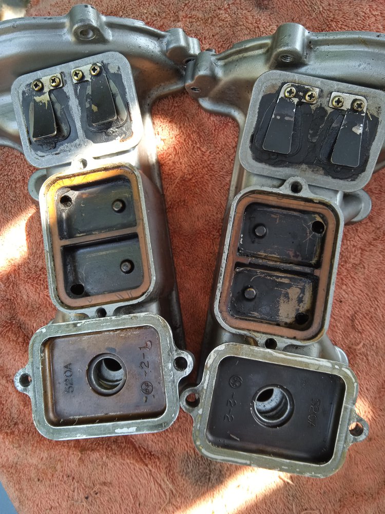

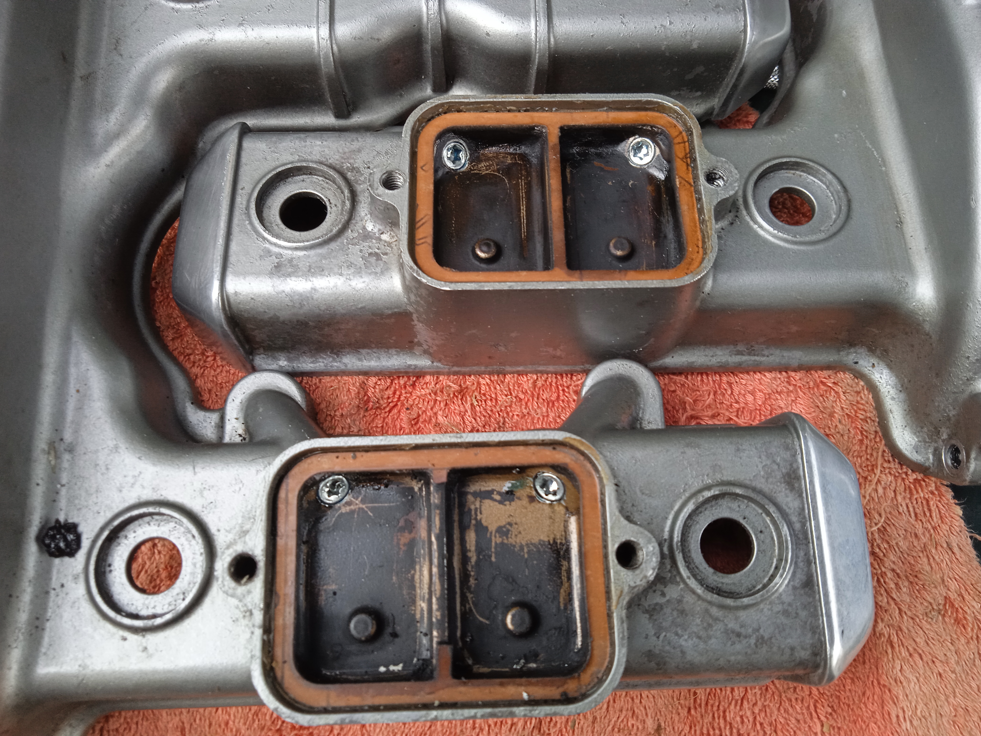

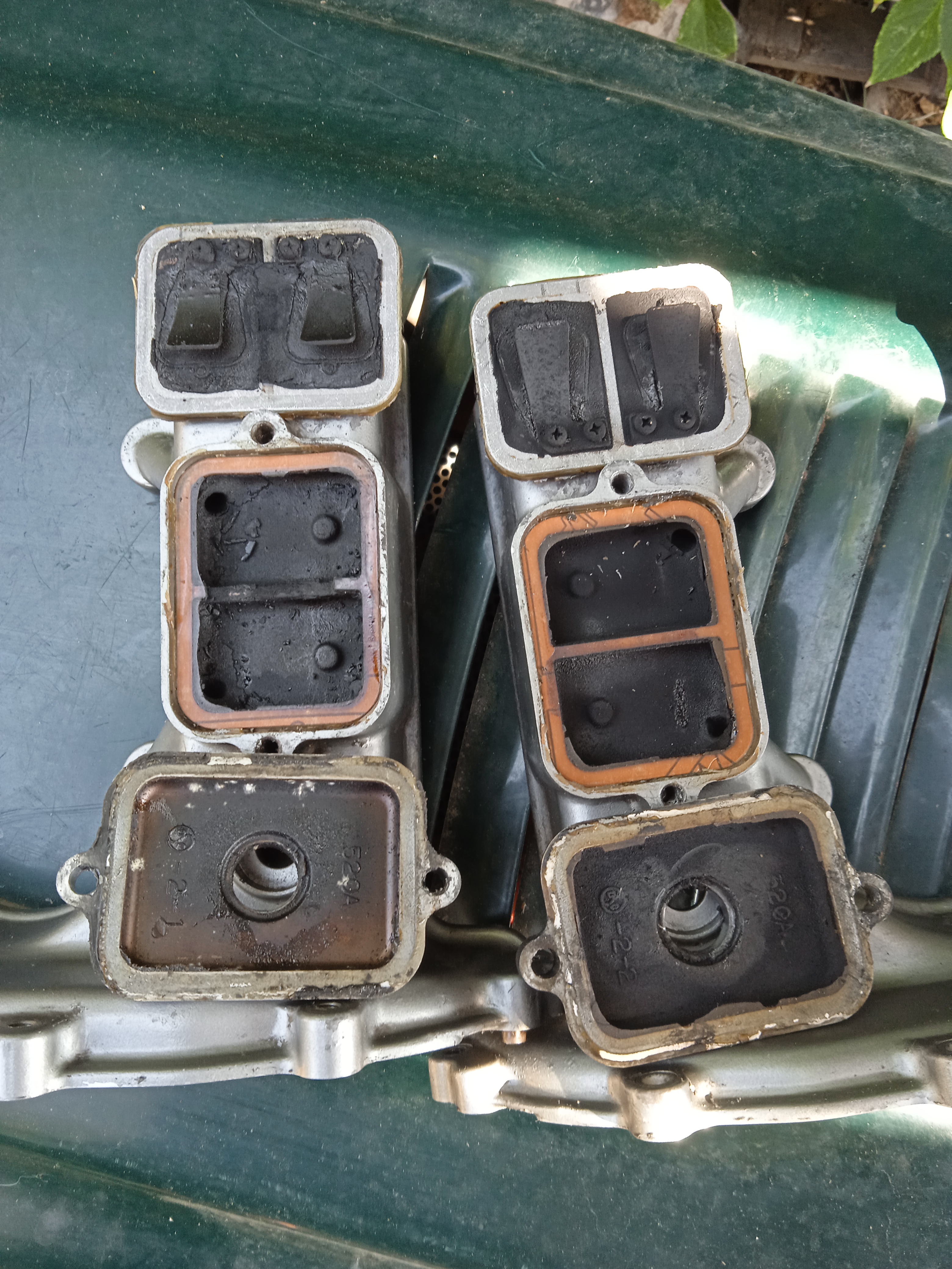

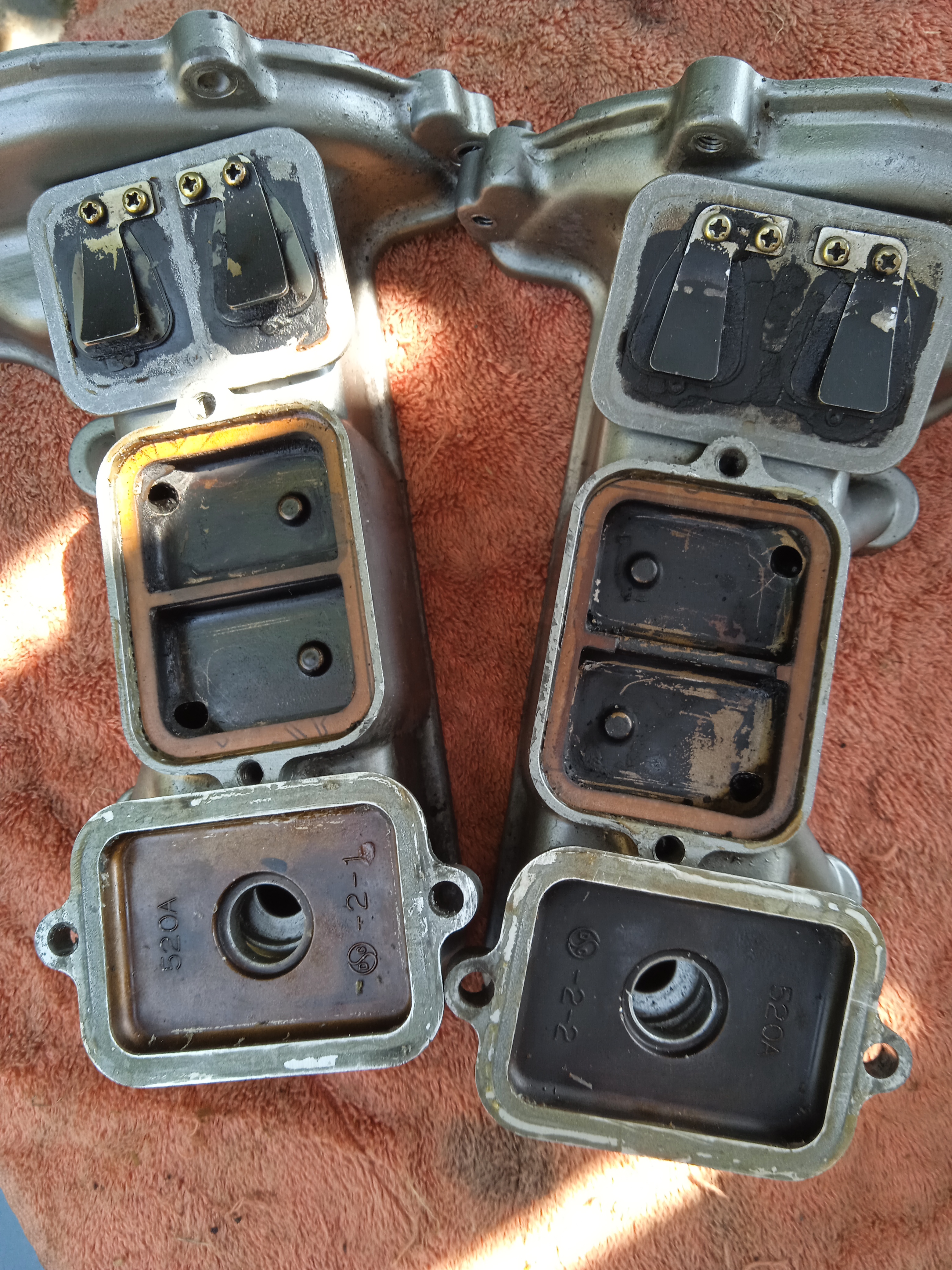

Mark, check your Clean Air System.
On mine the vacuum solenoid is knackered and is always open regardless of how much or little vacuum is applied so the airbox is always feeding air into the exhaust.
The reed valves work but the inner gasket on cyl 1/2 was broken and it was a bit of a mess in there.
When I chucked some air into cyl 2 I thought I heard air flowing in the cam cover but dismissed it as it should be impossible. Having now seen the centre part of the gasket missing.......it was. It was flowing from No.2 across the 'should be blocked off' wall and back out No.1.
Given it all a clean
And now have blocked off the passage ways.
8mm tap, no pre-drilling required, grub screws with 243 loctite
