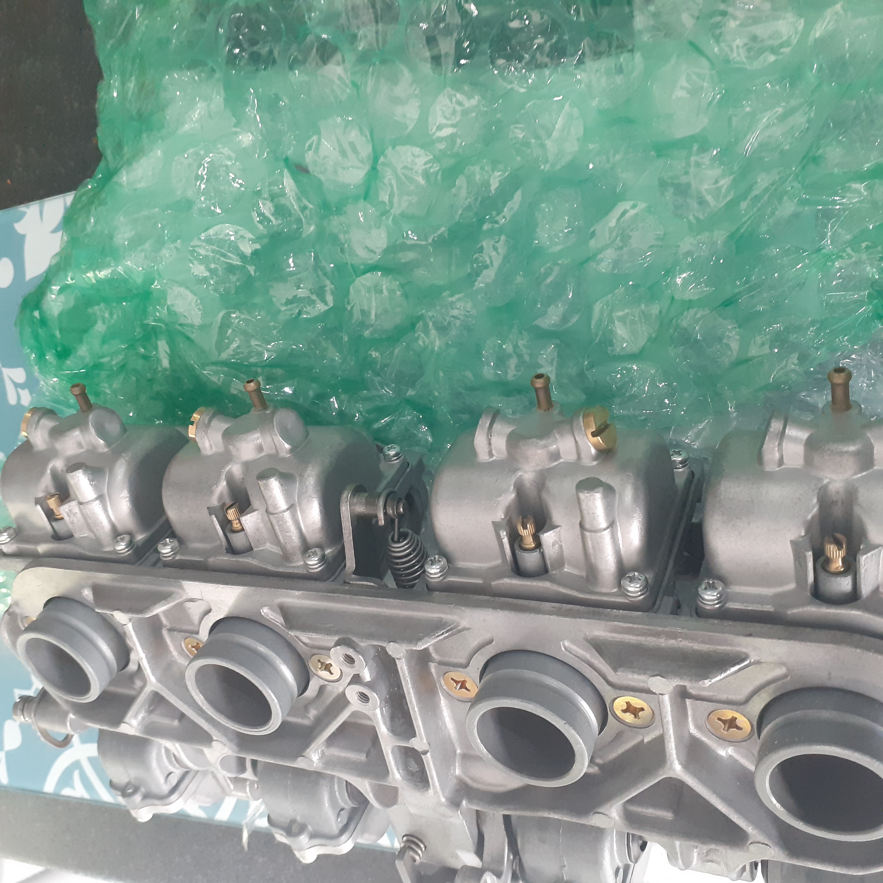

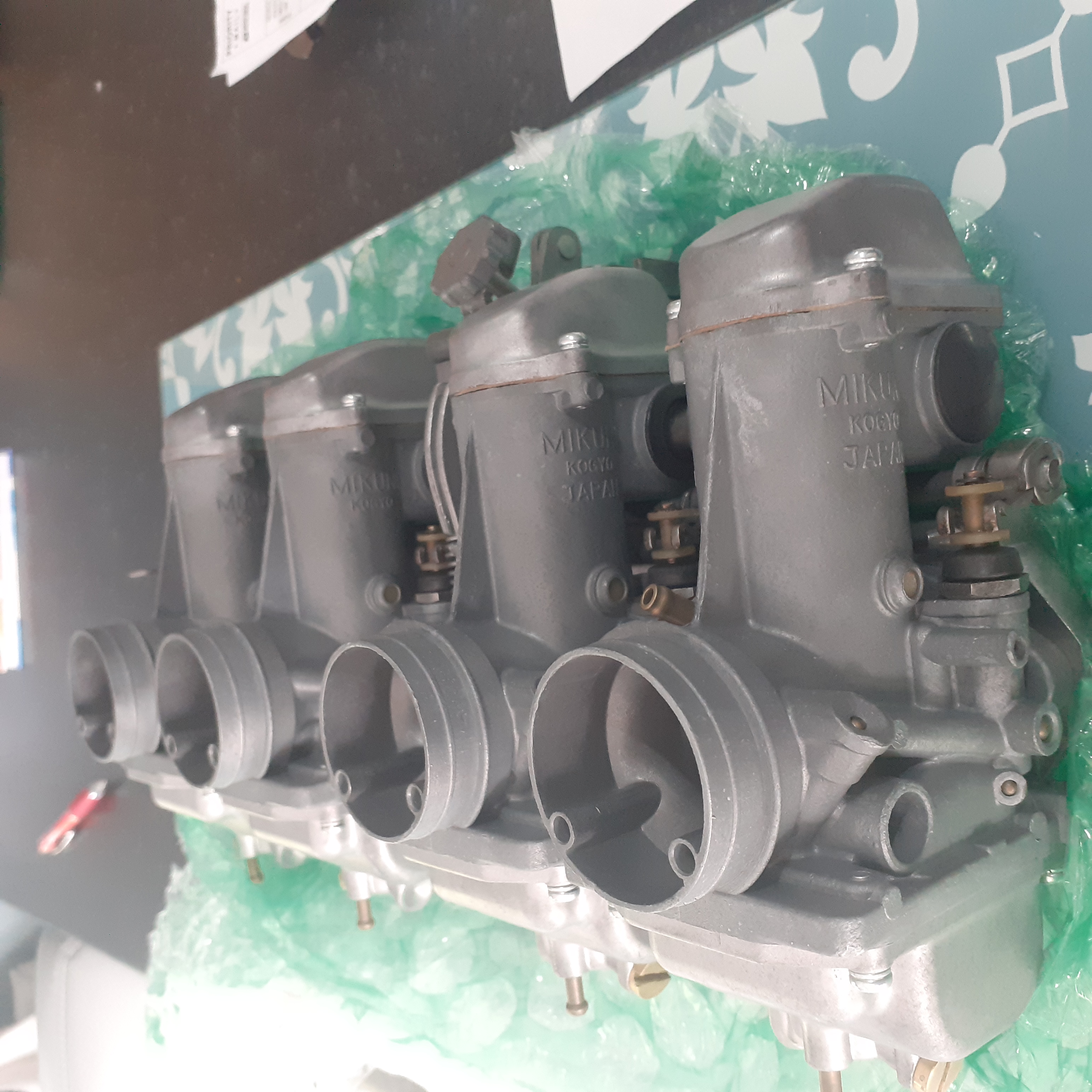

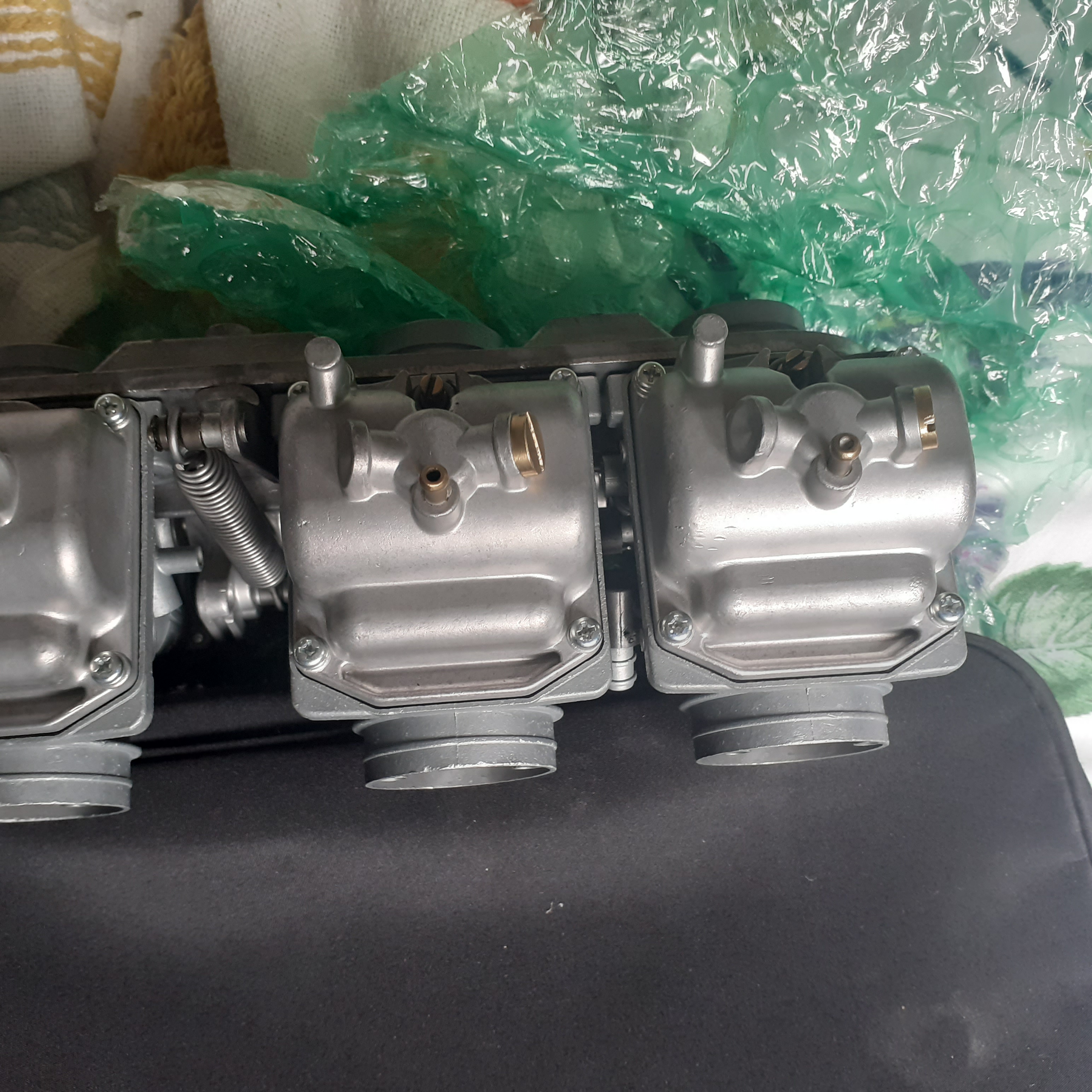

Needing bit of help with these carbs, I'm intending to sell them but want to make sure I describe them properly!
I think they are VM26 26MM carbs with the airscrew on bottom but I cant see any markings or codes on them anywhere, I've been all over them.
As i understand it, the Z900A4 and Z1000A1/A2 use the same carbuerettor?
Advice appreciated, thanks

They were rebuilt by Wired George in the States in 2017 but have never been out the box, i never needed to use them as my Z1000 had a good set but i thought it might be worth having spare ones.
I dont have any documentation now so i cant confirm jetting etc but he did a great job on my Z900 ones that Rob Meggit set up for me.

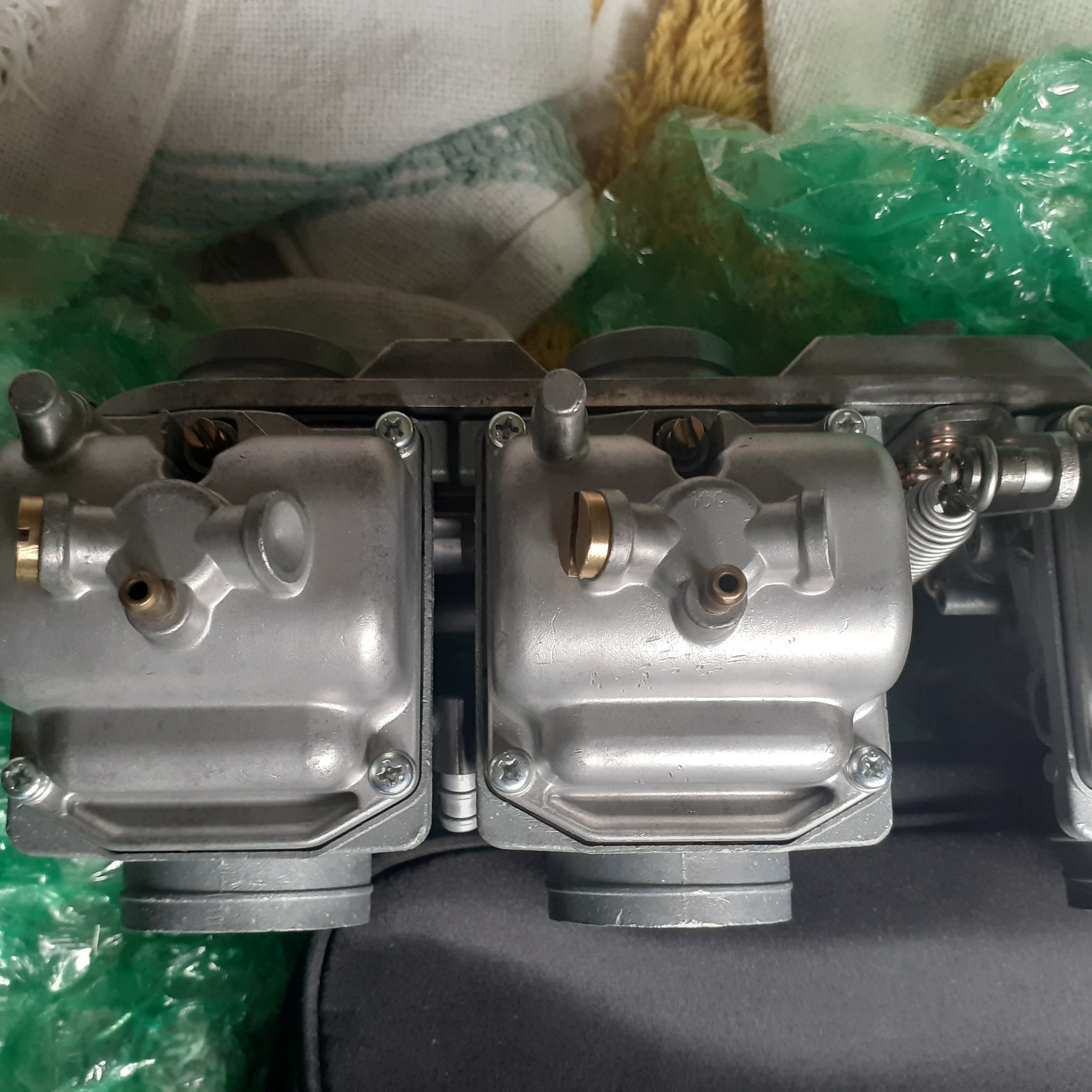

#3 PostAuthor: Garry.L » Sat Aug 30, 2025 6:44 pm
Z900A4 has the air mixture adjustment on the side (airbox end.) A1000A1 has the fuel/air mixture adjustment underneath (engine side).

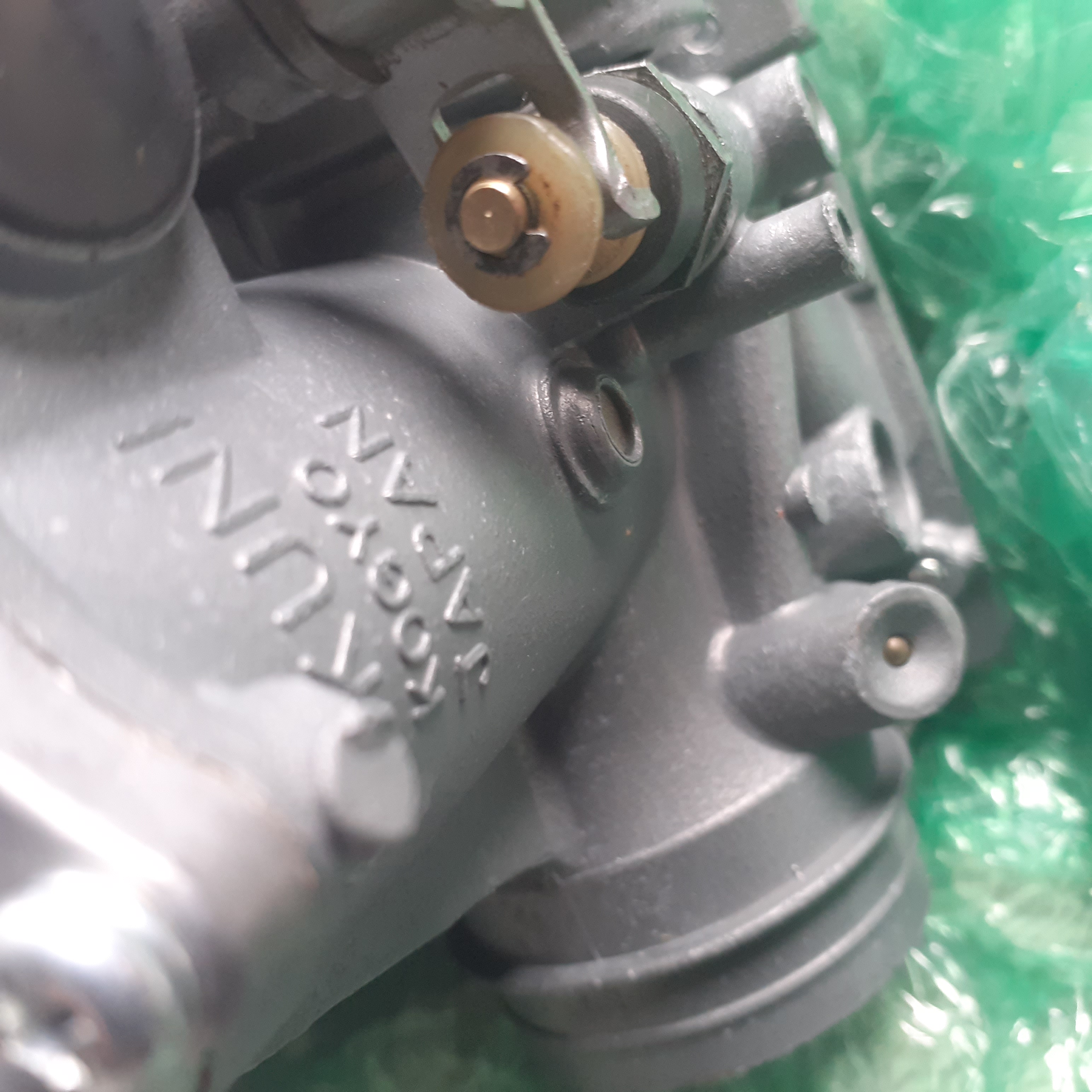

#5 PostAuthor: Ultim8pc » Mon Sep 01, 2025 9:38 am
To be certain find the carb ID which is stamped onto the top front of each flange (engine side).
I have a lookup table of carb IDs:
https://airevalleyclassics.co.uk/images/source/articles/carbtablem.jpg

#6 PostAuthor: Mark Tiller » Mon Sep 01, 2025 11:51 am
look like 1000A1 or 2

#7 PostAuthor: dave cullen » Mon Sep 01, 2025 5:57 pm
Ultim8pc wrote:To be certain find the carb ID which is stamped onto the top front of each flange (engine side).
very hard to see, but looks like 299 there, i assumed they were A1 carbs, many thanks please see for sale forum if interested
