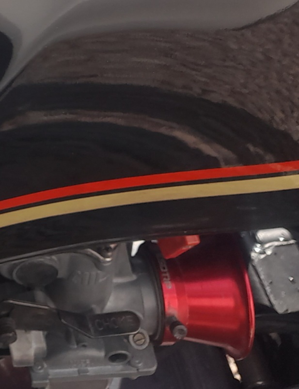

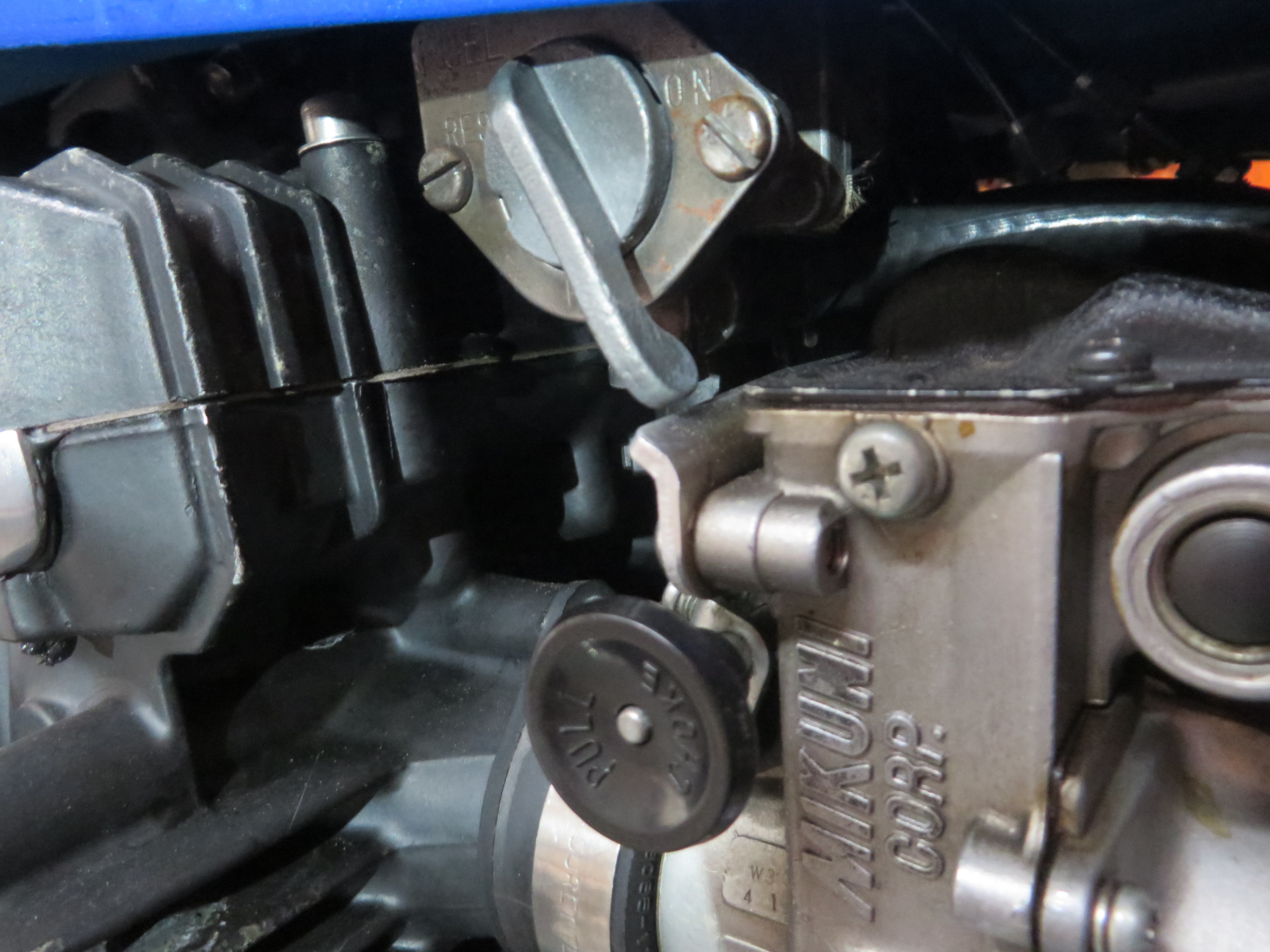

I've got bored out VM26's on my J and tank wouldn't seat because the original tap hits the carbs top. Had to make a feed plate and run an inline fuel tap. Anything can be made to fit.

RS 36's on a standard tank and tap on a J1 and you get about three mm's and thats with the back of the tank lifted by about 1/4 of an inch.
