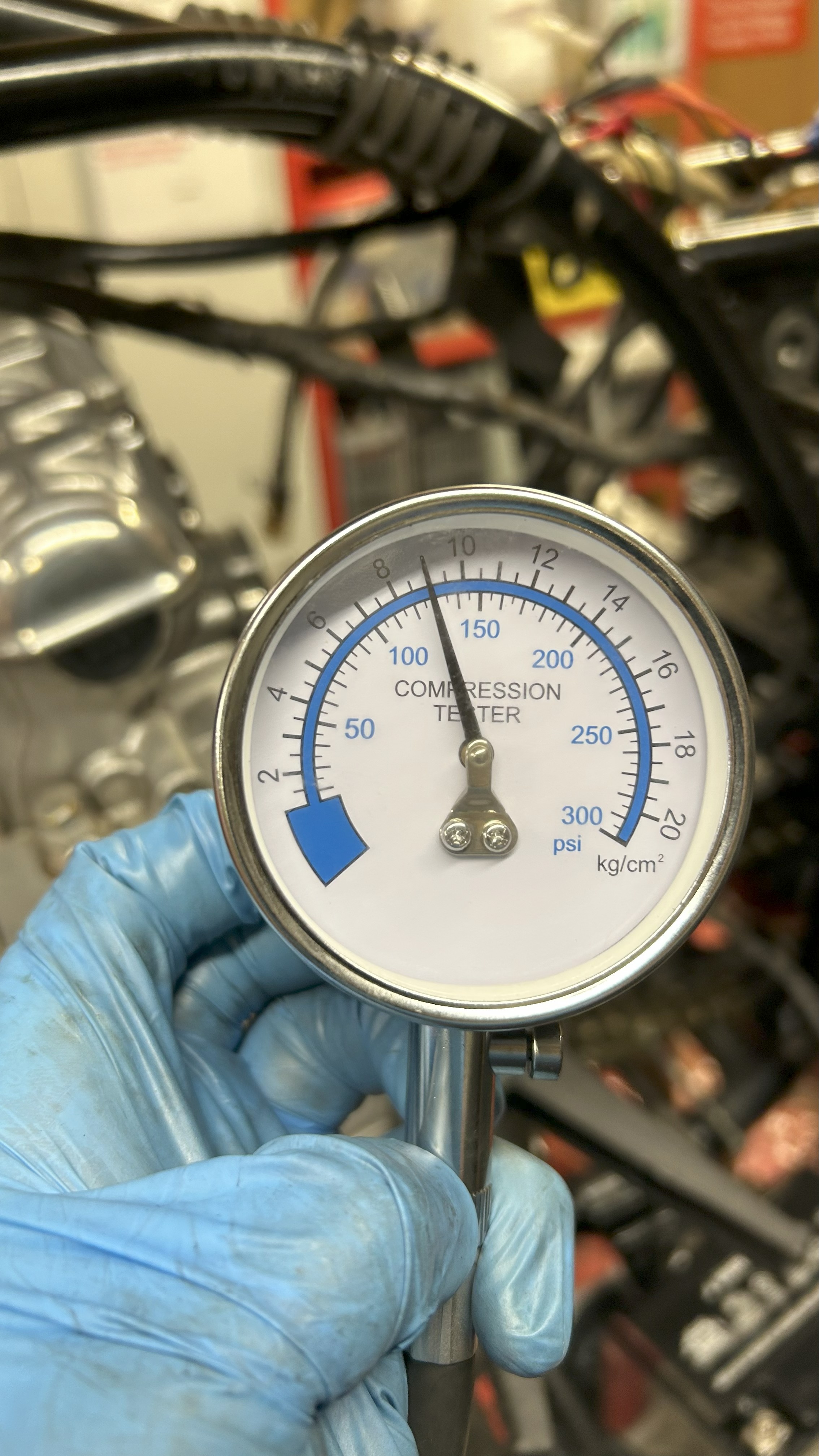

#8 PostAuthor: Mally » Tue Oct 07, 2025 12:05 pm
Finally sorted out wiring , earth fault , new harness and reg/rect from ZPower on order as its totally fkd .......will by 50 years old next year!!
Hooked up starter motor direct to battery , turns over freely, more importantly getting 130PSI on all cylinders , guess the kickstart wasn't enough to raise the compression sufficiently.
So top end strip down not required ! Happy days. :D

Apart from getting 130 PSI.... which gives me an idea that the bores and valves are probably gonna be ok.
