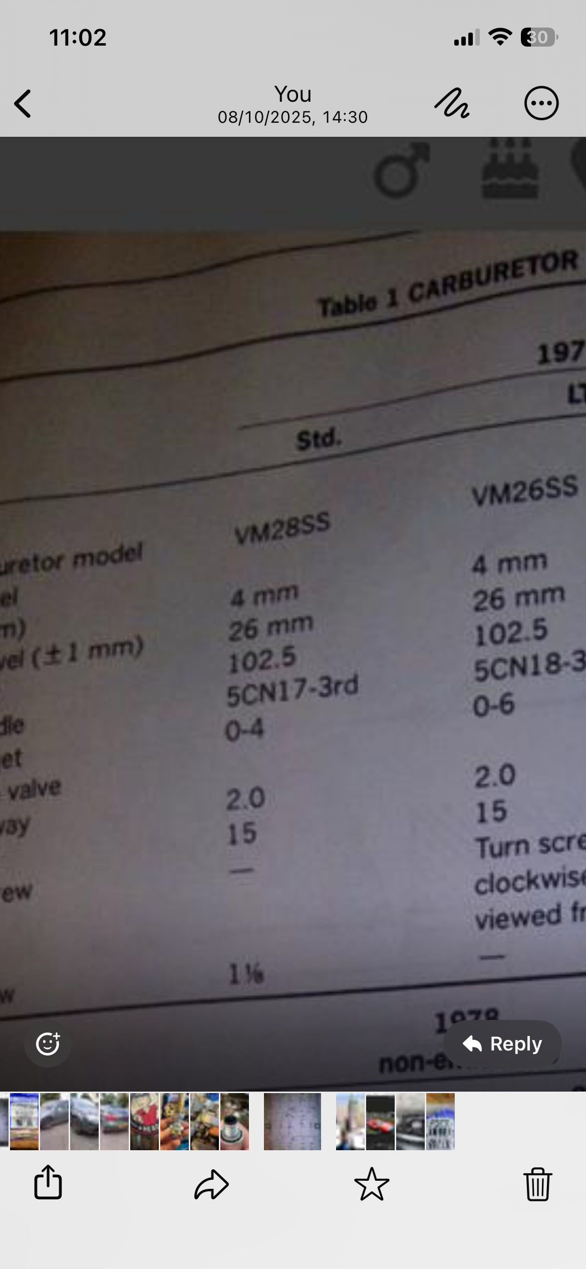

Your jetting is vm24 650 sizes which is too small for 1000cc. You've got bigger throats with smaller jets.
Spitting back through the carbs is mostly due to a lean mixture/air leaks.

Maybe (see attached), and obviously I know about the air leaks because im posting about the actuator seals which will affect the vacuum. I was hoping someone might have changed the seals and might be able to help regarding where to source replacements. Bike actually runs and starts well when warm and no sign of lean mixture except on start up

Warren suggested a weak mix causing the spitting back. The table suggested the air screw 1 1/8 from fully in , and you have them 1 1/2 out you said. That would make the closed throttle mix too weak , by flowing more air
