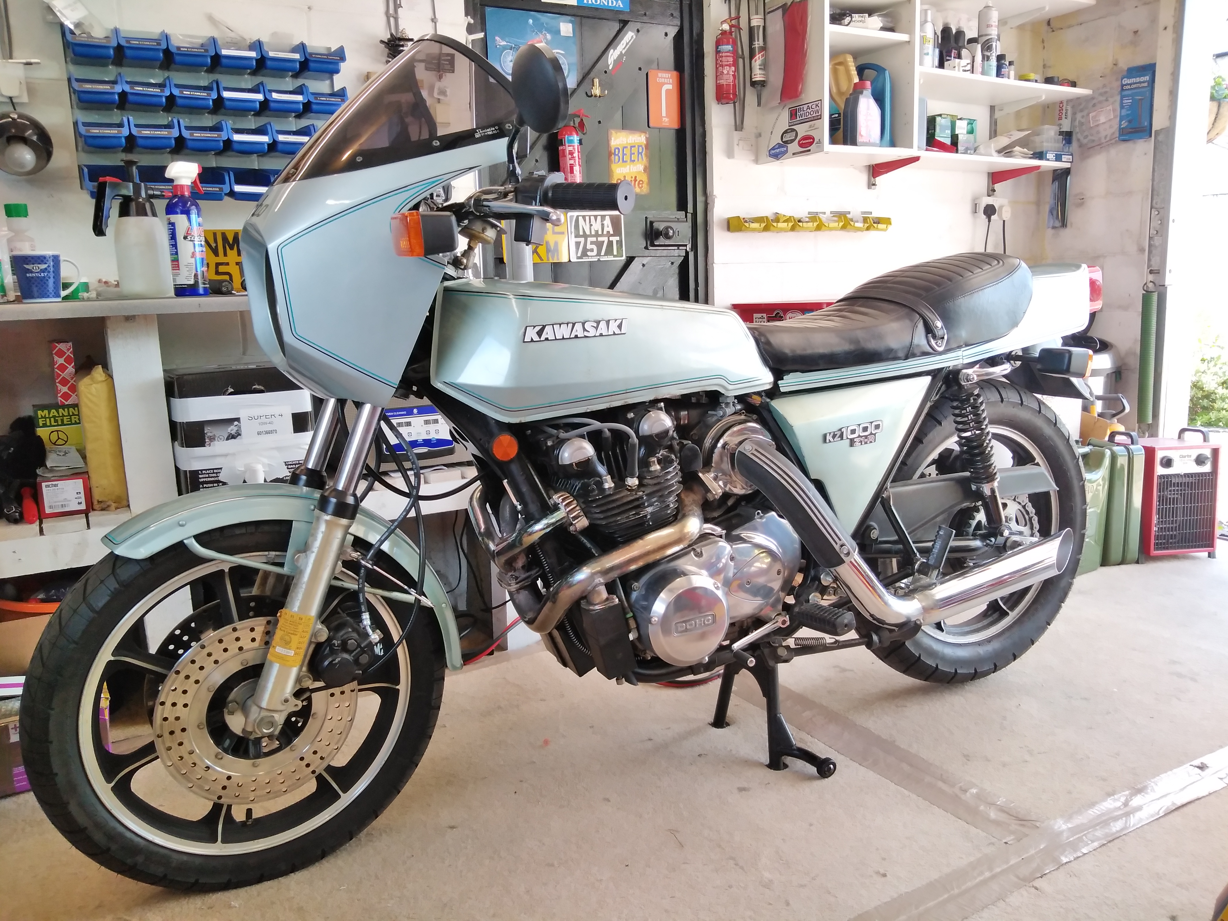

Awaiting a full resto, but I'll be on it next week stripping it down and getting it sorted.
It's just the cosmetics mainly to attend to. However I will be also doing some internal upgrades of course :lol:
1198cc, Egli oil pump, Egli deep sump, anti-surge plate, welded crank, APE studs etc, Super A-flow 370 Rajay with ported scroll, APE valve springs, Dyna 2000 with boost retard, Mikuni HSR, loads more............ it will be real nice when finished and bomb proof.

Having seen the bike it's already a nice original unmolested TC and as good as they look in Molly Colours the Stardust Silver really suits the lines of the bike...
Already Looking forward to my Test ride. :roll: :wink: :lol:
