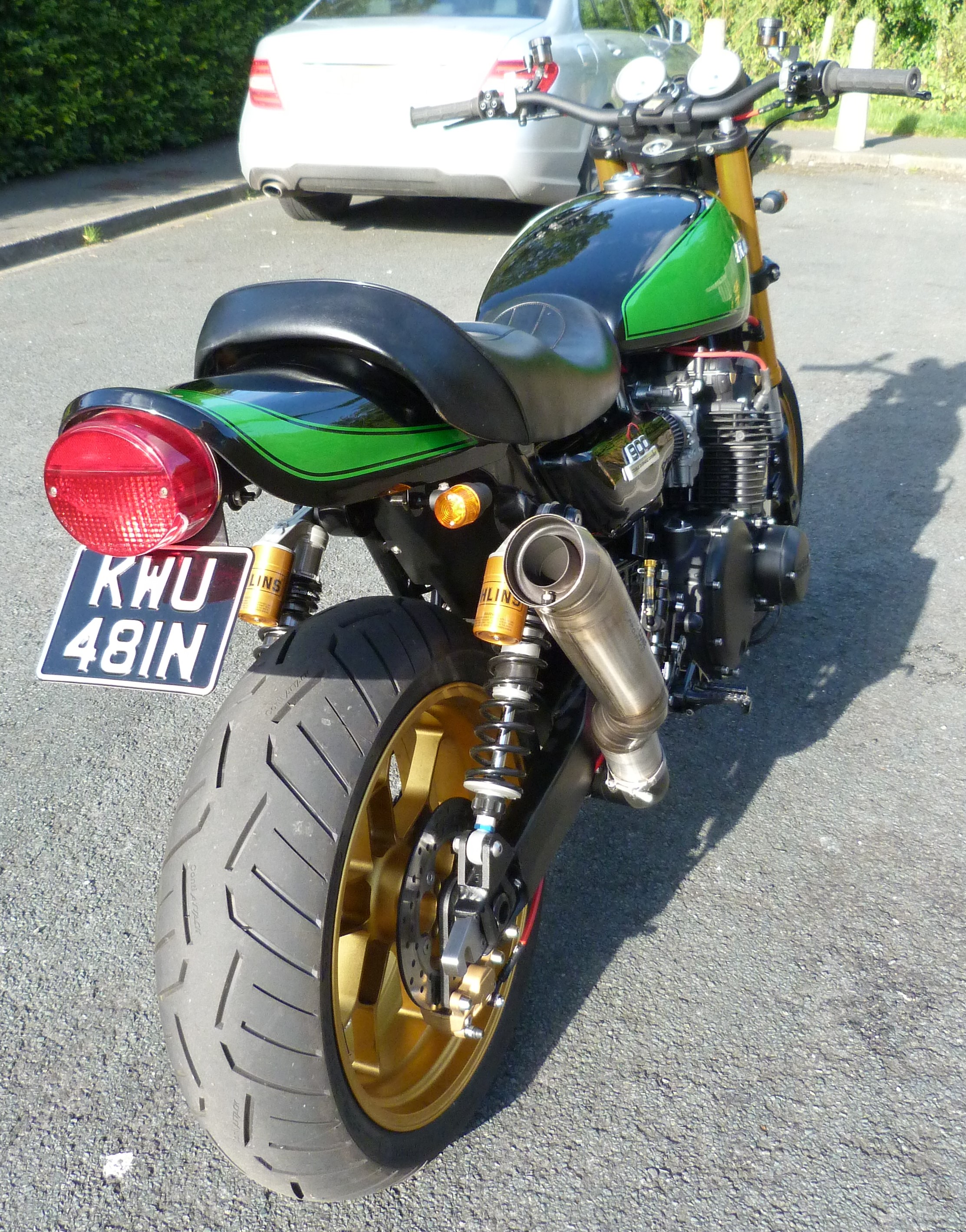

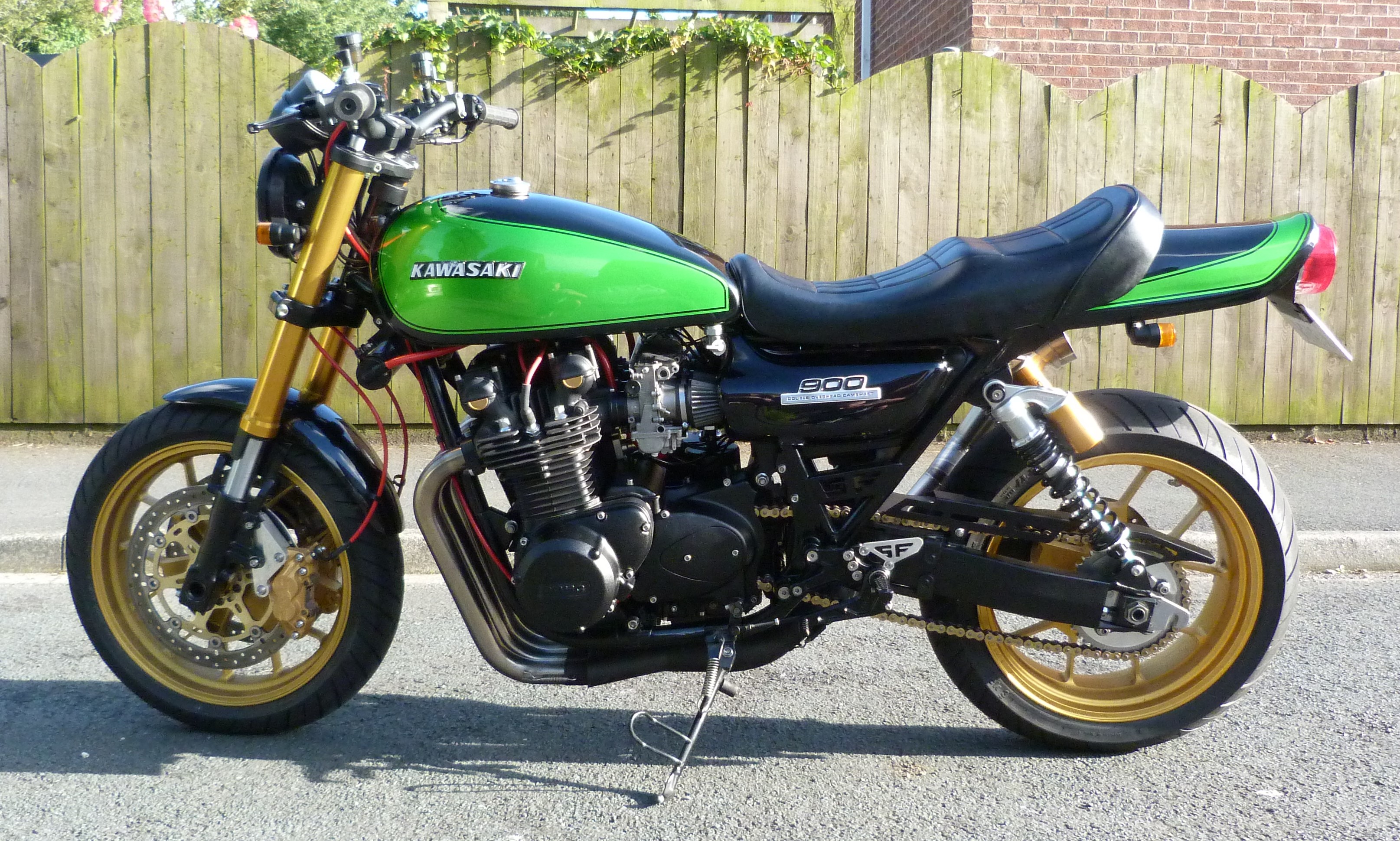

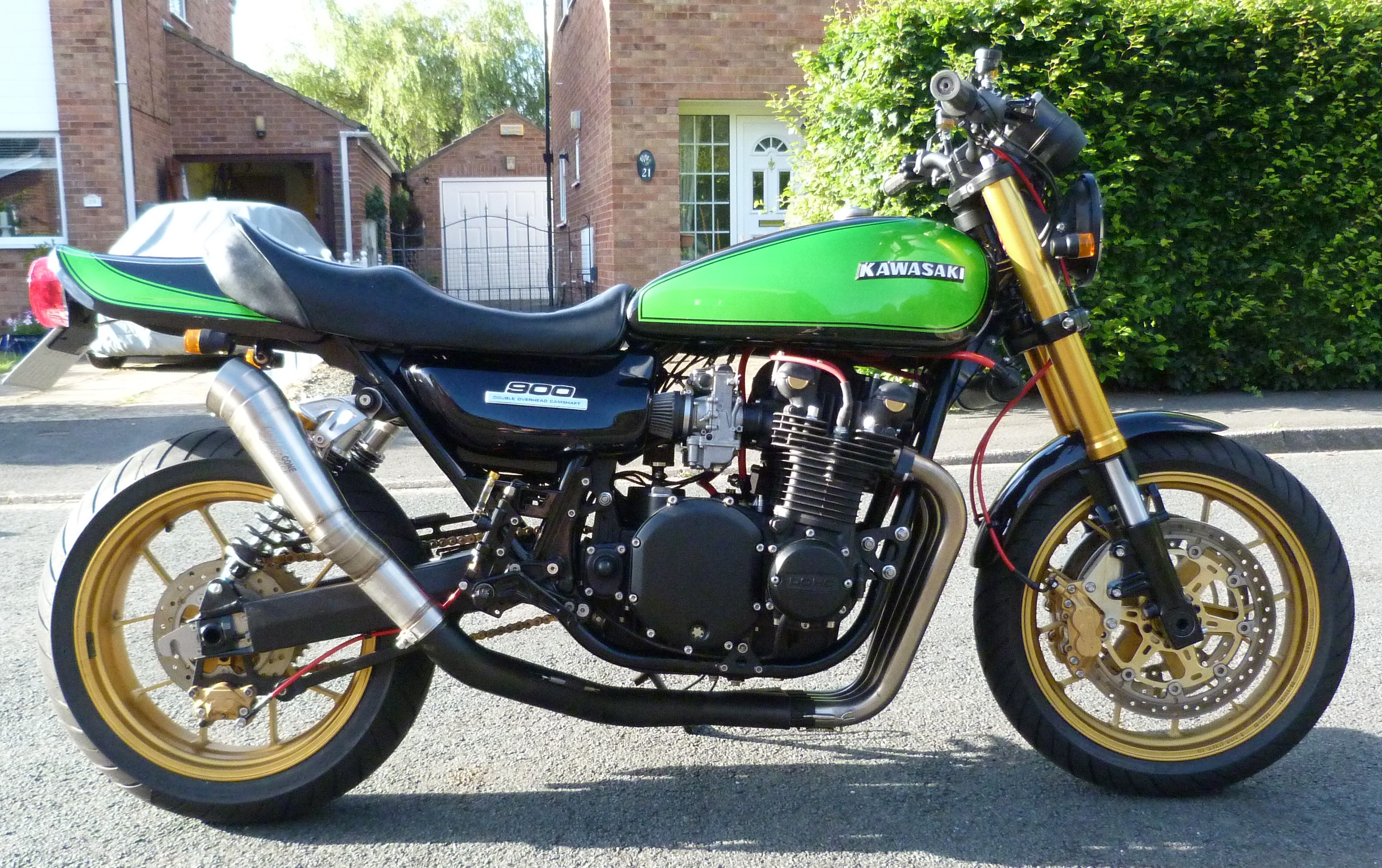

Just finished after 2 1/2 years of toil, total engine rebuild & far too much money spent, first run out at the weekend a few niggles like a flashing oil light hopefully
down to having LED bulb fitted.

Major effort and spotless finish mate but you cant leave the mob hangin here, few details on it, those look like Triumph Tiger 1050 wheels..

Hi, the wheels are Aprillia RSV Factory OZ, swing arm is modified TL1000, front & rear callipers Ducati SP2, front end is ZX-9 B2 & exhaust is cobbled together with
what I think is a Z1000 end can. Its got full Motogadget Bluetooth electronics system with LED lighting, just wanted it to be reliable spent far too much time by the side of the road waiting for a mate with a van to pick me up in the past.
