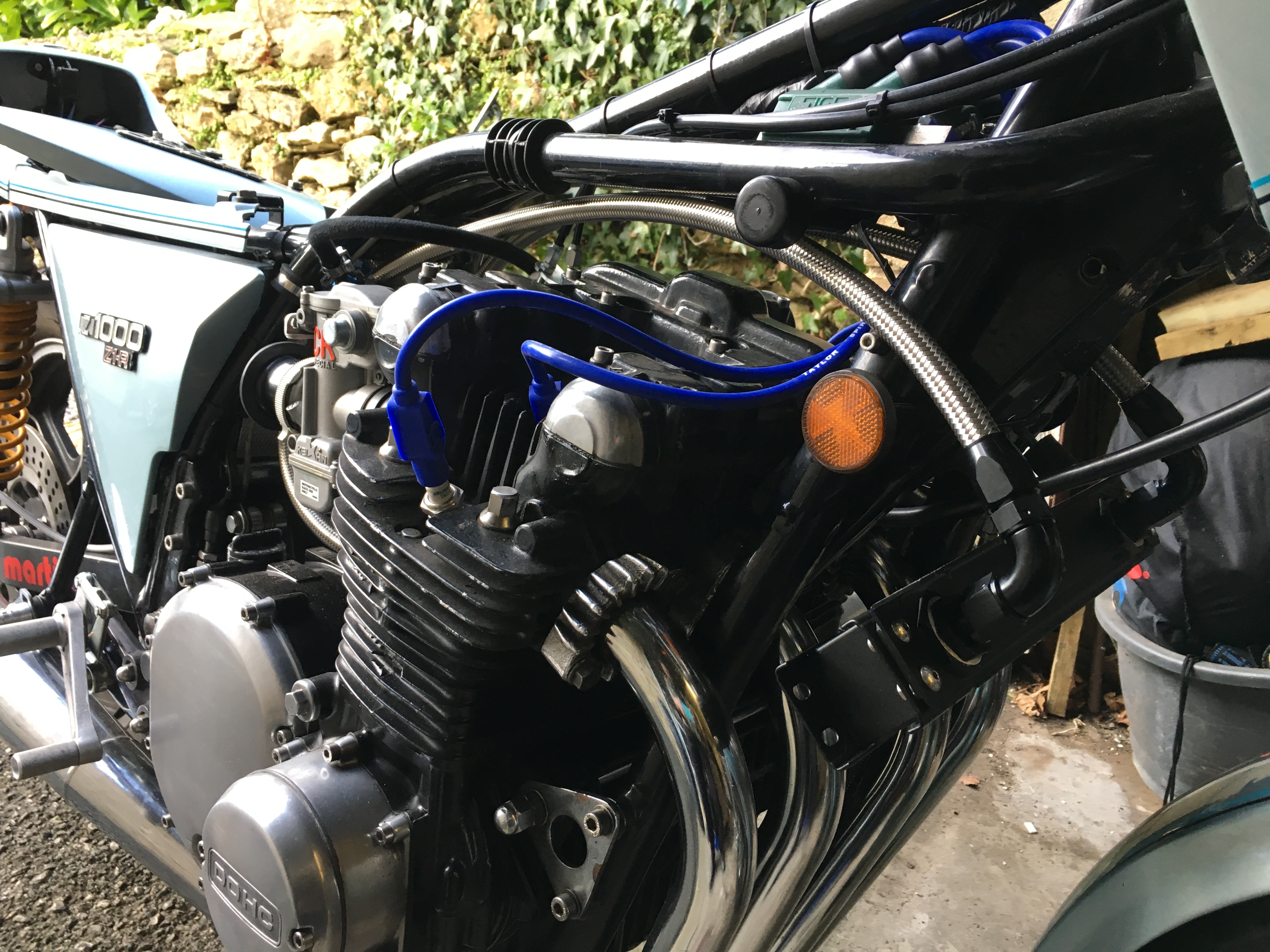

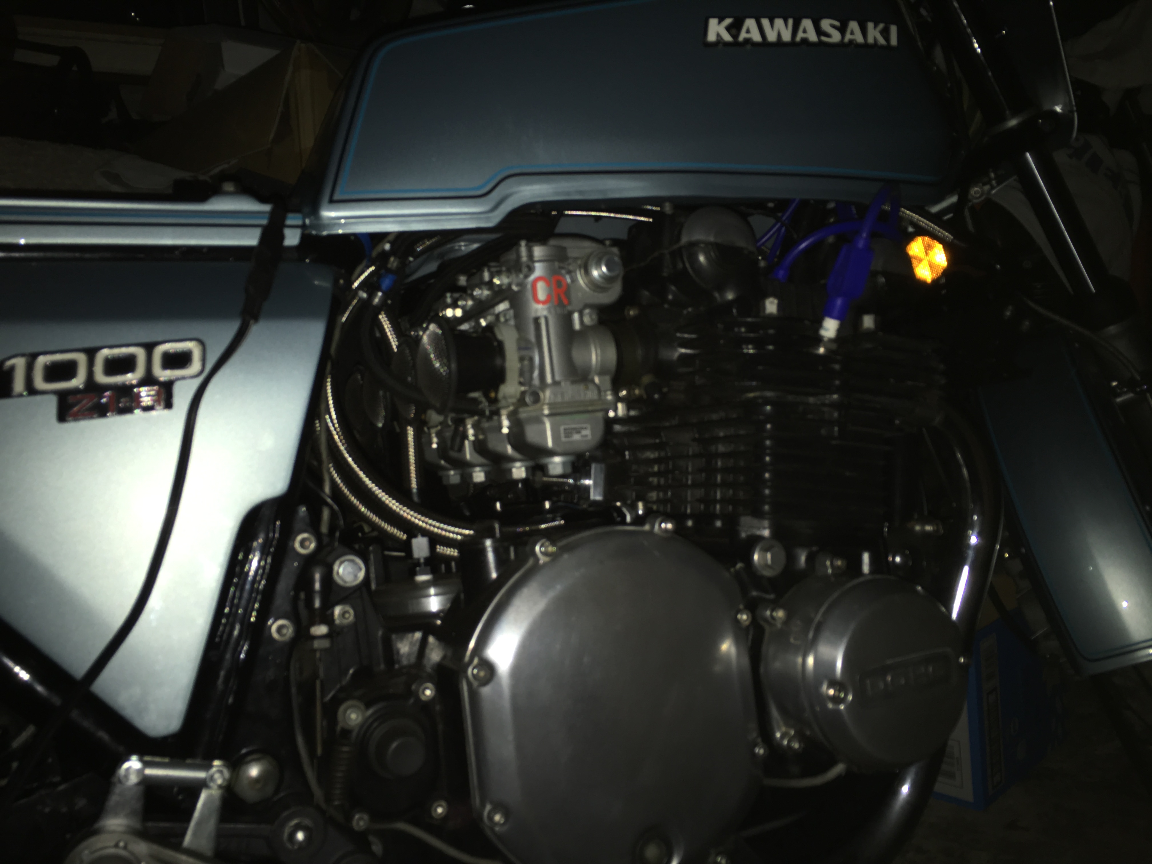

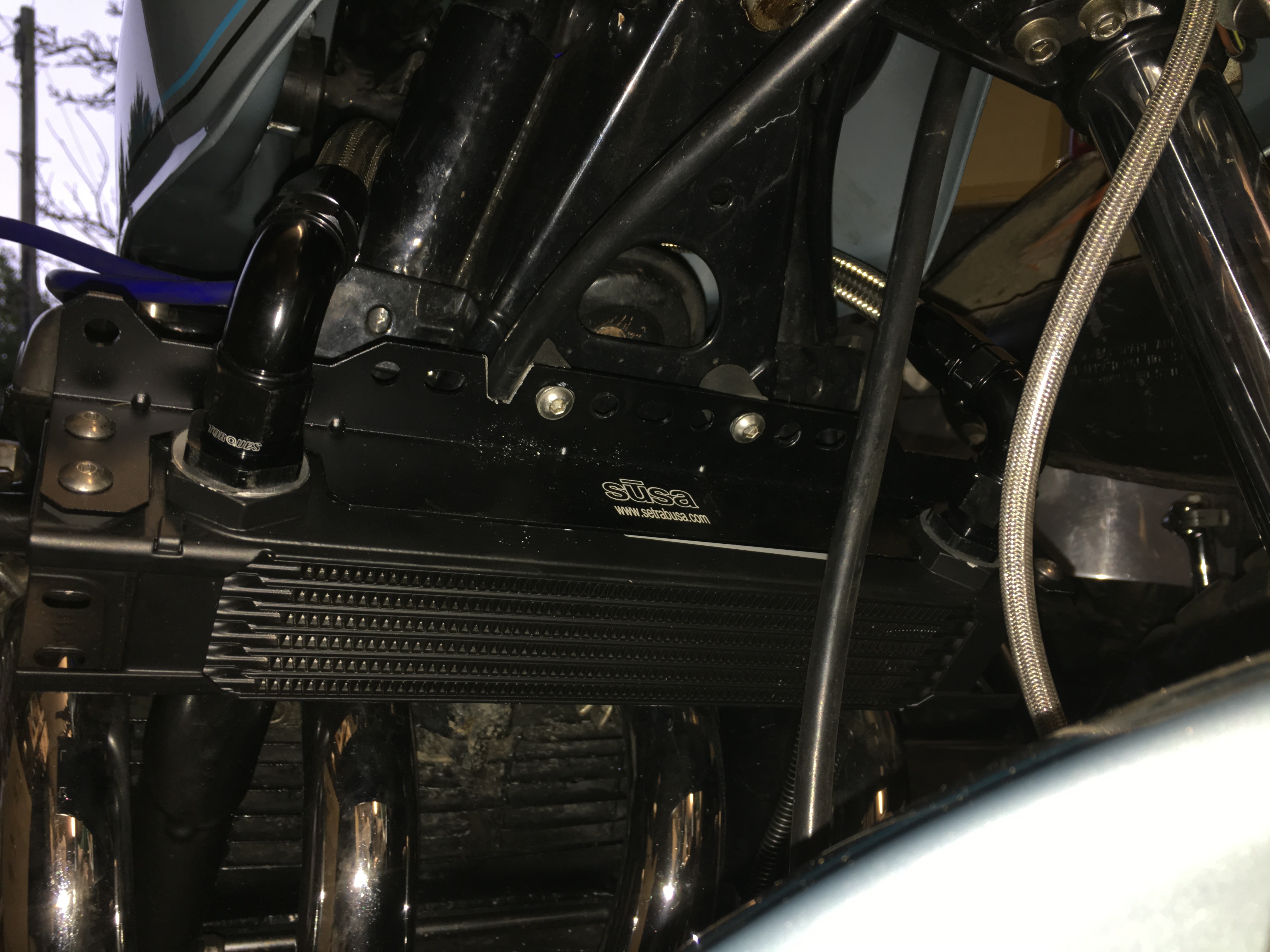

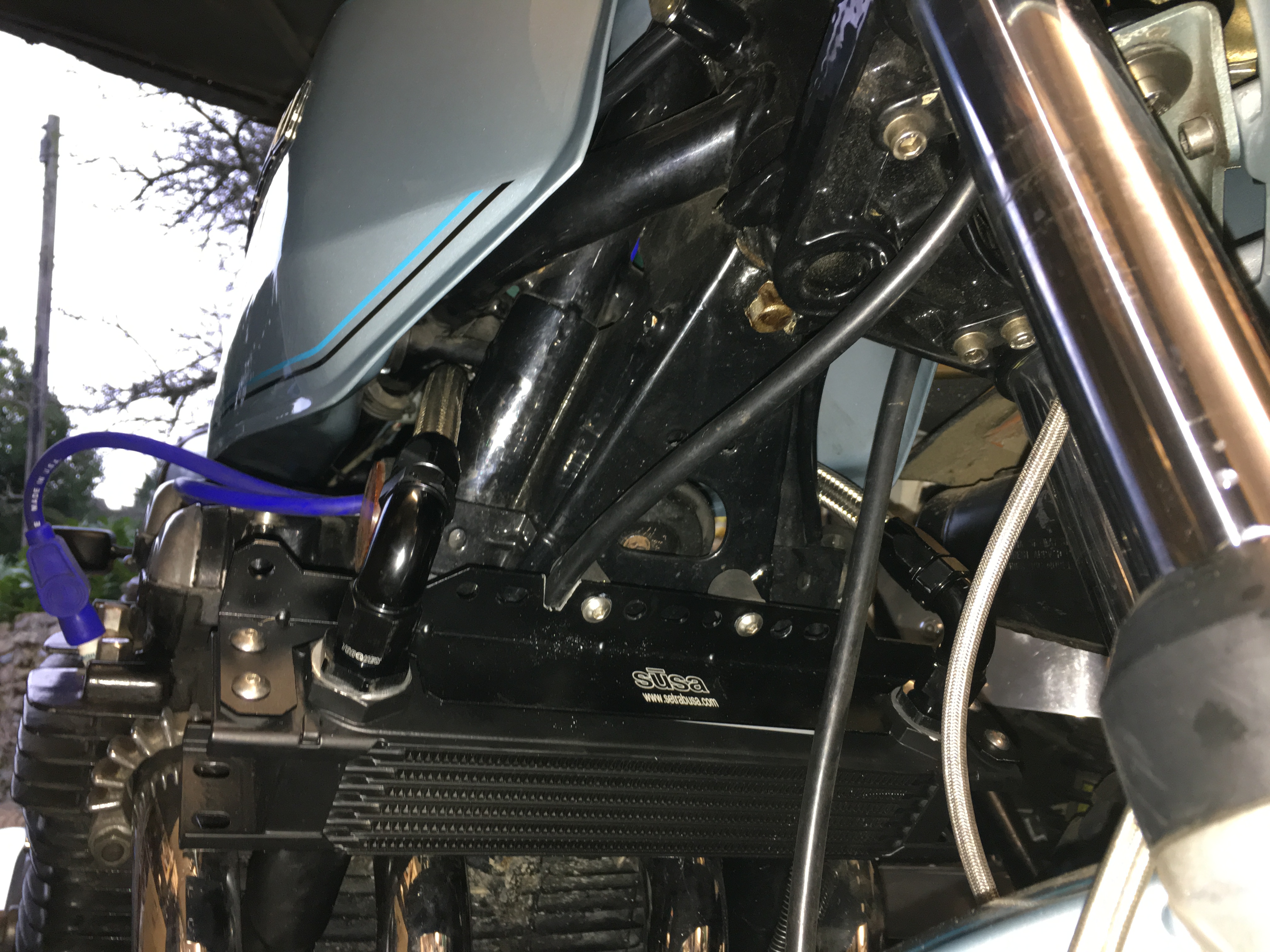

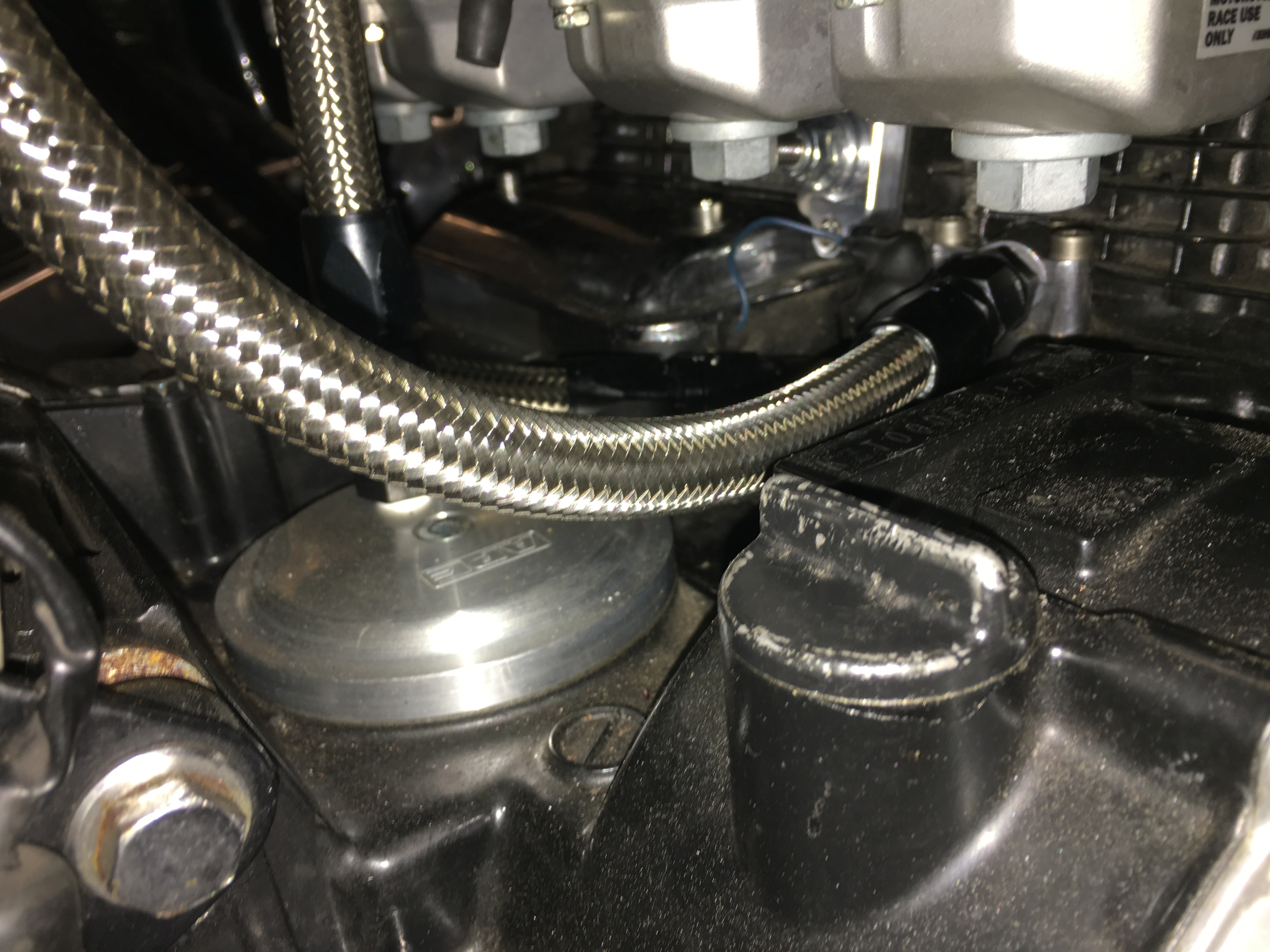

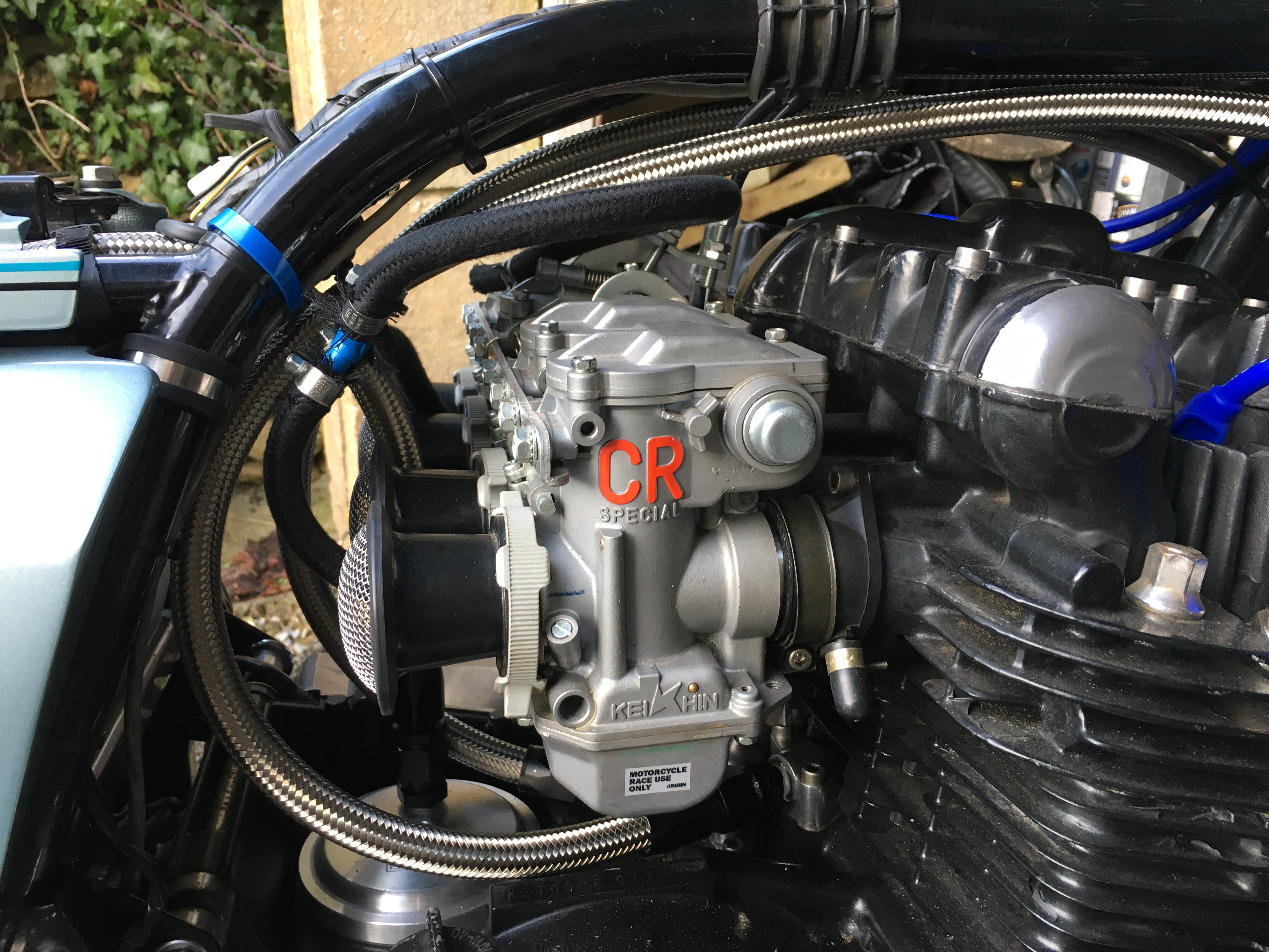

Had a bit of spare time and tackled a few bits........ firstly fitted a manual cam chain tensioner. This involved removing seat, tank & carbs, so also swapped the blue fuel line for more subtle black braided rubber hose. Also fitted a set of mesh filters on bellmouths - did remove the fine mesh & nylon filter material sandwiched in between so not fully filtered, but keeps air flow up.
Next it was time to fit the oil cooler take offs - then plumb in the s/s braided hoses & AN connections.
Decided against the thermostat as the hose is 12mm, but barb connections only 10mm on stat :roll:
Got it all buttoned up and even had time for a brief test-ride this afternoon.

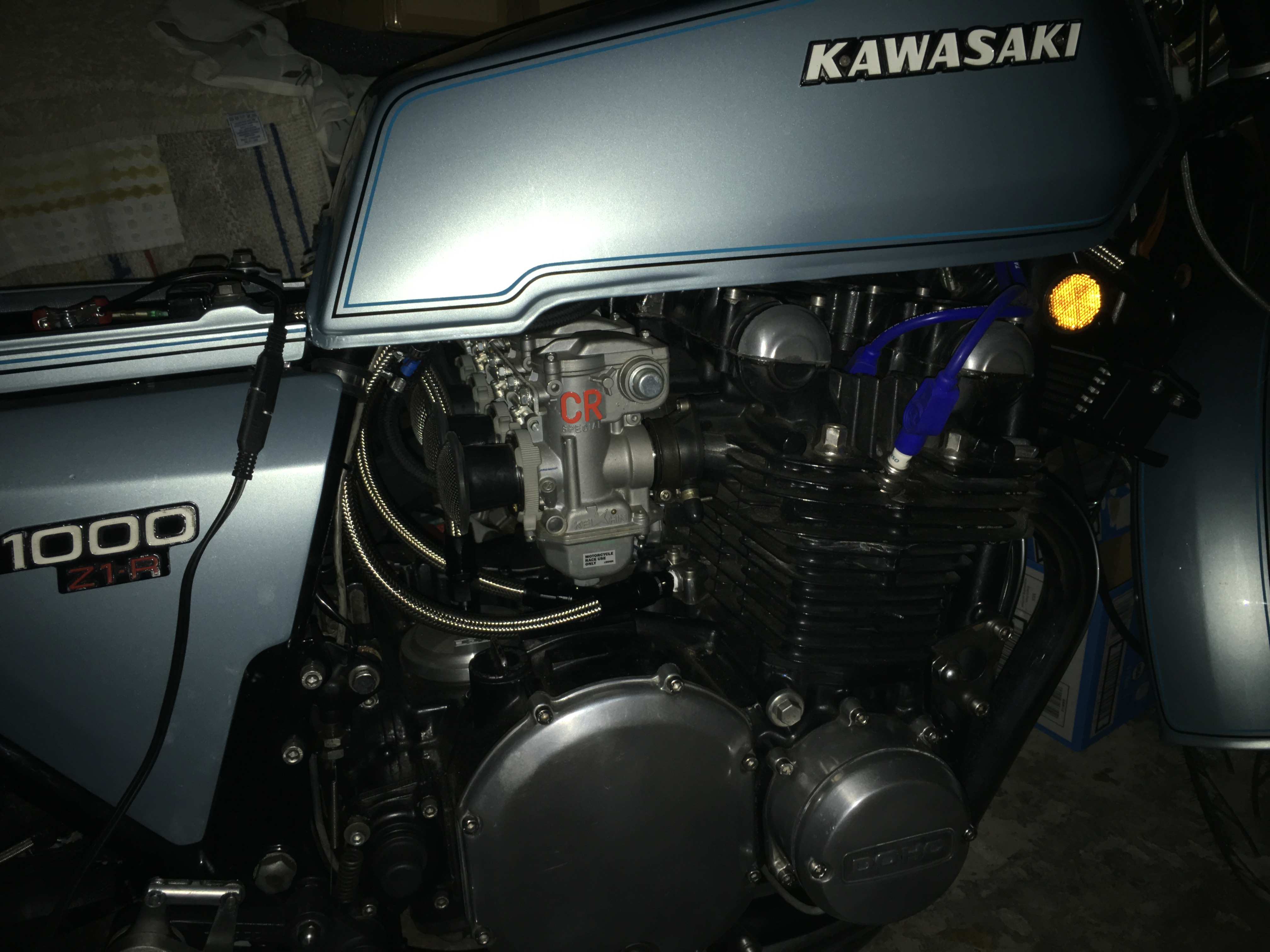

Better side view:
