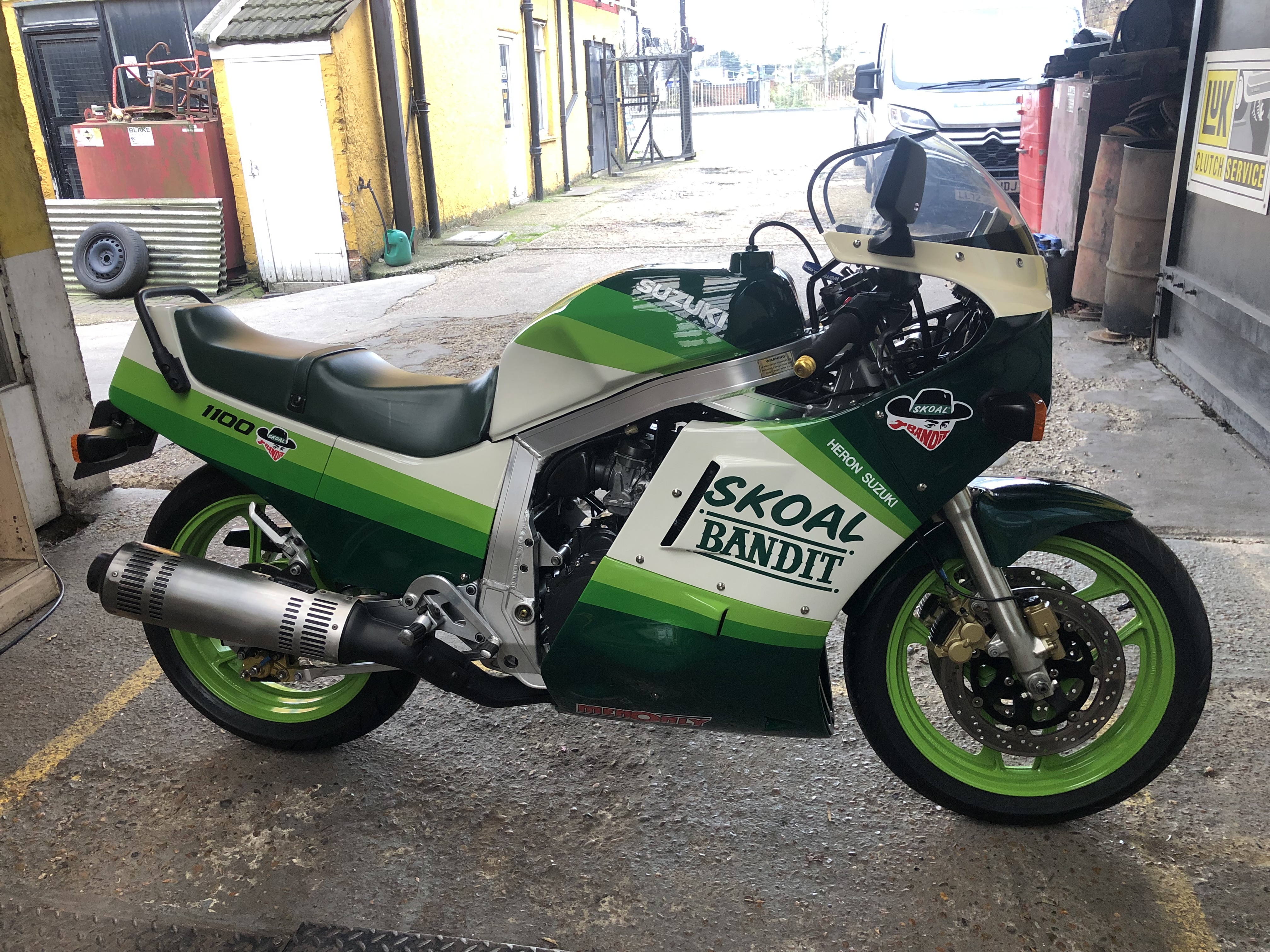

I bought two bikes from the family, the Z1R and nice 1986 Suzuki GSXR1100 which needed the least amount of work so I started on that first which I finished in mid December.

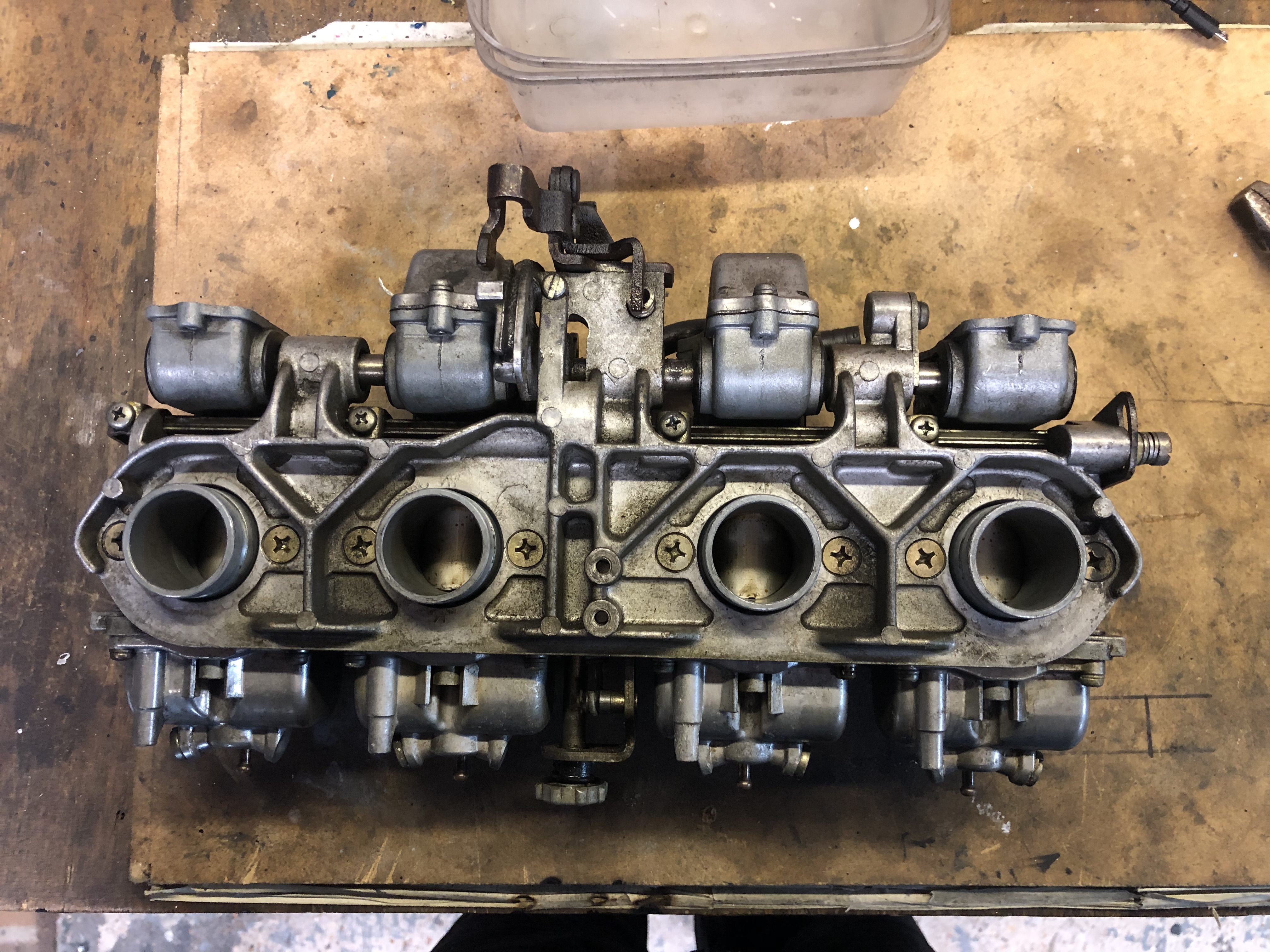

I started on the Z1R last week, washed off 34 years worth of dust then fitted a new battery to see if the engine turned over and if the lights work, the engine span over nicely and all the lights worked.
First job remove the tank and empty out over a gallon of 30 year old petrol, which had been turned a dark orange by the rusty tank.

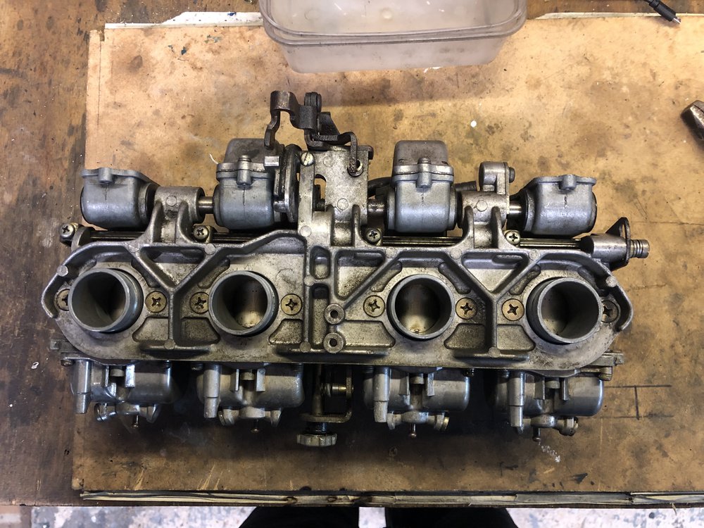

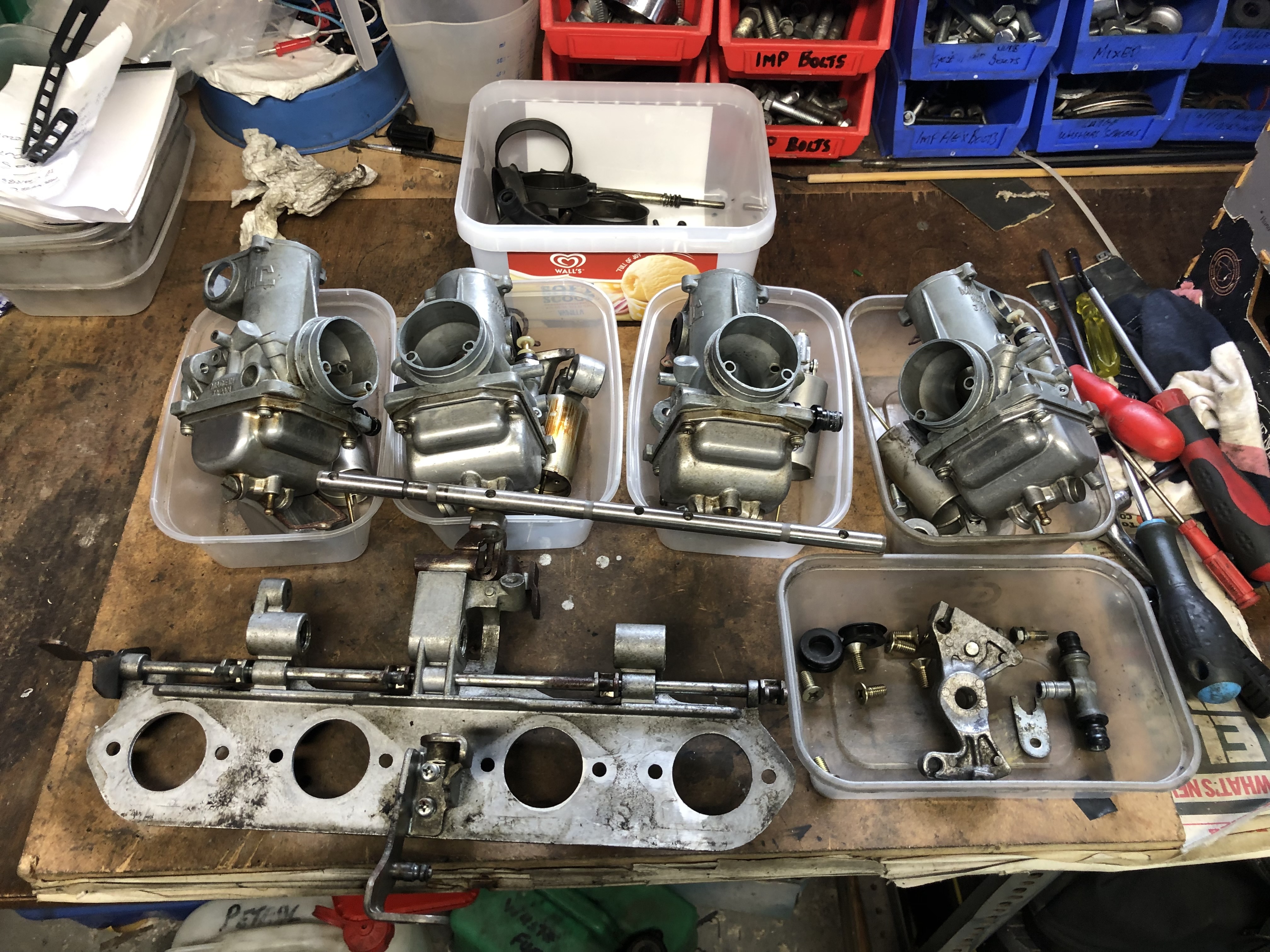

Next, remove the carbs and dismantle them to check the jet sizes and make them ready for ultrasonic cleaning. What a pain of a job to undo the screws holding the inlet rubbers onto the air box, getting them back in is going to be worse, surely there’s got to be an easier way to remove the carbs, any ideas on how this can be done will be gratefully received.
Checking the jets and they all seemed to be the right sizes except the main jet which had been changed to a plastic one size 120, maybe because of the straight through silencer even though that seems a bit big, I ordered a Keyster repair kit that seems to have all the seals, o-rings, gaskets etc.

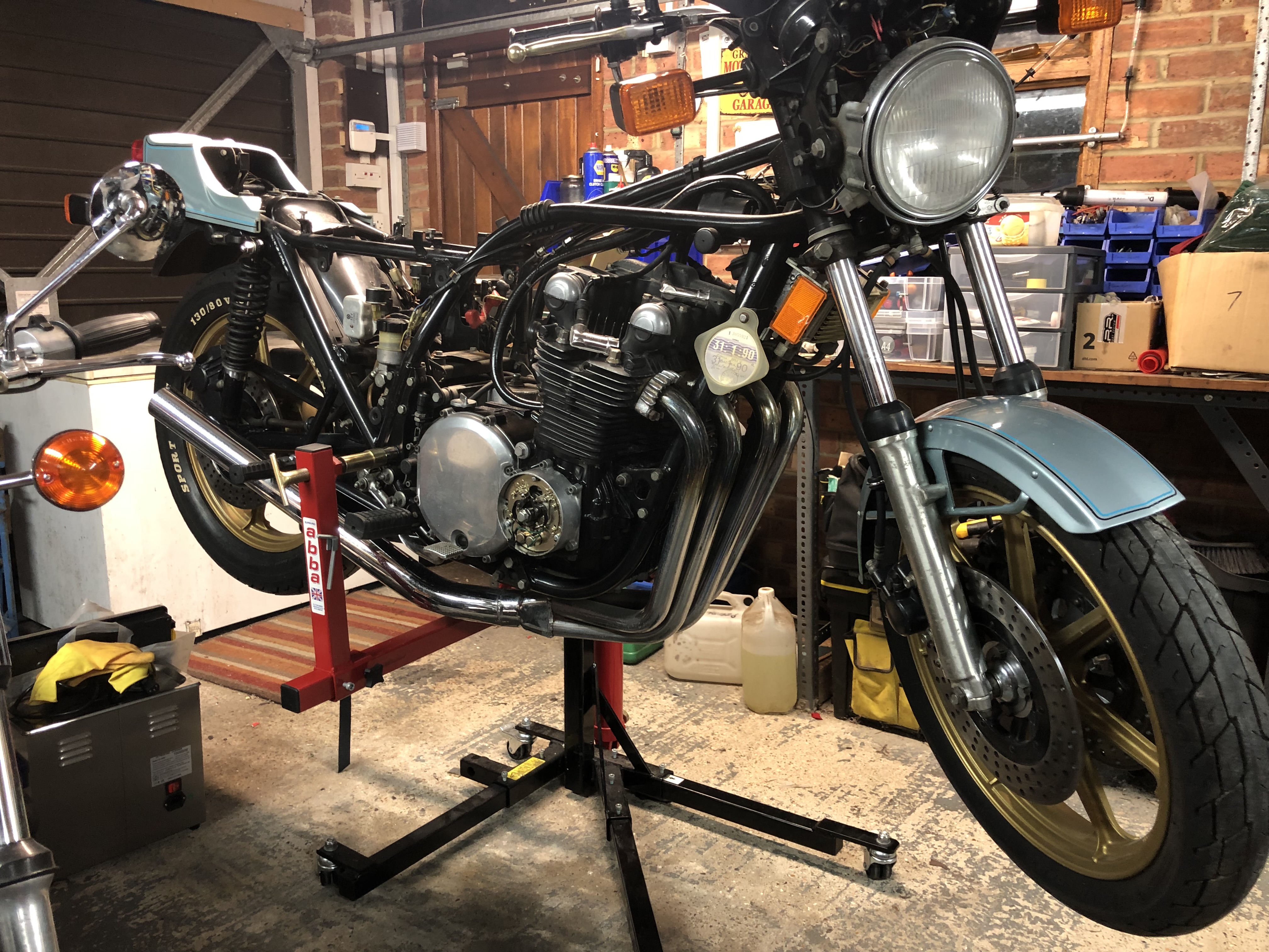

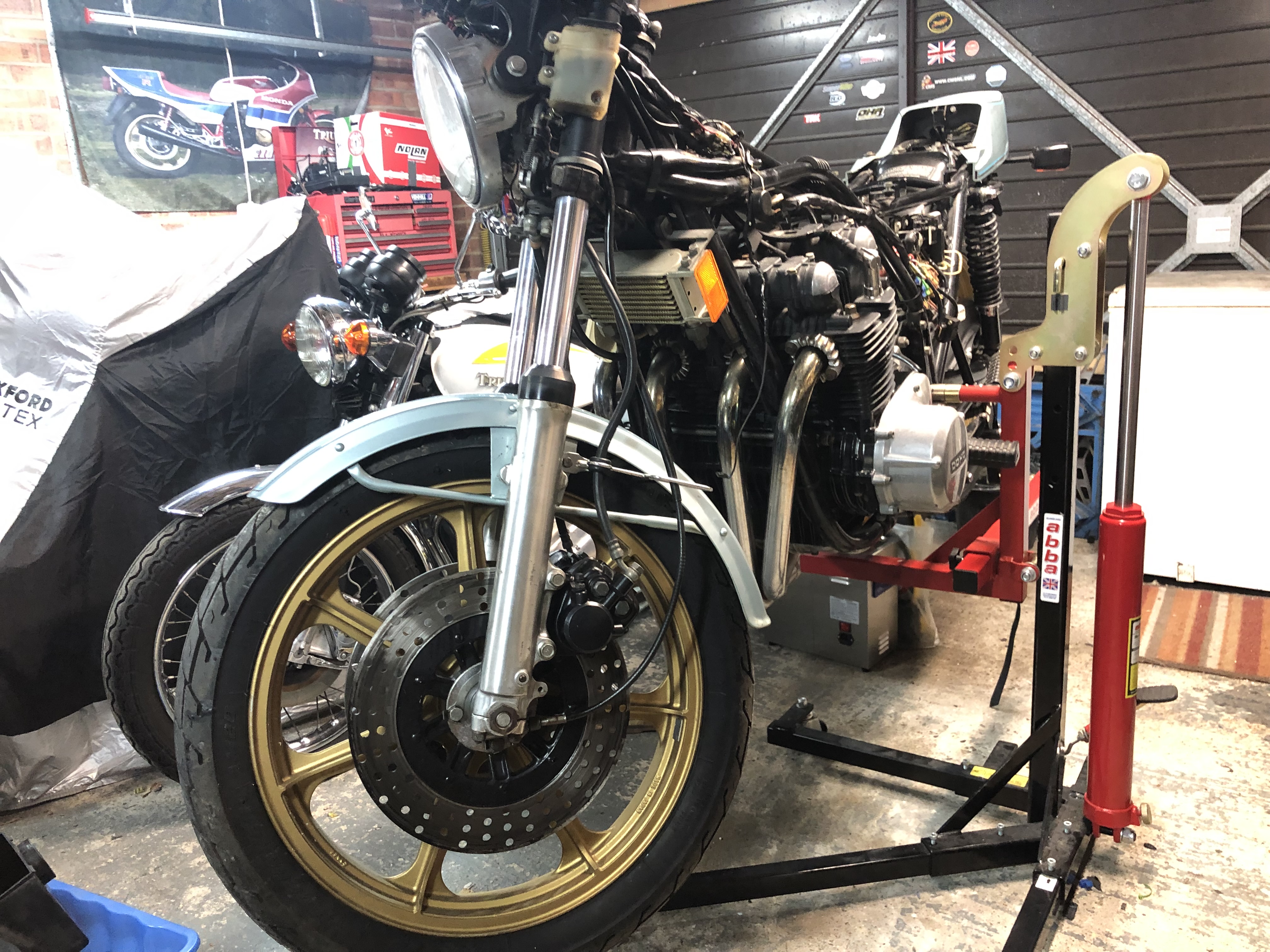

Hi peter55 I see you have a abba lift are you using it to lift the z1r ? Did you get attachment for the z1r from abba lifts

Yes but you need to tell Abba what the head size of the nuts you want to go onto, I think they are 19mm, I’ll check tomorrow, their records only go back to 1984 so anything earlier they won’t know the size. I think to buy the complete set is very expensive, I buy my adaptors when I need them.
I’ve found the Skylift is a great tool, I replaced my ramp with it and have the adaptors for all my bikes British and Japanese

Sorry I didn’t get back sooner, don’t know where 19mm adaptors came from, they need to be 22mm on the right side and 24mm on the left.
Well worth keeping and using, I’ve got an Abba stand and the Skylift and use them all the time even for cleaning ,all the time I was working on the GXSR it was on the Skylift, for me it’s better than the ramp I used to use.
