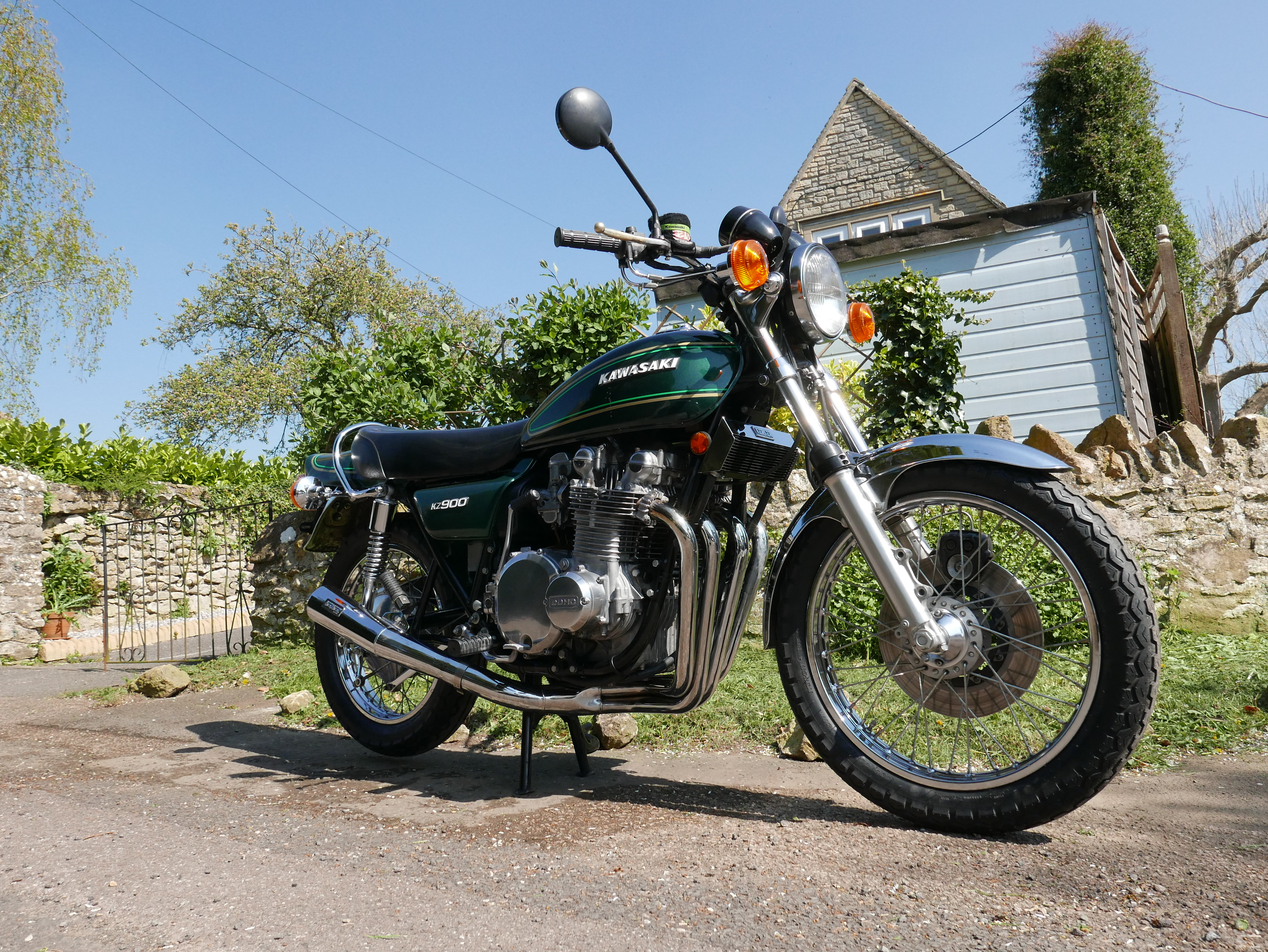

Re: My newly acquired '77 kz900a5
Righto,
Carbs back in all running well!
Just a few little bits n bobs to do:

Anyway, it a decentish day so decided I'd take a few photos.
Top work Nigel that is a really nice job
LUSH - only thing to do is cover up that Yellow Mobatt
