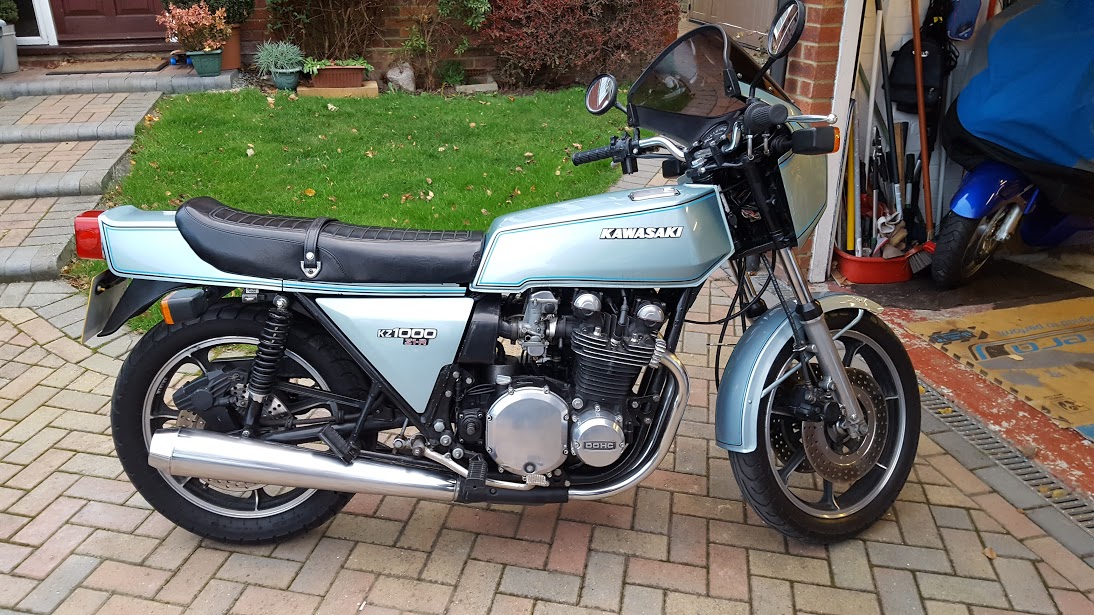

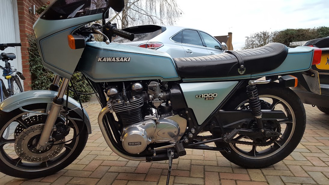

I've gone and done it this time....

Yes i did get it from Dave Orritt.
It looks better in the pics than in the flesh but is very original having the correct exhaust, kickstarter under the seat and short stemmed main stand. Goes well, with history from 1992 when it came into the UK but has 40 year old "patina" cosmetically.
I'm going to give it a thorough clean and check over, refurb the brakes as it hasn't been used much in the last couple of years, make sure everythings safe then riding it as is.
Well that's the plan.....
For those who own a Z1R, how do you get it on the main stand with the stubby side extension ? I've used all my strength and couldn't get it up (ooh err missus)

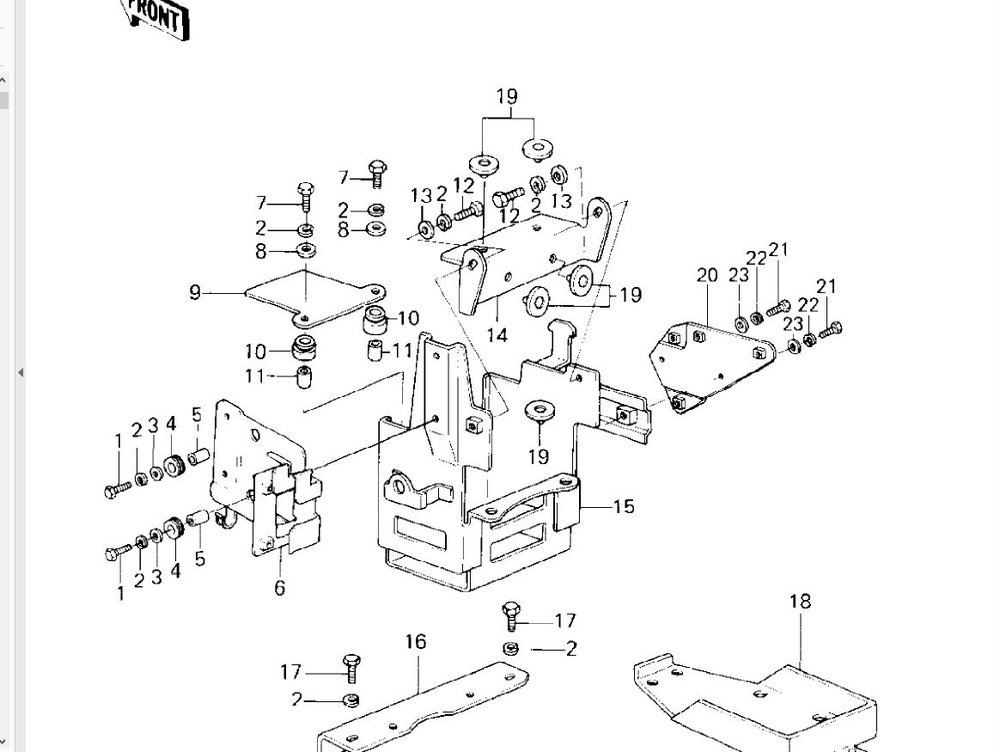

Couple of questions for the Z1R aficionados:
Is there a service manual you can download or purchase that covers the Z1R ?

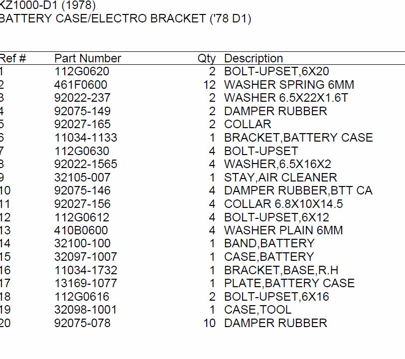

Has anyone got a photo of the battery box complete with the "battery box plate " (pt no. 13169-1077) in place. It's missing on this one and I can't make out where it fits ( or where to get one ).?
Still investigating the differences on this bike to the Z1's .....quite a few dedicated bits for this model it seems .

here is the battery box components exploded
wiv part numbers

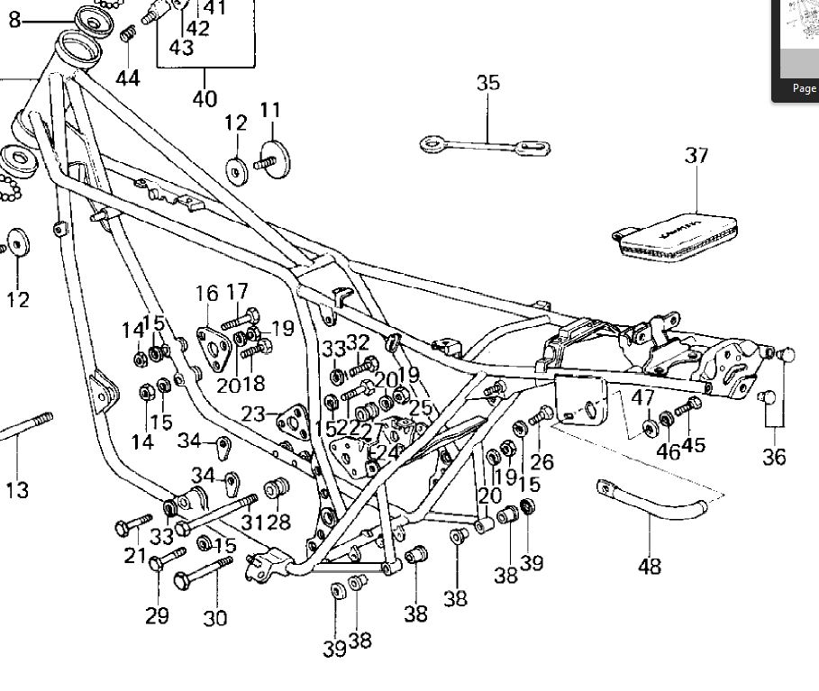

Thanks Keith, it's part 16 on the diagram but part number 17 in the parts list ? I can't make out where it goes and if I really need one. I've seen very pieces for sale with slightly different part numbers for other Z1000 variants but not sure if they are the same.?

sits across the top of the engine mounts 24 25 there should be a captive nut on each side for it bolt too
