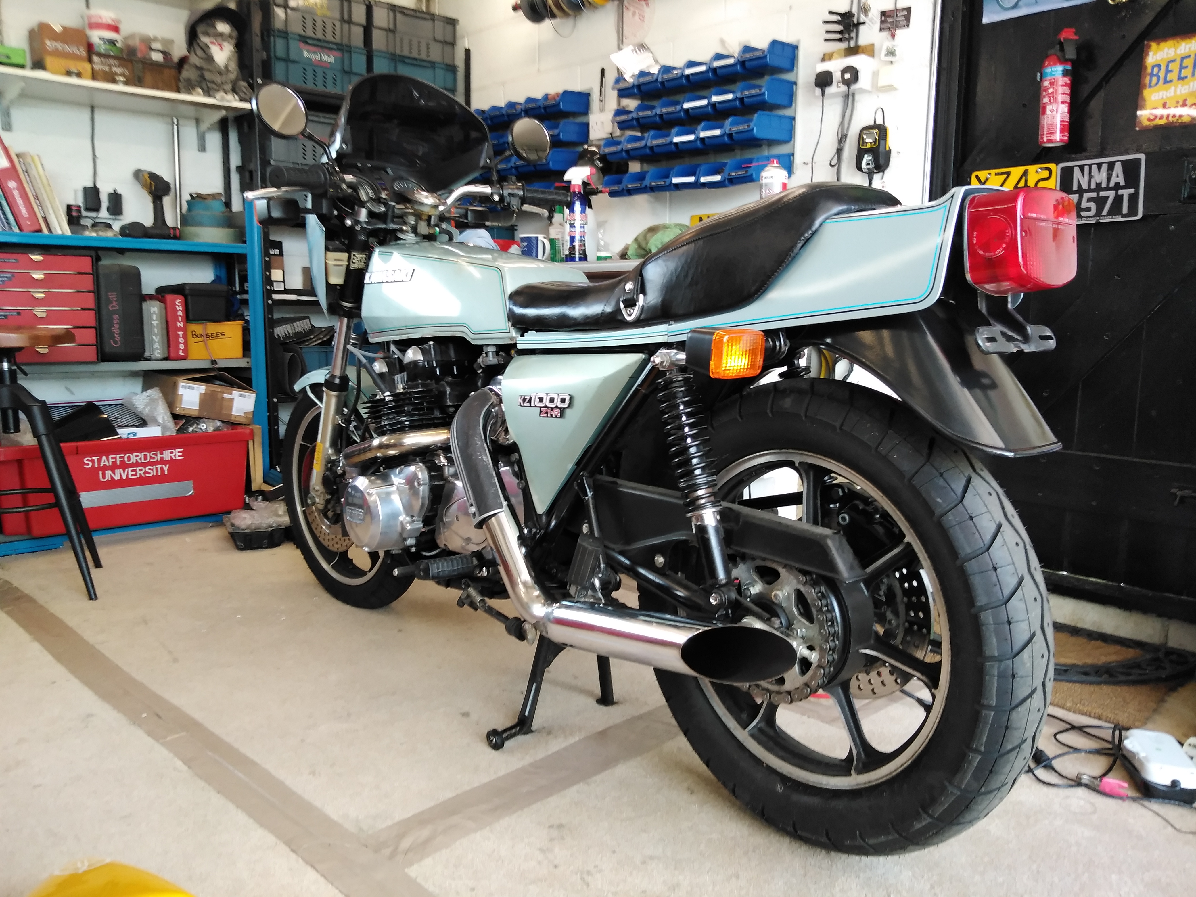

Awaiting a full resto, but I'll be on it next week stripping it down and getting it sorted.
It's just the cosmetics mainly to attend to. However I will be also doing some internal upgrades of course :lol:
1198cc, Egli oil pump, Egli deep sump, anti-surge plate, welded crank, APE studs etc, Super A-flow 370 Rajay with ported scroll, APE valve springs, Dyna 2000 with boost retard, Mikuni HSR, loads more............ it will be real nice when finished and bomb proof.

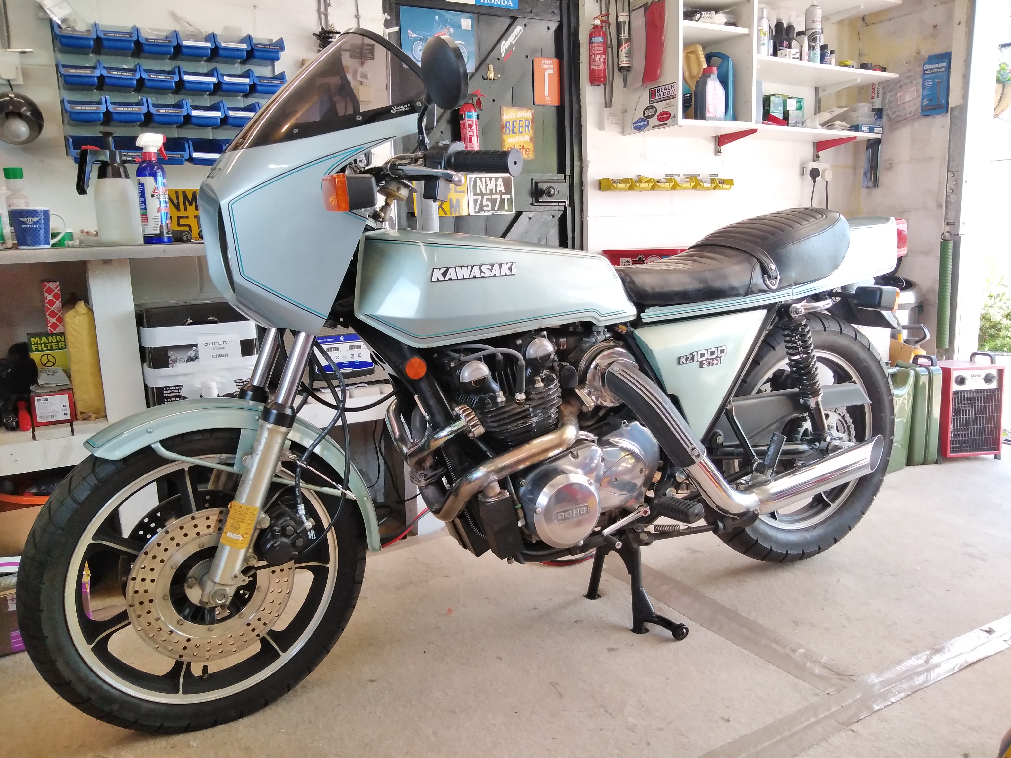

Having seen the bike it's already a nice original unmolested TC and as good as they look in Molly Colours the Stardust Silver really suits the lines of the bike...
Already Looking forward to my Test ride. :roll: :wink: :lol:

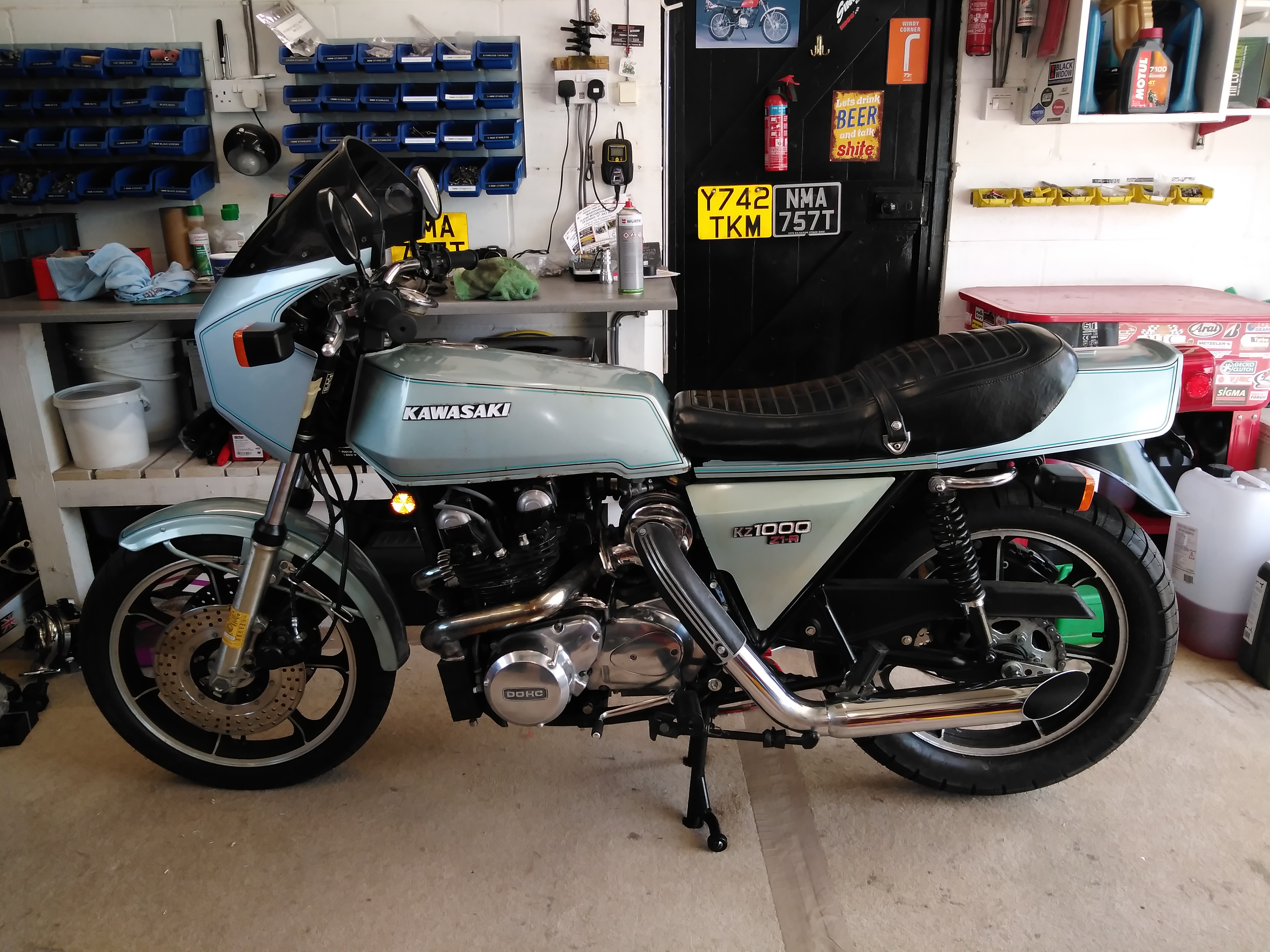

Hi Big Fluff
beautful bike ! Congratulations ! Make her shine and ride her, enjoy !

Great looking bike! I am not an expert on the TC's but did the silver ones not come with the log type headers and the black molly's with the spyder headers?

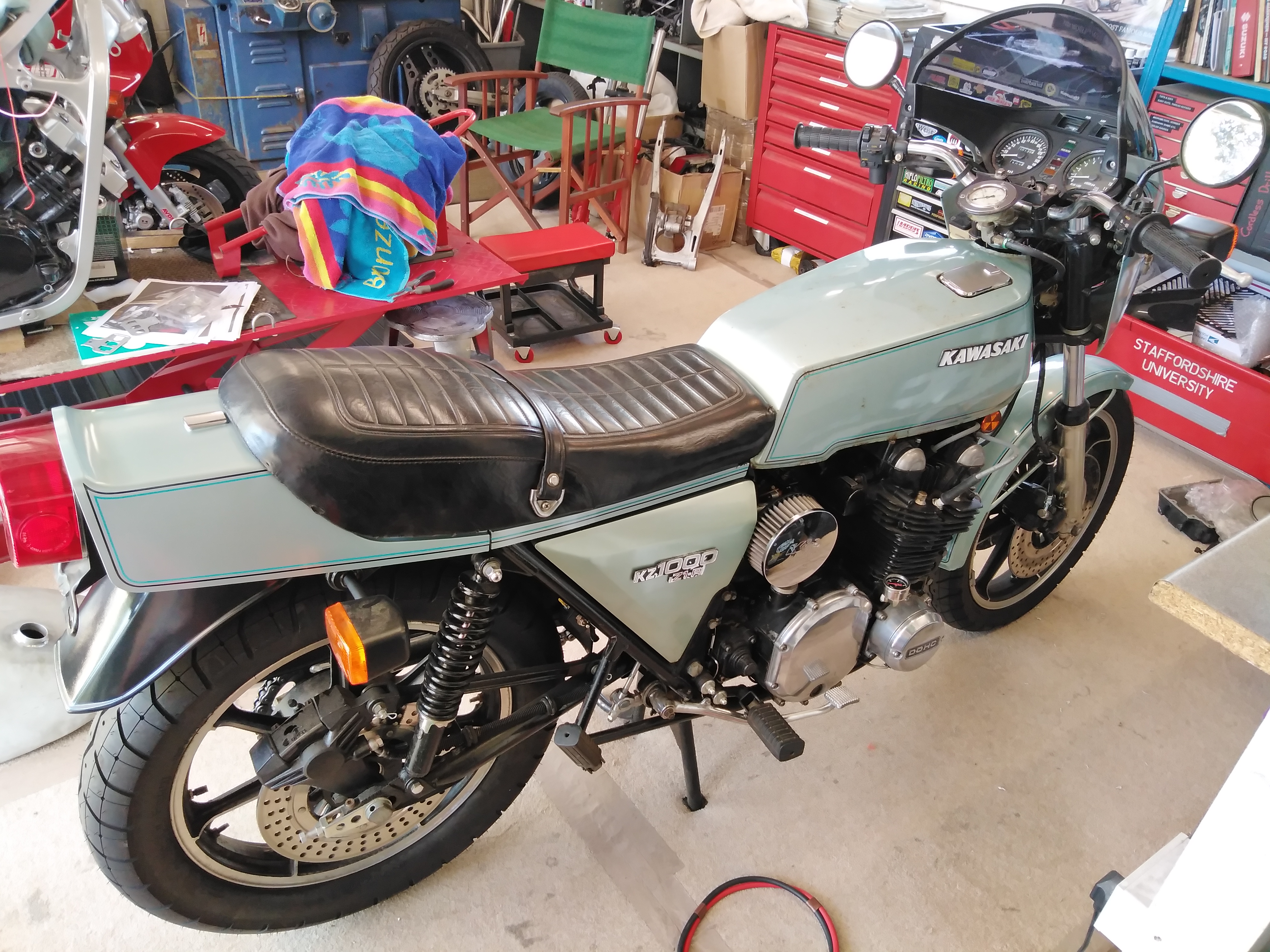

#8 PostAuthor: Big Fluff » Wed Jan 19, 2022 5:08 pm
Mathh wrote:Great looking bike! I am not an expert on the TC's but did the silver ones not come with the log type headers and the black molly's with the spyder headers?
No not all the Stardust had the lof type header. When the TCII was "designed", not only did this include the introduction of the Molly paint job, but also a raft of other modifications including the Spyder header, turbo oil return line, crankcase breather and triangular filter. However at the end of the runout of the early ATP kits, the Molly paint jobs were behind schedule so some of the Stardust models had to be pushed out to customers with all the TCII mods with the exception of the paint job.
All the paint has gone off to richie at FX now, and it's staying Stardust Silver too.

#9 PostAuthor: Big Fluff » Wed Jan 19, 2022 5:10 pm
pertonpc wrote:Great bike.
Has the front of seat foam been lowered slightly?
Certainly a keeper.
Mark
Yes Mark, the previous owner was shorter than me! :roll:
I've just bagged a totally restored seat for a criminally low price to replace it.
