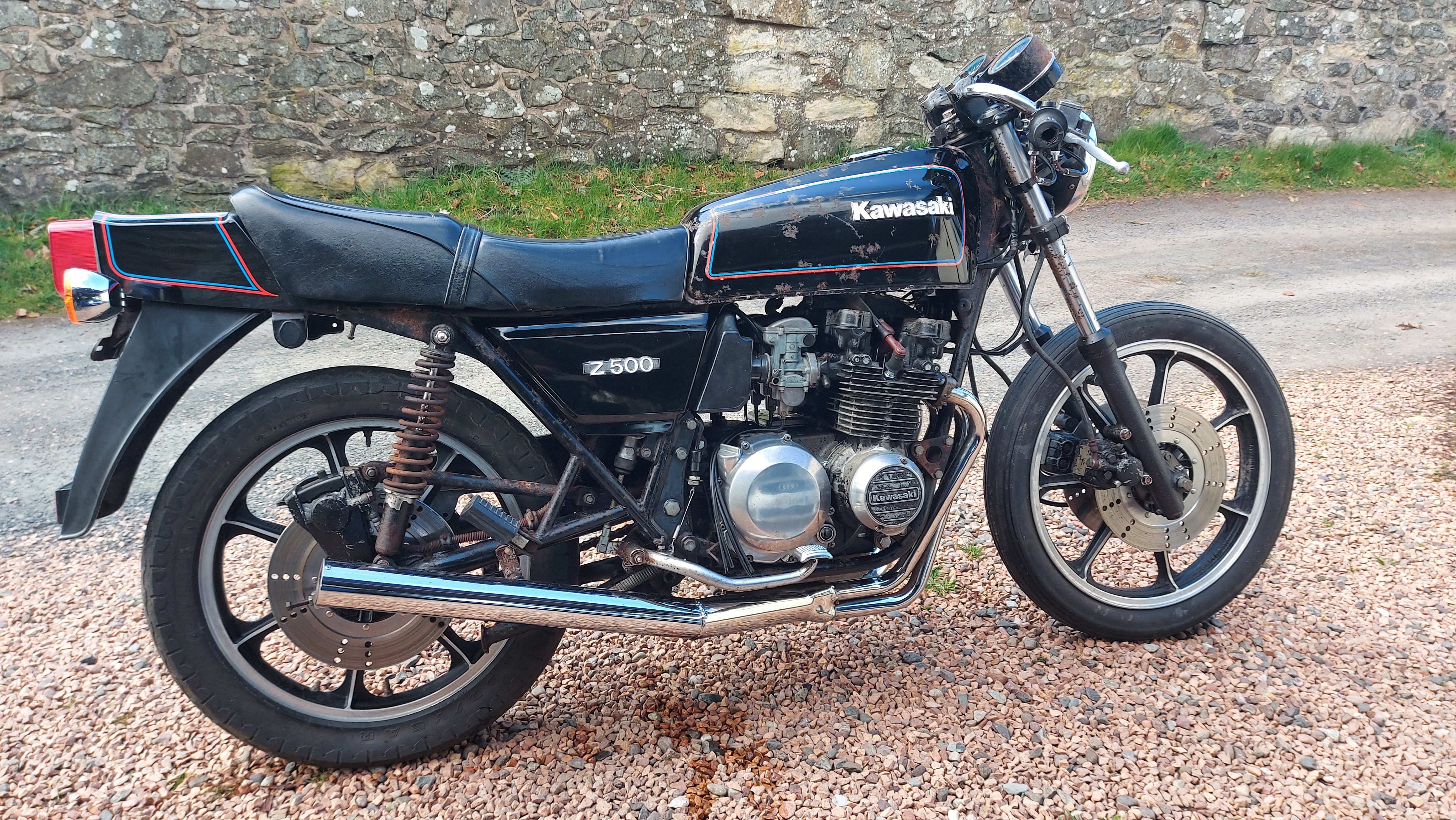

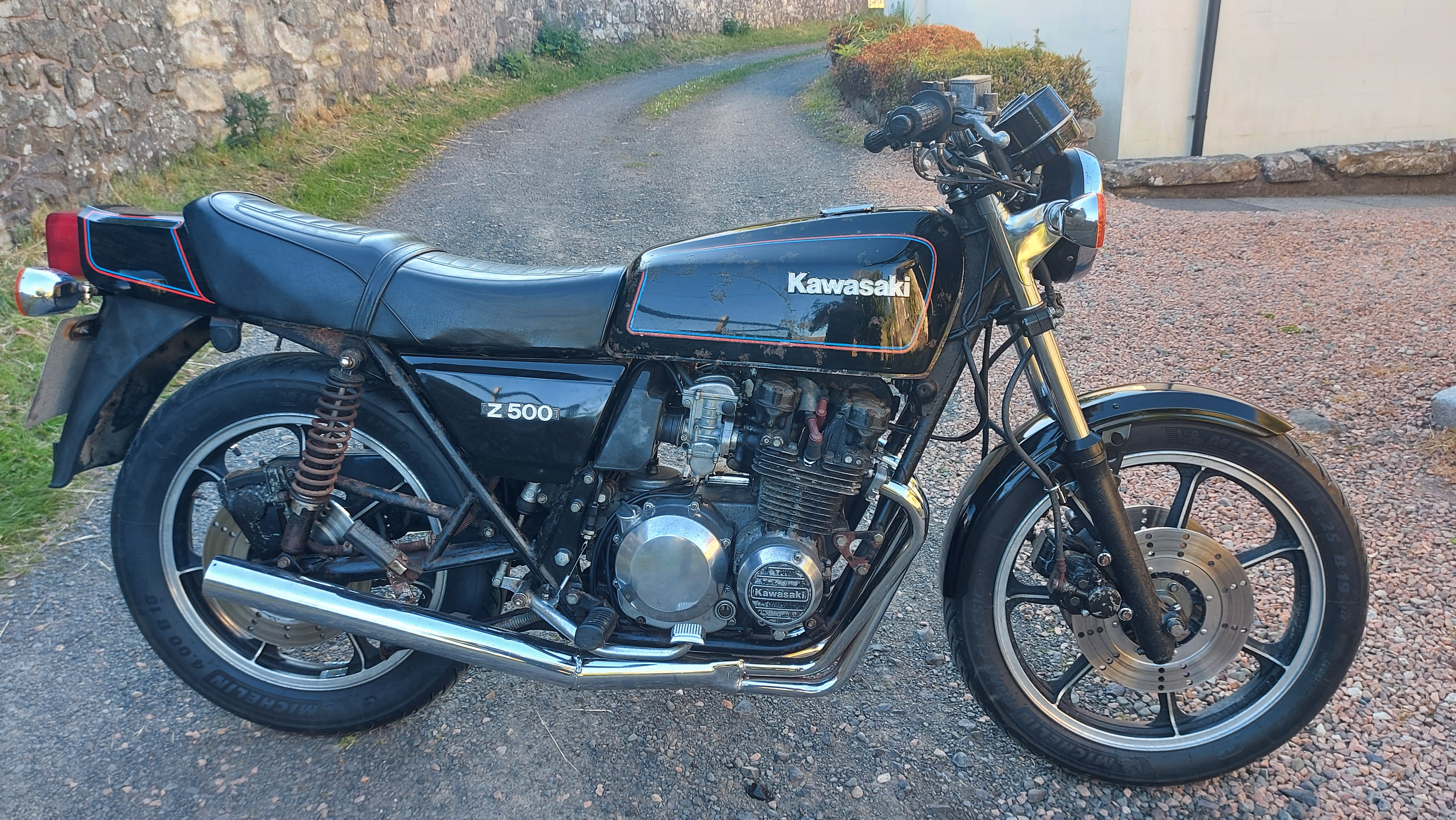

My project has made some progress after 30 year slumber.. All the electrics are now working(lots of issues including kill switch shorting) and I have had the bike actually running. Clutch was seized, so reassembled that after polishing steel plates. Cleaned up some parts and bleed brakes. News parts so far include rear brake switch, performance coils, engine service kit (oil, filter, spark plugs, air filter), fuel tap rubbers, couple of bulbs, battery. Carbs are I think next thing as not running well and flooding. Tempted to keep this as a rolling project rather than stripping to bare frame altho that does need painted at some stage. Been quoted £400 for painting tank alone which is too much. Front mudguard in process of getting back to nearish bare metal.
Parts needed are left rear footpeg, right front footpeg, left front indictator, headlight mounts.
