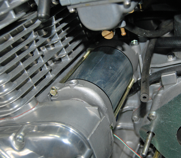

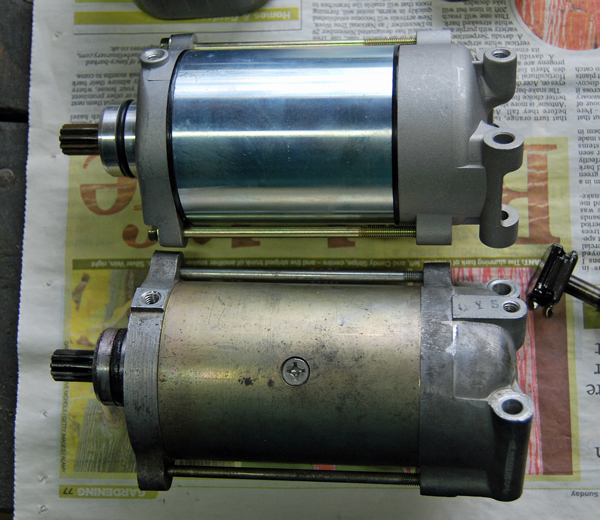

Parcel has arrived from Jeff, Motobatt and new solenoid/starter wiring ready to go..
So after getting a fair anal reaming by Customs and the Vat office - one 'Ricks' starter motor ready to fit. (original pictured bottom).
A neat and tidy installation, the mounting is identical.
The wiring connection is at the other end of the starter, the same as the later 4 brush starters.
First test was with the original starter but with the Motobatt - although it turned over a touch faster when the motor was cold - it still struggled to start when hot.
Second test was with the 'Ricks' starter and original battery - the torque over the original starter is immense, the motor span really fast - hot or cold - fitting just the starter would have been a right result.
Third test was with the 'Ricks' starter, Motobatt and a new shorter lead from the solenoid to the starter - we now have hyperspeed - it turns over so fast it sounds like a modern bike - now we start first time every time - if not sooner!!
I'm not easily impressed but - foo kin ell :9

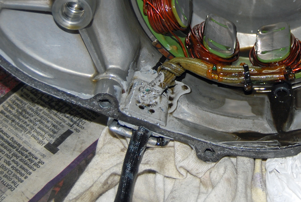

Next.... the dreaded wicking of oil through the wires from the generator cover.
I've tackled this leak before - but it's back.....

The weeping generator cover has proven a touch frustrating!
As said I've tackled this before - I'm going for shares in new gaskets.....
The Wurth sealant is suitable for use in oil, it showed no sign of failure and was certainly hard to remove.
I'd used this sealant as the original silicone sealant I'd used was not stuck to the casing when I dismantled it last time.

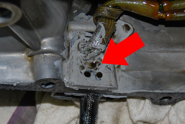

After cleaning It was impossible to tell where it was leaking from.
It had to come apart again for inspection.
On first appearance the gasket was a tad darker where it crossed the grommet, it appeared to be weeping from here.
Then it appeared to be coming down the wires themselves.
The woven cable cover is itself covered in some kind of clear sealant which does not appear to let oil through.
On closer inspection a pin hole ended up being the no1 suspect - but after filling with oil it was not the culprit.
Somehow it must be wicking it's way out down the cable - so a new grommet and a re-wire with modern cable is next.
More to follow on this.....

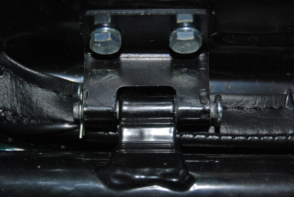

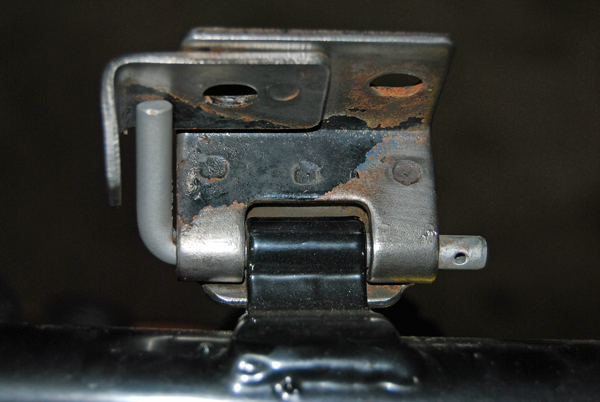

Next on the agenda was to tackle the "Saddle resting on the Side Panel" issue.
It was puzzling me why it was doing this, all became clear when Taffus found the answer in his Z900 thread - http://www.z1ownersclub.co.uk/forum/vie ... at+stopper
Discontinued item 53009-032 is the answer - or a bit of metal and a welder....
During the resto I'd replaced the saddle with a new one.
I'd discarded the old saddle to storage without looking at the original hinges.
Not looking at the old hinges meant I didn't know the new ones did not have the stopper.
I'd wondered what the side bracket was for on the brackets shown in Taffus's thread.
I dug out the rusty old hinges and had a play.
Both had the original L shaped retainer pins, both had the side brackets, the front hinge also had the stopper welded on.
With the L shaped pins in place I found they had marked the side bracket in previous use - I think I sussed it.
And of course with the stopper - it stops the seat before it leans on the side panel - simples.
A trip through the blaster and a coat of paint and we will be good to go.
You learn something new every day!

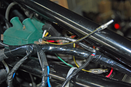

I knocked up a dnya coil feed mod, this time using a micro relay.
The pattern Ltd loom I'd used on the resto was suffering from corrosion of the terminals, so I now use DC4 silicone grease on all connectors, filling a small syringe made filling the connectors a bit easier.
I mounted the micro relay base on the offside coil mount.
Brake outtage sensor still fits on the nearside mount.
Just in case it helps - I ran earths from the coil mounts back to the battery, I have no idea if this will make any difference - but belt and braces and all that.....
All fits nice and neatly under the tank, the extra blue wire on the pattern switchgear will be deleted.

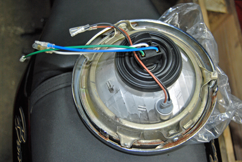

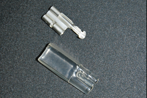

I picked up some Jap spec bullet connectors from one of the online terminal suppliers, these make adding extra earths etc, a doddle.
So the pathetic 40 year old sealed beam unit is being replaced by a nice new H4 unit from ZFever.de....
Sidelight bulb - doh! - need another earth then.....
I'd only planned for earths from the two indicators and one from the headlight.
[img]Z1000LTD_2903167.jpg[/img] Not enough available space to display pic
so I made up an adaptor lead - instead of joining the two indicator earths together - Doh!
[img]Z1000LTD_2903168.jpg[/img] Not enough available space to display pic
The beauty of modding the loom yourself - it all fits without ramming the headlight in.....
