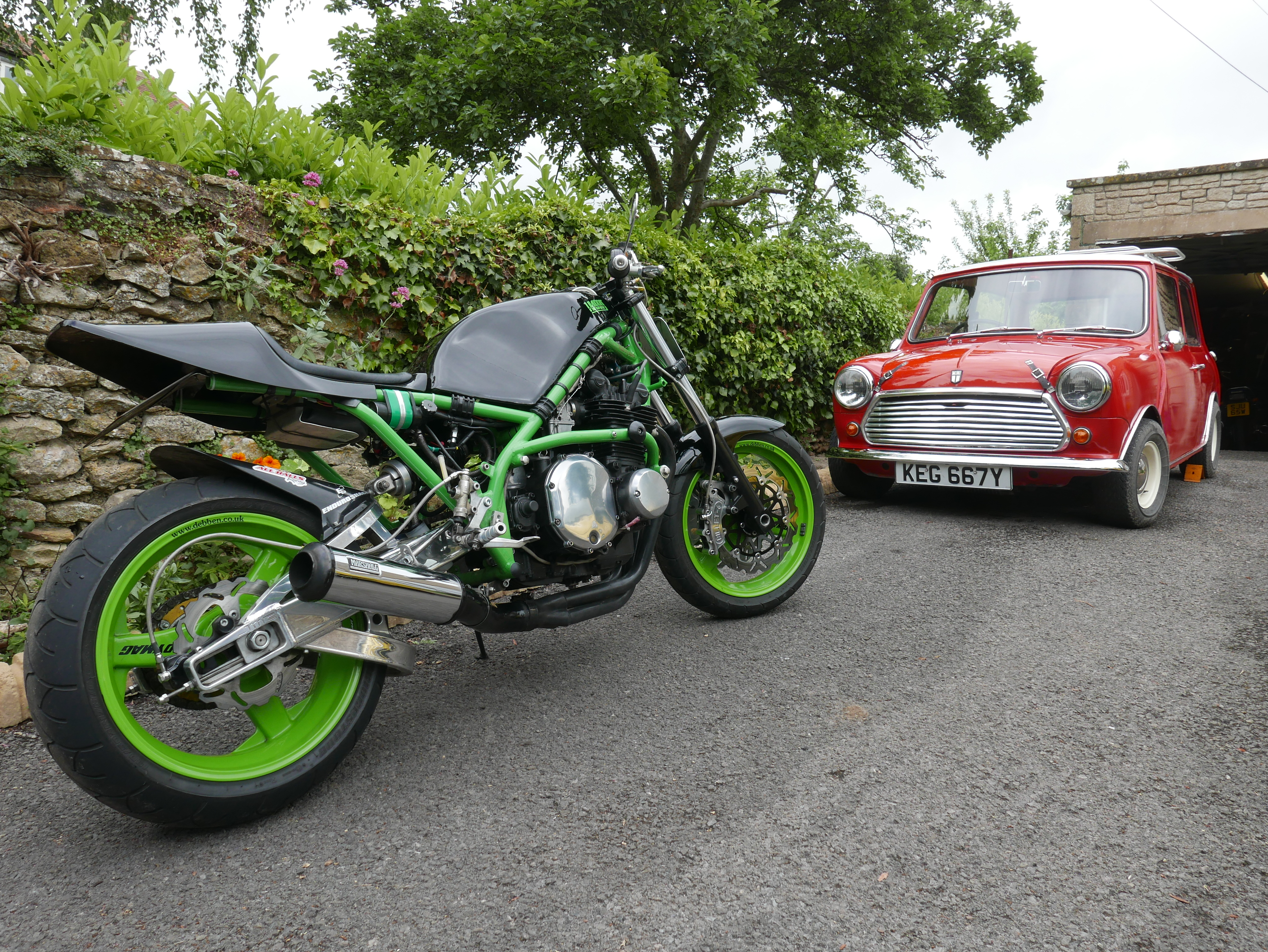

So I picked this up last august with a Gsxr engine in, Harris-Kawasaki on the logbook so game on what engine for it, decisions decisions,

Engine on the right is my Harris lump, Z9, 1045cc High Compression forged pistons, welded and indexed crank, polished and ported head to rubbers with 33mm flatslides, I've also got a full titanium akrapovic system for it dyna s ignition dyna coils and taylor leads, need source some cams when funds allow, which is what the engine on the left is for, Z9 again had a gearbox issue so ripped it down putting it back to 903cc block and clean it up to go back in the 76 a4 chop thing to sell it to fund the rest of the Harris

Would be nice, bodywork is going to be chrome black, for now just mudguard tank and Z9 tail, I'll buy a new mag 2 fairing from Harris later on :D

Lovin' the frame colour...... Green & Black - a great combo (I'm biased) :lol:
I got the wheels before I got mine p/coated, so they dictated the colour!

Nice I like that :vcool I've got a mag 4 tank
