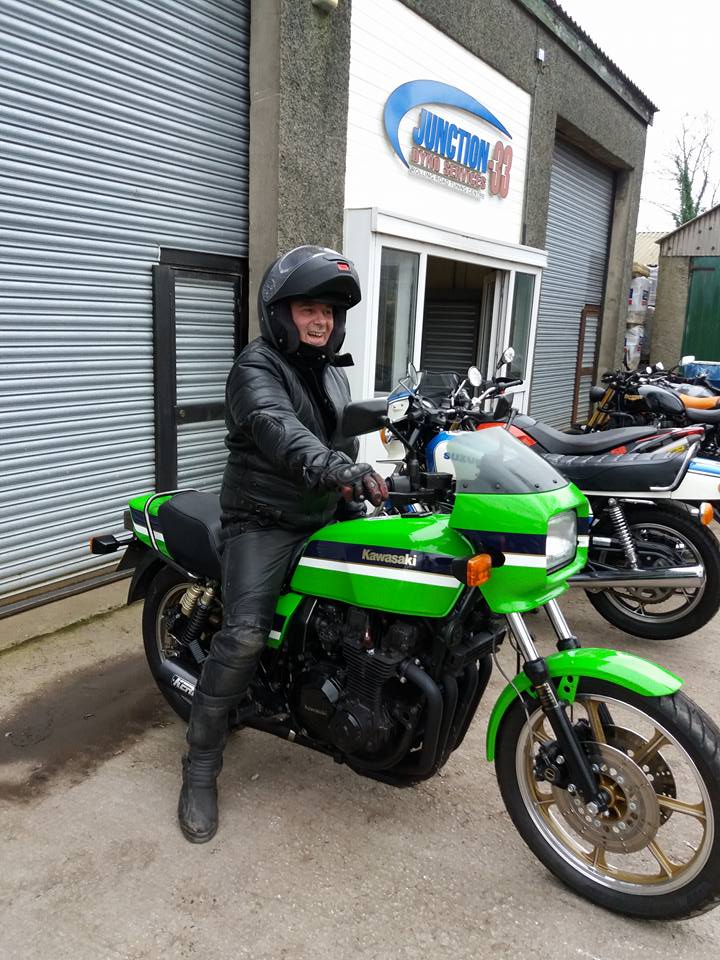

Gents,
As you know I bought the bike from Paul and shipped to Australia, really happy with the bike but it was missing a couple of little things to bring it back to standard :D
I've fitted the original shocks which I found in the US, fitted the black chrome 4-2, stripped and rebuilt the carbs and had all the engine cases repainted in gloss.
I can't stop looking at it :D

There's a horrible inclusion on the clutch cover :mrgreen:

Oh, and fitted a period fork brace just because I had a new one in a box! :vcool

I thought it was a horrible '80s mural!

Fantastic,a credit to present and previous owners

Looks 100% :luv (the bike - not you!)

cases are mint and an inclusion is just that its part of its history. love it and look after it there a rare beast now days.
