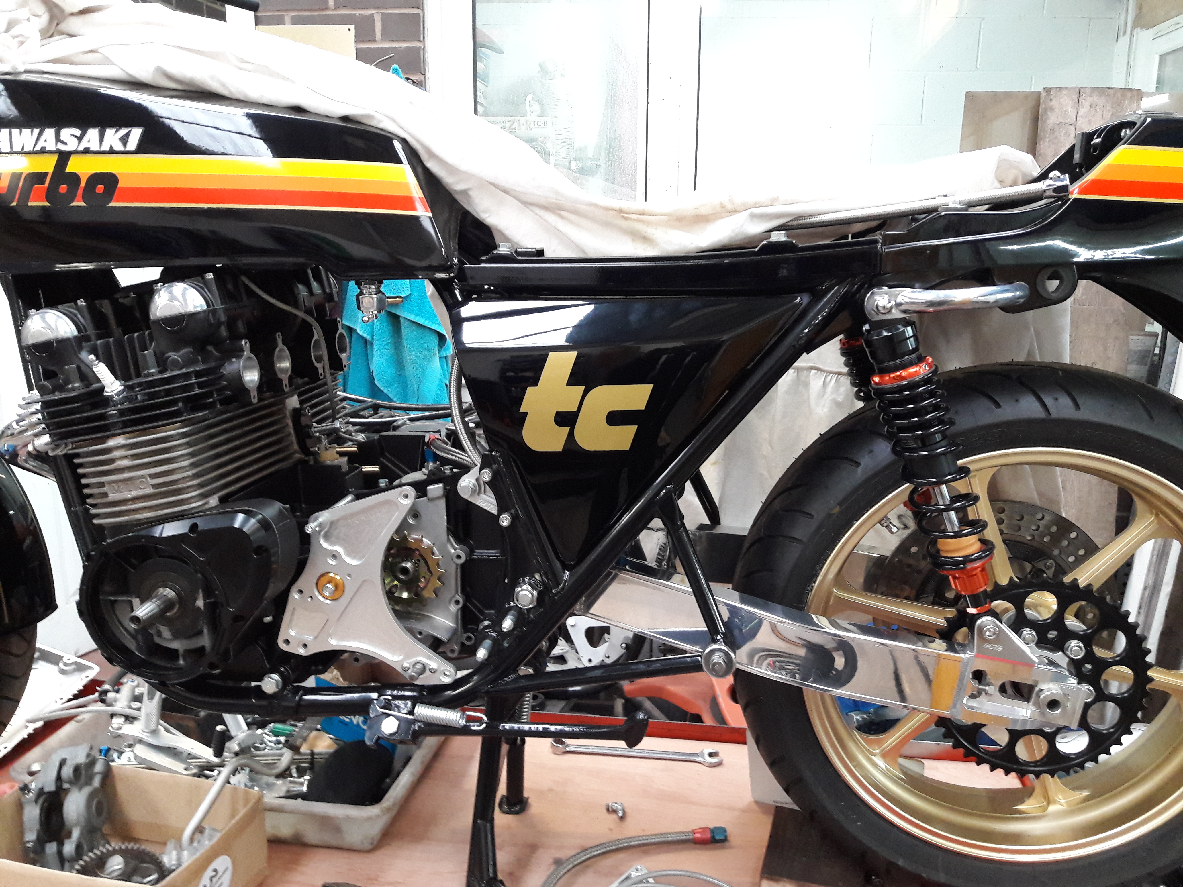

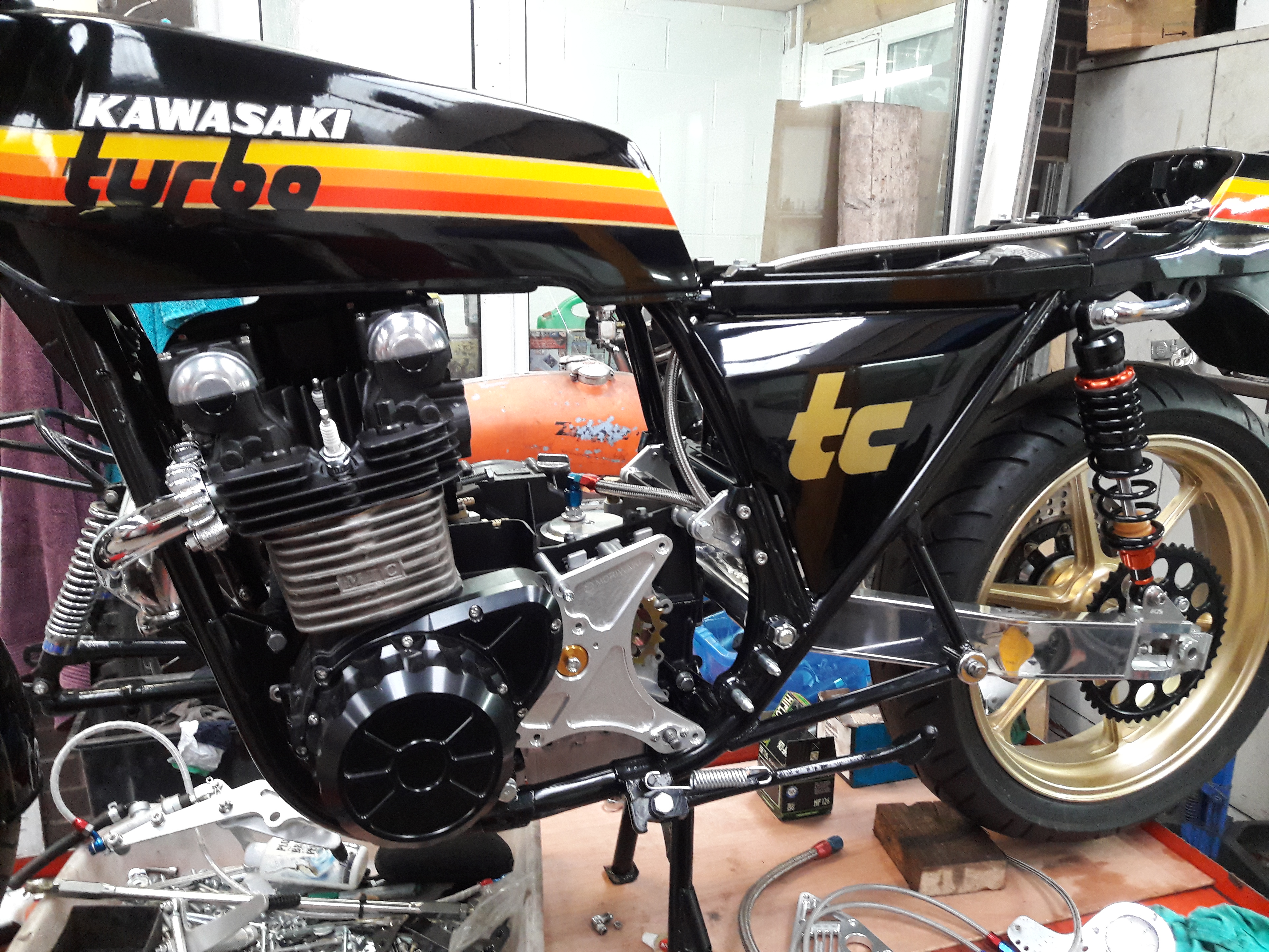

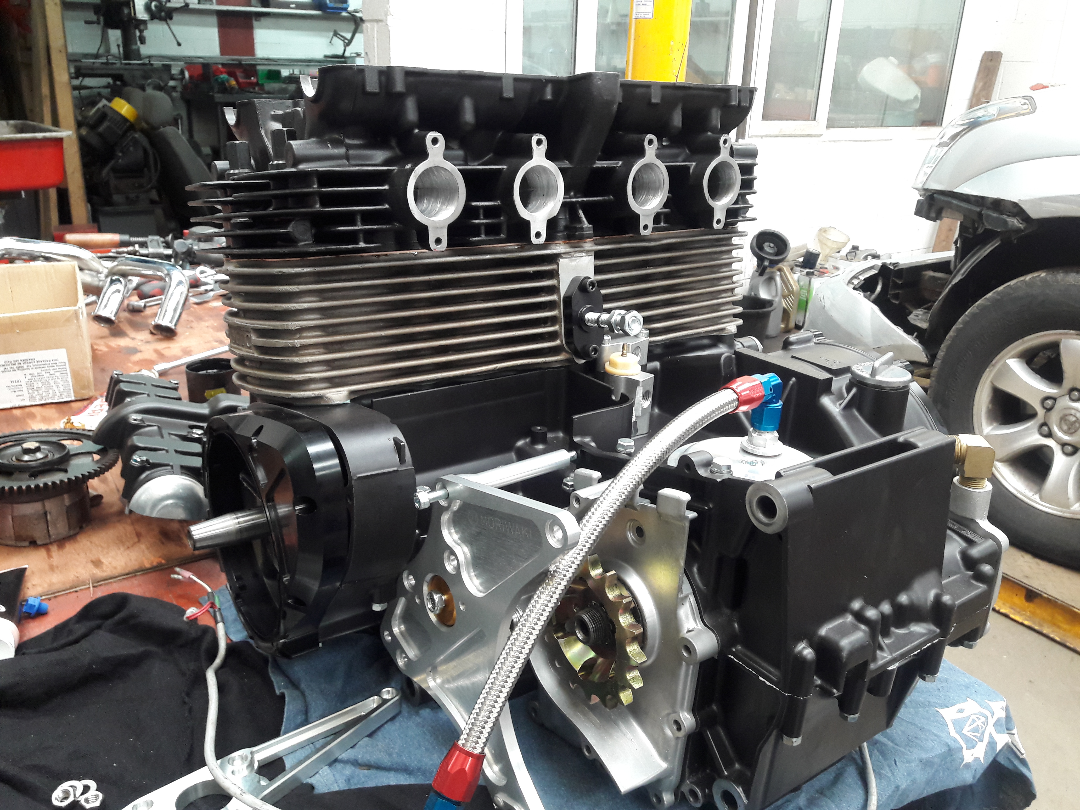

#17 PostAuthor: hotrod » Thu Mar 22, 2018 9:58 pm
more pics of the turbo build

#18 PostAuthor: Gonzo » Thu Mar 22, 2018 10:59 pm
I like your swingarm... who makes it and what's the max tyre width it can take?

#19 PostAuthor: ZedHead » Fri Mar 23, 2018 11:03 am
Gonzo wrote:I like your swingarm... who makes it and what's the max tyre width it can take?
https://www.saisei-europe.com/Shop/Prod ... rm-type-11

what size is the motor 1327? see you are using a MTC big block
hotrod

#21 PostAuthor: hotrod » Fri Mar 23, 2018 9:48 pm
its a 1260 with low comp pistons ,liners are quite thick so the bores will be stable ,plus loads of room for re bores when it goes bang

#22 PostAuthor: hotrod » Fri Mar 23, 2018 9:50 pm
it is a pmc job ive got a 4.5 rim with a 160 tyre but there is room for a wider set up

#23 PostAuthor: ZedHead » Sat Mar 24, 2018 8:17 am
It will take a 170 tyre.
Brilliant project BTW :D

#24 PostAuthor: Reecy » Sat Mar 24, 2018 11:44 am
Love that swing arm

#26 PostAuthor: saltflatracer » Sat Mar 24, 2018 7:13 pm
Nice build Hotrod, sensible size 1260cc as you say nice & stable with loads for rebores if necessary.
What size valves has the head got in it & who done the porting?

#27 PostAuthor: hotrod » Thu Mar 29, 2018 6:45 pm
saltflatracer wrote:Nice build Hotrod, sensible size 1260cc as you say nice & stable with loads for rebores if necessary.
the valves are the std size ive done all my own engine work its had the ports cleaned up but not ported ,

#29 PostAuthor: Big Fluff » Tue Apr 10, 2018 3:00 pm
Just be sure to fit boost activated retard if you plan to go over 5 psi.
If you don't, then as you say you WILL be reboring it on a regular basis!
You'll also need at least one additional crankcase breather.
Nice project though.
