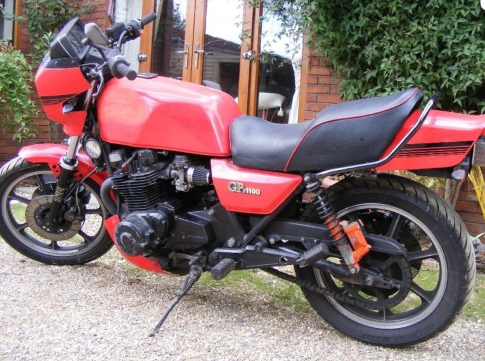

Here's my 1100b1
This is how I got it after a long time looking ....
And now so far ..

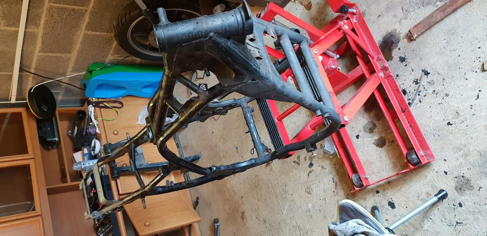

Just stripping and mocking up
Spec.
Std engine
Gsxr flat slides
Zx9r f model forks love the 46mm forks.
Zrx 1100 rear end inc shocks
More pics next week

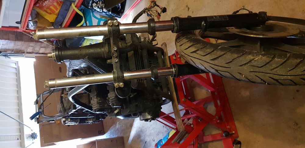

Thanks I have no intention of changing anything so that the original parts cant be re fitted and they are staying with the bike . The only exception to this is the rear shock mounts which I'm having custom made and I will have to cut the old ones off but sympatheticily .my zx9r E forks have had the stem machined to take std size gpz bearings . I'll post more pics ..later ..

Stripped and off to powder coating today with the zrx arm ..

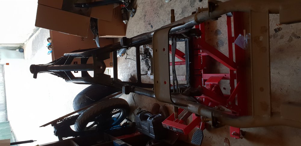

Slight progress head stock machined and swing arm and wheels mocked up for fit ..

Rear shock extenstended mounts collected . Hopefully done so they look stock and bolt in as apposed fo weld in a little machining and back to std .
