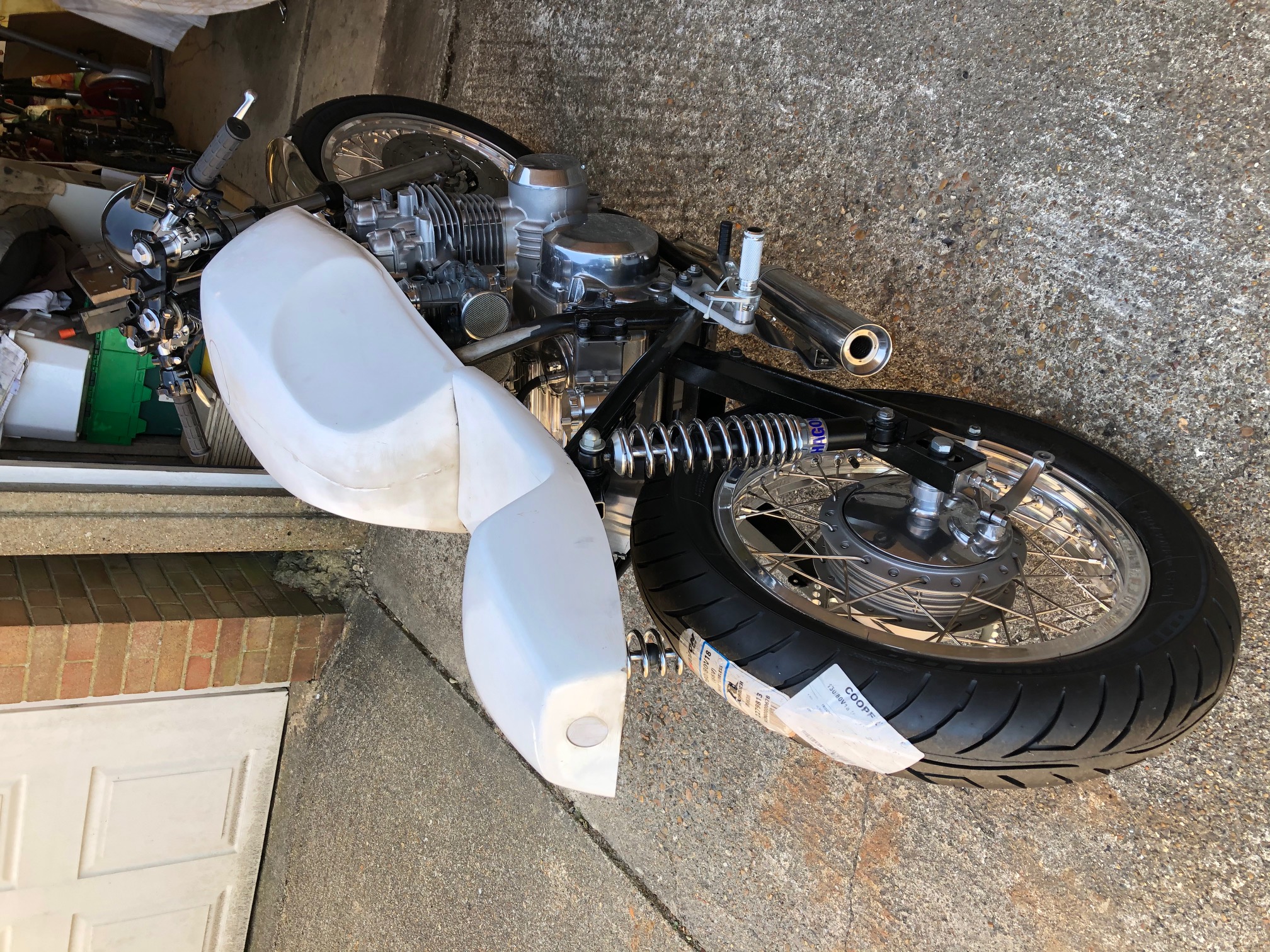

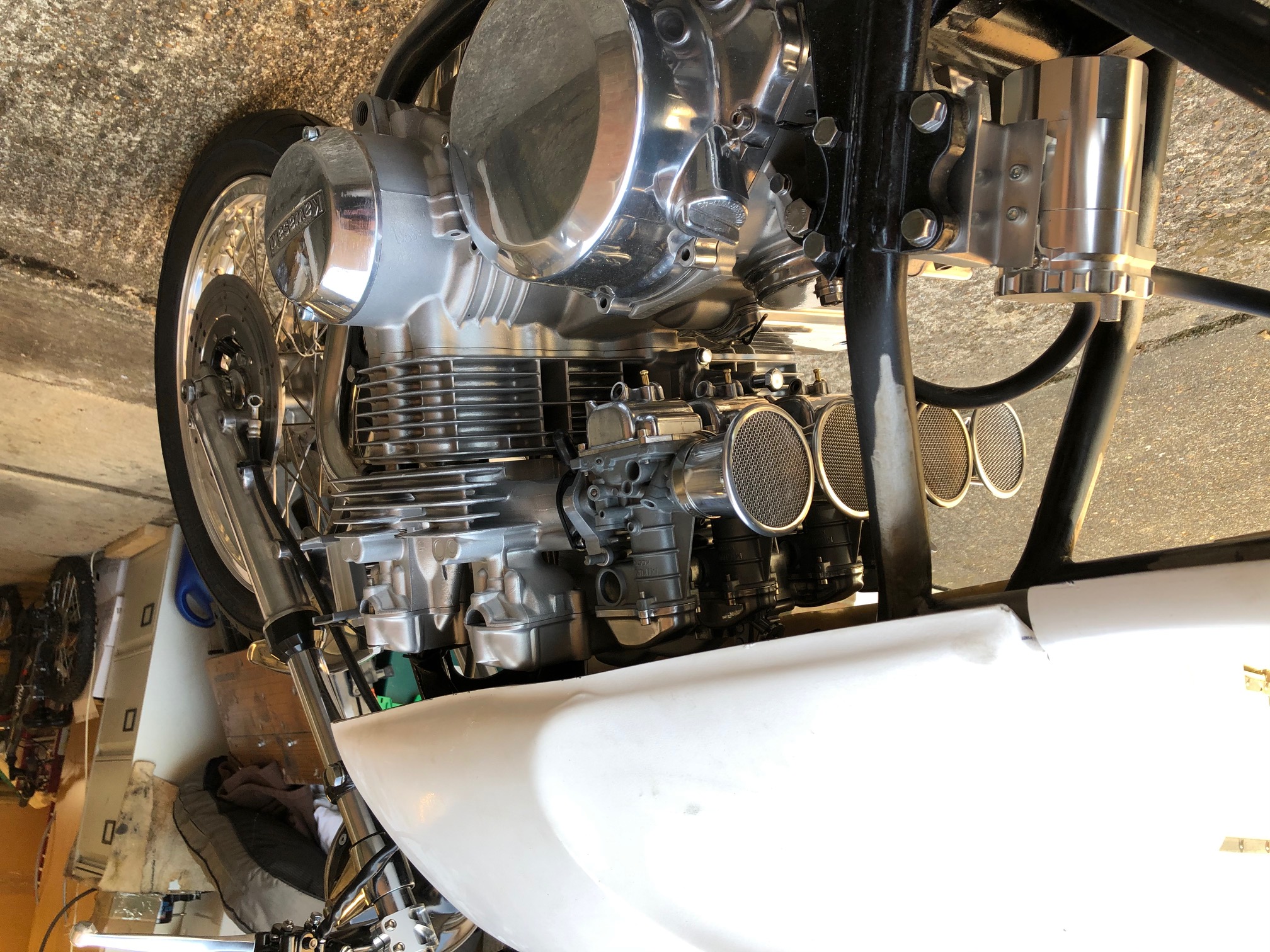

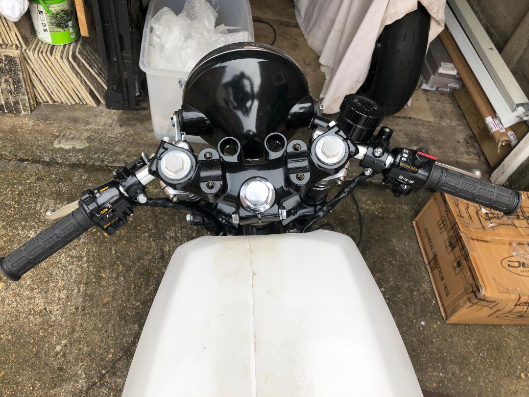

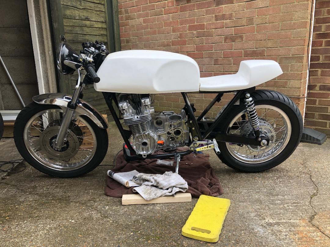

Well it’s been quite a while since the last update.
This lockdown and the fact that I’m on Furlough leave has meant I’ve been able to spend a lot of time in the garage working on project 650.
Over the last few months I’ve been scouring the internet for parts and was able to start thinking about beginning a dry build to see where we were at.
With the empty engine casings in the frame I was able to align the tank and seat unit parallel to the frame and with the right proportions between it’s bottom line and the top of the cam cover. The build has gone reasonably well, although there are a lot of alignment issues and a few spacers to be made up here and there.
Loads of work still to do and lots of parts to mock up.
I’ve bought a Delkavic stainless 4:1 exhaust that I will offer up next to see where I’m going to need to weld brackets to mount this. I’ll post more photos once this is in place.
Stay safe and well guys.

#21 PostAuthor: 000zeds » Sun Apr 19, 2020 6:19 am

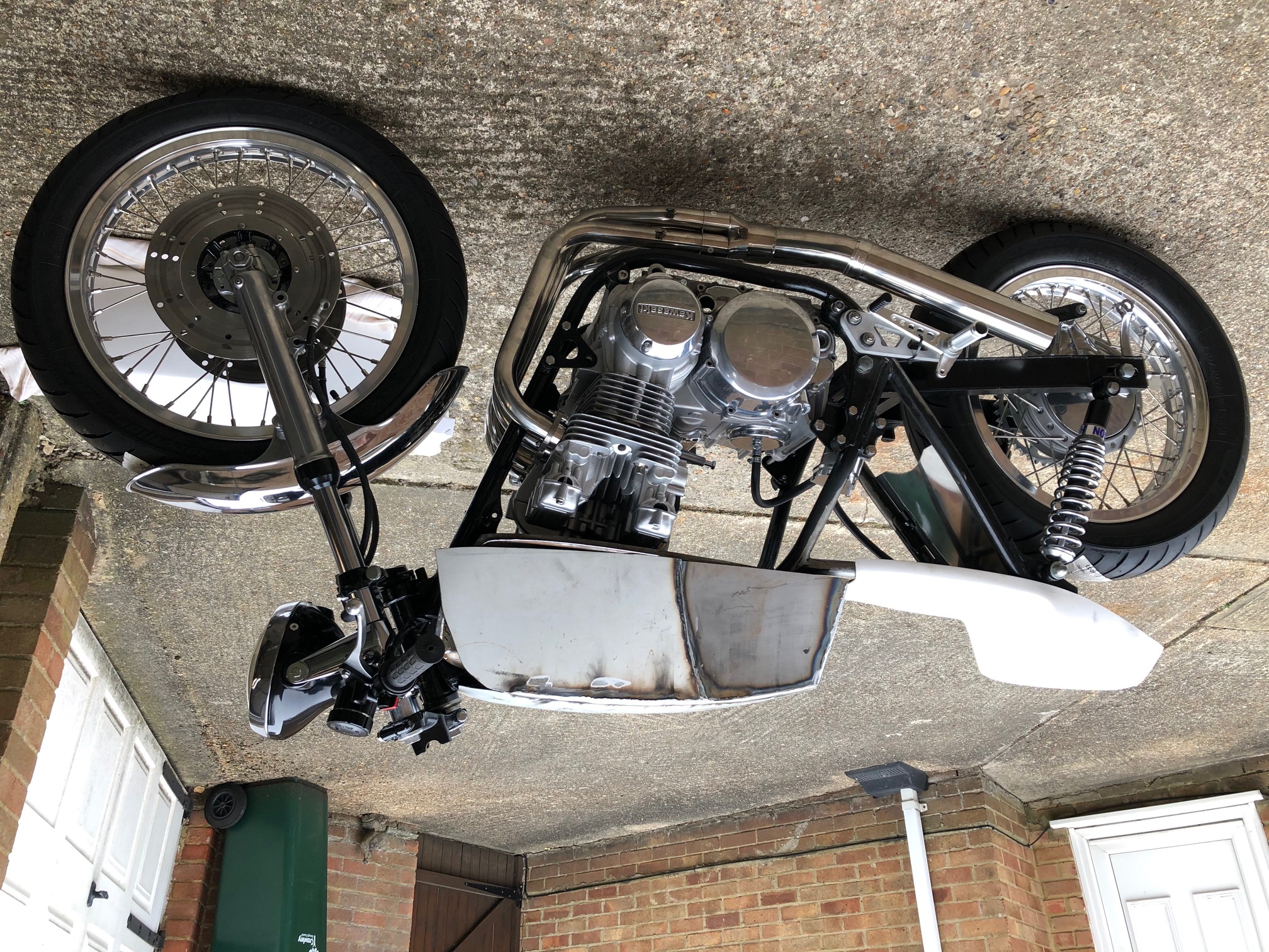

When did you move down under :?: :D :D :D

#22 PostAuthor: Paul Whitehouse » Sun Apr 19, 2020 7:11 am
That's weird....viewed on my phone, they're the right way up !! :)

That’s looking great Paul! Love the Rickman shape tank. If you need a fairing I have a NOS rickman I picked up around 20 years ago I’ve always planned to use on something.. lol.

#24 PostAuthor: Paul Whitehouse » Sun Apr 19, 2020 7:21 am
Hopefully the photos are the right way up now :)
Lee: I hadn't planned to run a fairing...but would be interested to see it. Could you PM me some details and a couple of photos.

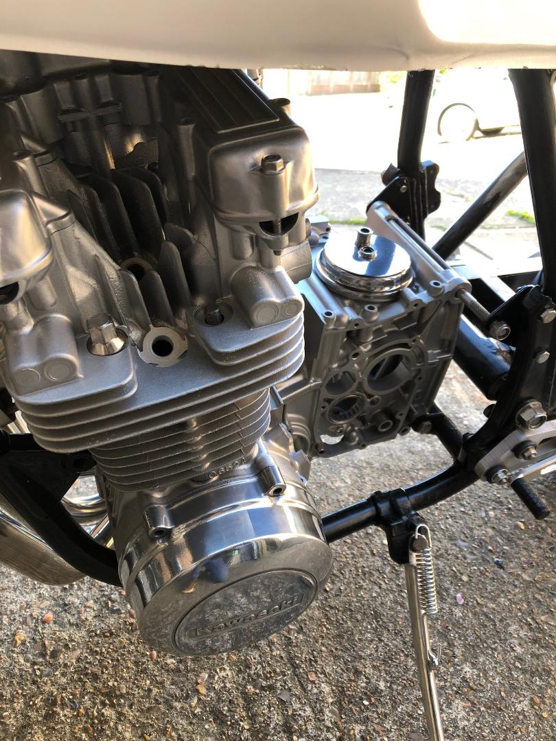

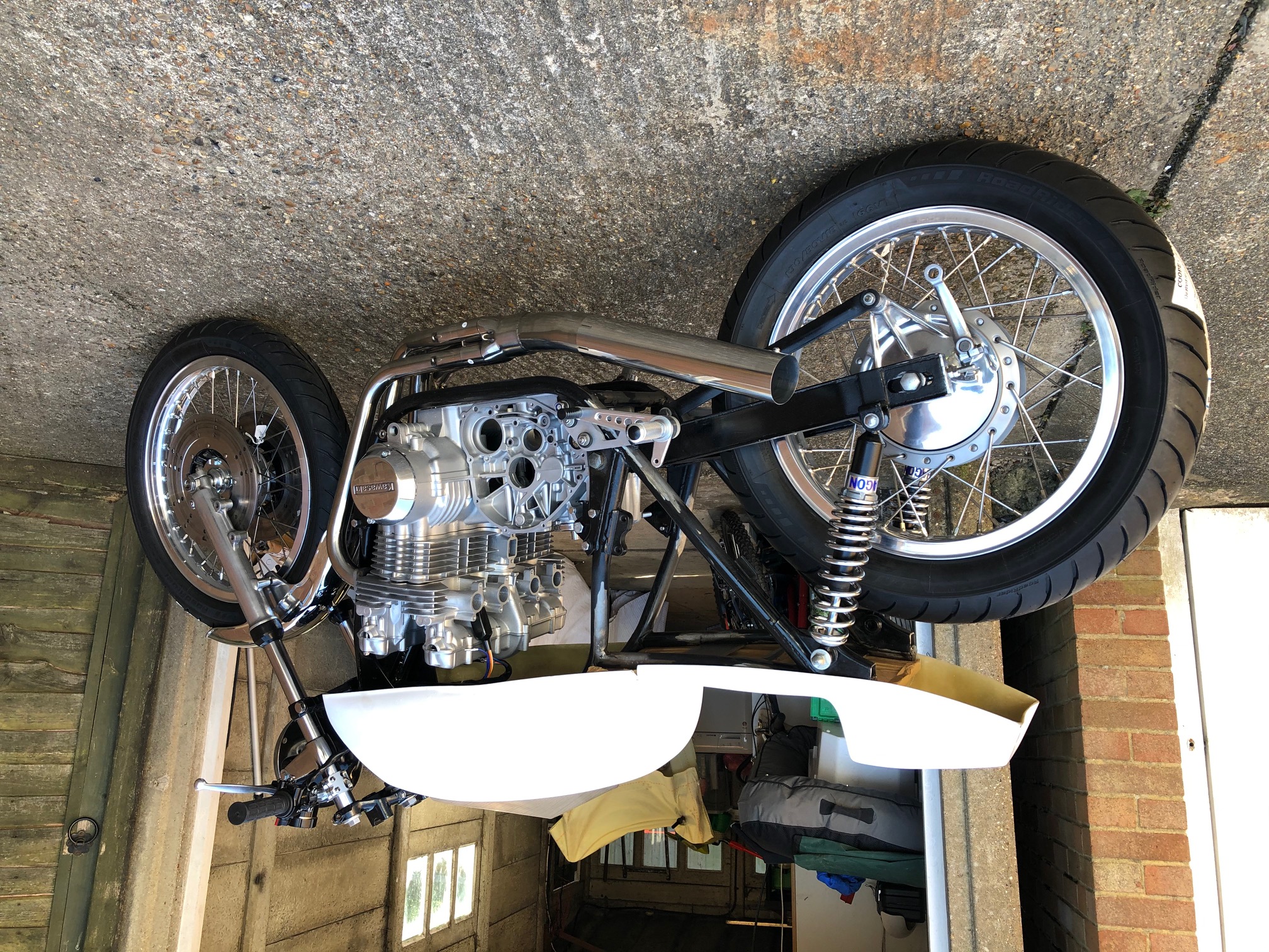

#26 PostAuthor: Paul Whitehouse » Wed Apr 22, 2020 6:22 am

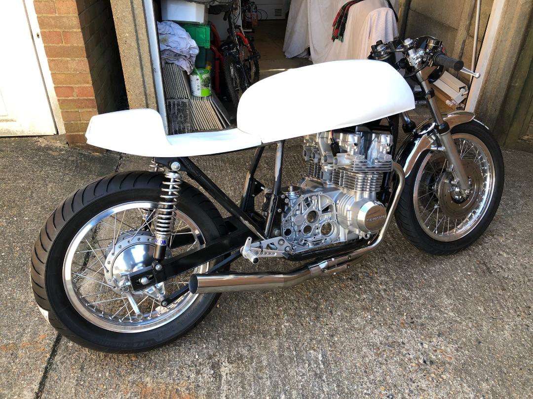

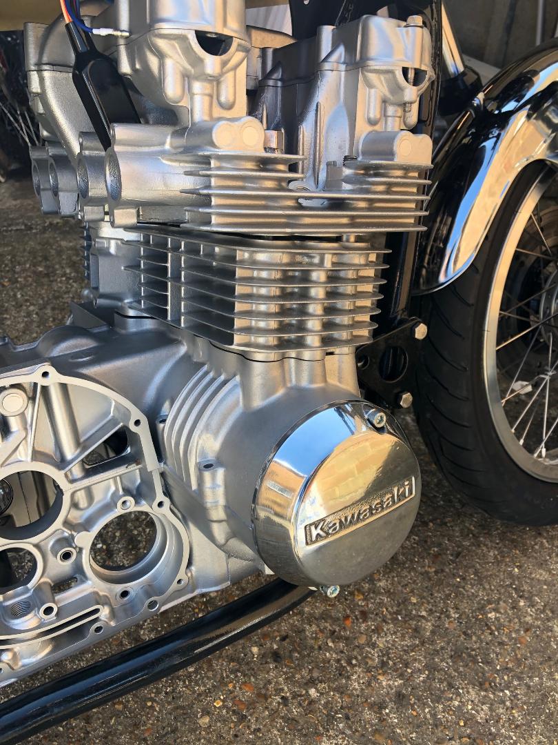

Another good day in the garage yesterday. Dry build of the exhaust and also set about some of the outer casings with the polisher.

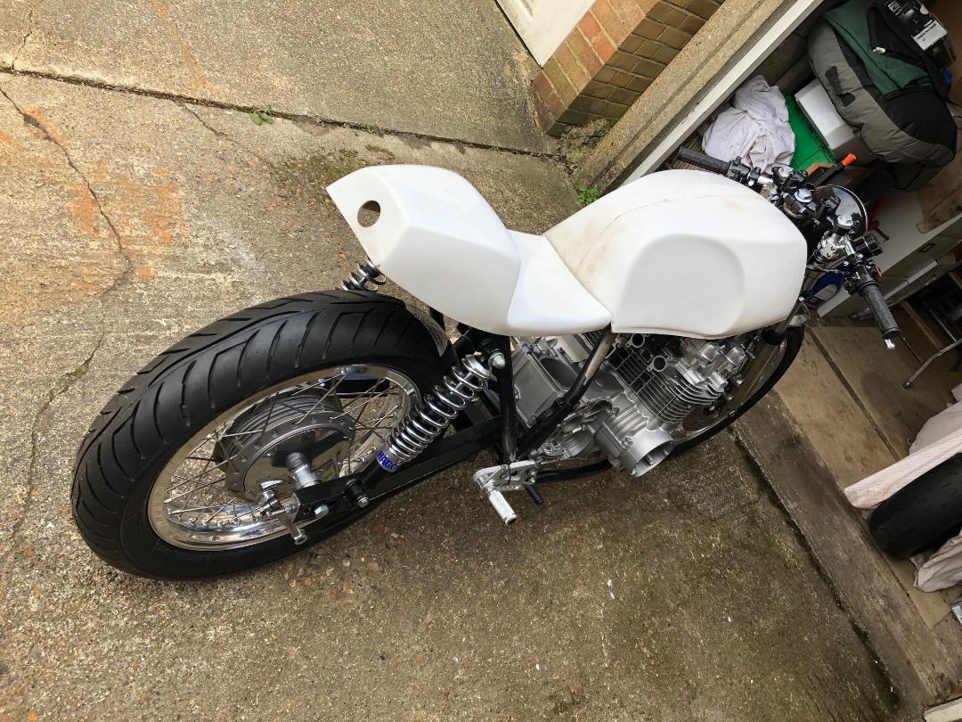

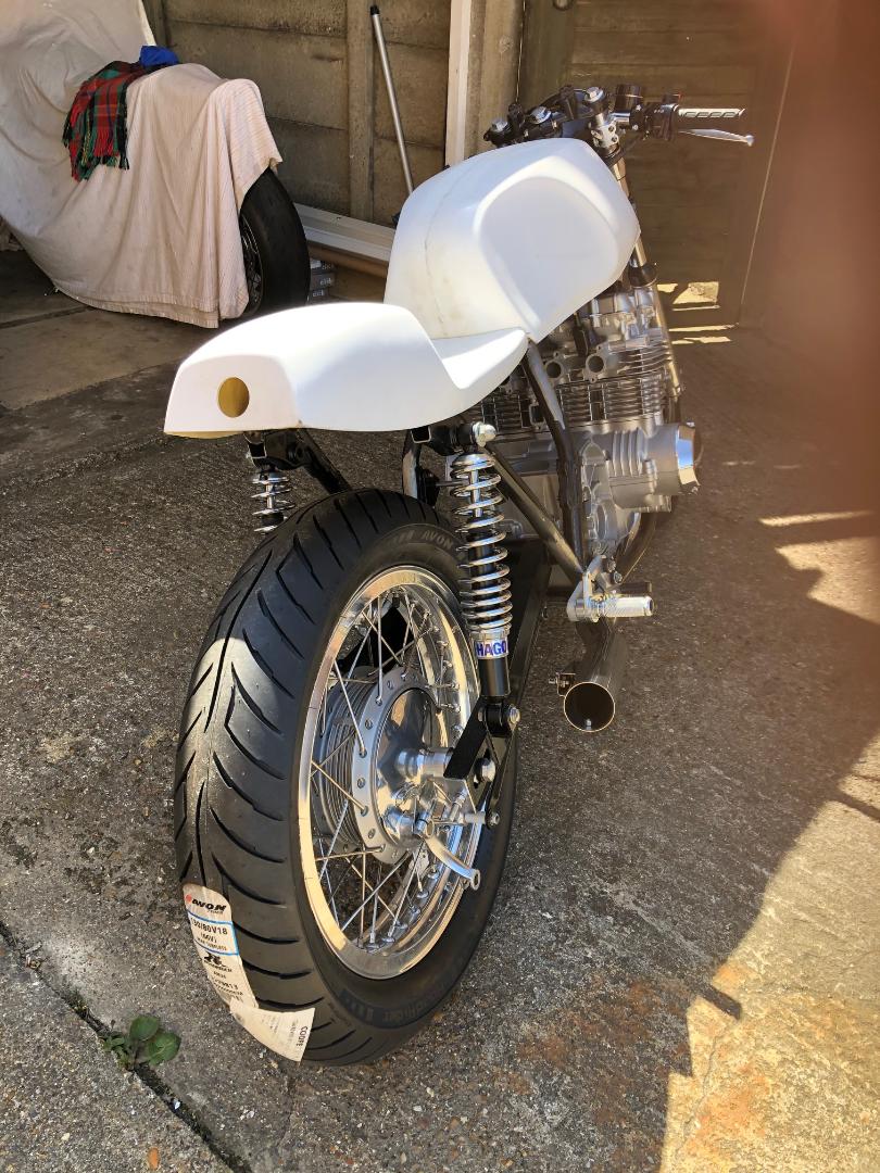

#29 PostAuthor: Paul Whitehouse » Tue Jun 02, 2020 11:08 am
A couple of photos showing the latest `dry` build status.
The fabrication of the tank is underway. It uses the existing Z650 tank as the base. This allows me to pick up on all the existing location features on the frame.
The carb bodies have been ultrasonically cleaned and a light vapour blast. No internals at this stage, but now gives an idea of the finished look of the bike.
