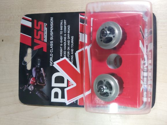

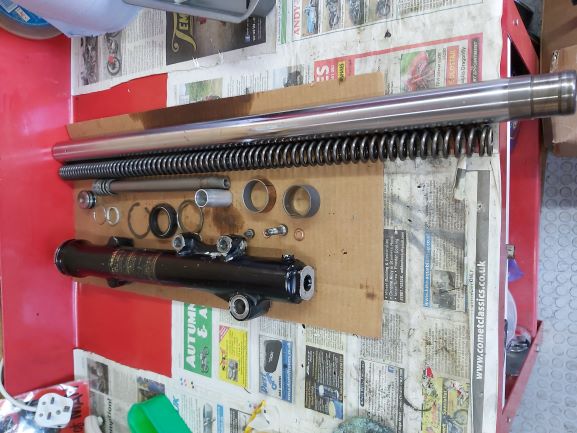

Over the last week, I've started stripping down some of the GPz components to see what needs to be refurbished and/or renewed and I started with the forks & wheels.
The forks came apart without too much drama and once stripped and checked the stanchions have gone away for re-chroming. I had already upgraded to progressive fork springs from WP, back in the day, so they will go back in and I'm going to convert the forks to run cartridge emulators from YSS. These only have a single shim stack that controls both rebound & compression (unlike the more expensive Racetech units which have individual ones), but I think they will still be an improvement over the original system.
one fork stripped - one to go !

YSS emulator.jpg (207.49 KiB) Viewed 147446 times

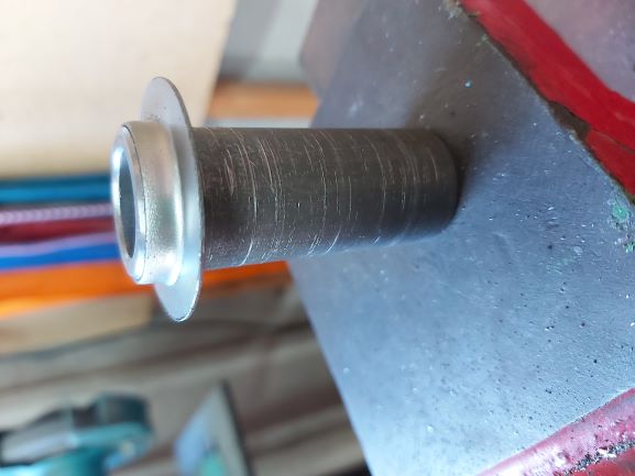

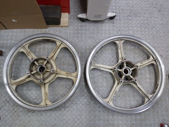

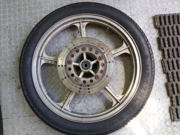

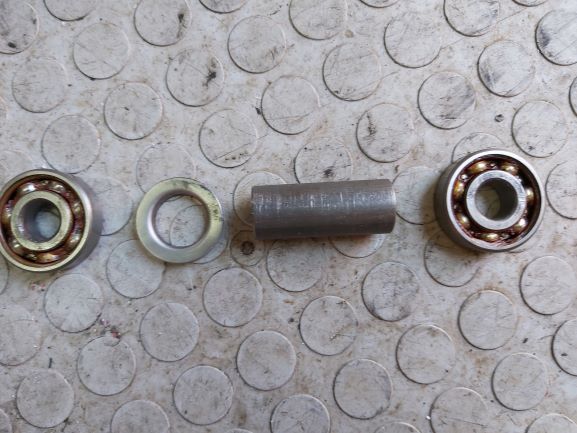

The wheels were next to come apart as they need repainting and the discs were scrap. I was worried the disc bolts would be seized and if I used my impact driver gun, it would round the heads. So out came my trusty impact driver and 4lb hammer and they all came out without drama. I have a new found respect for the humble impact driver :D The bearings on the front wheel were a real mare to get out as I couldn't get the spacer tube between them, over enough to get a solid punch on the opposite bearing. Eventually after an hour or more and much swearing, cursing and the obligatory spilling of blood, they came out. In contrast the rear bearings took 5 minutes ! The spacer is just a tube with a collar pushed on and the collar on the front one had come loose, which might explain all the hassle I had. A quick tap with the hammer and it is back in place :)
Spacer before and after -
Spacer 1 small.jpg (52.37 KiB) Viewed 147446 times
Spacer 2 small.jpg (31.96 KiB) Viewed 147446 times

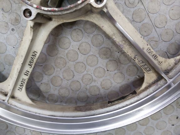

I gave the wheels a quick clean up and gave a section of the rim a polish to see how they would come up after languishing in my shed for 20 odd years and thankfully the rims look OK, but might need a bit of a deeper polish to take out any remaining imperfections.
Wheels before and after
Front Wheel small.jpg (64.9 KiB) Viewed 147446 times
Wheels small.jpg (56.43 KiB) Viewed 147446 times
Rim partly polished

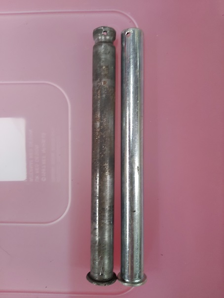

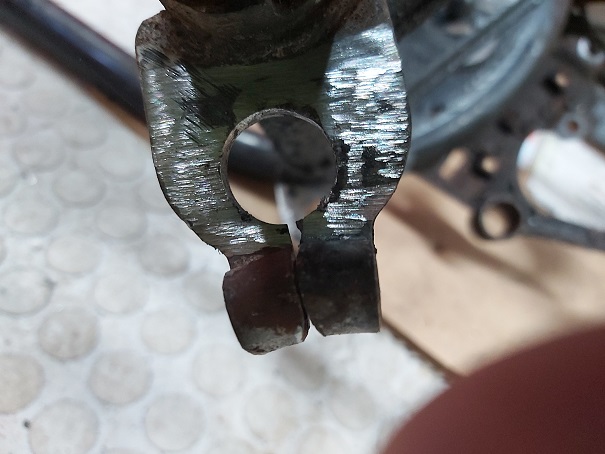

I've had to have some remedial work done to the frame - the steering lock stop had to be re-instated on the headstock ( It had been removed to accomodate the "other" forks & yokes I was going to use). Also, the main stand bracket had gone oval where the pivot goes, so needed building up with metal. The original stand pivot tube had almost worn through where it was turning in the frame. Thankfully, i tracked down a NOS item in the USA as it's NLA via Kawasaki.

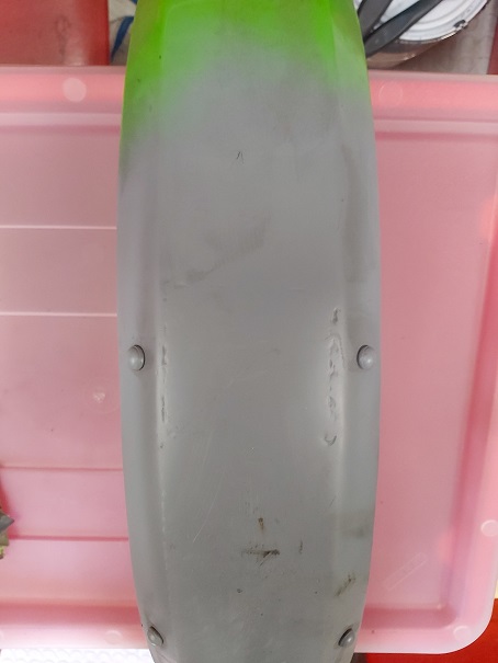

Additionally, the front mudguard had some rot between the brace and the guard itself and that's been cut out, with a new piece welded in. Thankfully, other than that it's sound and with some making good of the welded area it'll be good to re-use.
Built up and back to round !

New pivot against old worn one - can you work out which is which :D
Stand Pivot Small.jpg (53.04 KiB) Viewed 147348 times
Corroded metal removed
Rusty Mudguard Small.jpg (101.86 KiB) Viewed 147348 times
Patched and ready to be finished
Muguard Small.jpg (51.48 KiB) Viewed 147348 times

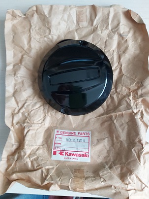

Sometimes rebuilding a bike, you strike it lucky.
This arrived a couple a days ago - possibly the last NOS GPz550 ignition cover in the UK. It had been gathering dust dust on a shelf in a Kawasaki dealers for almost 40 years, until I tracked it down and liberated it :D

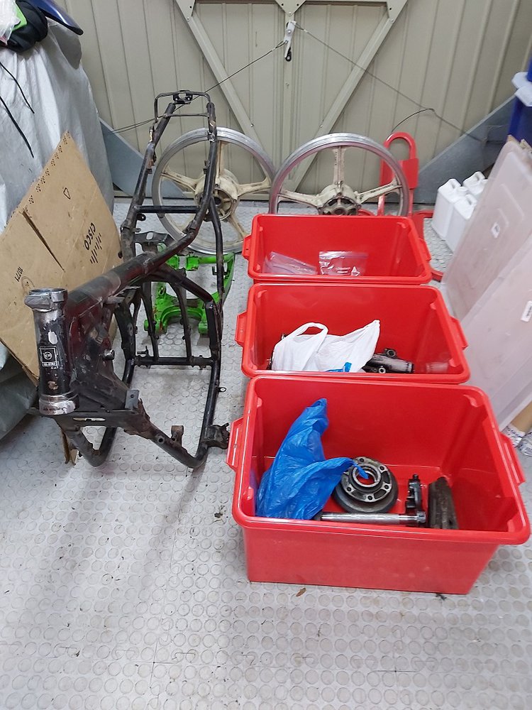

After another weekend in the garage, I've finally finished cleaning and checking the frame and running gear. Thankfully, I didn't find any horrors and with everything sorted into various containers, it's time for a trip to the Powdercoaters :-)

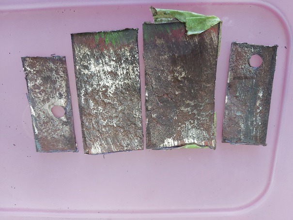

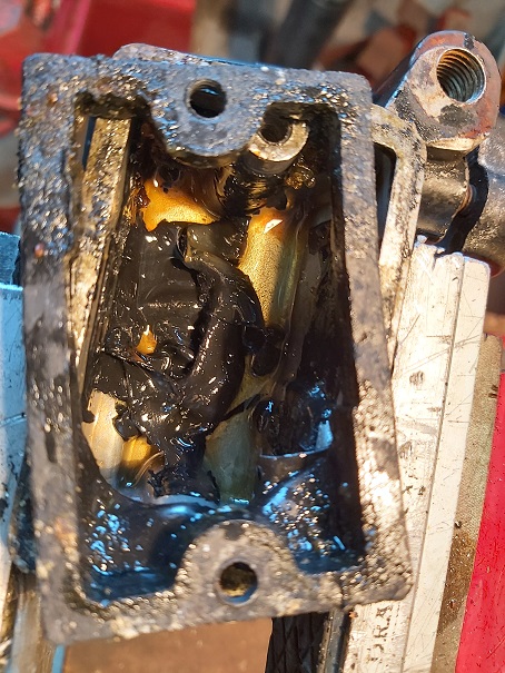

I decided to tackle the master cylinders first and unexpectedly, the screws holding the cap on the ffont m/cyl came undone without too much of a fight. However, when I took the cap off, I was greeted by a thick black gunge sitting in the reservoir. it took me minute to work out that it was the remains of the diaphragm :shock: It must have dissolved over time as a reaction to being in contact with the brake fluid.
Fonrt m-cyl.jpg (162.45 KiB) Viewed 147068 times

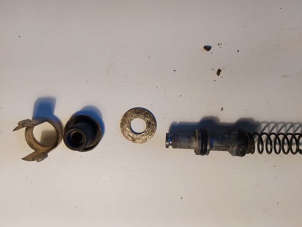

The piston was stuck, but came out without too much effort, but I was slightly shocked to see the piston is not held in by a metal circlip as I expected, but a plastic clip that just pushed into the M/cyl bore !
Front piston.jpg (51.78 KiB) Viewed 147068 times

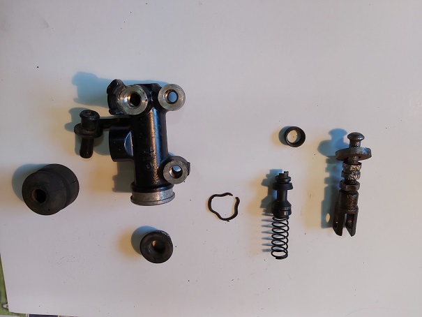

The rear m/cyl was much the same, except the piston was so stuck,so I had to carefully drill the head off it, to free it up. The rod from the brake pedal to the m/cyl is pretty corroded, but is NLA. I'll have to see how it looks when it comes back from the rebuild, but I'll keep a look out for a good secondhand one in the meantime.
Rear m-cyl.jpg (55.22 KiB) Viewed 147068 times

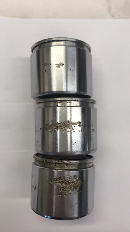

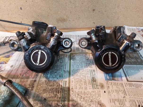

The calipers were next and whilst they didn't look too bad, they were as furry as my cats :lol: The pistons were stuck solid and the bleed nipples didn't want move either. I didn't want to damage anything trying to get them apart and it was at that stage I decided to send the whole lot away to be professionally refurbished. Once I'd factored in my time in stripping everything, then the cost of getting them aqua blasted, then painted and sourcing new pistons, seals, etc to rebuild them - it made sense (to me anyway) to farm out the rebuild.
That was a couple of weeks ago and the people rebuilding my brakes sent me this picture of the pistons, they removed from the calipers :shock:
Having seen those, I was happy that I decided to send them away for refurbishment as they were probably well seized in and I would probably have damaged the calipers themselves trying to remove them myself.

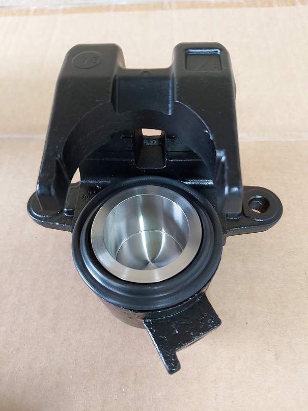

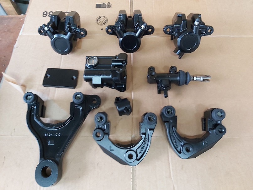

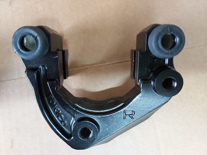

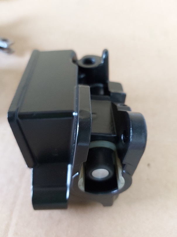

The brakes have come back from Powerhouse and I'm well pleased with them :D
They've been stripped, cleaned, painted and rebuilt with all new seals/stainless pistons & rubbers. I have new decals to apply, but they can wait until the calipers are back on the bike, so I get them the positioned correctly ! For now, they are safely stored away awaiting fitment later on in the rebuild.
Master Cylinder rebuilt.jpg (87.4 KiB) Viewed 146874 times
Caliper Bracket.jpg (152.08 KiB) Viewed 146874 times
