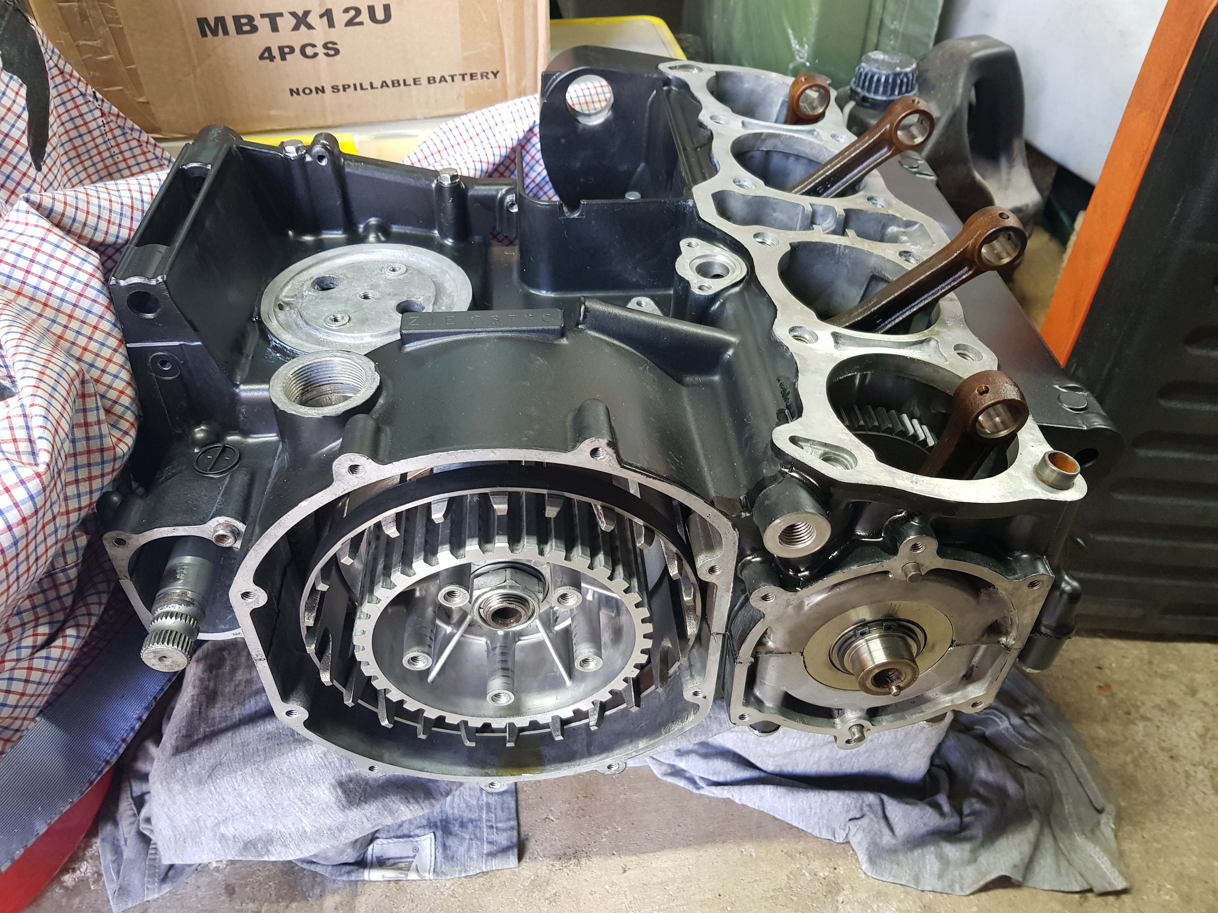

#7 PostAuthor: davidcouzens » Mon May 18, 2020 10:13 pm
Just a few photo updates
Back in the frame
Forks polished with new seals, clips and washers
Cam cap repaired
Back on her wheels
Still lots to do happy so far tho

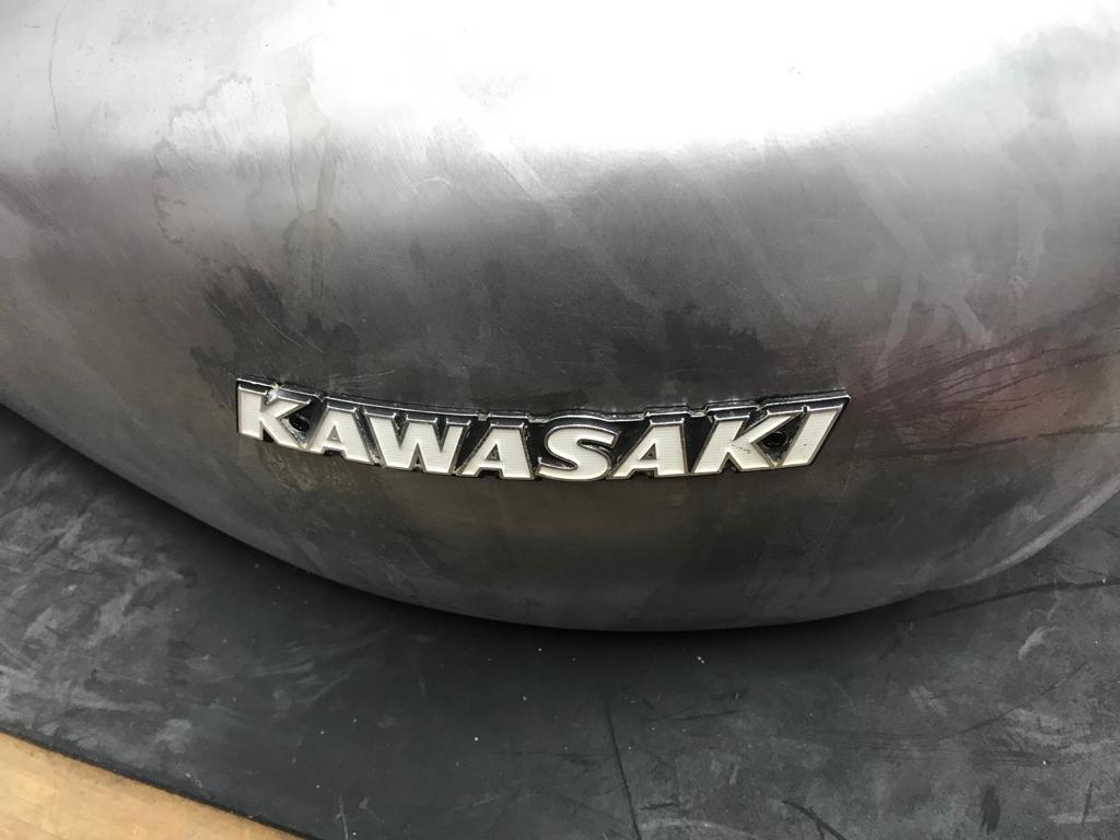

#15 PostAuthor: davidcouzens » Thu Feb 04, 2021 8:20 pm
Had my tank repaired by Andy at Motorcycle Dent Removal
Cannot attach photos of before as files too big but looks a lot better now
Ready for paint have spoken to Shaun Dewis today and booked in
