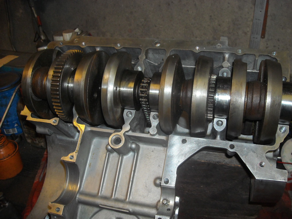

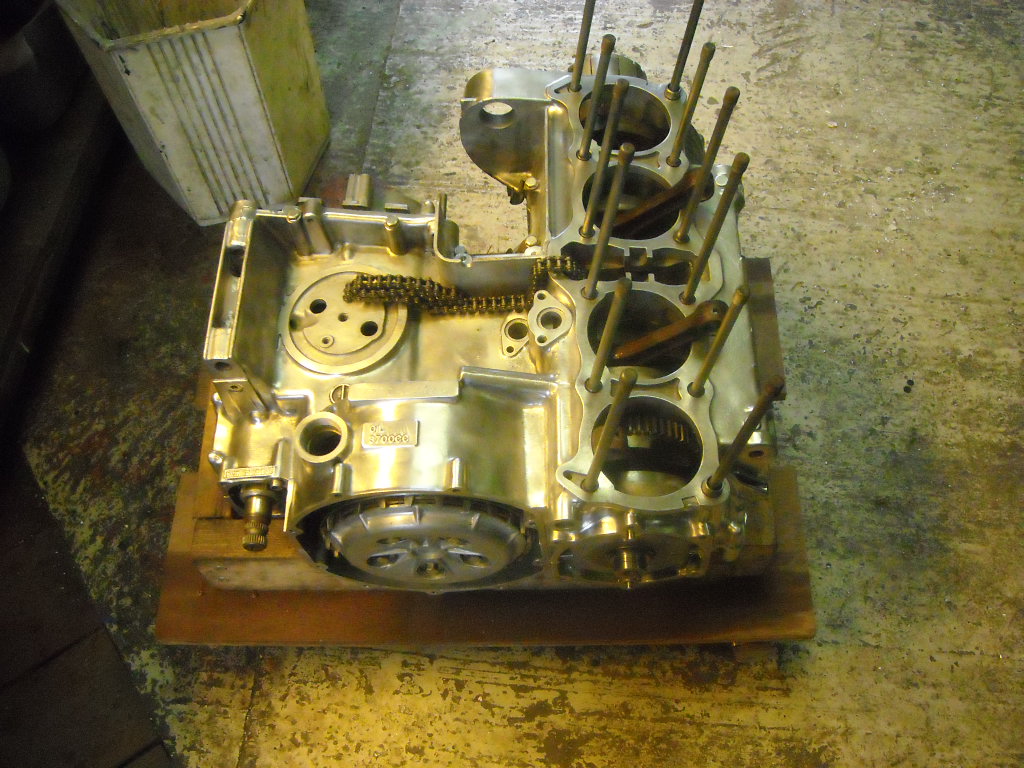

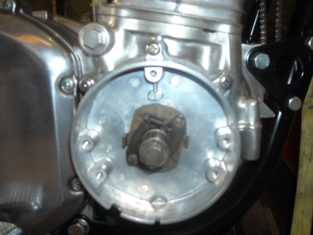

As usual I start with the engine.
The upper crankcase had an issue with the lugs where the starter motor is attached. They were broken off some time in the past so they had to welded and the threads needed to be repaired.
That was done by a pall who knows how to weld aluminium. Thank you Freddy!

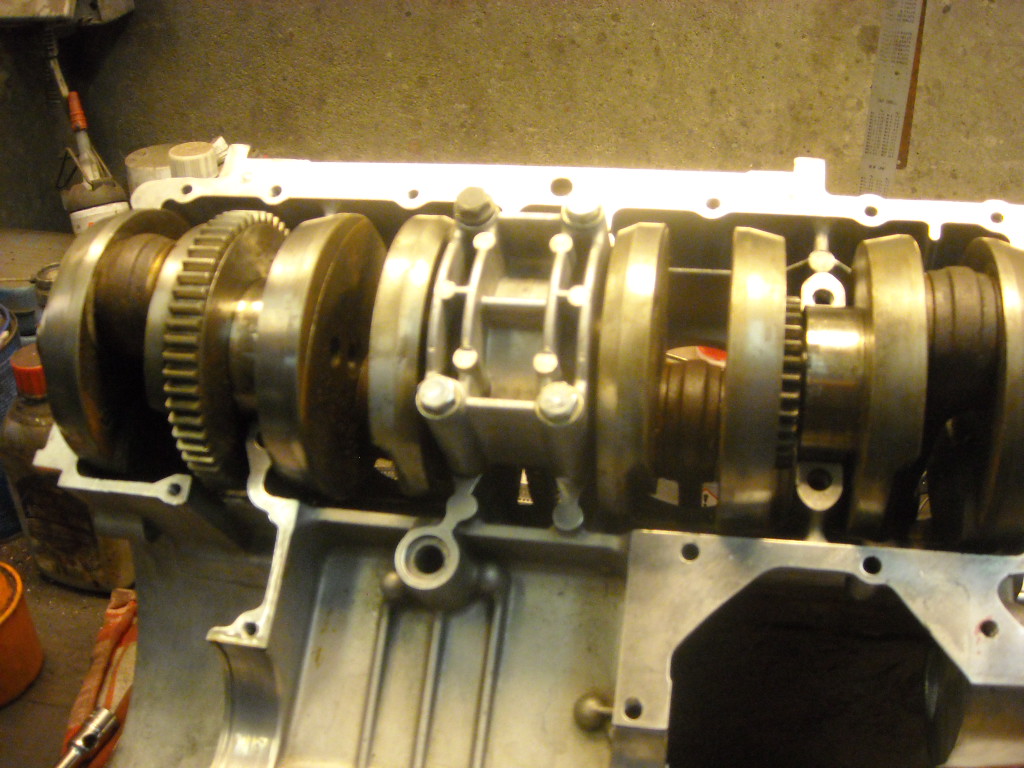

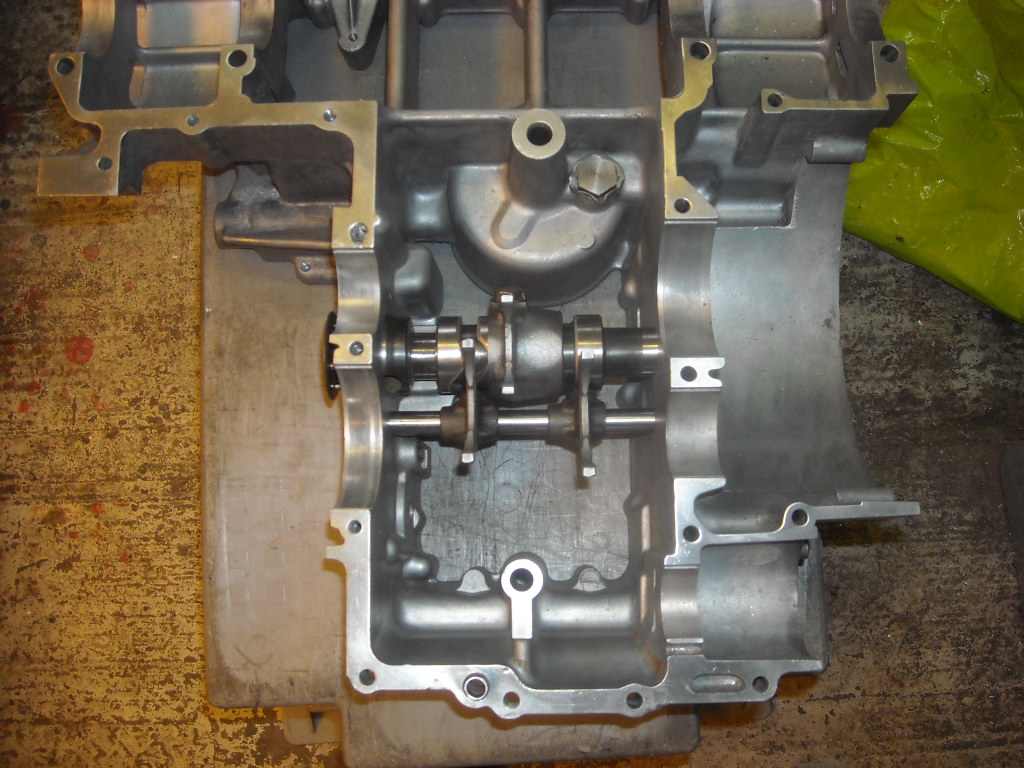

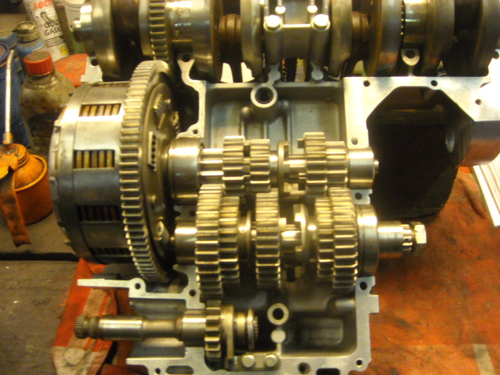

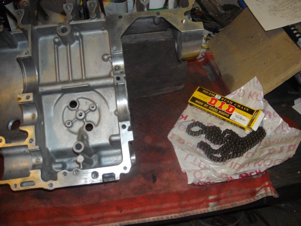

I usually put a new endless camchain on before the crankshaft goes in the upper crankcase.
Then the gearshafts and the kickstartershaft go in .
The gear selector and the forks go in the lower crankcase and the two cases are assembled.
Don't forget to put a new oil seal between them!
Afterwards the outer gear selector and the cover are mounted. New oil seals are mounted. Don't forget the tiny O-ring on the outgoing axle behind the bushing where the front sprocket is mounted !
After a few hours the lower engine is completed and now it's time to mount the other parts.
That'll be within a few days.

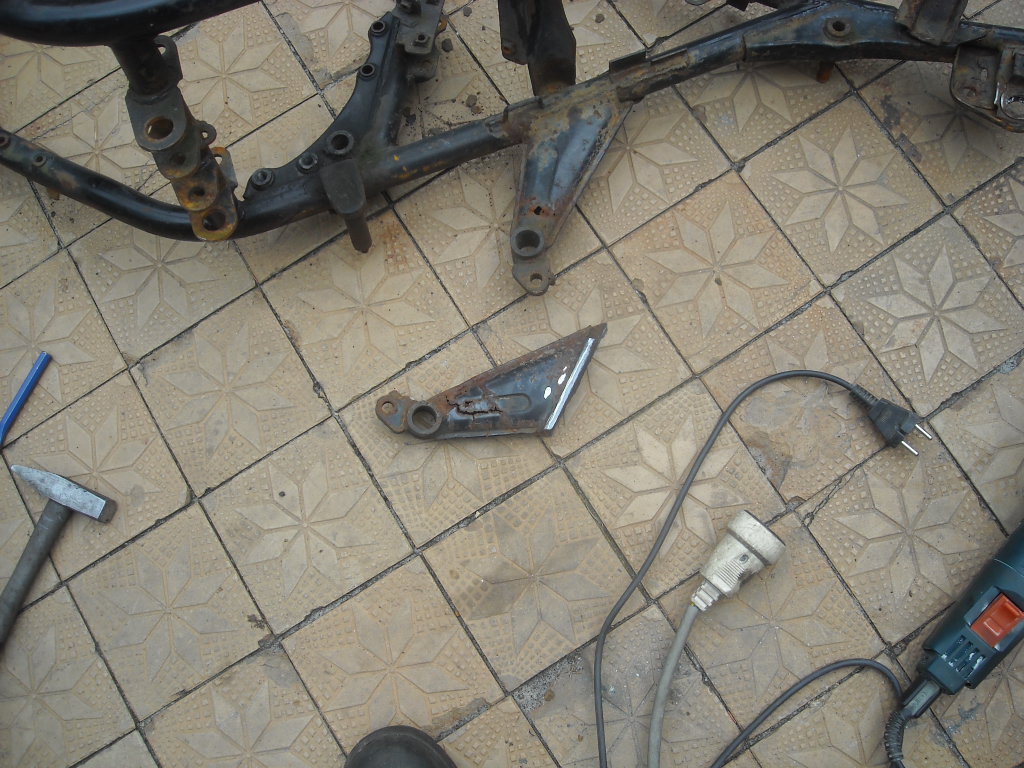

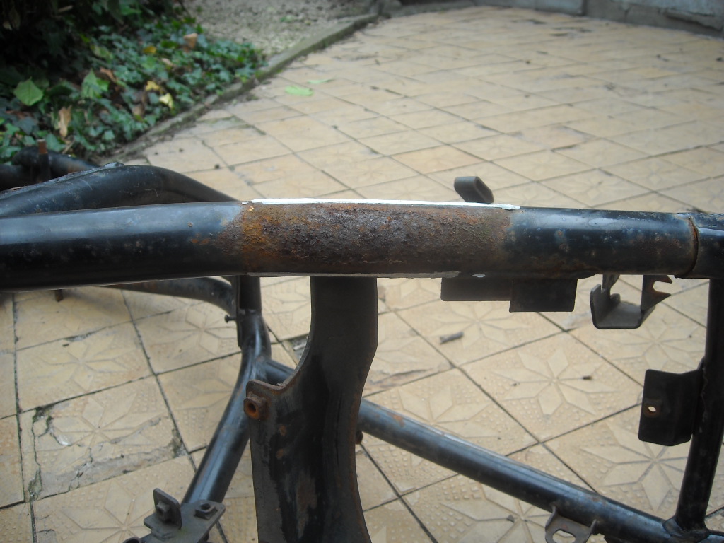

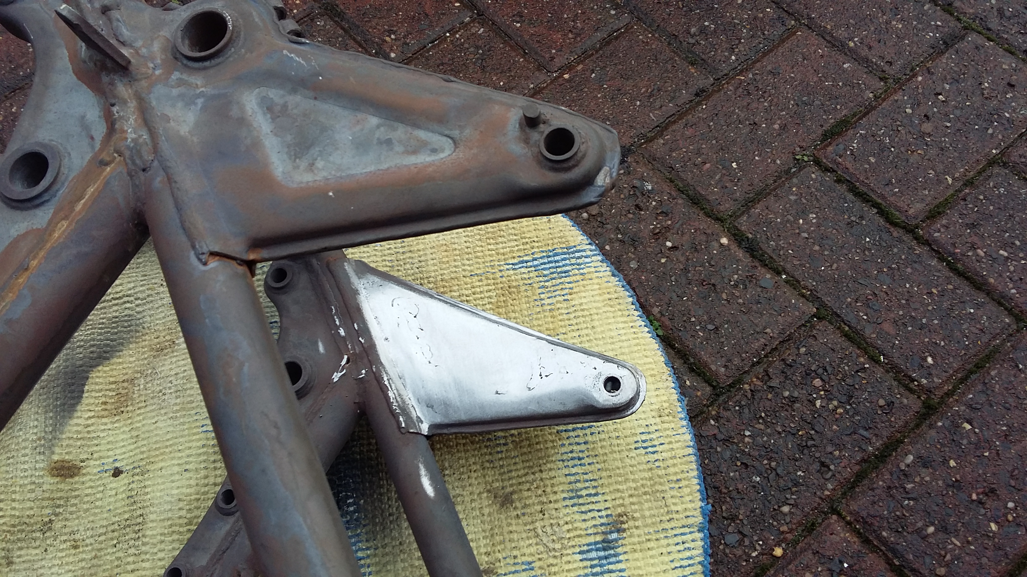

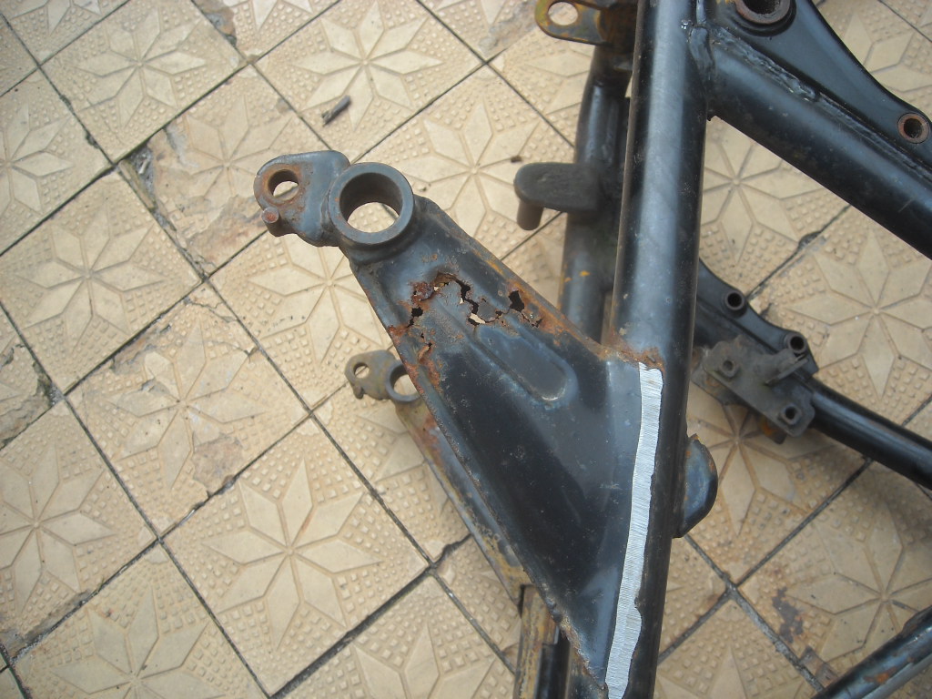

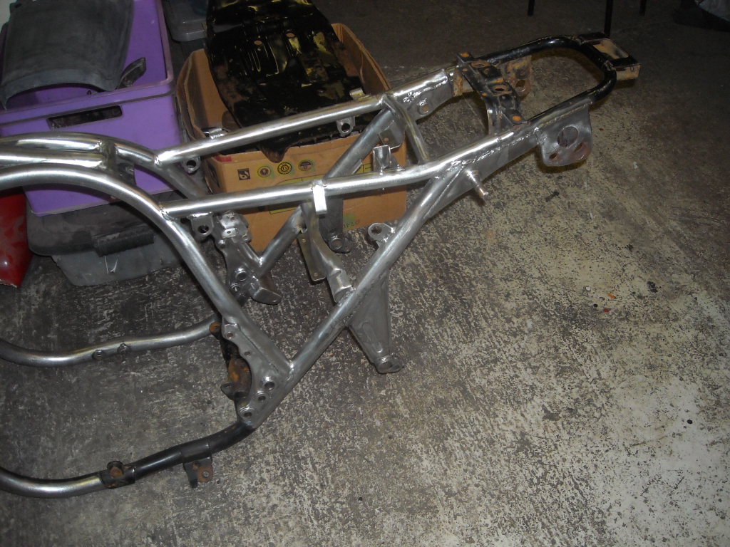

I decided it was time to do something about the " issues " of the frame...
See for yourselves:
You can see right through the passenger footrest brackets...not good, not good at all!
OK, something must be done to repair them.

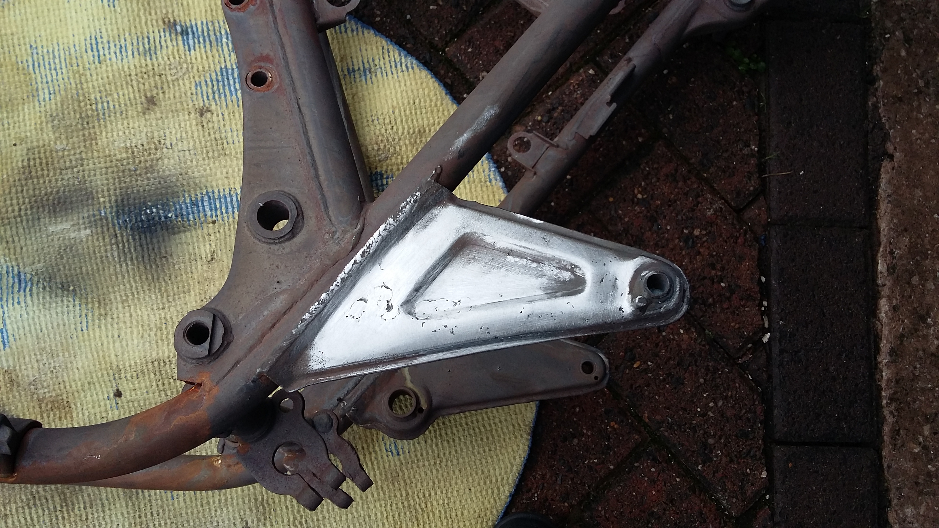

So I decided to grind them off and to replace them with good ones.
After 15 minutes of fear, the two brackets were off the frame.
The frame tubes are not damaged, only a bit rusty.
More to come soon!
See for yourselves:
More to come soon!

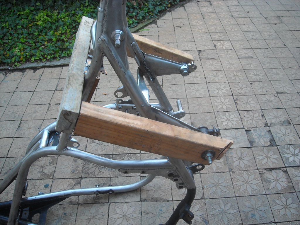

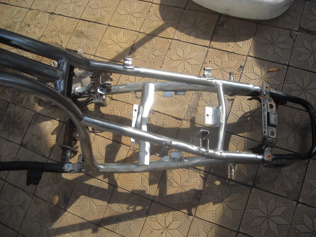

Hi men
an update on the frame:

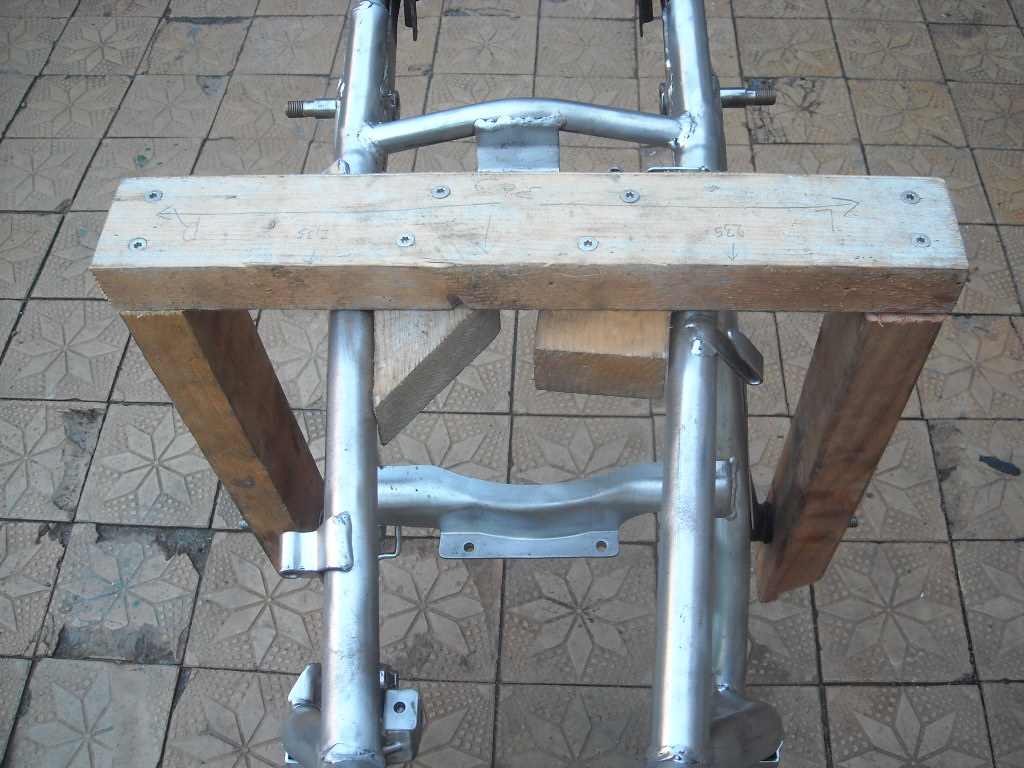

- rear footrest and exhaust hangers welded on the frame
- the old paint mostly removed of the frame

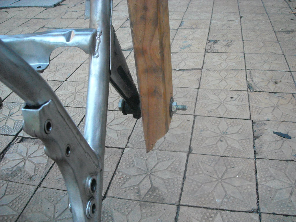

I made a jig in wood and took some measurements before I removed the exhaust hangers from the donor frame so it would be easy to attach them on the new frame at the correct place.
A long M10 bolt was used to attach the hanger on the wooden jig.
Two pieces of wood were attached between the rear frame tubes to find the correct place
As you can see : it's no rocket science, anyone can do these things.
More to come !

Nice work. Did you fabricate the new exhaust and foot rest hangers?

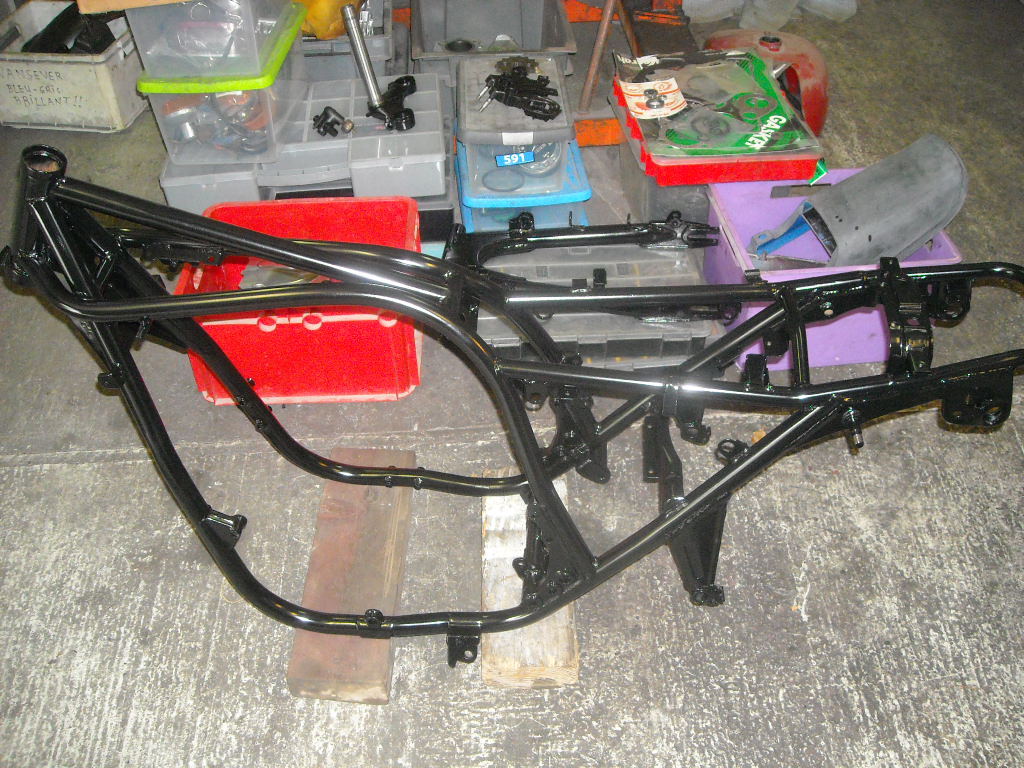

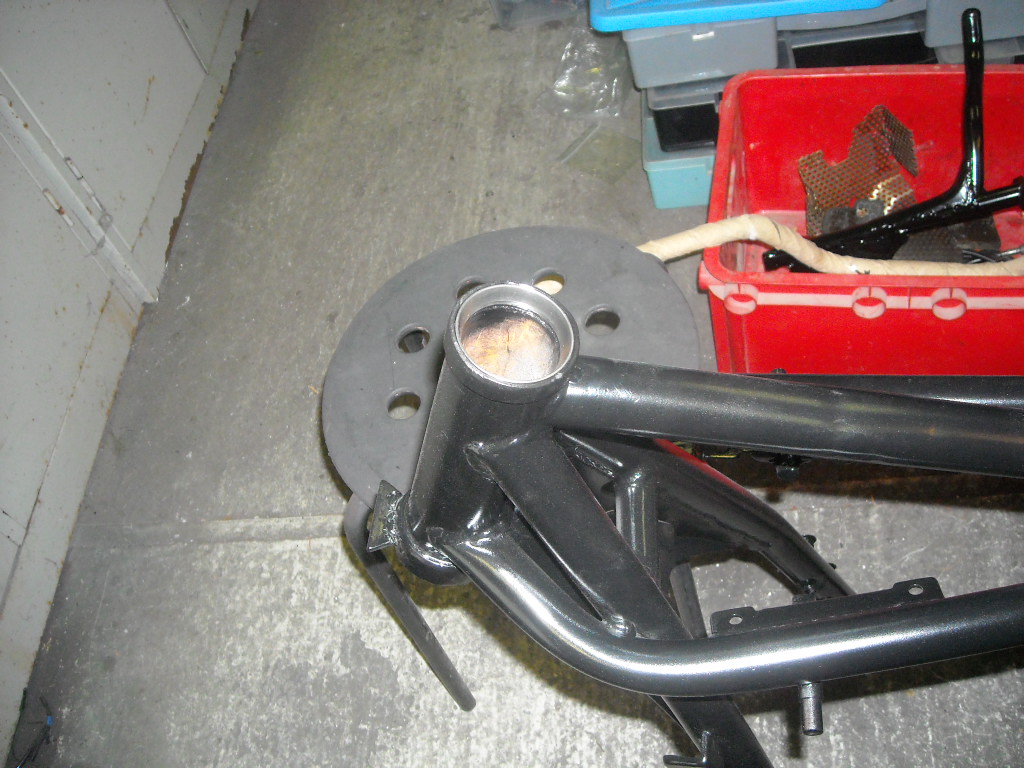

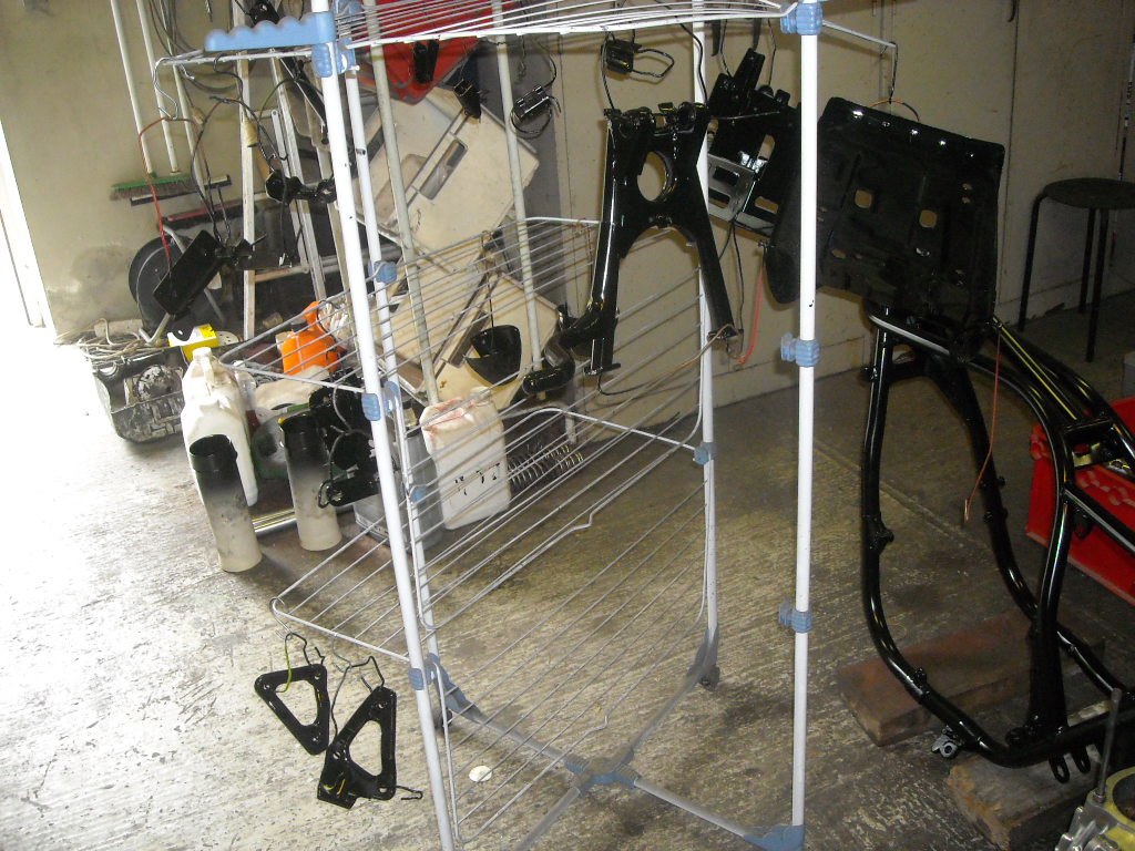

Hi men
the next episode:
- the frame is painted
- a lot of frame parts are painted, those that need the "glossy" look
Painting parts is always a bit of a challenge. You have to make sure you can hold them when painting and you have to make sure you can hang them to let the paint cure. In the mean time you must take care that, when you paint the parts, you don't forget to paint a spot. After all you can't spray behind a corner, the spray of paint goes straight ahead . It' s always turning the part around and up and down to see behind all the corners.
Now it's time to prepare the other frame parts, those that need the "dull" black paint.
The brake calipers were allready painted, now it's time to prepare the wheels and the disc rotors.
That'll be for a next time.

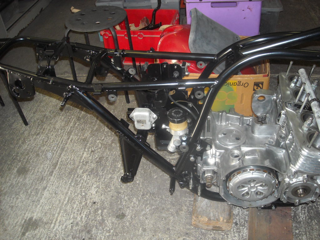

I have some progress on the engine and on the frame.

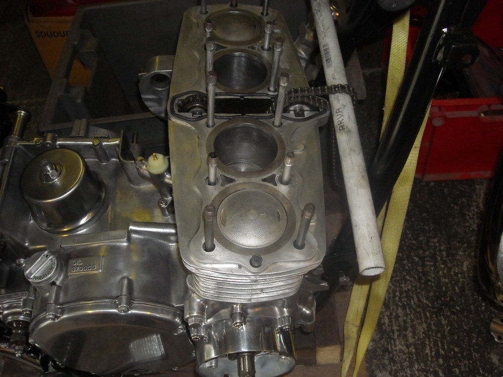

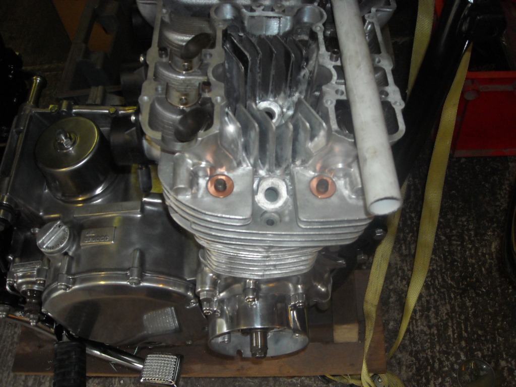

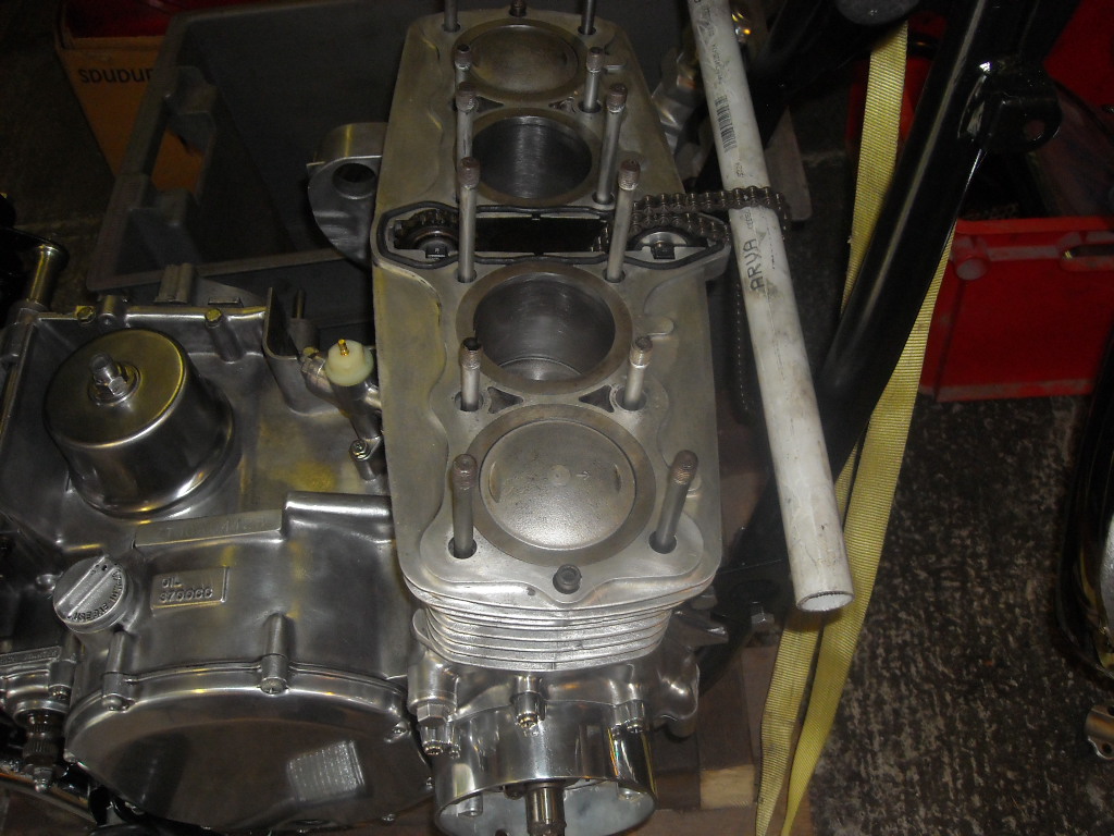

The new piston rings arrived and were mounted on the pistons and those were mounted on the crankshaft, the cylinders were honed and
mounted over the pistons.
After that I couldn't resist to mount the engine in the frame so see for yourselves...

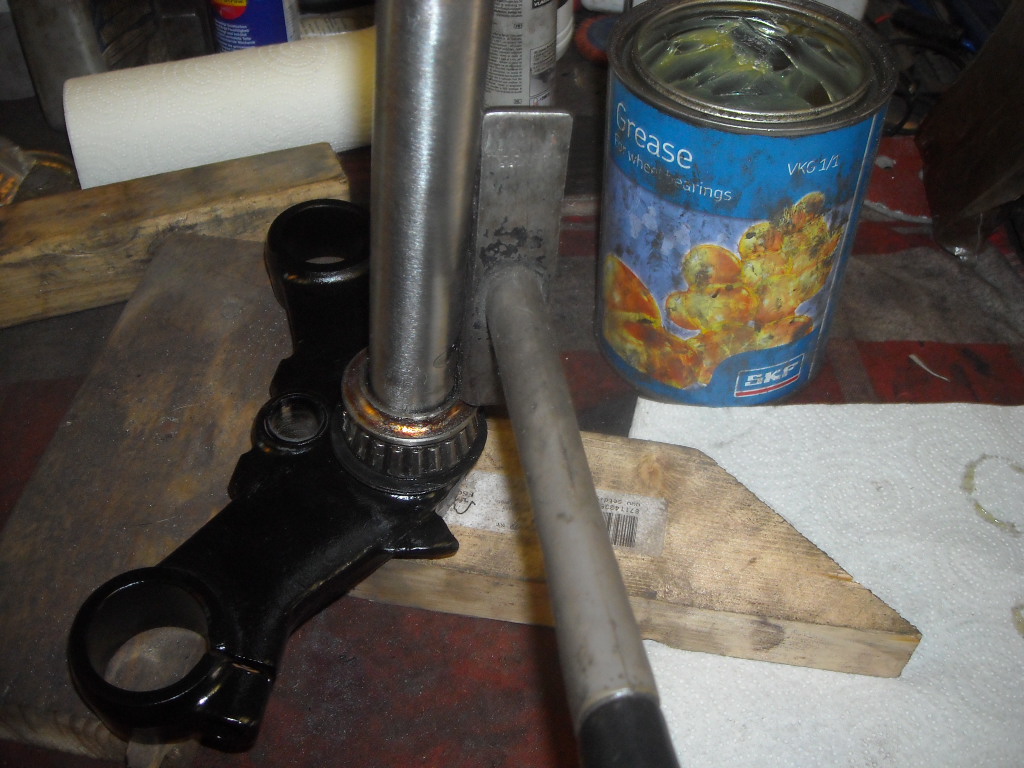

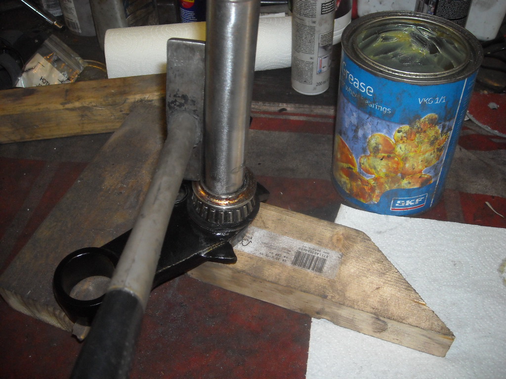

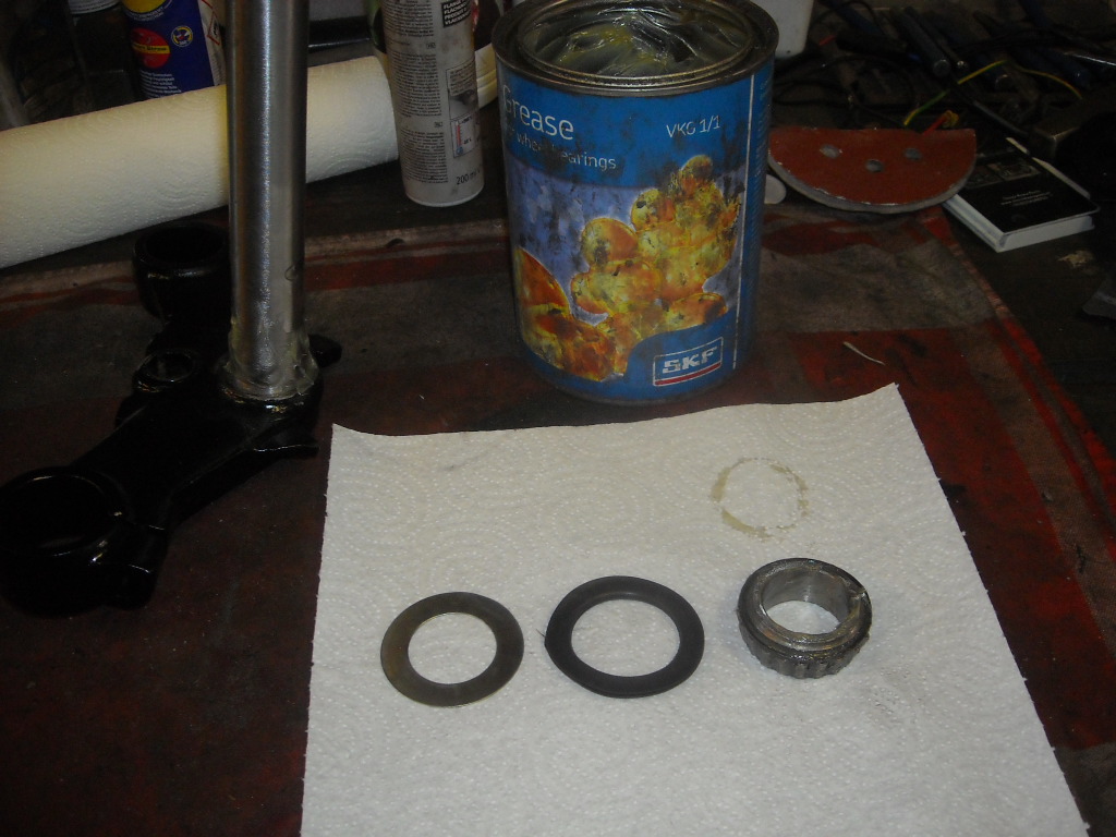

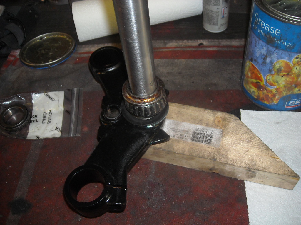

Before mounting the engine I placed the SSK400 conical bearings in the frame.
The top and bottom shell of those were mounted in the yoke tube.
When mounting the conical bearing on the yoke you should take care of some precautions:
-the correct way of mounting parts: first the big flat washer, then the rubber seal and afterwards the bearing.
-use a lot of grease to lubricate the steering stem and the tapered roller bearing.
-use and old shell to place on top of the new bearing
-take a hammer and slide along the steering stem left and right to get the new bearing at the correct place
-make sure the rubber seal sits correctly centered so it protects the bearing against water and dust
The top tapered bearing is a peace of cake to mount, here again,use plenty of grease.

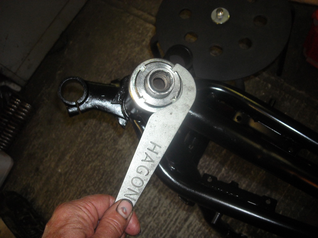

A handy tool for giving the big nut the correct tension without damaging it: the tool to change the preload of the spring of the rear shock dampers.
So, that's it so far.

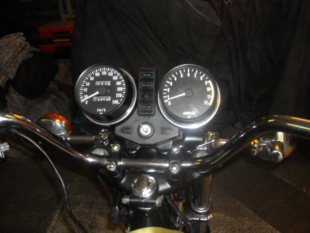

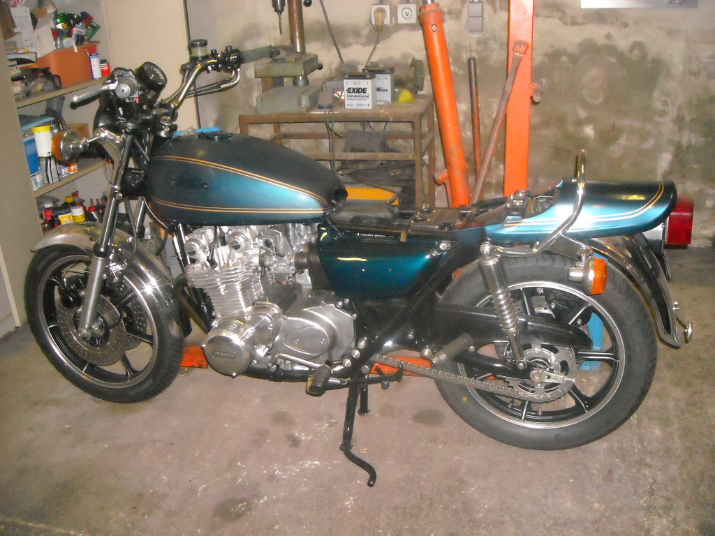

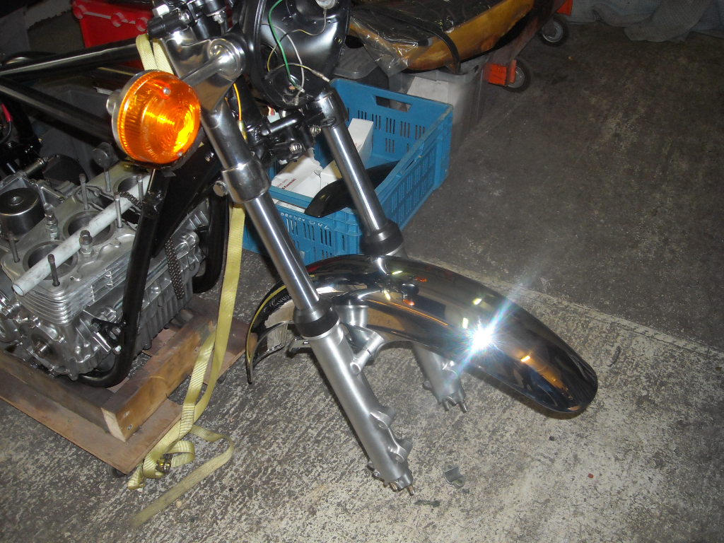

Hey guys
I made some progress the last week.
At the front of the bike:

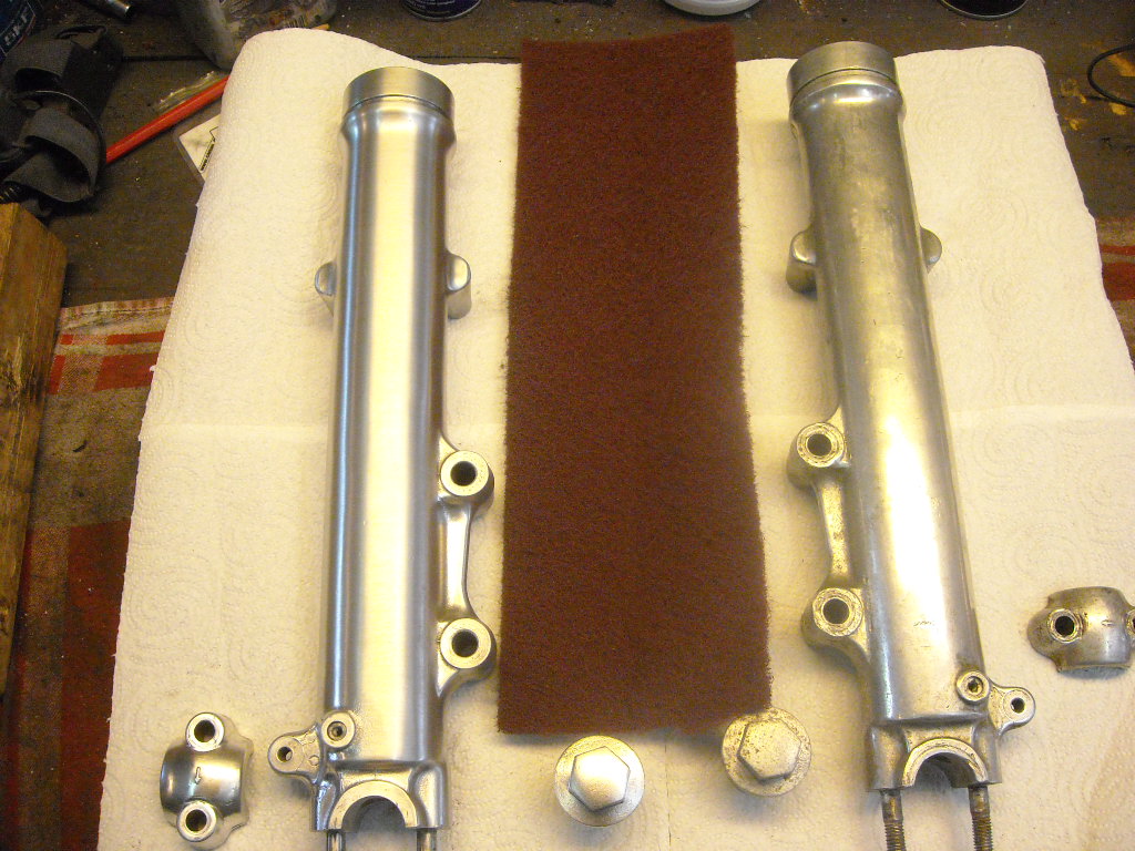

- the front fork was cleaned, polished and given a clear coat
as usual I use the nylon brushes to clean it and the white rubber brush to polish it
a string of "scotch brite" is used to give it a bristled look
- the clear coat had to cure for a few days and this morning was baked in the oven.
- the front fork was then assembled and mounted in the yoke

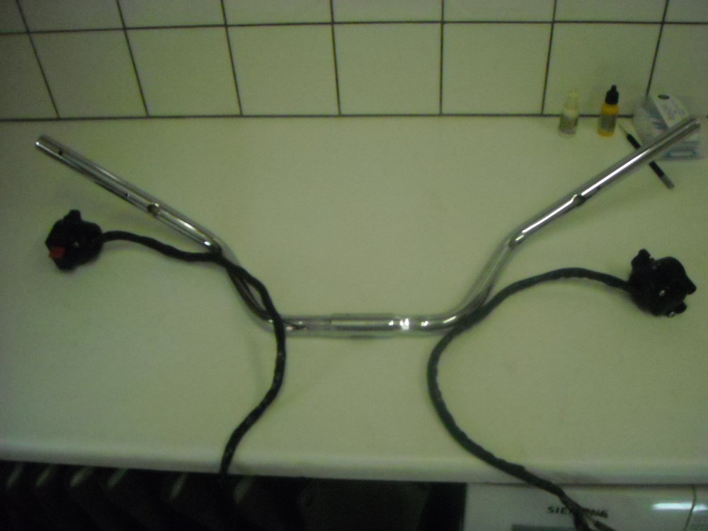

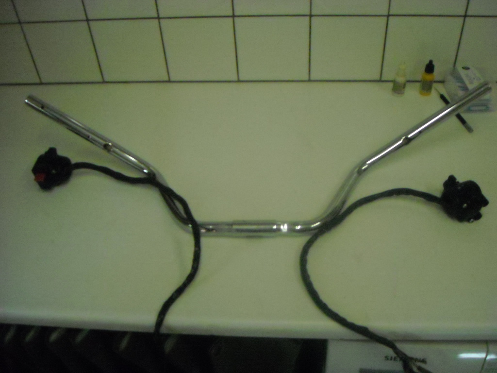

- the handlebar switches were painted, assembled and mounted on the handlebar
- the handlebar was mounted
- the clocks were assembled and mounted

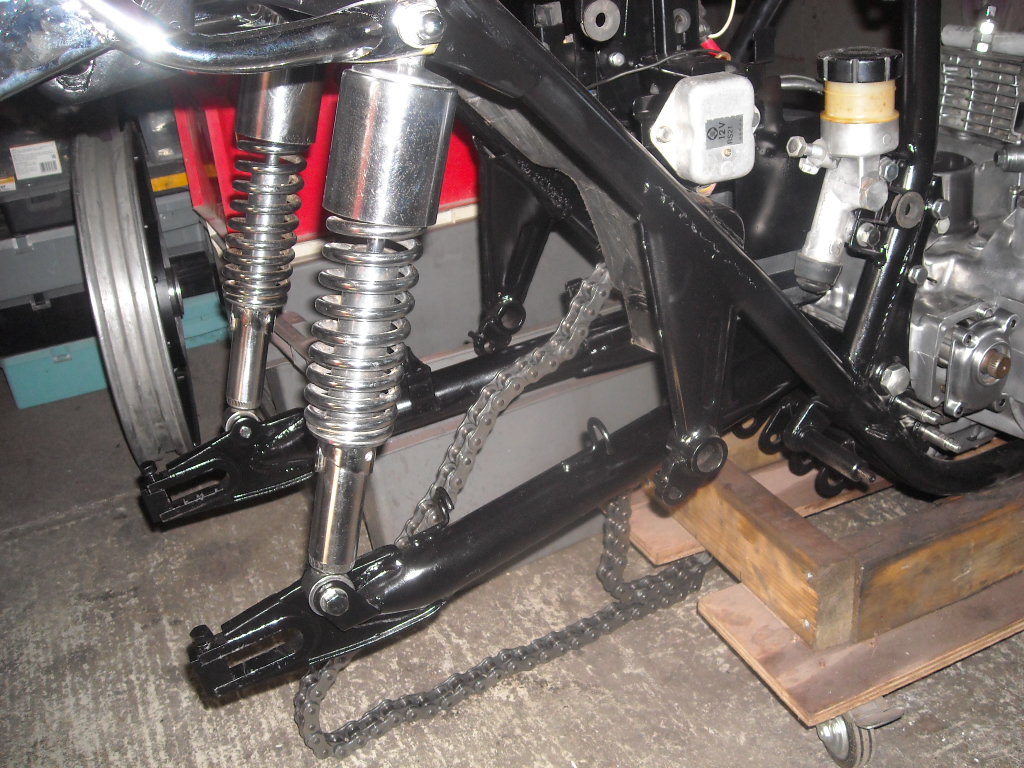

At the back of the bike:

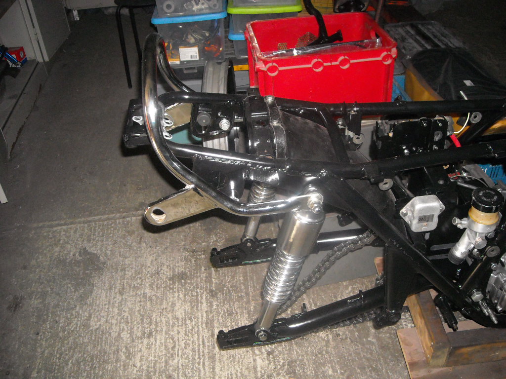

- the swingarm and the rear shock absorbers are mounted.
- a new endless chain was mounted at the same time
- a grabhandle with "ears" found it's place
Now I'm waiting for the BT46 tyres to arrive. They should be here next week.
A bit more patience, the old lady is almost on her wheels again !

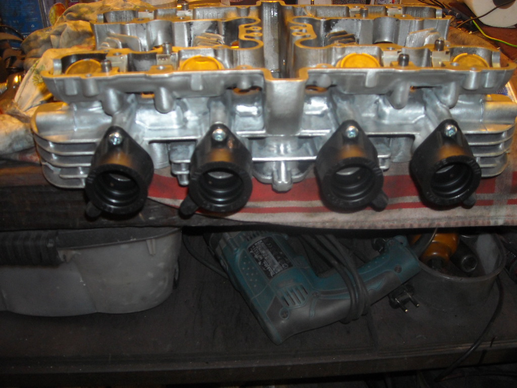

Hello men

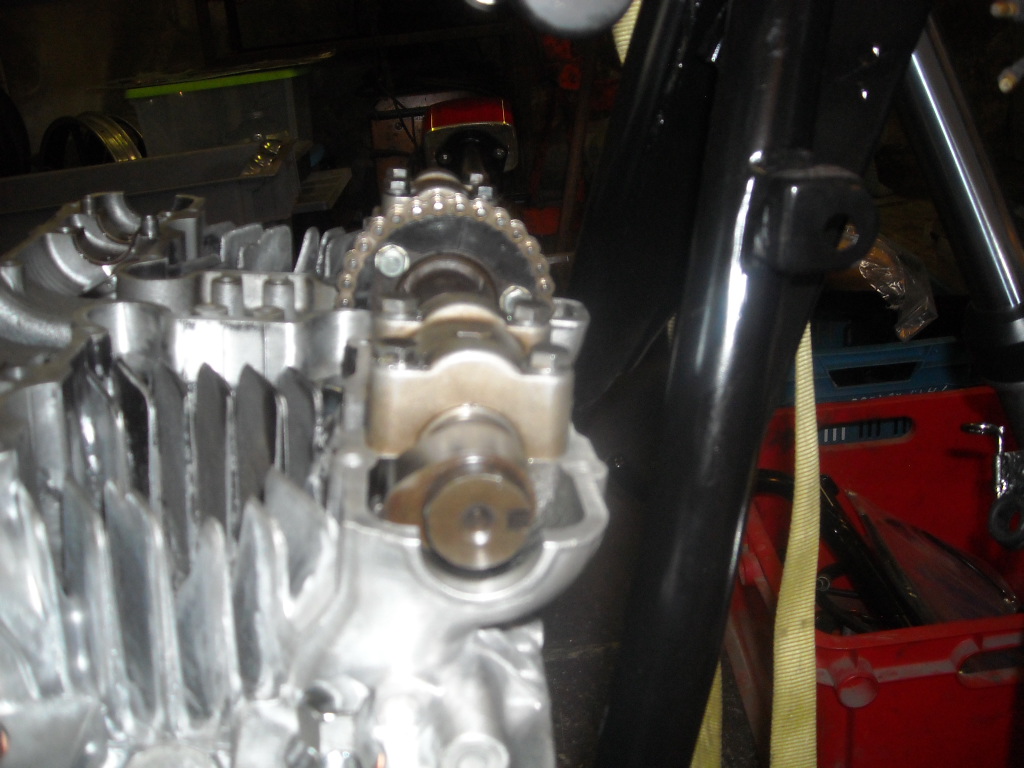

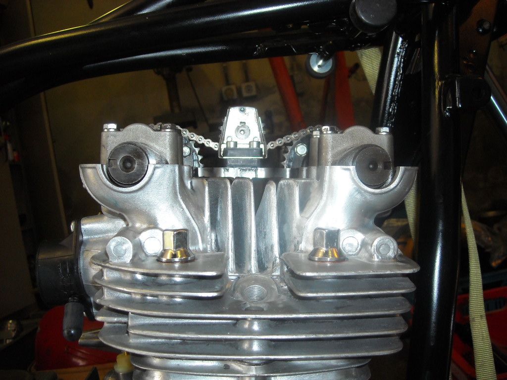

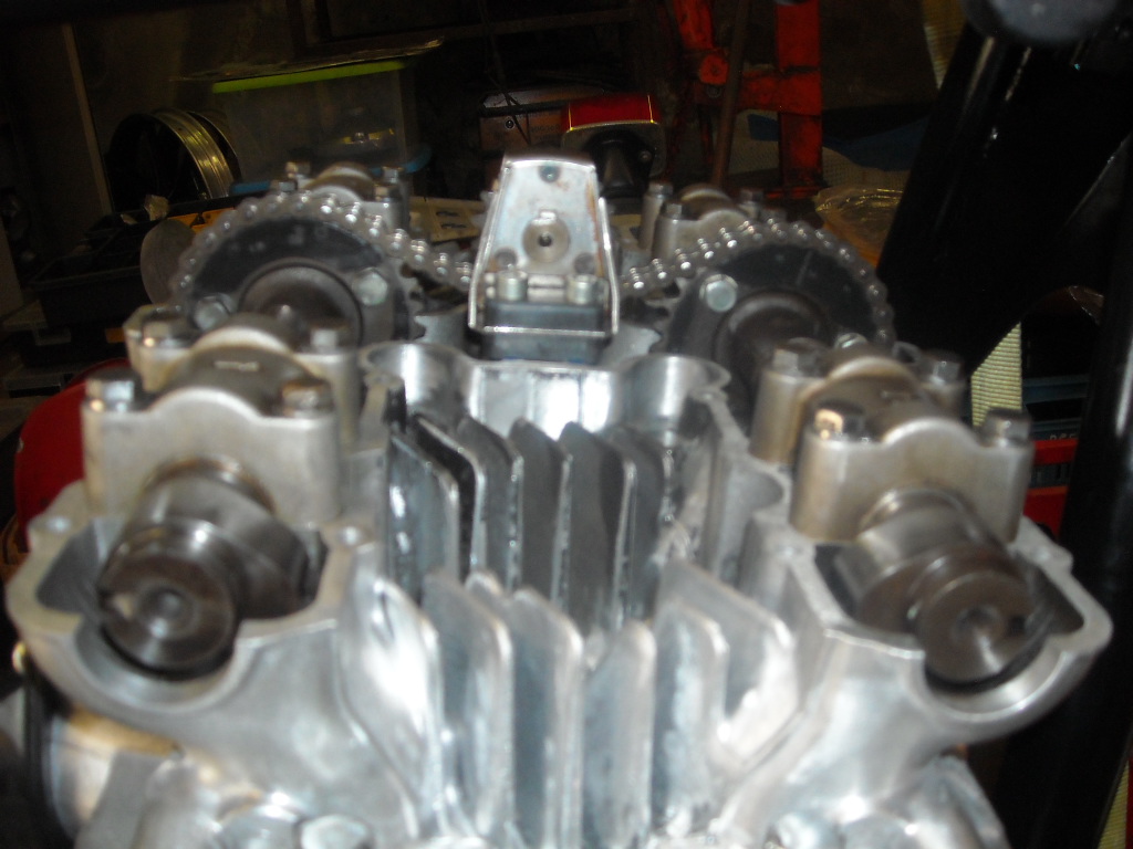

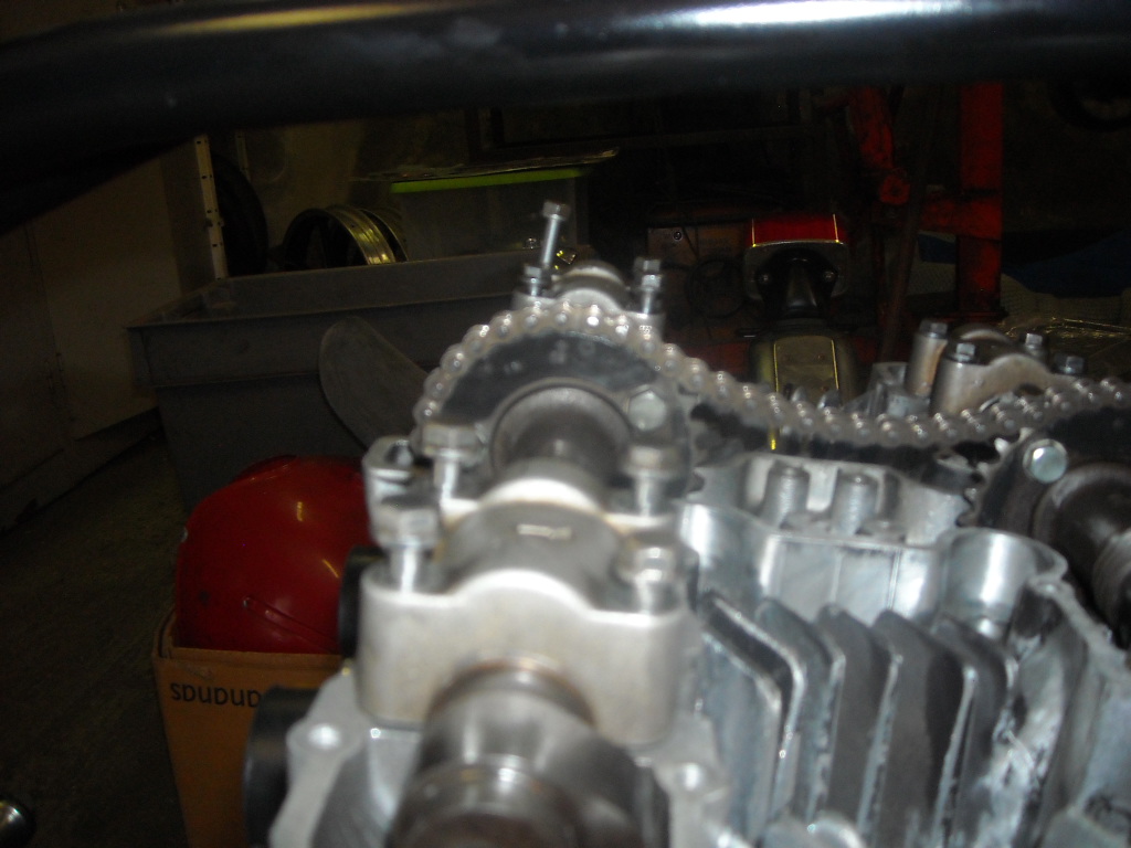

because I'm waiting for the tyres to arrive, I decided to do some work on the engine.
It was time to mount the cylinderhead and camshafts.
Most of you have done this and know how it goes. For those who never tried to mount a cylinderhead and camshafts I took some pictures.
You start with mounting the dowels on each side of the cylinder block, you put the front and rear sprocket with their rubber parts and with the camchain tensioner in the cylinder block and don't forget the O-ring around the camchain tunnel.
Don't forget to mount the carburettor intake rubbers, it's easier now!
Now it's time to mount the cylinder head.
After you put the head at the correct place you can start with the copper and steel rings. The four copper rings go on the outside, the steel rings on the inside.
Now it's time to fasten the cylinder head nuts. They must be done in a specific order, the first time at a torque of 2,5 Kg, the second time at a torque of 4 Kg.
Then it's time to put the camshafts in.
Before you do anything else: put the number 1 and 4 piston at the top dead point. You can do this by turning the crankshaft and look at the ignition timing advancer. The "T" must be aligned with the mark . This is very important and something you have to check before every further step.
Start with the exhaust camshaft. Pull the camchain taut and put it over the camshaft sprocket.
Make sure the mark on the camshaft sprocket alignes with the upper surface of the cylinder head;
If that is OK bolt the camshaft caps 1 and 2 in place. Do this gentle and equal at both sides. Push a bit on the camshaft to release the strenght on the bolts.
Now it's time to mount the intake camshaft.
Start counting 28 pins of the camchain and make sure that pin is on the "28" mark of the intake camshaft sprocket.
If that worked out you can mount the number 3 and 4 camshaft caps.
Mount the cenrte sprocket,
mount the camchain tensioner and activate it by releasing the M6 bolt.
Take a 17 wrench and turn the crankshaft around, do this several times to be sure that the timing is correct
If the two indentations on the side of the camshafts face away from eachother and they are aligned with the top of the cylinder head, you did ste the timing correct!!
See you next time!

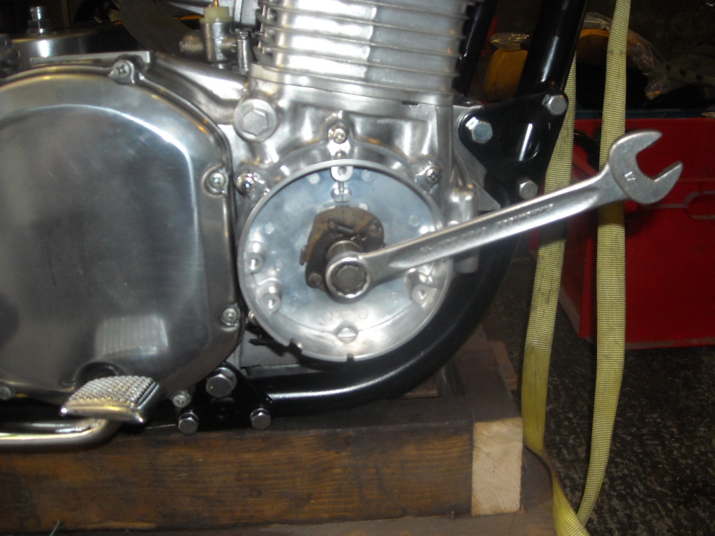

See you next time!

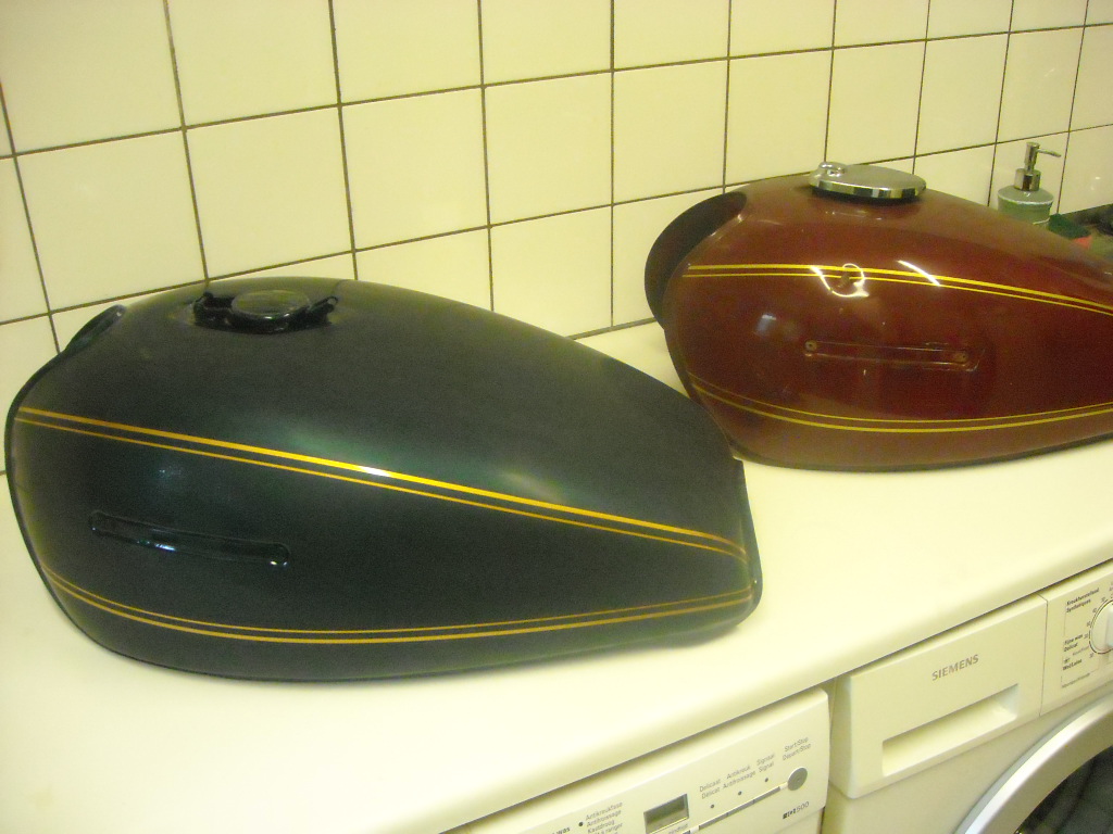

it's been a while since you heard something about the project but here it is:
- the BT 46 tyres arrived, they were mounted on the wheels and now the old girl is back on her wheels again.
- I had a lot of work on the body parts, the paint of the fuel tank, the side covers and the tail was completely stripped, dents were filled up with filler, an adhesive primer was applied on the plastic parts and then base coat was applied and a thin clear coat.
- last friday I received the decals and they were applied to the fuel tank and on the tail after the clear coat was grinded with wet and dry n° 2000.
- during the weekend I recovered the seat and mounted it on the frame.
- I hope that the temperatures will rise over 15 °C so I'm able to apply a clear coat over the body parts.
I took some pictures of the decals. I have a Z1000A1 fuel tank and tail with the original paint and decals on it so I used those as a reference to apply the new decals.
You need simple tools to apply decals. A bit of water with a few drops of dishwashing soap to moisture the surface where you want to put the decals. A few adhesive ruban to use as reference marks , a piece of rubber to wipe the water away and a hobby knife to cut the decals at the correct place. You allso need kitchen paper to dry the decals after applying them.
This is the result. Just a few days to allow the decals to dry completely and higher temperatures to apply the final clear coat.
As soon as I have more news I'll let you know!
