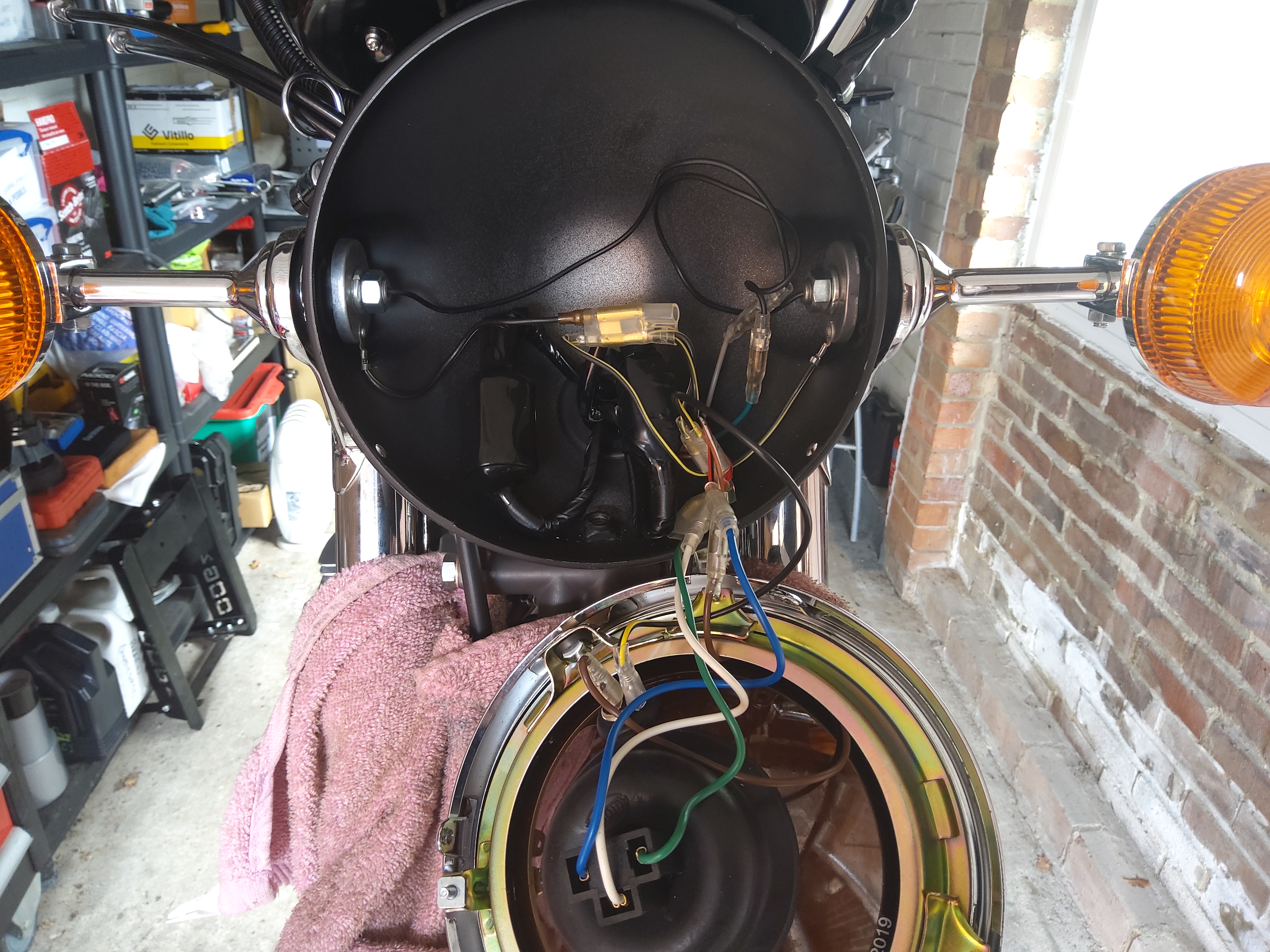

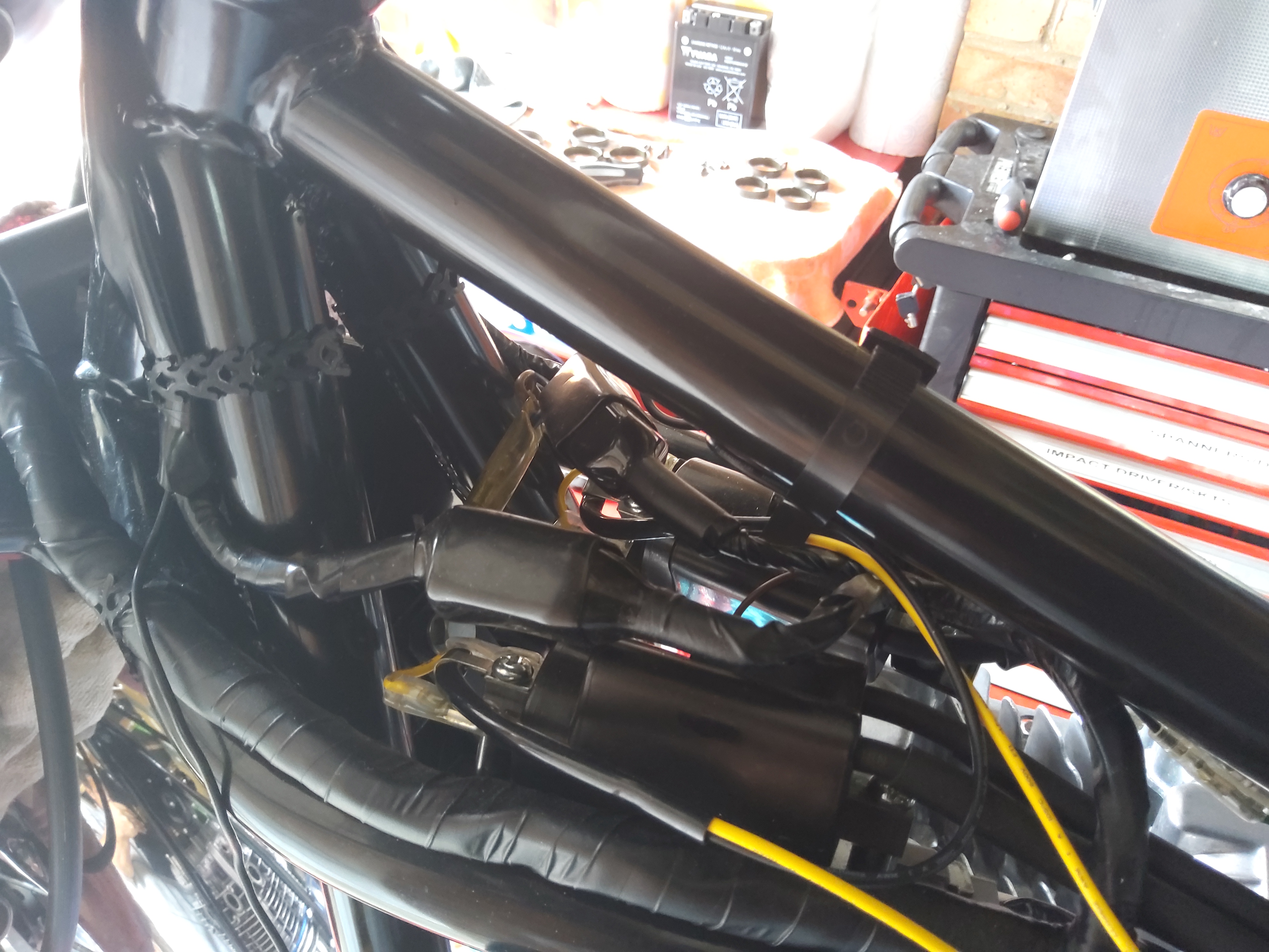

Hi there...re the headlamp electrics. I've attached pics of my Z1-B set-up which should be nearly the same. I tried to add text boxes and arrows over the base pic but f**king MS Word, the famous bloatware app, won't let me save the pic with the annotations.
Anyway, the first pic shows the block connectors at the end of the main harness coming through the large round hole and connecting to the speedo and tacho block connectors. I have a grommet inside the large hole to protect the main harness as it feeds through but cannot find it shown on the parts schematics.
The second pic shows the main harness block connections to the LH (closest) and RH switchgear block connectors.
Not sure what you mean by large hole in the base? My shell is a pattern but follows the Z1 style fairly closely, with a threaded hole in the base for the anti-vibration bracket (23064-009), and a large circular hole above for the wiring to feed through as described above. There also may be a small hole at the very top (used for Z2 speed warning light) which should be fitted with a rubber bung (92074-006) for the Z1.
Hope this helps.

Steve, thanks for your photos, that helps a lot, although your colour coding seems to be entirely optional. That connector block for the gauge lights & switch I currently have outside the headlamp. Mine has the same circular hole, though there is no grommet, but there is a mystery extra vertical slot like hole at the back as well. As far as I know the shell is original, but it is a project I have taken over, so nothing is certain. I do have the threaded hole in the base, and one on top with the rubber bung for the Japanese market red light.
