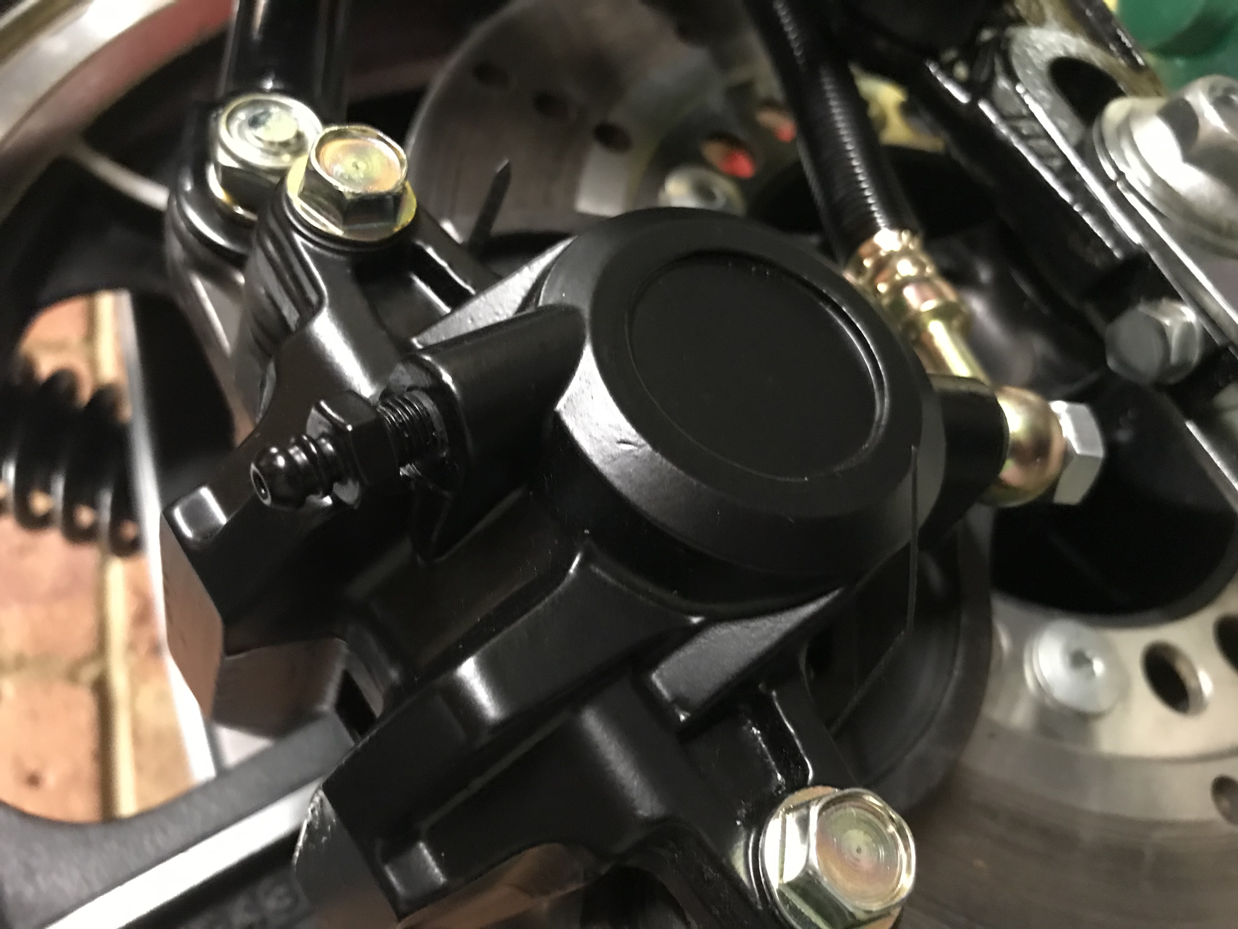

More paint trials and tribulations.

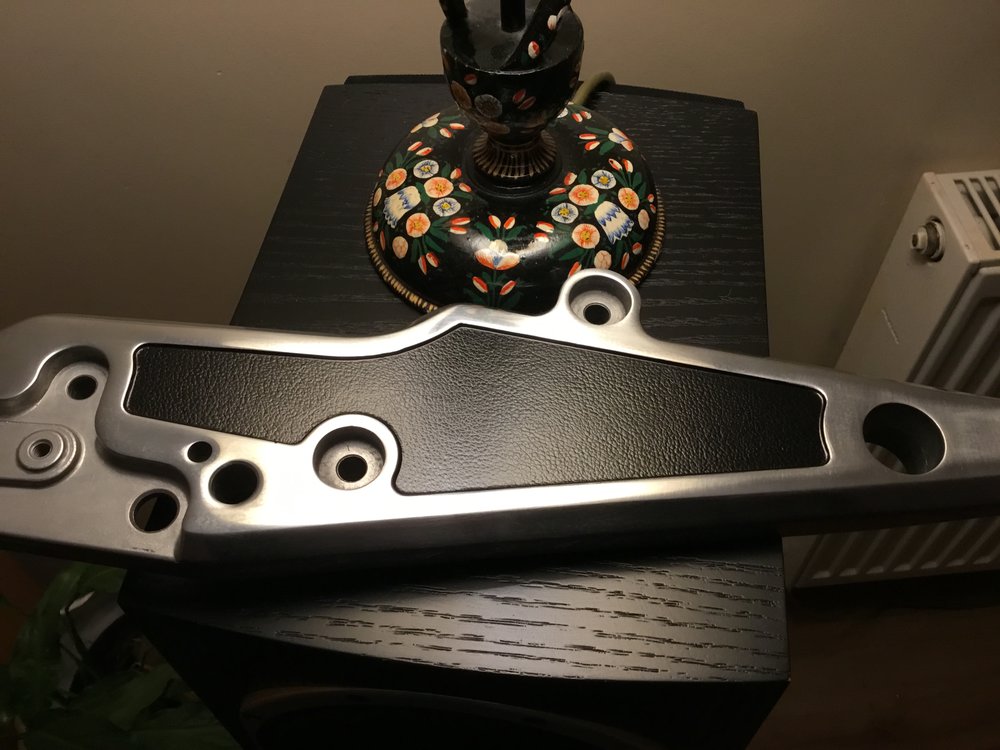

Back in the summer I started to paint the calipers. When I stripped them back I made a very careful note of the finish which was, to say the least, tenacious but also not a bright satin. So many restorations I have seen get this colour either too bright or too thick. I ended up trying two different methods.
The first picture is Simoniz satin black tough paint. Supposedly good for up to 150 degrees I just don't trust it. I sprayed it according to the instructions and left it in the sun for a couple of weeks. I then tried some paint stripper on a test piece and it virtually washed off within seconds of application. It also looks too bright. See what you think?
The front calipers I did in PJ1 500 degree case paint which I then baked on. Aren't gas barbecues wonderful.
This curing process had the effect of dulling the paint quite considerably to the point that it looked quite matt. I have left them for a while as I pondered my next move until a brainwave happened...
Actually I got them covered in greasy fingerprints so wiped them with a microfibre cloth and noticed a dusty residue on the cloth. I continued cleaning them and used the tiniest bit of liquid wax to help with picking up the dust. I must say this is a very close, hard to tell apart, finish to what was there.
All the time I am doing these paint jobs I am mindful of being able to do them again at home if running repairs or repaints are required at any time in the future.

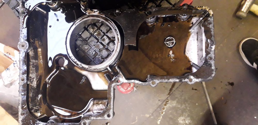

I had a message from Buzzard today that he has stripped the engine in readiness to take to R D Cox for blast and paint.
The sump is always a good place to look for signs of your engines health. He said it looked pretty good.

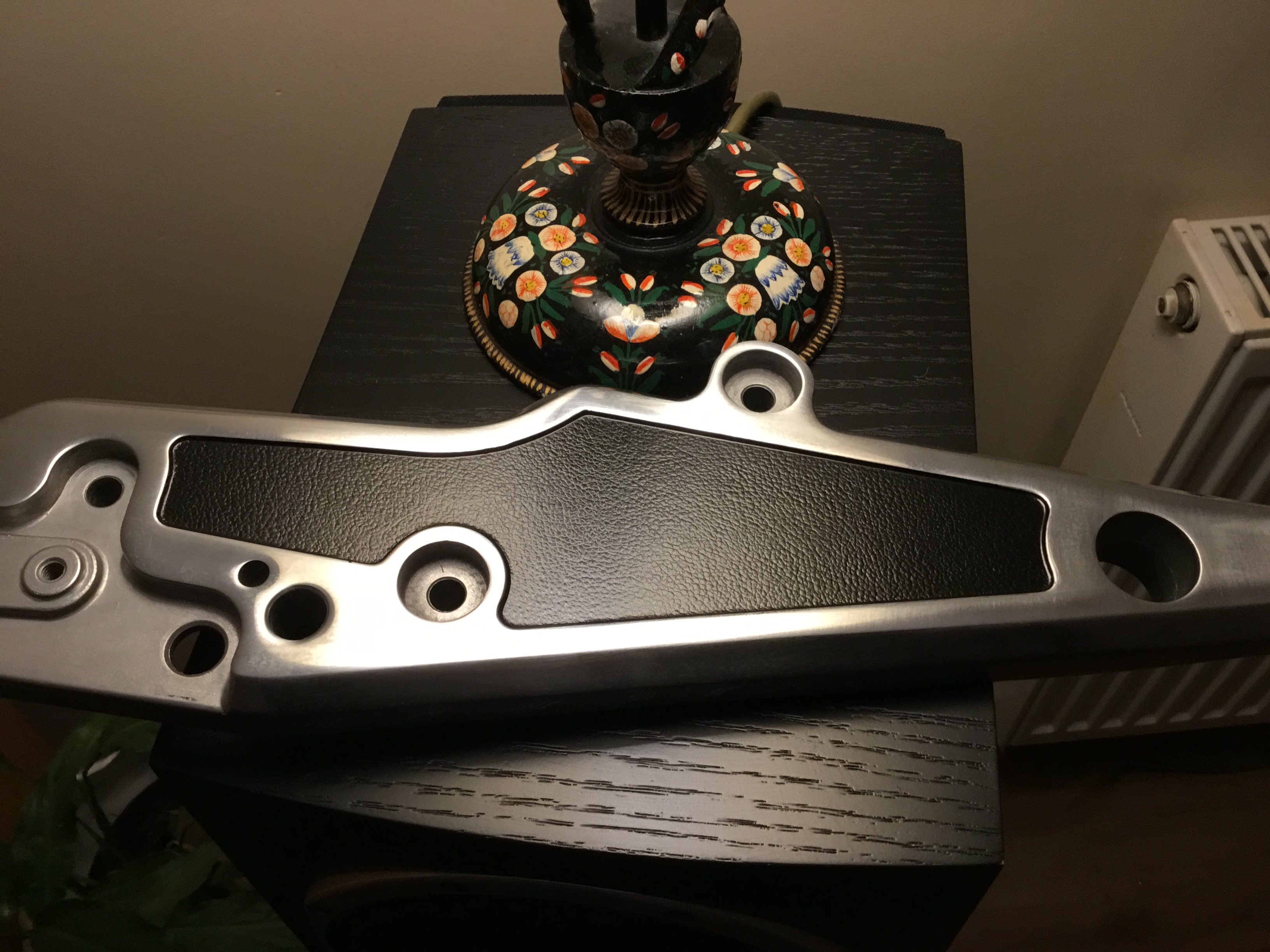

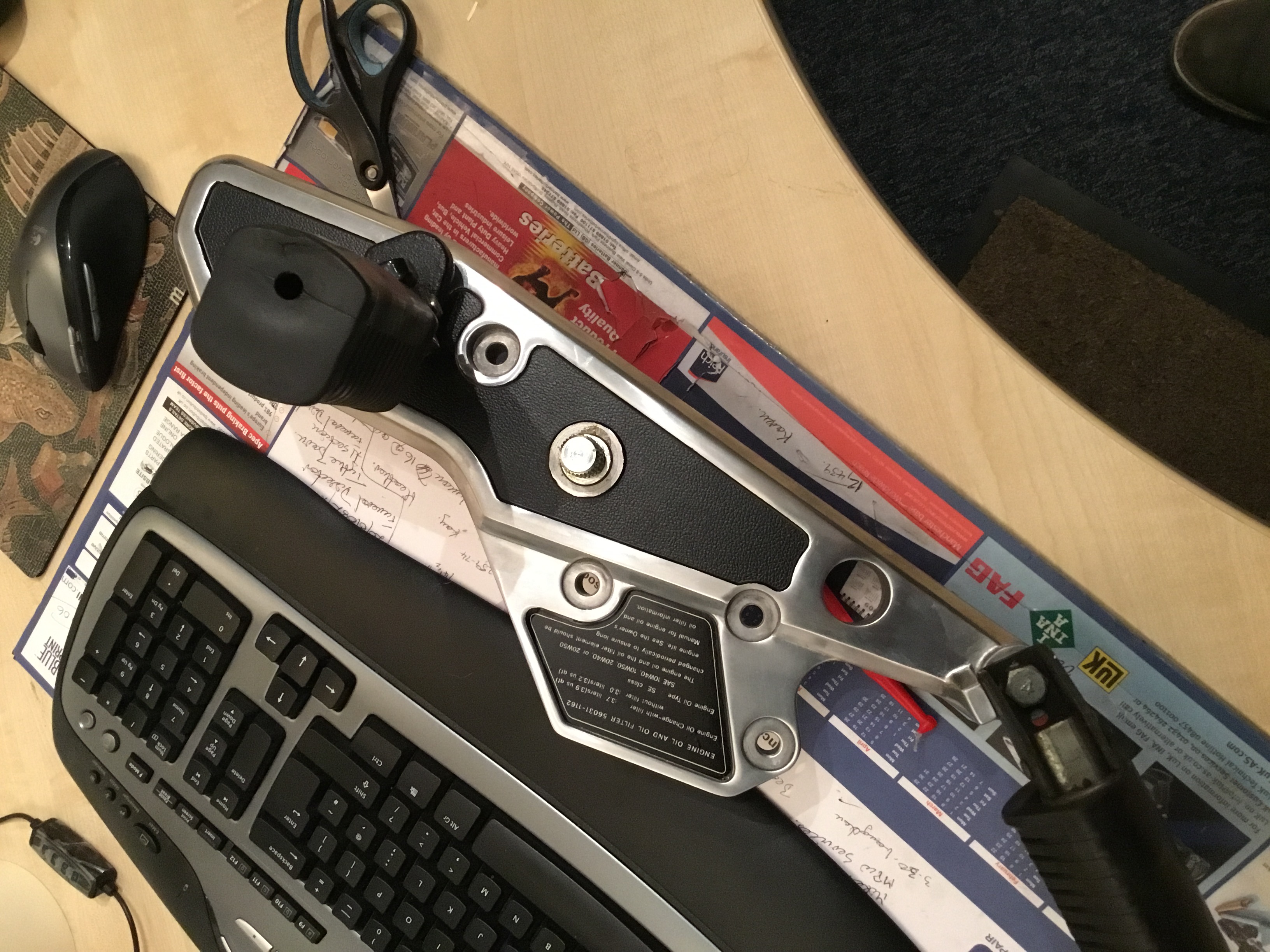

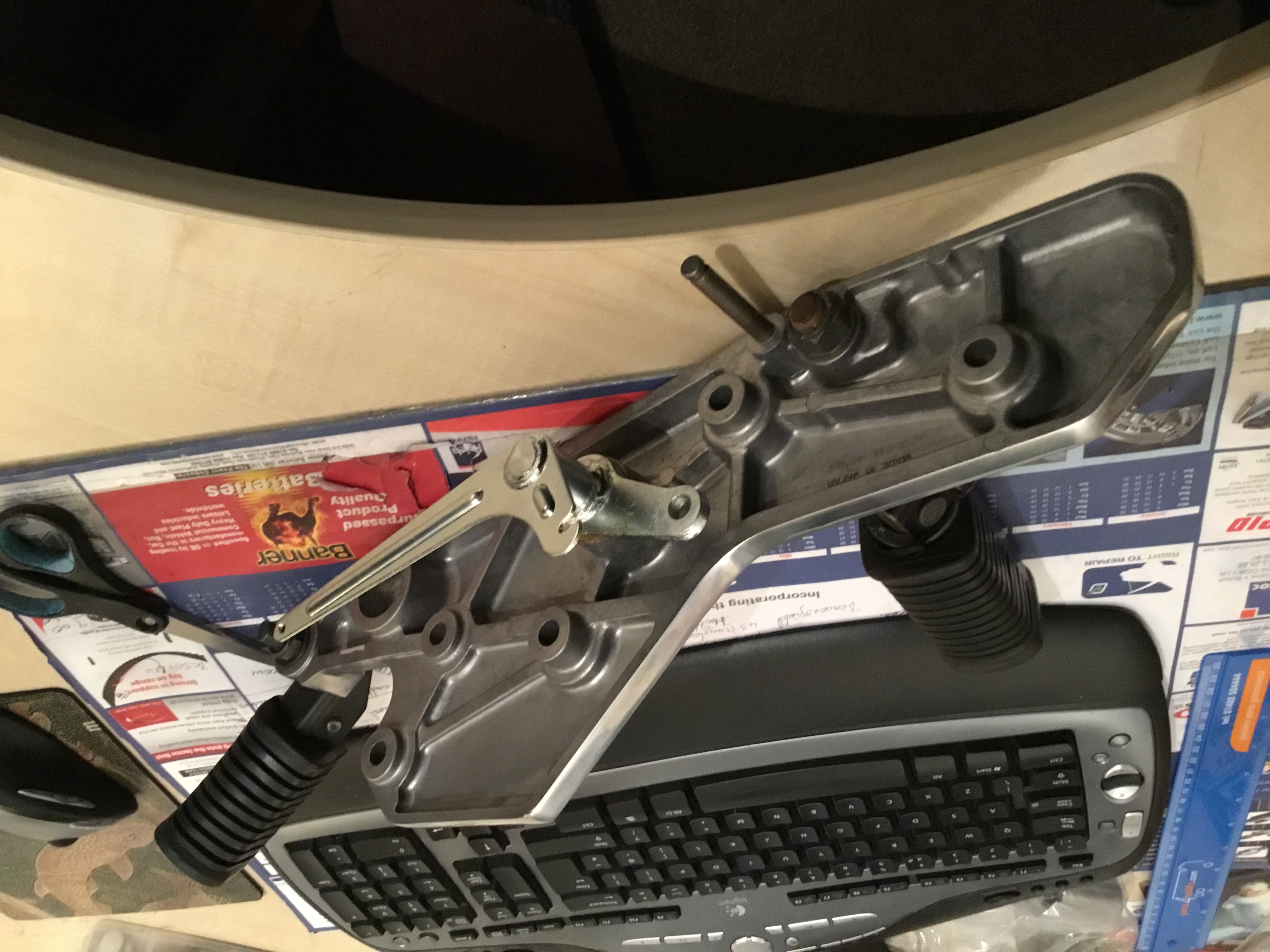

I assembled and painted the footrest hanger. What a PITA trying to fill the black sections without going over the lines. The oil sticker arrived today so I fitted that.
The footrests are pretty good, I may just leave them. Even the nuts and washers are probably not bad enough to re plate.

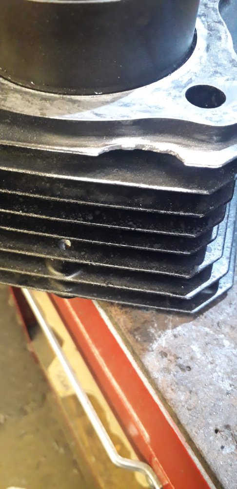

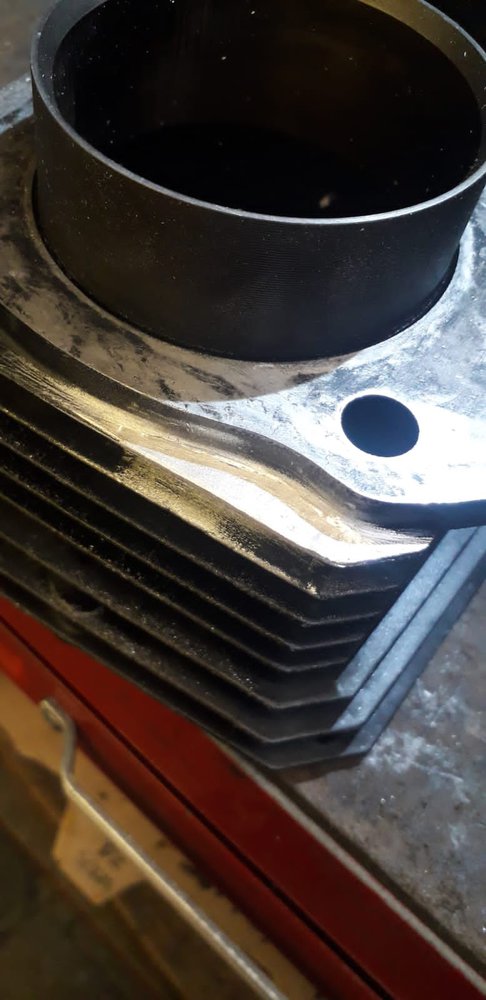

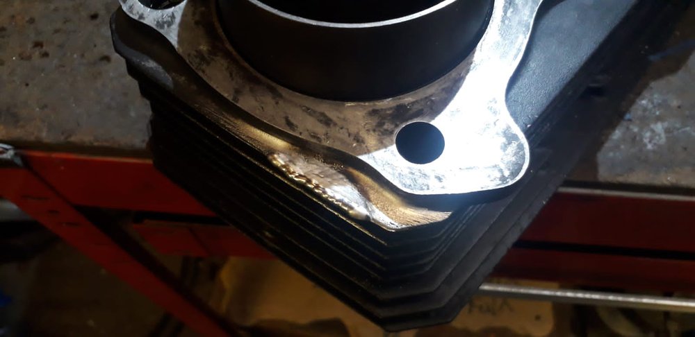

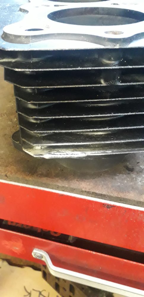

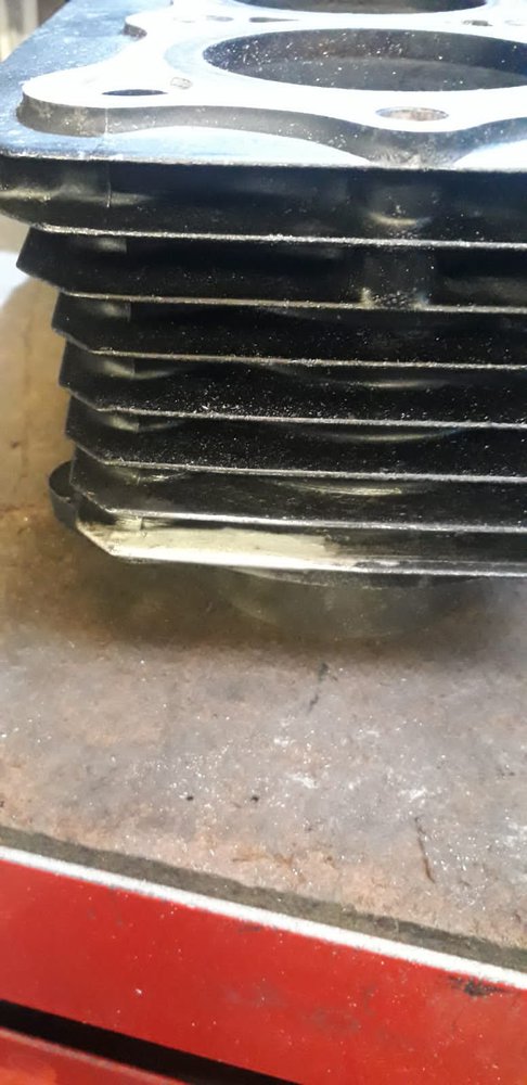

When I pulled the engine earlier this year I noticed a damaged fin on the barrel. I have no idea how it happened as it must be the hardest for anything to get at. It’s almost like it was a stress crack as there was no other sign to give me a clue.
Buzzard sent me some pictures before sending the bits to Cox for paint. His welder is genius.

Got to agree with Chris , the guy I use is a coded aircraft welder for 28 years at British Airways. Jez the welded, as I call him, top bloke. He does all my welding then I machine/ fettle it back to original. Buzzard@thebuzzworkz

A surprise 17 degrees today meant satin black was an option.
I got the other footrest hangar done and discovered that a fingernail is best for sharpening up the edges.
I may have to redo the right hand side?

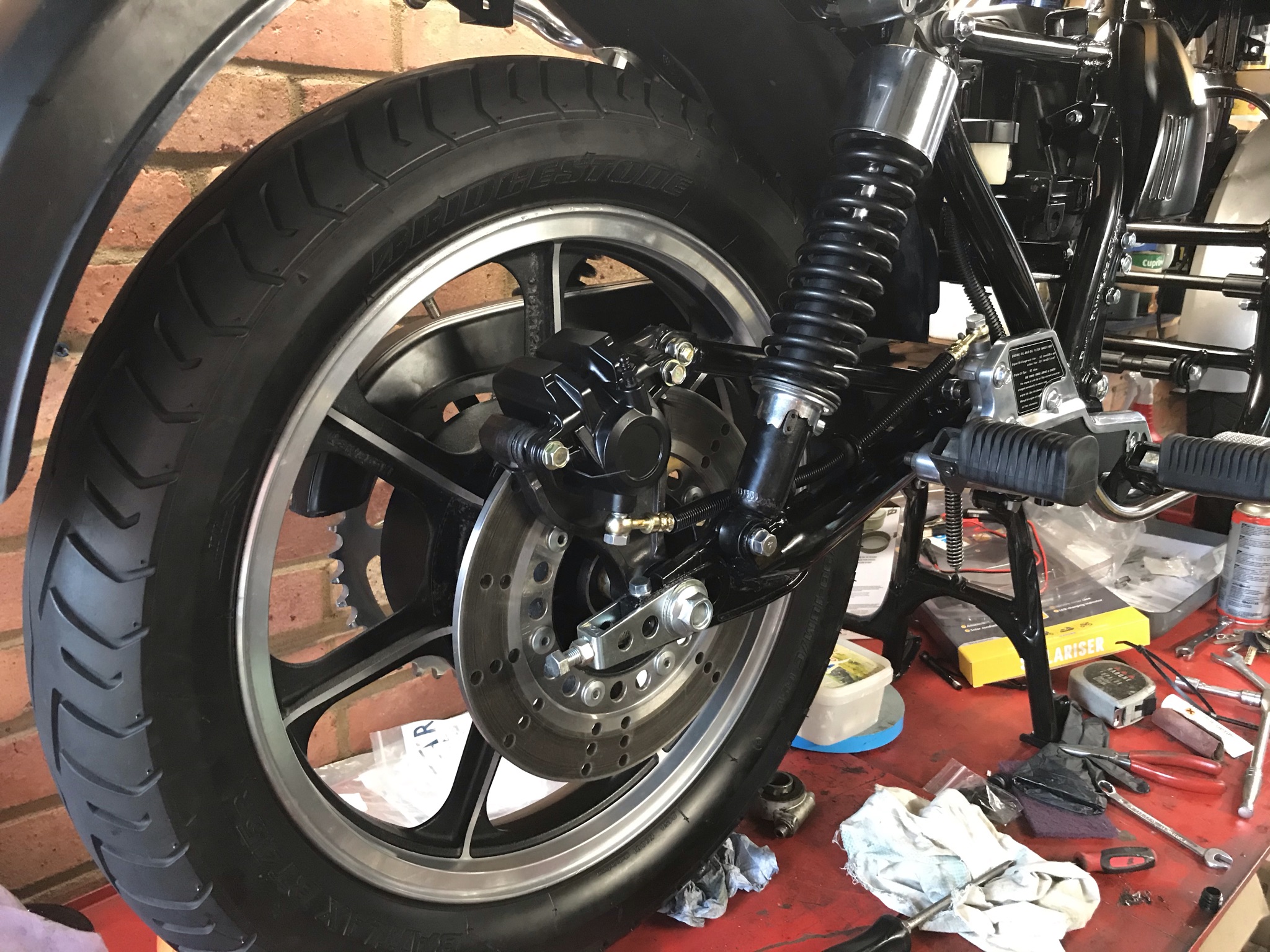

I was determined to get something done today but am feeling rather delicate after a family party. Only our household involved but it’s rare to have a Saturday when we are all here and no one is due at work the next day.

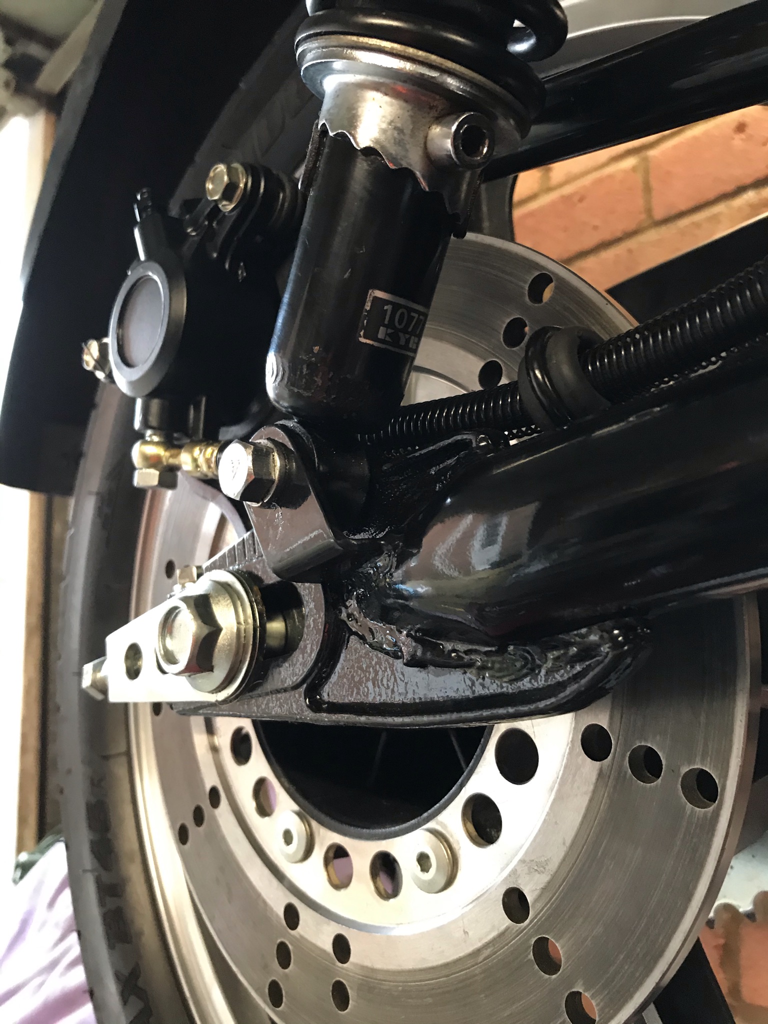

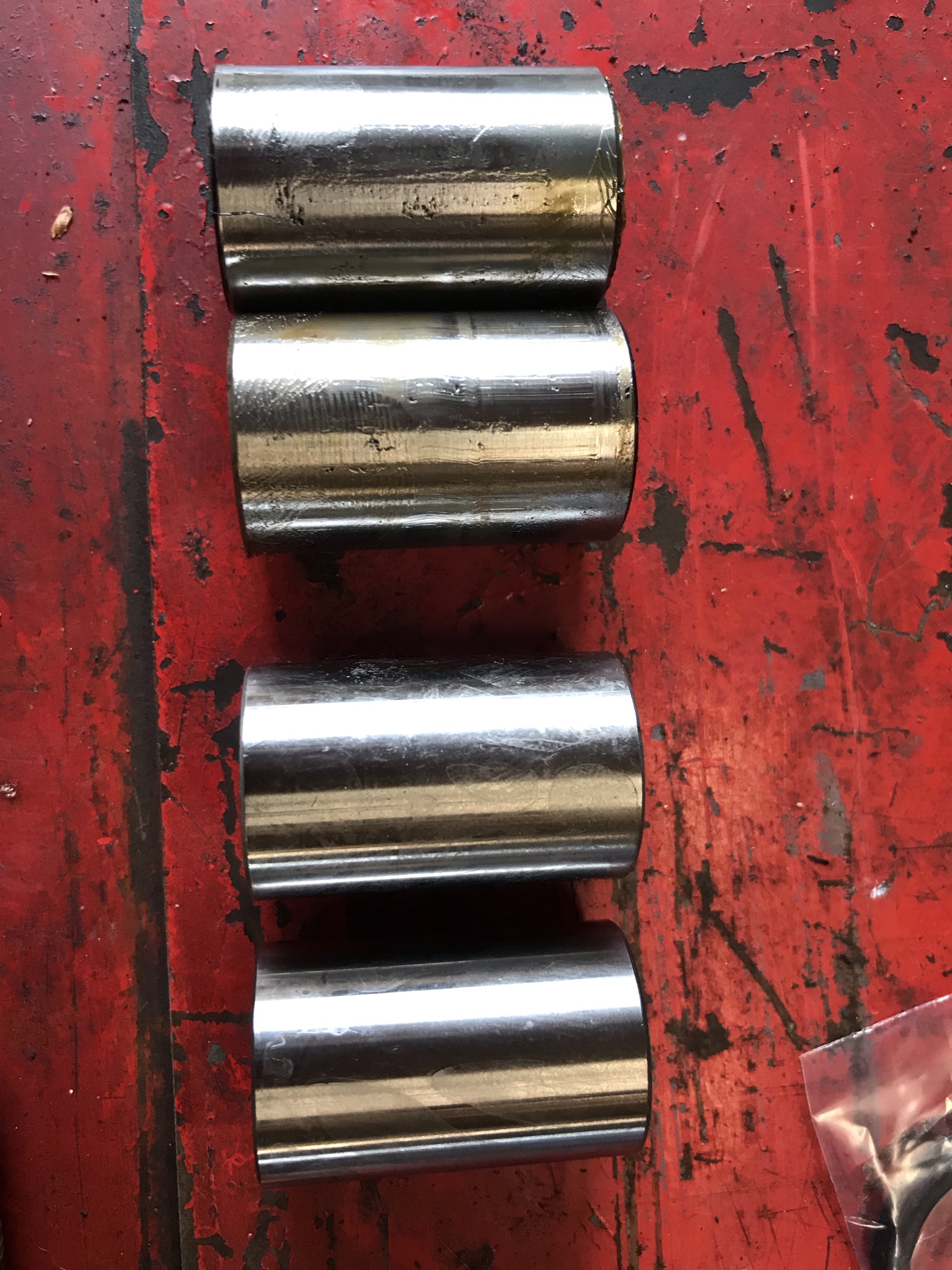

I did manage to get the swing arm finally installed and tightened though. When I first put it together I wasn’t happy about the bearing bushes. As you will see from the photo there was some wear of the case hardening so I bought new as well as seals.

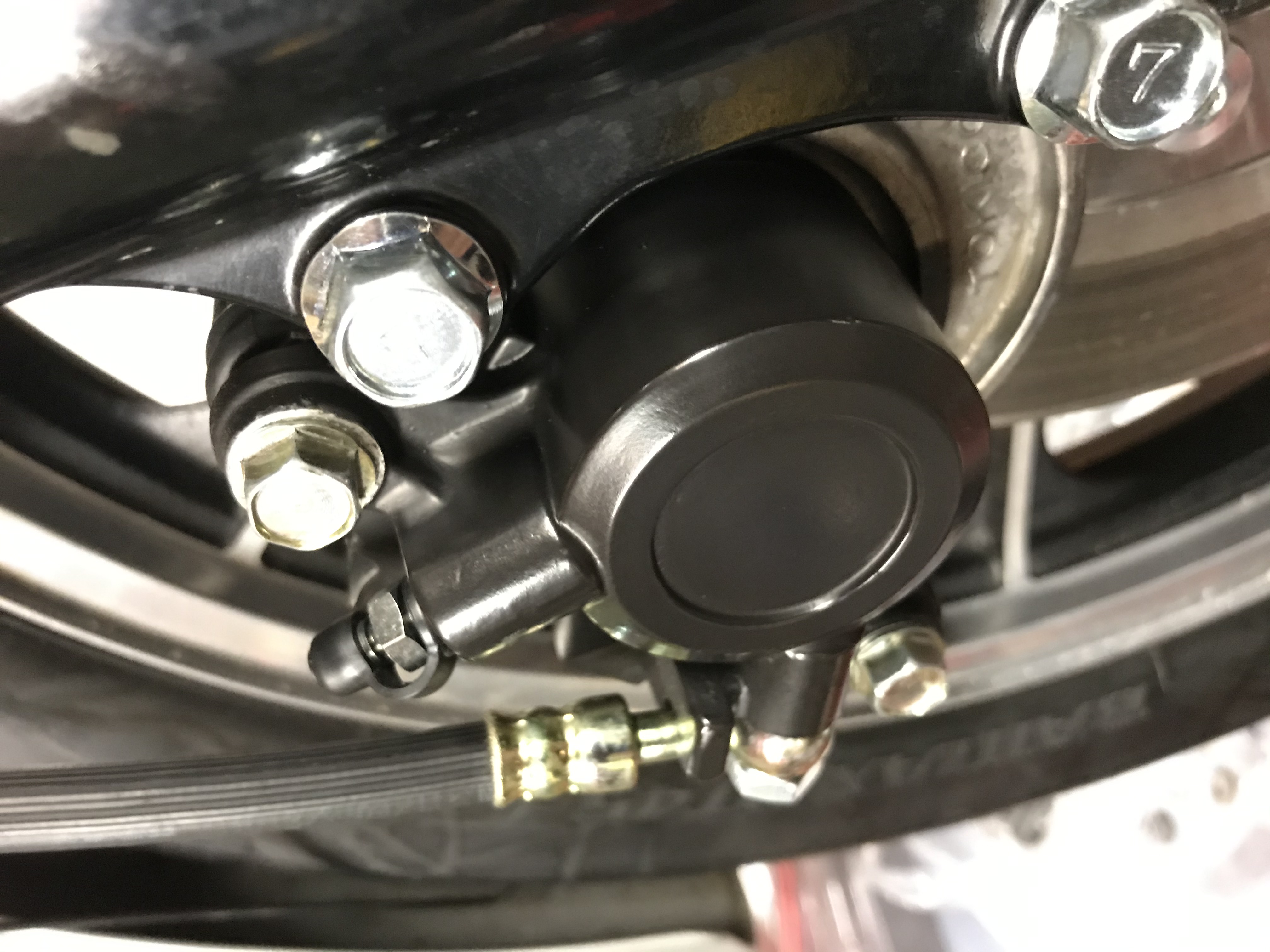

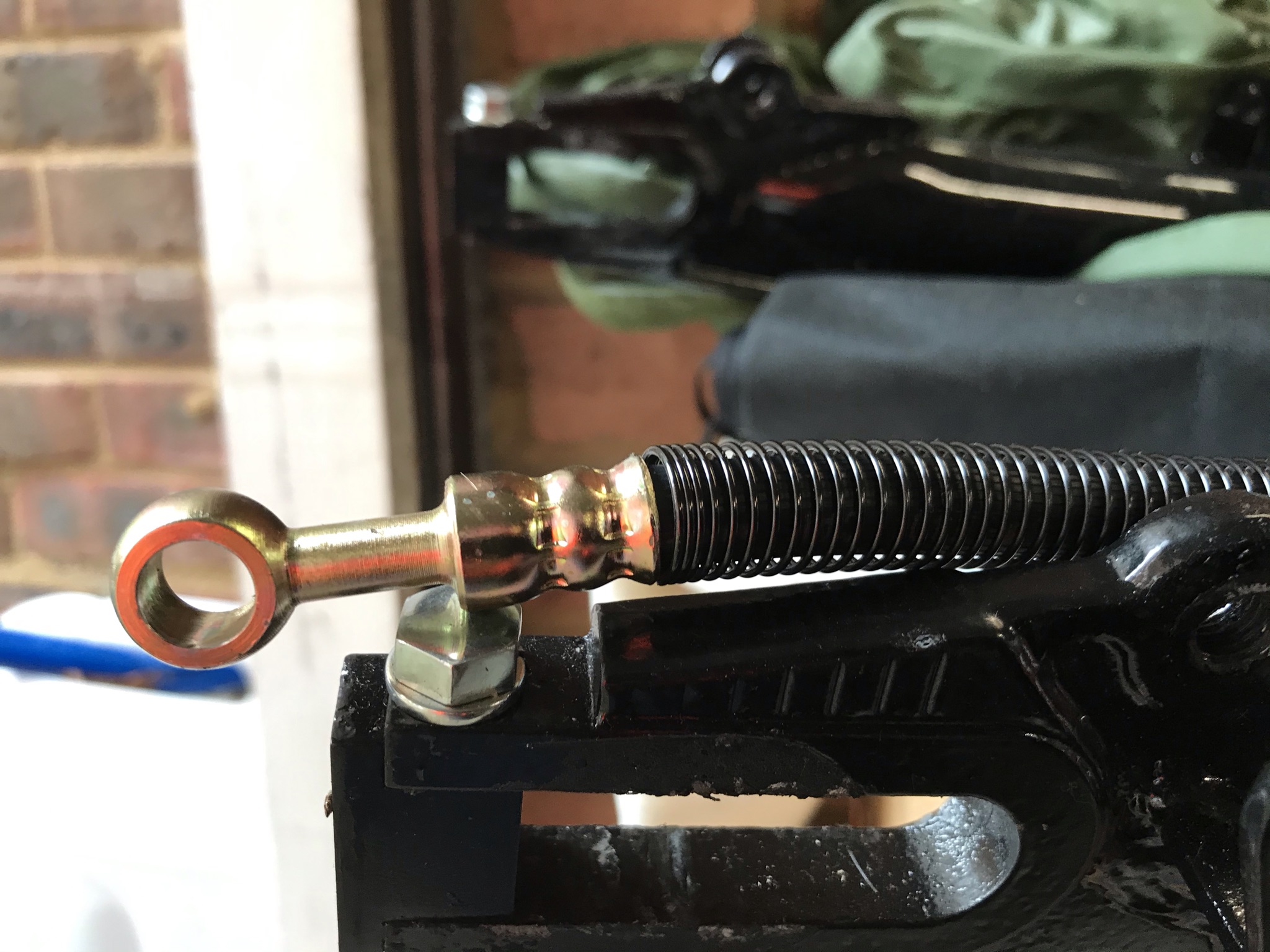

I did say I would post a close up of the refurbished brake hose. These were very good anyway but had tarnished particularly on the protective spring over the years. Mikey’s plating man is very good.
Once all back together I took some pictures in better light.
One thing I don’t think I can refurbish successfully is the rear shocks. I know they are pants anyway and that the damping disappeared many years ago but I wanted to get it as good as possible for display. I will invest in some lookalike shocks when it comes to riding.
The KYB sticker is not replicated by anyone, I have asked. The 1077 refers to the part number and I suppose it’s just not worth anyone investing in manufacture for a limited number of sales. I can’t see many others wanting them.
They are pretty good though, the springs are a little tarnished but that will have to do. I’m not going to invest any money into them.

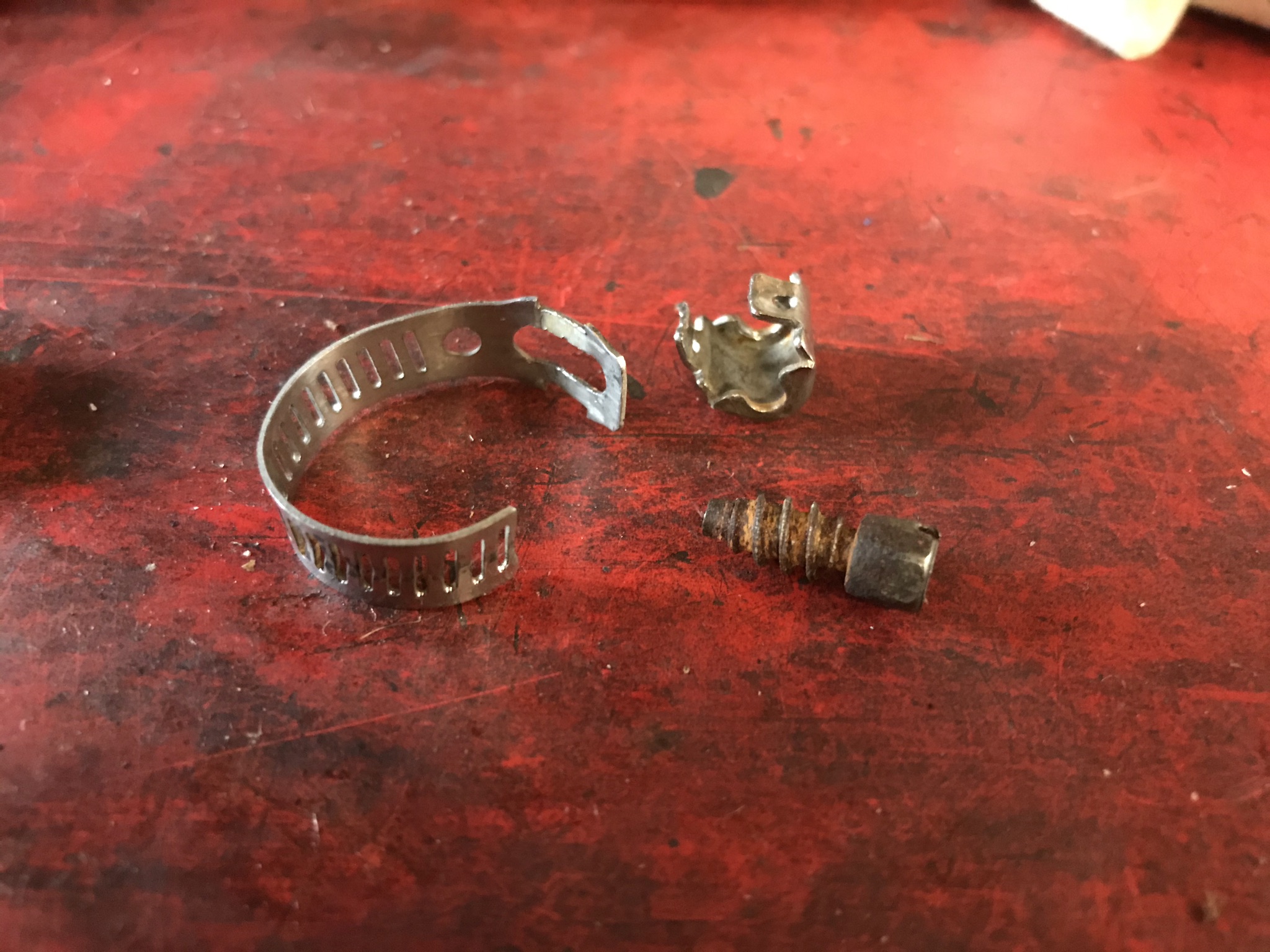

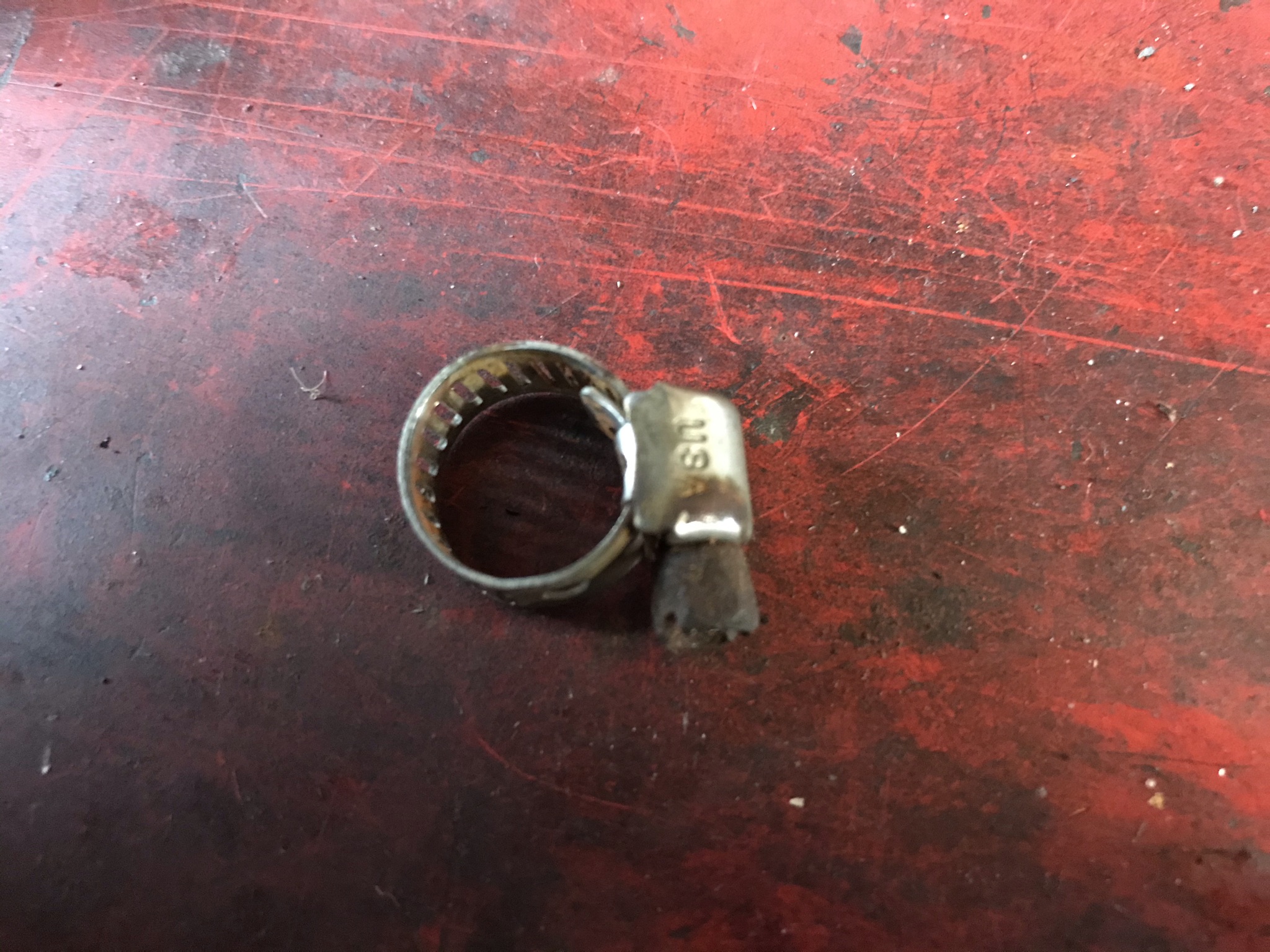

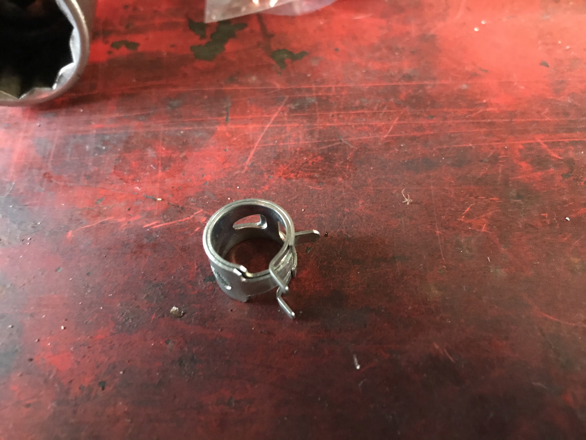

The rubber hose from the fluid reservoir to the rear master cylinder is held in place with 2 hose clips. I had thought that they had been replaced at some point as they are marked USA. They are stainless but have a zinc coated screw which has tarnished. I found they are still available from Kawasaki but neglected to look out for a superseded part number.
These turned up.
I know they will work well but if I can I will refurbish the originals.
I took one apart.
The screws will go off for plating with a lot of other parts still to be done next year.

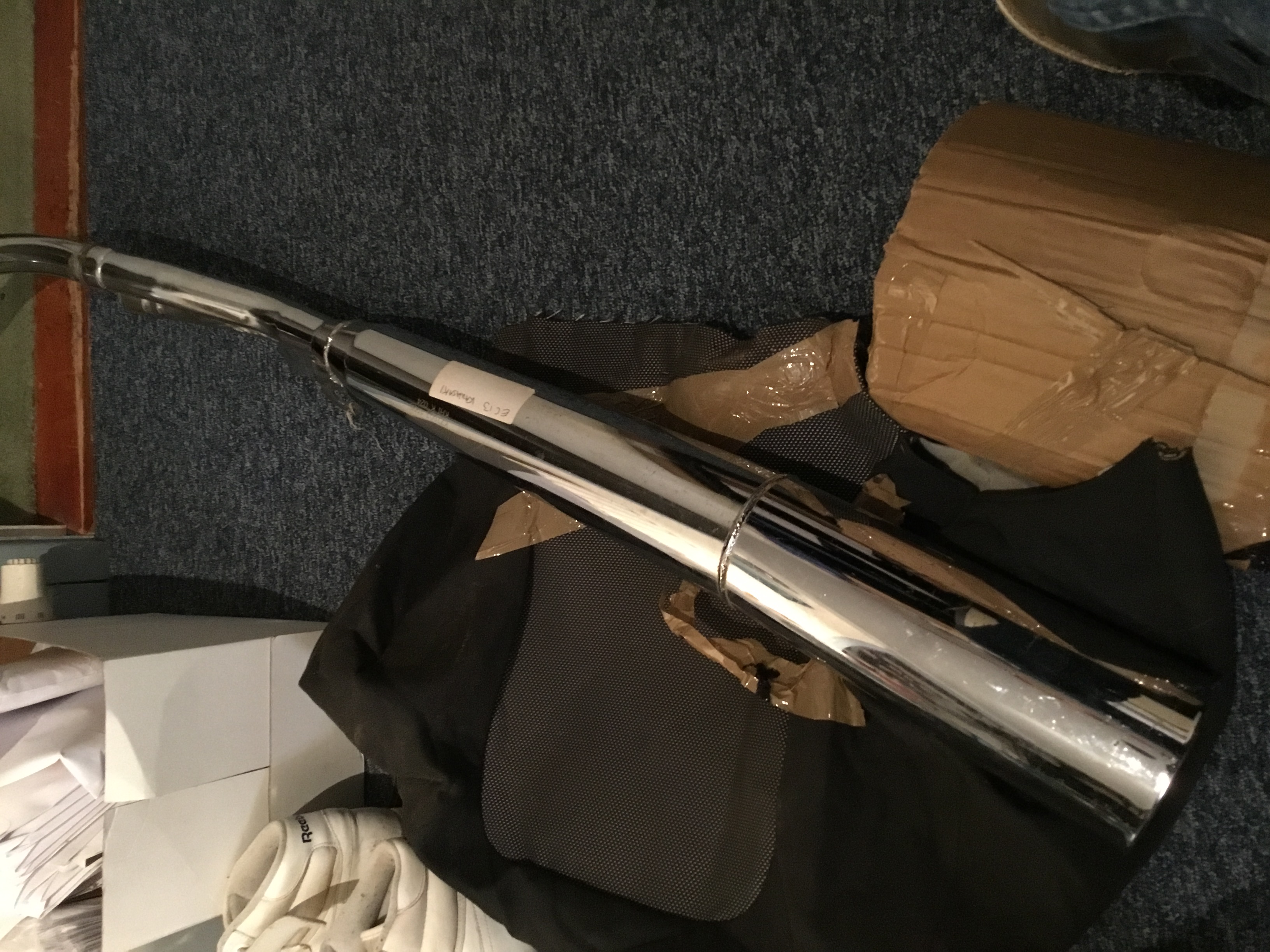

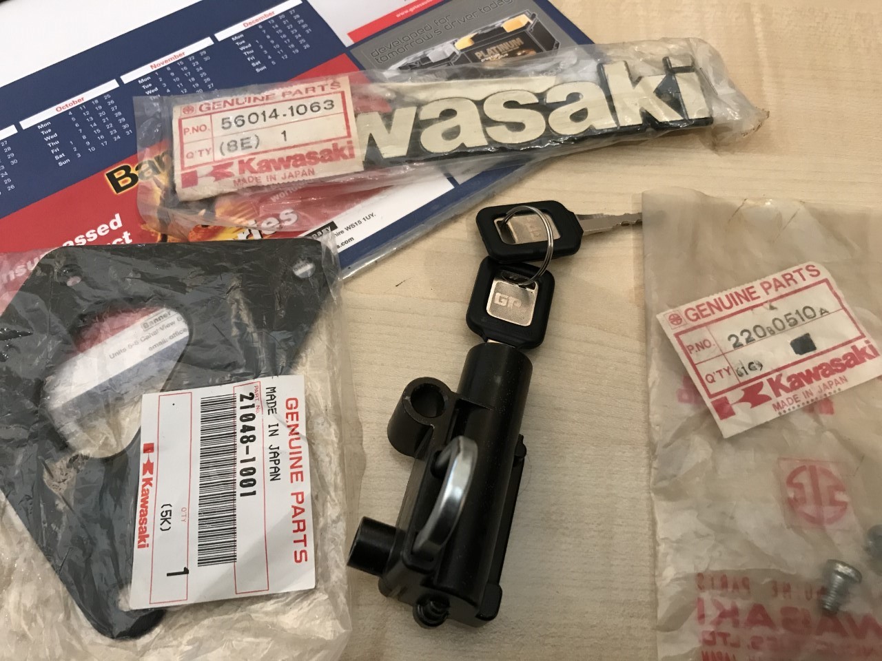

Cold, dark and damp in the garage by the time I get home so have to make progress with parts collecting.
I've had some good results lately :D

#41 PostAuthor: popsA1 » Tue Nov 17, 2020 8:45 pm
Where did you get the seat lock from? Everywhere I look it says "Product not available". :cry:

#42 PostAuthor: tlc » Tue Nov 17, 2020 10:36 pm
Greece, of all places.

#44 PostAuthor: tlc » Mon Nov 23, 2020 8:01 pm
It’s amazing what can be found NOS.

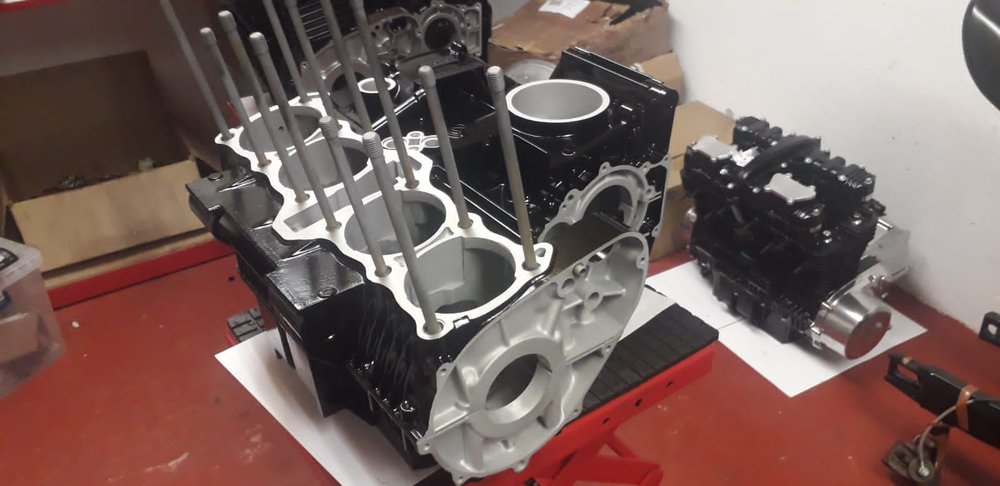

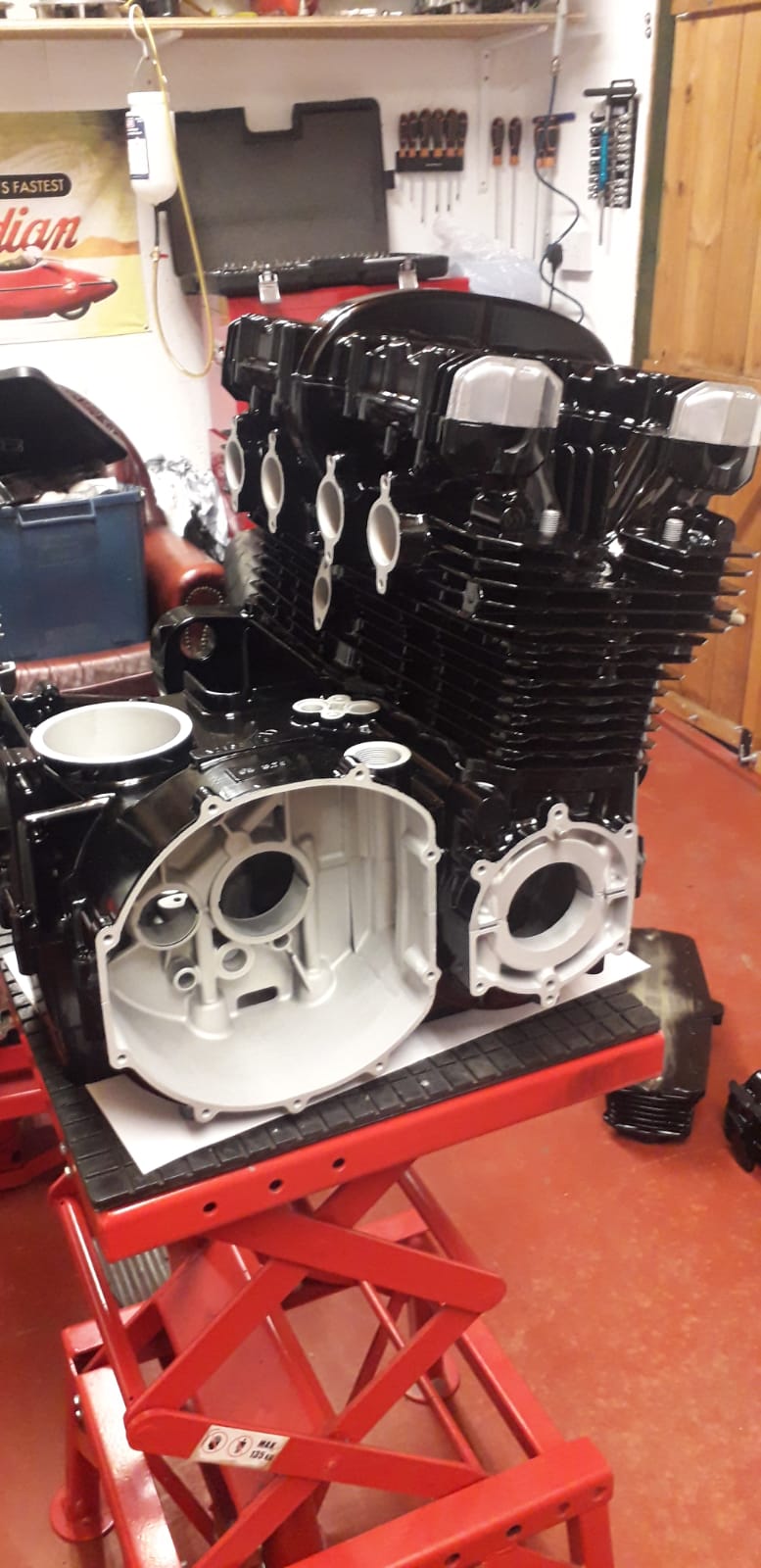

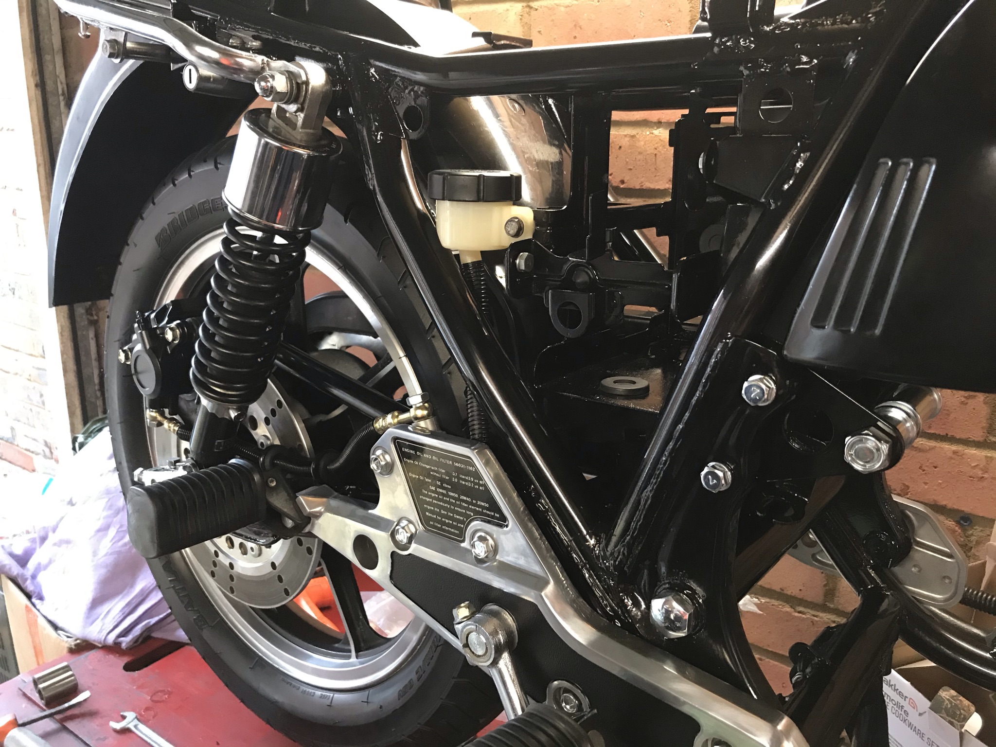

#45 PostAuthor: tlc » Sat Dec 12, 2020 6:58 pm
Current progress - blast and paint complete.
